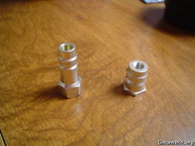

So you were able to vacuum down, and fill the system with stuff from harbor freight?
Romanova
Aug 7, 2002
3,855
Cypress, TX
Quoting jepherz:
Quoting iceman69510:
Quoting jepherz:
Well, I bought a can of 134 oil, 2 cans of r134, a $12 vacuum and a AC gauge set from harbor freight for $45. Vacuumed the system and it held vacuum, charged with the two cans and both gauges were optimal at idle and 2000 RPM. Blows COLD! About $100 in supplies and I ended up with some useful tools and working A/C.
Thanks for all of the help, guys.
Was the system already converted to the R134 fittings?
Nope, I put those on as well.
Explain process please.
jepherz
Aug 8, 2004
7,878
KC, Missouri

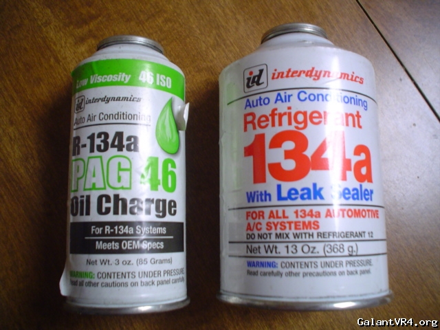

I just emptied out a full (I think 5 oz?) of PAG oil, which is what you're supposed to use for r134. It comes in the same type of canister that the freon does. After vacuuming the system, emptying the PAG oil into the system until it was gone, and starting the car, the A/C is able to start because of the minimal pressure from the oil. The actual quantities of oil for all parts of the system are in the dealer manual, but it was so close to the amount that came in the can, I didn't bother to measure.
I'll get some pictures of the stuff I used tomorrow.
