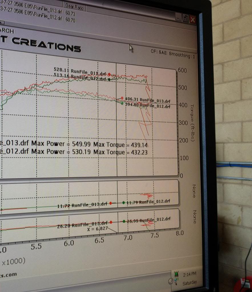

Results are in. 550awhp/440awtq at 26 psi on e85. Why only 26 psi you ask? We were having ignition issues, due to the Dynatek arc-2 not working and subsequently causing spark blowout when we tried to turn the boost up any higher. Once I get the ignition issue sorted out, the car should easily make 600+hp, which is the ultimate numbers goal, although I'll probably keep the boost at 21-26psi most of the time.
Realistically I'm very happy with the results, and I don't want to push the car too hard because I don't want to break anything. I think 550awhp is pretty awesome considering it was relatively "low boost" and we were fighting spark blowout. I had to gap the plugs down to .017 for now!

Numbers:

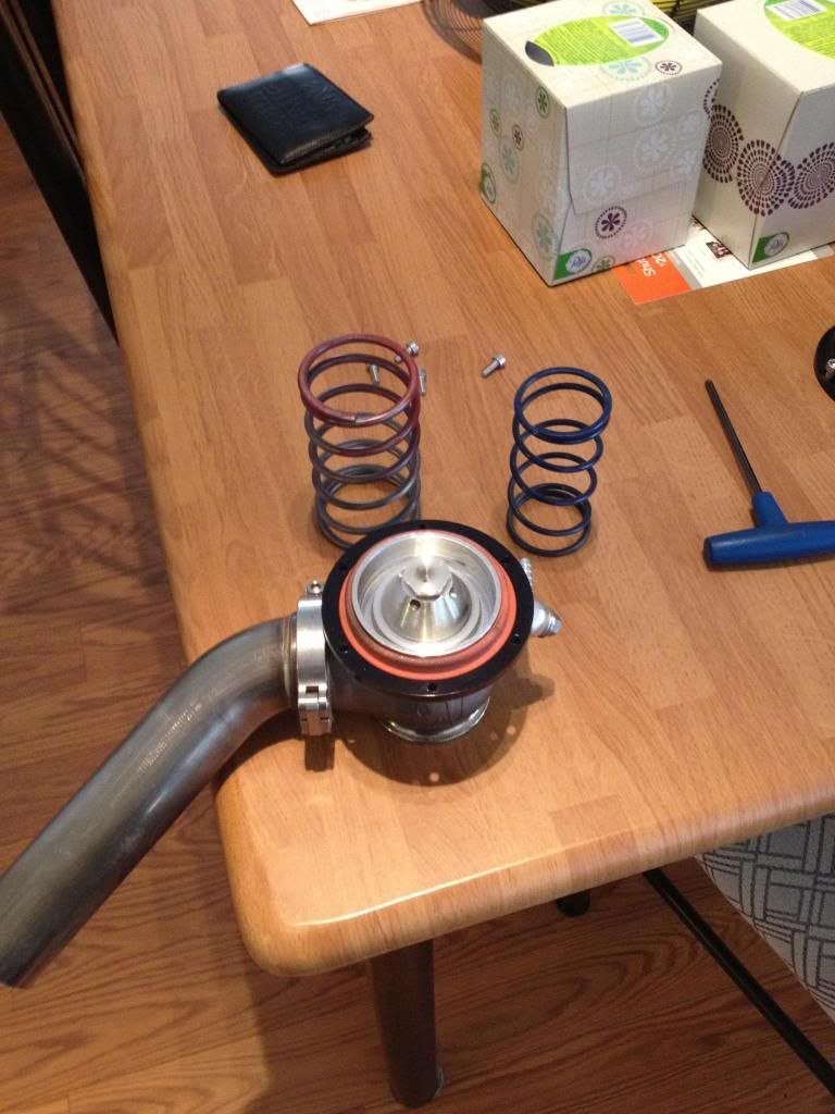

I had to add another spring to the wastegate the day before. Was at .7 bar (10psi) now at 1.3 bar (17.5psi)
