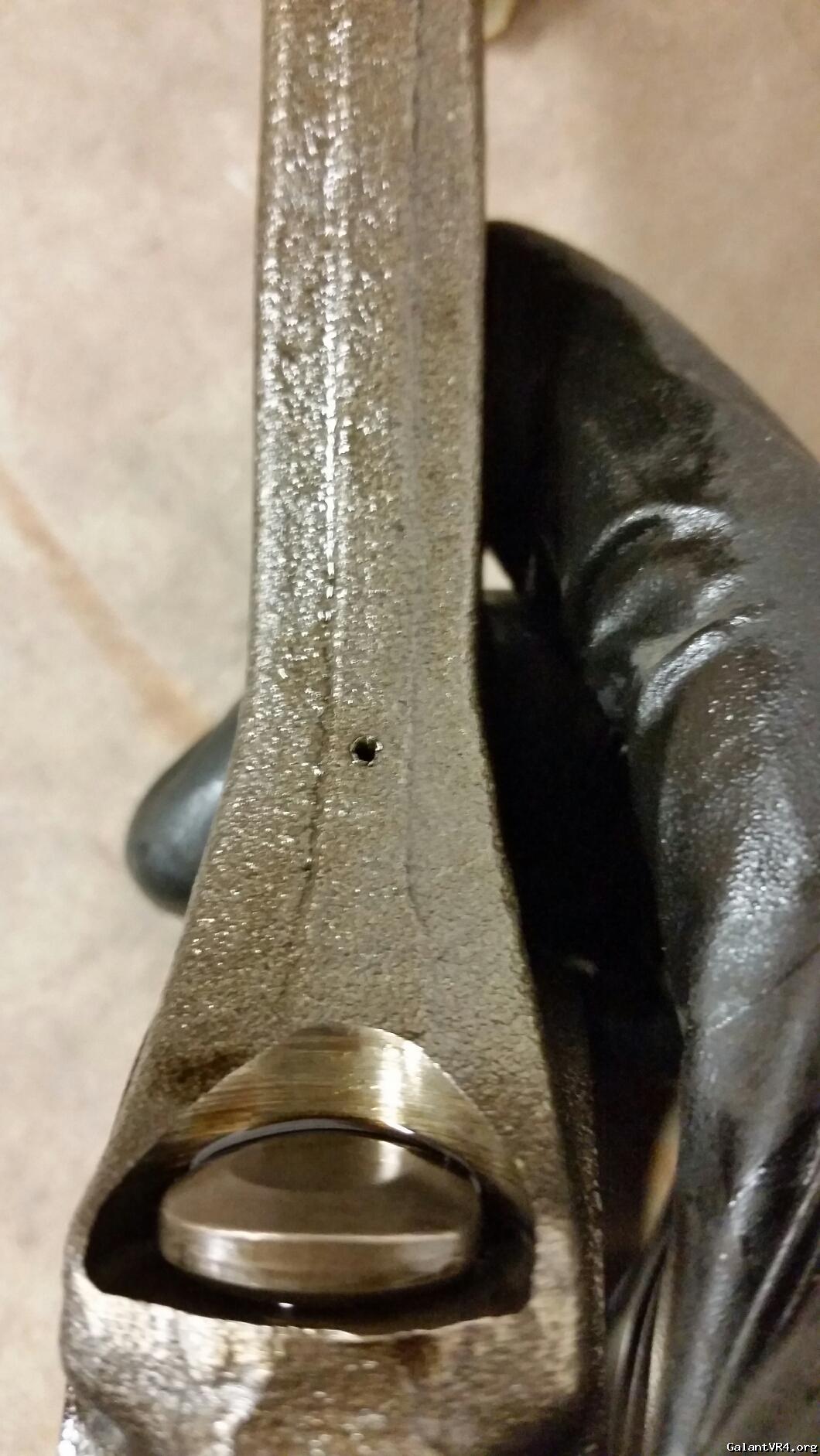

The stockers do. I know my Eagle rods do not, but they are on floating pins also, so they are oiled from the squirters. If you look at the stock rods, you can see the oil galley

^^ Disagree. The stock rods have pressed-in wrist pins. An oiling hole would be completely pointless. Some aftermarket rods feature an internal oiling hole for the floating pin but most do not. Typically the oiling of the wrist pin is achieved through scavenging of oil from the cylinder wall, which then collects in the piston skirt and oils the wrist pin progressively from the piston to the rod. Many engines do not use oil-squirters and still run partial of fully floating wrist-pins. The oil squirters job as a lubricating aid is secondary to it's function in cooling the pistons, hence the use of oil squirters in turbo applications. The choice to use or not use oil-squirters isn't about lubricating the pistons, it's about a compromise between oil pressure, cost-to-install, and piston dome heat (which isn't really a problem for low-to-mid power levels with forged internals).

If that is the case, they why the holes from the rod bearing to the wrist pin (with matching holes in the Rod bearings themselves). I would be interested to know the purpose of them.

Stock rods definitely have holes that go to the wrist pins. My eagles do not. I never noticed cylinder wall squirt ports on the stockers though. Not that I ever looked.

Open foot insert mouth. I never actually had a stock rod in my hand only eagle rods. Thank you for clearing that up.

I didn't know it had any oil ports in it. I just happen to have a set from my core engine out in the shop right now.
