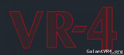

I had the "Galant" and "VR-4" in AutoCAD (dwg) awhile back; I'll see if I can find it on my archives, fwiw. It was simple recreating it onto CAD though, so somebody competent should be able to reverse engineer it to scale onto the CPU.
JNR - if you have this, that would be great.
9,848
I'll take a look for it. I'm trying to recall why I even made it and know the "VR-4" part was done; just hope I still have it on my HDD, although don't know why I would've gotten rid of it...If I can't find it, wouldn't be a problem for me to do it again on the computer and save as a dxf; I didn't install the autocad/inventor on my new laptop just yet, so would need to do it at work, but maybe just measure it up at home and bang it out.

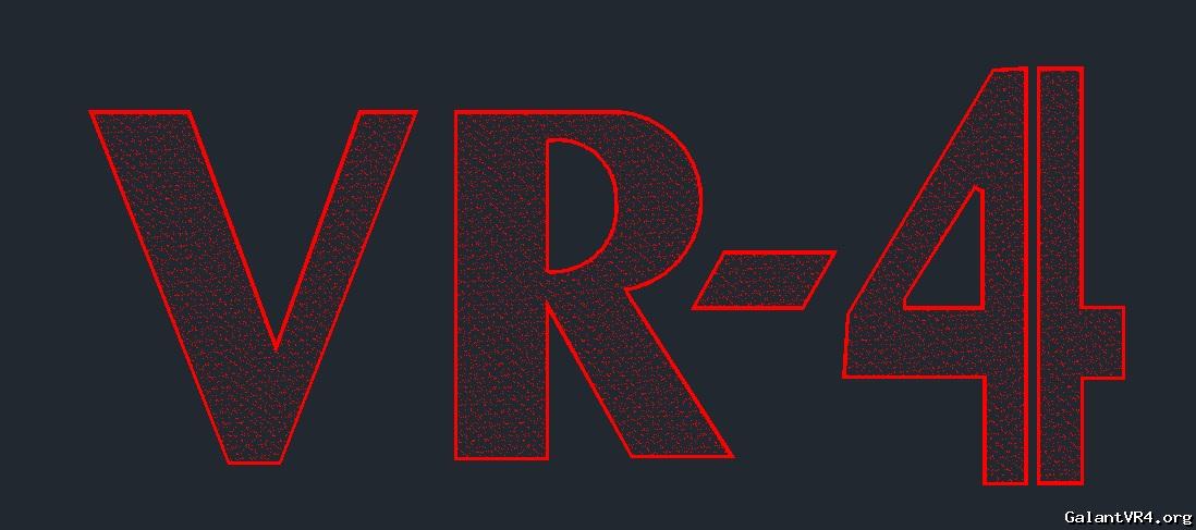

Well, found the file and wow it had been almost 6 years ago (damn time flies). I had thought I did it more to actual scale, but comparing it to the repro keychain logo (all I have in front of me) it's not *quite* the same, so now I'm questioning where did I take it from then. the "look" is there and it's close, but there are enough differences that it's not going to match the keychain logo. [EDIT - looking at the badge pic it's closer then; this is what I have; I downloaded dwg viewer so I could see the file, so here's a screenshot (ignore the colors, as those were used to assign pen weights, as well as how crude the lines are since that is display resolution limits only):
I can recreate anything though, based on whatever you want, so let me know if you need any help on what exactly you're looking for.
9,848
Well, if it looks OK (ignore the thick lines), you're welcome to the dxf file Blacksheep; just PM your e-mail and I can convert tomorrow at work.
