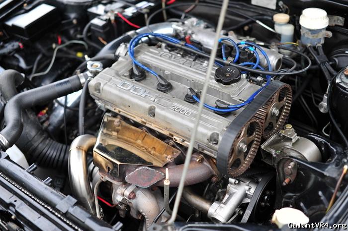

The car runs like a raped mongolian. 14b with lotsa boost. Looking for dyno and 1/4 mile records. Lotsa weight elim - car weighed 2620 the other day (no driver) with a packed camera bag, passenger seat and misc tools & electronics. More weight to pull over winter. Few more parts to get...
JMF SMIM coming soon - will do dyno comparo between 2G, E3 and JMF on 2G head when it comes in.
Also Evo8 complete valvetrain installed - noticeable improved throttle response.
Thanks to Joe at Slowboy for help and sponsorship lol...

Oh yeah - the E3 over 2G intake manifold is day and night. Car spools faster, boost hits really hard, and top end is finally useful with those 264's...

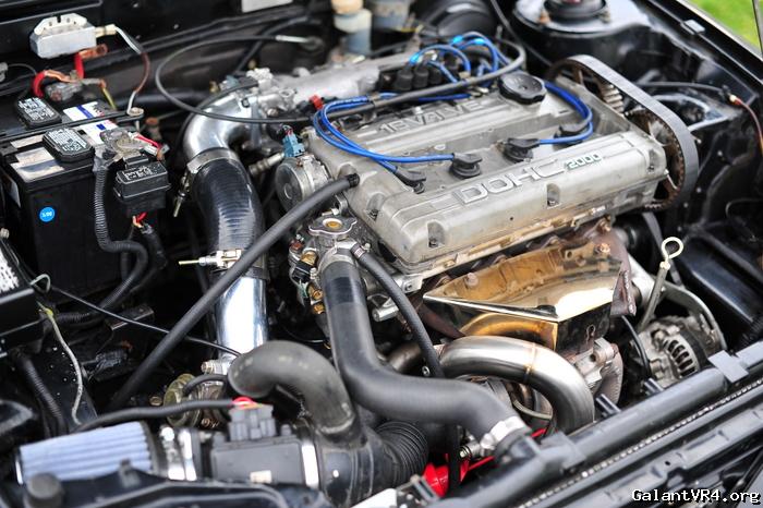

Nice. I have a feeling we will be going back and forth with 14b conversation next year. What tires are you going to be using?
The aperture your shooting the engine pics at makes it feel like Im looking under the hood of a model toy car, not a real one. 1.8 lens?

D700 w/ 50mm 1.4 afs for the engine pics ;0)

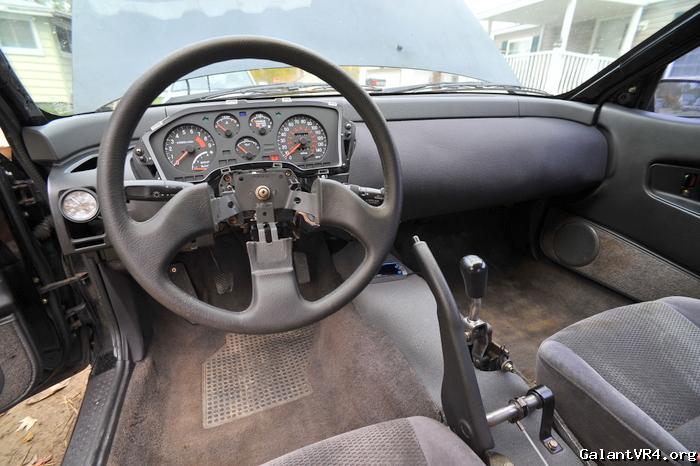

secret ultrawide on the interior

thanks to Olson for the Colgate white E3 turbine and o2 housings - and the fire engine red actuator. It's so gay I had to leave it on this dumpster chicken lol...

What's the story on the interior?
I think he had a write up on what he did to the dash. He gutted everything and ran a piece of fabric over everything.
I have a question though. Will the stock accordian intake pipe be a hinderance at all?

it is a hinderance. I had a 4" FP intake pipe on the other day and it was sick (borrowed).
ditching all of that - ECM link v3 w/ map my ninja...

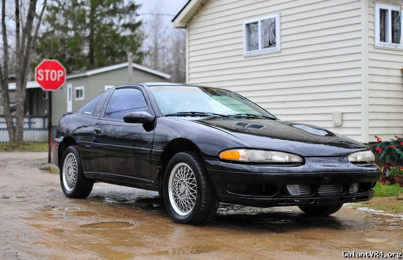

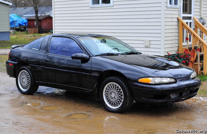

wahoo! got it buffed :0)
paint is still mud - but good god it's more than a little better...
