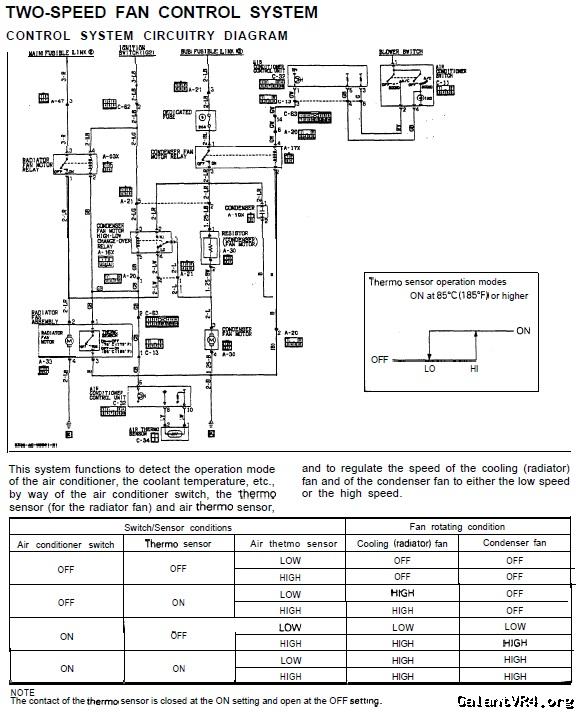

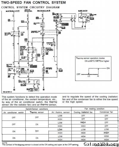

I over heated my car again. lost count now but which sensor triggers the cooling fan to turn on? /ubbthreads/images/graemlins/banghead.gif
thanks in advance
Here you go

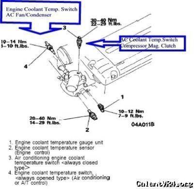

Quoting yeti:
if the number 3 plug is not even plugged in does it matter on a car without AC?
No
Quoting AlainB7:
Somebody have the part number of the #4 sensor?
Or the 4 part number for future reference.
Not 100% but according to caps should be MD 069879
The primary fan is controlled by the thermo switch in the bottom of the radiator.
