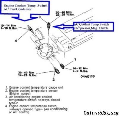

These are the sensors in the t-stat housing:
The USDM cars have a sensor at the bottom of the radiator that turns the fan on ( not shown but easy to find ). The relay for the fan(s) is on the LH side of the rad support near where the IC pipe goes thru.
You can test any of the sensors by grounding the plug hot lead with the key On. Fans should turn on, temp gauge should go all the way to hot, etc.
