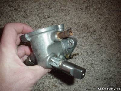

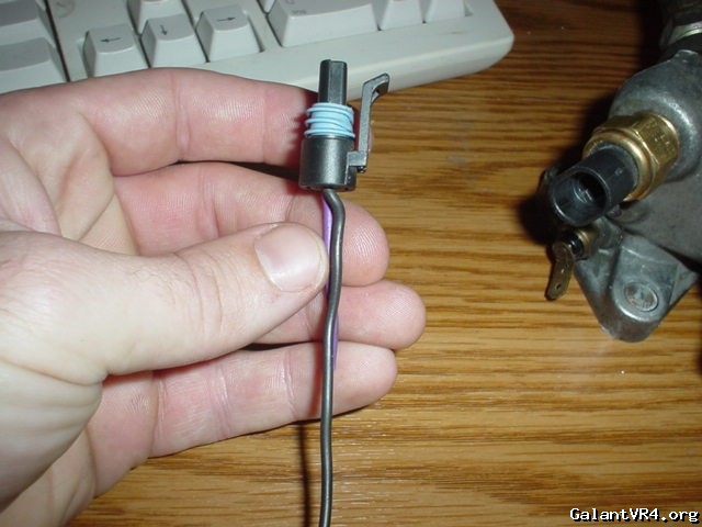

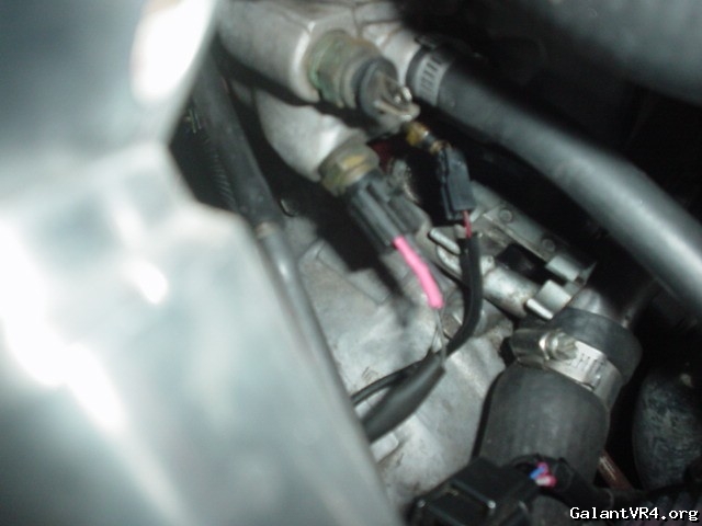

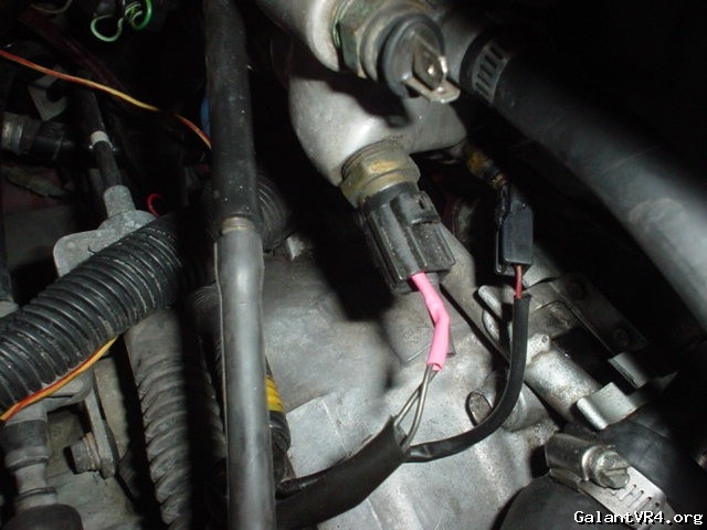

Here's a couple of pictures of the sensor I'm talking about. It's the one you see in the pics with the red shrink wrap going into it. (because the plug got brittle and broke apart from heat.)
Another angle.

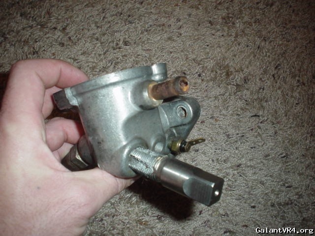

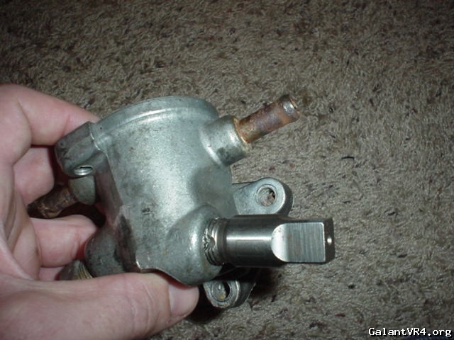

Since the hole that the factory sensor is in happens to be the right size, you won't need to drill to just adapt it over. At this point insert the tap and thread it by hand as far as you can.
Mount the housing in a vice or put a long bar through the 2 openings for leverage. Then start to use a wrench and turn it further and further in. For every 2 turns in with the tap, back it out 1/2 turn to clear it of shavings. Then proceed further until the tap is almost all the way in. Then remove it and clean the housing of any shavings.

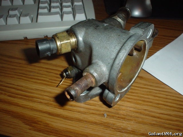

Here's a picture of the housing with the GM sensor installed, the other pic has the pigtail that comes with the sensor.
When it's installed (or before hand) You can solder the wires from the factory harness to the GM pigtail. The polarity of the wires is irrelevant since it's just a measure of resistance. Though, if you want to, take a volt/ohm meter and find which wire has continuity to ground and hook that to the black wire. Solder the remaining wire to the colored wire left on the pigtail. (purple in my case) Then plug it in and go.

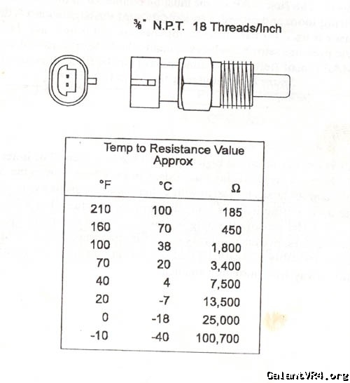

Here's a chart for the resistance of the GM sensor. I don't have the chart for the Mistubishi one, but they interchange perfectly with no confusion in temps according to all the stand alone ECU's I've installed, and one friend who's running this sensor because he didn't want to pay what Mitsubishi wanted for the pigtail and sensor when he broke his when a wrench slipped.

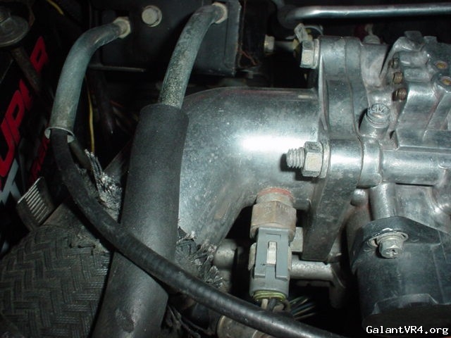

This same method can be used to install a GM air temp sensor in the TB elbow. They are the same thread tap and drill size.
Here's a picture of my IAT for the Haltech in the TB elbow. Look for a full write up on a stand alone install soon.
Another angle.
