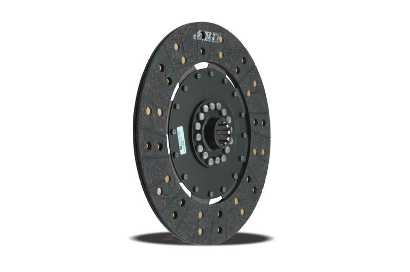

For those of you that want a lighter than sprung hub street disc option but don't want to deal with a puck or you're scared of springs popping out, we also offer a solid hub street disc. The drawbacks are that it will transmit more gear noise in the car because you don't have the springs to dampen torsional vibration and you can expect more decel noise. The benefits are that it weighs approx. 1/2 of what our sprung street disc does which allows for faster shifting and there are no springs to come out.
Since it still has the marcel between the linings(what contributes to the smooth engagement along with the friction material on a organic disc)it's not going to feel like an on/off switch and you shouldn't have to leave intersections at 1500 rpm so you don't stall the car or look like buck rodgers taking off.
Here's what it looks like.
The pic is of an Evo disc but you get the general idea.
Daryl
