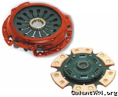

A 6 puck is not hard or violent to drive as a DD. I have a Clutchnet 6 puck and so does Ryan Hertz. I have zero chattering if I rev to 1500 to engage.
We just got Ryan's in a few weeks ago and the very first test drive was very smooth.
A Clutchnet 2X w/sprung 6 puck disc is about $350 shipped. I bet an ACT would be about the same.
Remember, a 6 puck disc can use a lighter pressure plate because it is all about "pounds per square inch". The 6 puck has less surface area so that the PSI of the PP is concentrated.
There is someone on this site that works at ACT, call them up and ask for a GalantVR4 website discount. Can't hurt and they might actually give you a good deal.
But it is my suggestion for a DD that you want to drive "spirited", go with a SPRUNG hub 6 puck and a 2100lb pressure plate.

The heavier PP is desired for max power connection but you may not want to push it in in stop-ngo traffic to long.
The 2100 PP would still hold plenty of power.
But call ACT and ask them what they think. After all, they are the experts /ubbthreads/images/graemlins/grin.gif.
Basicly, a sprung 6 puck is fine for DD. You just have to raise the rpm engagement a few hundred.
DO NOT get a solid hub unless you want a very harsh ride (as a DD).

I understand that, I was planning on a sprung full face. but I was just making sure you meant sprung 6puck, what about the clutches with two friction materials?

Me and a friend have been getting our own clutches made for some time now. Equal to a 2600 or more. Its a heavy duty PP and a 6 puck unsprung hub. I had one in my 363whp sentra, it was a daily driver. A little chatter if you dont engage it right, but not bad at all. I had a similar one made for the galant but i have yet to get the car on the road so i cant comment on how it will act.
Now my sentra was a cable driven clutch, granted it took a strong leg to DD it, the galant being hydraulic i suspect it to act just fine properly driven. Cost of our clutches, 200. CHEAP!
