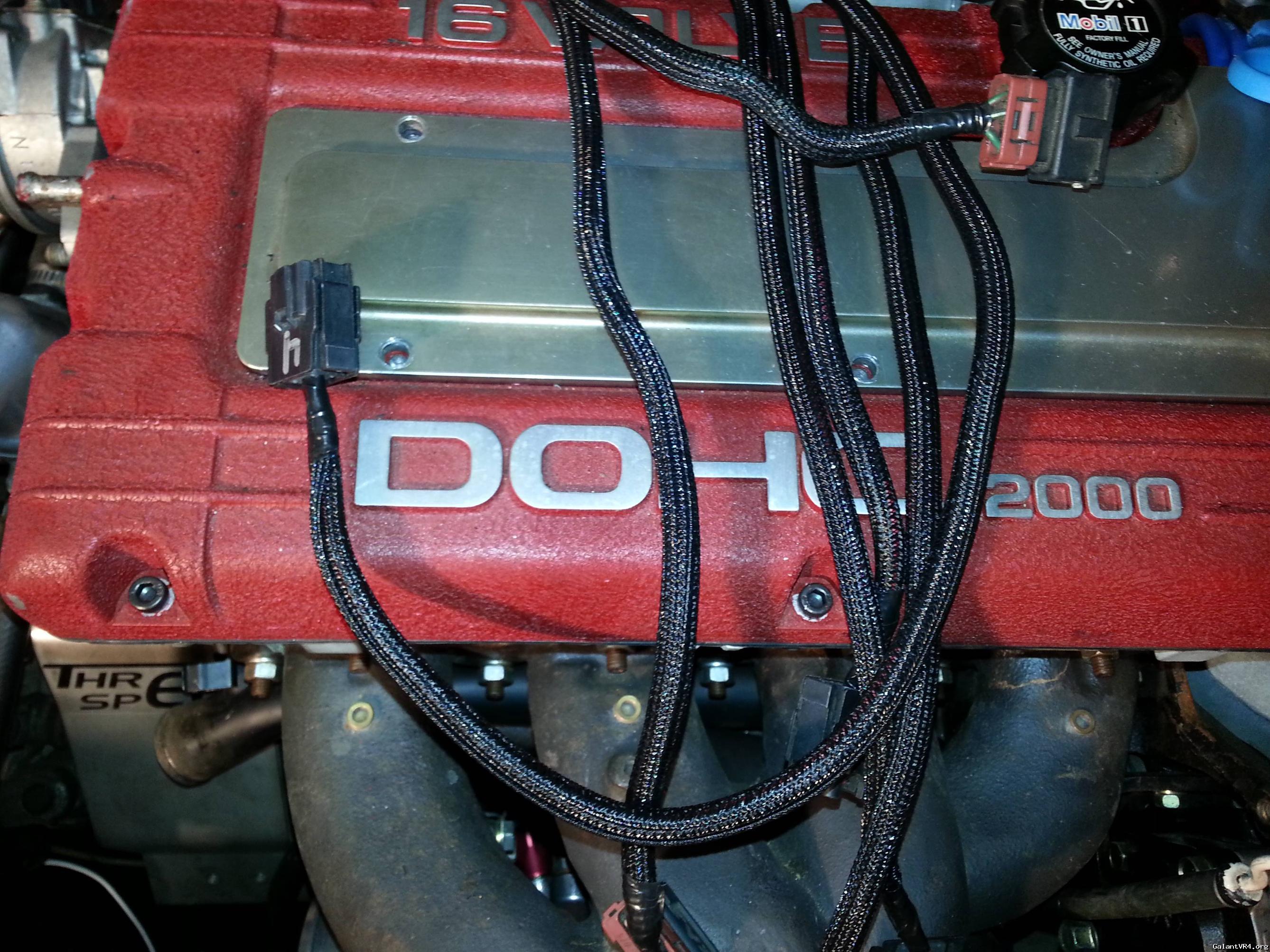

I used TechFlex F6 loom in my car. It's soft to the touch, you can coil it and it won't split apart and drop the wires, and it looks way better.
amazon link though there are many sizes available. On amazon, some vendors are cheaper than others, even with prime, so definitely search around.
I did heat shrink at the ends when I re-did my injector clips.

That looks really good Andrew. I'm basically getting ready to tackle the same project as Brett

The larger the holes in the braided sleeve, the more dirt that will get inside and act like sand paper on your wires.

The weave on this is reasonably tight, but frankly I've put ~300-400 miles on my car since 2007...
