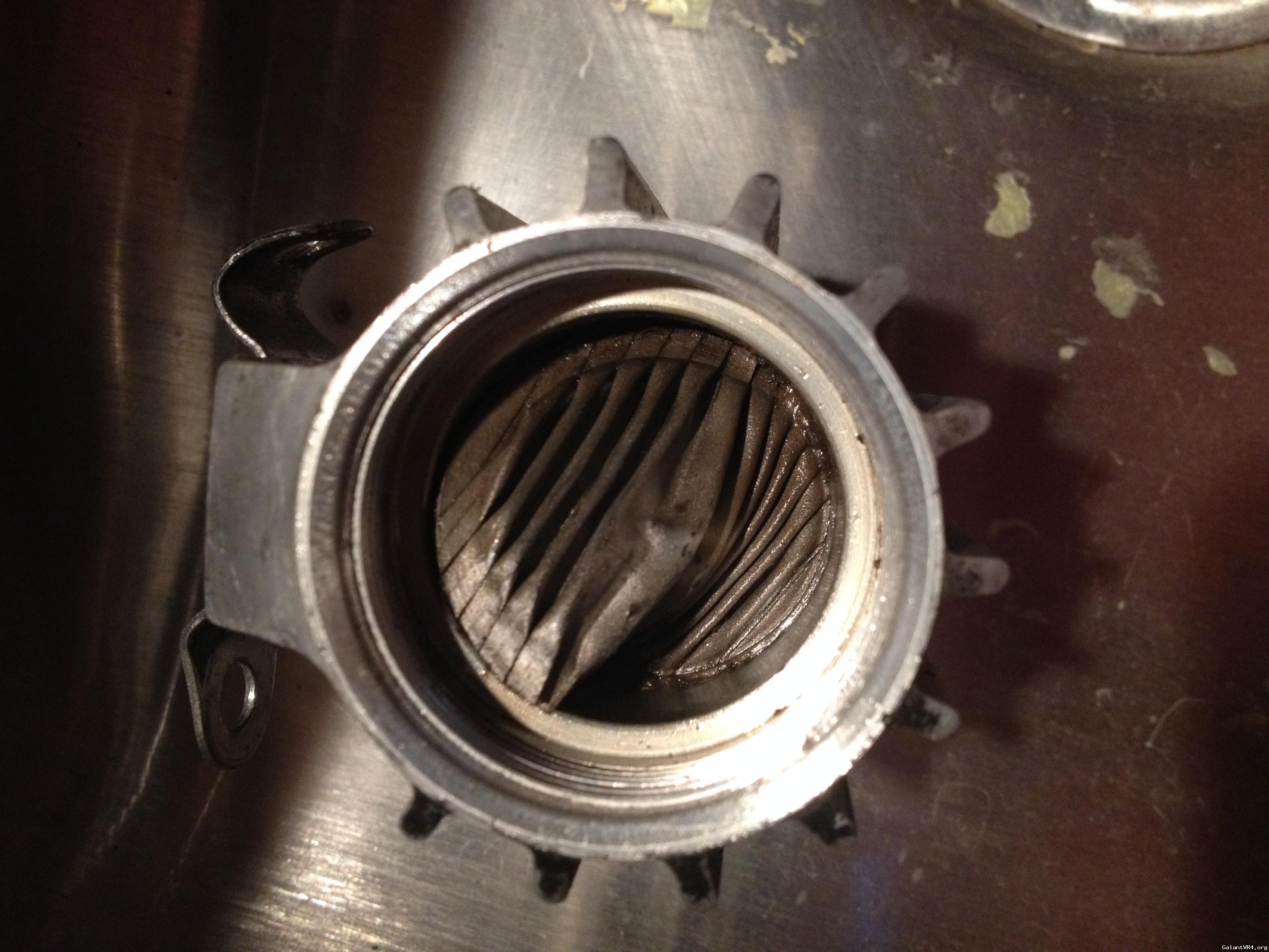

Annnnnd I'm pretty sure I found the problem. This is my fuel filter, I couldn't blow through it so I'm pretty sure I wasn't getting enough fuel to the rail. Which might also explain my white-ish plugs.

Your probably going to have to send your injectors out and have them cleaned. I had the same thing happen to me just not quite as bad. I was at the strip and it started leaning out. Replaced the filter and days later it started to run bad.

Flying eagle, I'm not sure how it's suppose to go in there. I'm pretty sure the filter failed totally. They sell replacement filters for it and they look nothing like this lol
And vr4play, ya I'm pretty sure that's gonna have to happen. I took it around the block and it did the same thing. So my injectors definatley need to cleaned now as well.
When I replaced the filter it was dark out and I didn't see the crap that came out until today. The gas was a dark tanish color when it came out of the old filter. I also found a pretty substantial exhaust leak from the manifold to the turbo. So that can also be part of this issue too. Looks like I have my work cut out for me in this awesome -20 degree weather lol

It looks to be to be internally identical to the Golan fuel filter that I had. The problem was the design. There is not enough area and they clog up very fast and since its pleated it unravels the pleats and blows open letting crap by into your injectors. I would recommend getting a different fuel filter. I switched to a holly paper/gauze type element that is E85 compatible. I would advise something similar as the metal screen filters need more maintenance and are know for failing just like that one.
