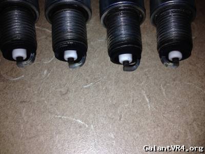

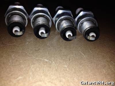

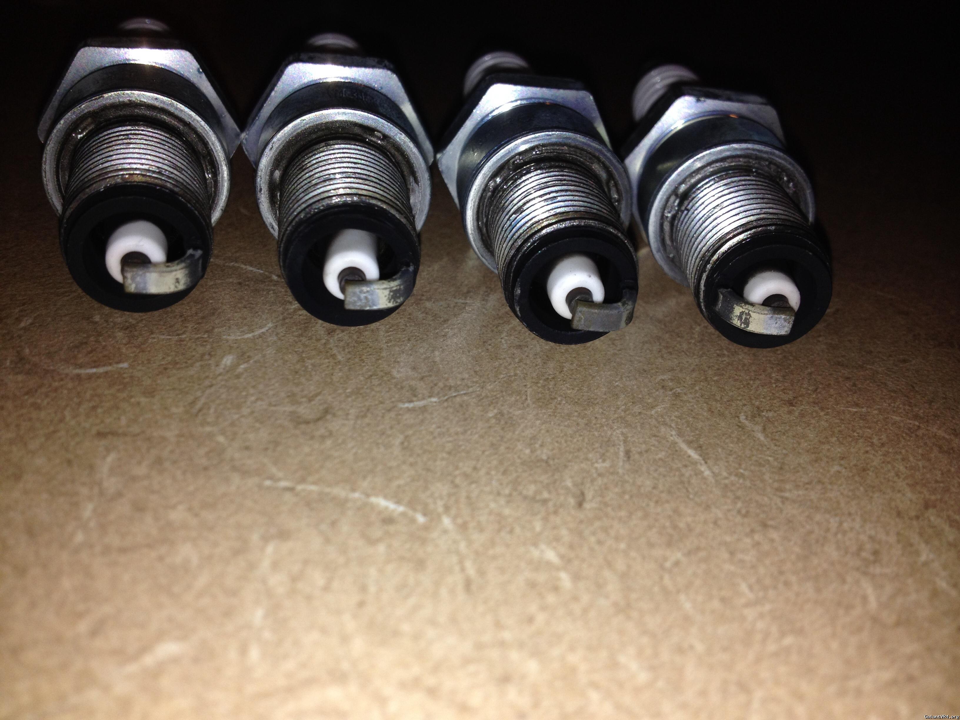

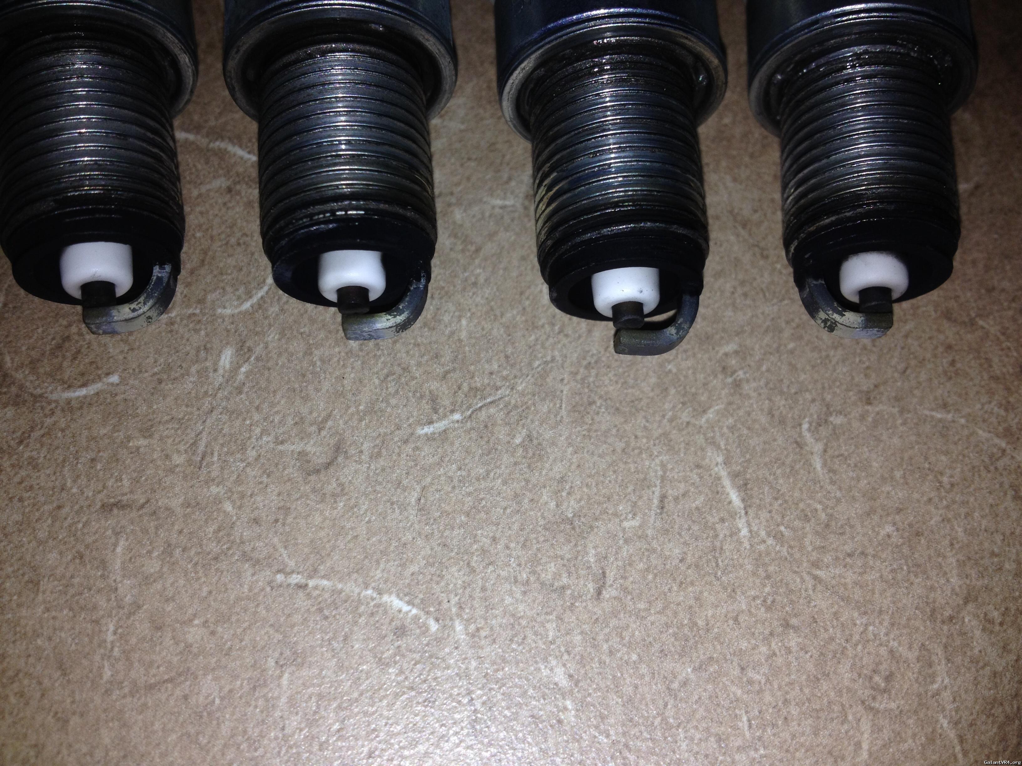

What do the spark plugs look like?
(post a pic! /ubbthreads/images/graemlins/smile.gif )

The maf is what I was thinking as well. Hmmmmmm, I do have an extra coil pack I can swap out, i'll see if that does anything and report back with the results. Ill also take a pic of the plugs and post them up when I get home tonight.

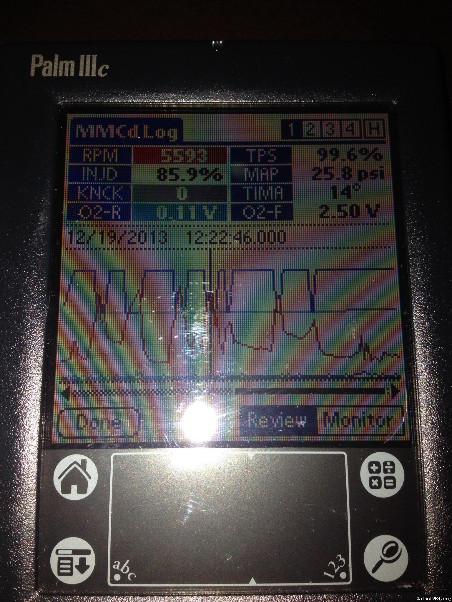

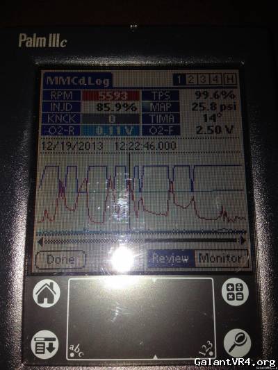

I don't get the O2 issue. It's reading 2.5v again. Also I know your not running 25psi. I think that MAF is off to start.
