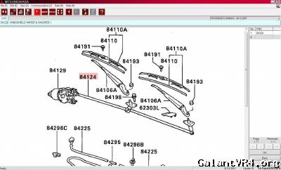

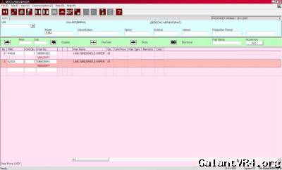

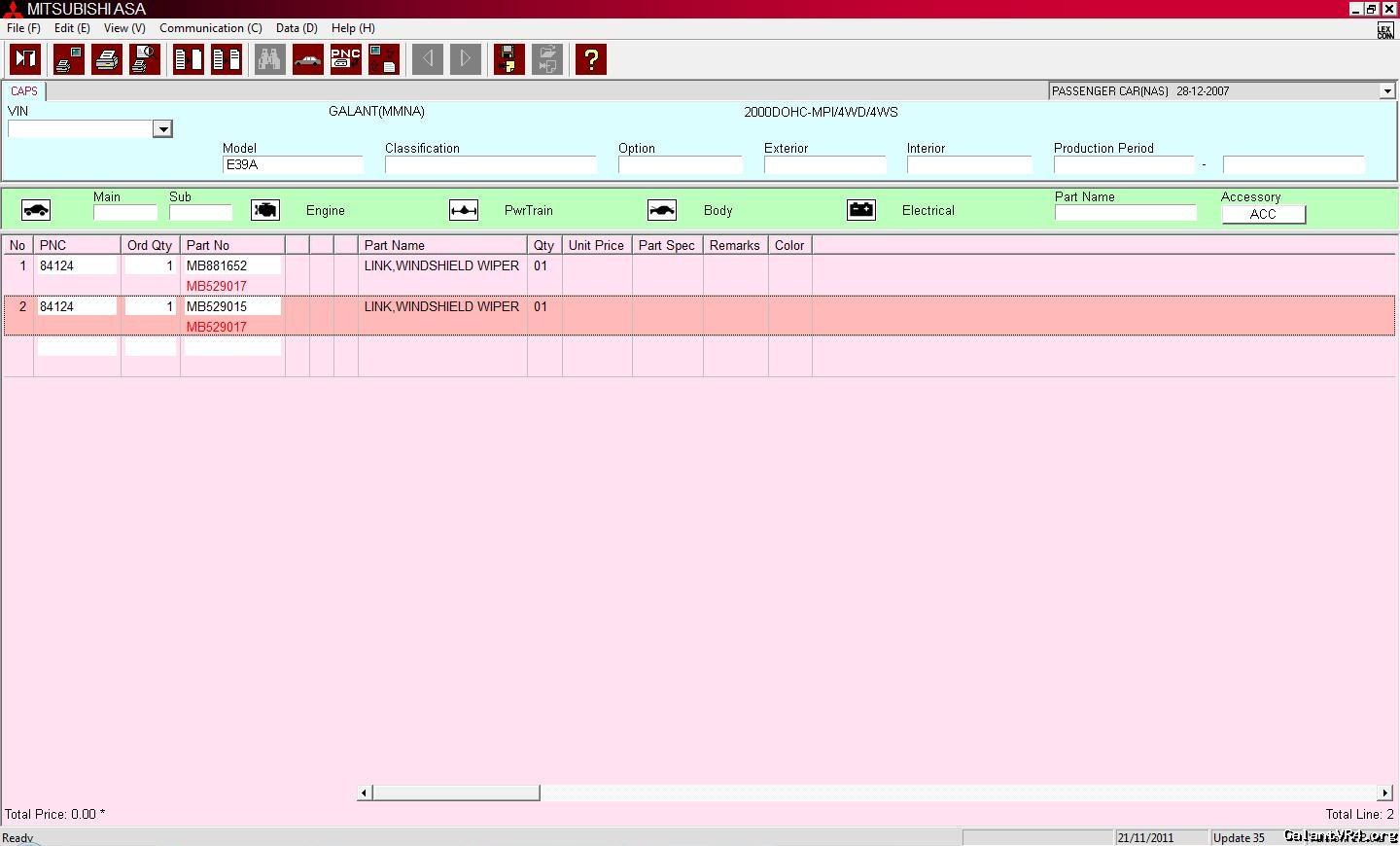

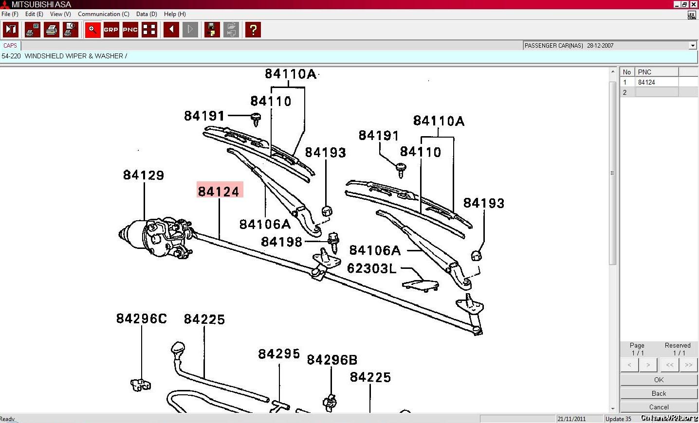

For the link? CAPs shows both of your triangle pieces as one piece connected by a rod.
Top # is for June '1990 - Feb 1991
Bottom # is for March '91 - May 92

Yeah Mitsu only sells wiper transmissions as one assembly. Your not the first person to ask for the individual parts. Montero Sports are famous for popping one arm off and ruining the white plastic grommet/bushing.

Strange that the replacement part, MB529017, doesn't appear to be listed in JAP or NA ASA as used by any vehicle /ubbthreads/images/graemlins/confused.gif
But does correspond to their IPB item #84124 for the 89-92 Galant.
