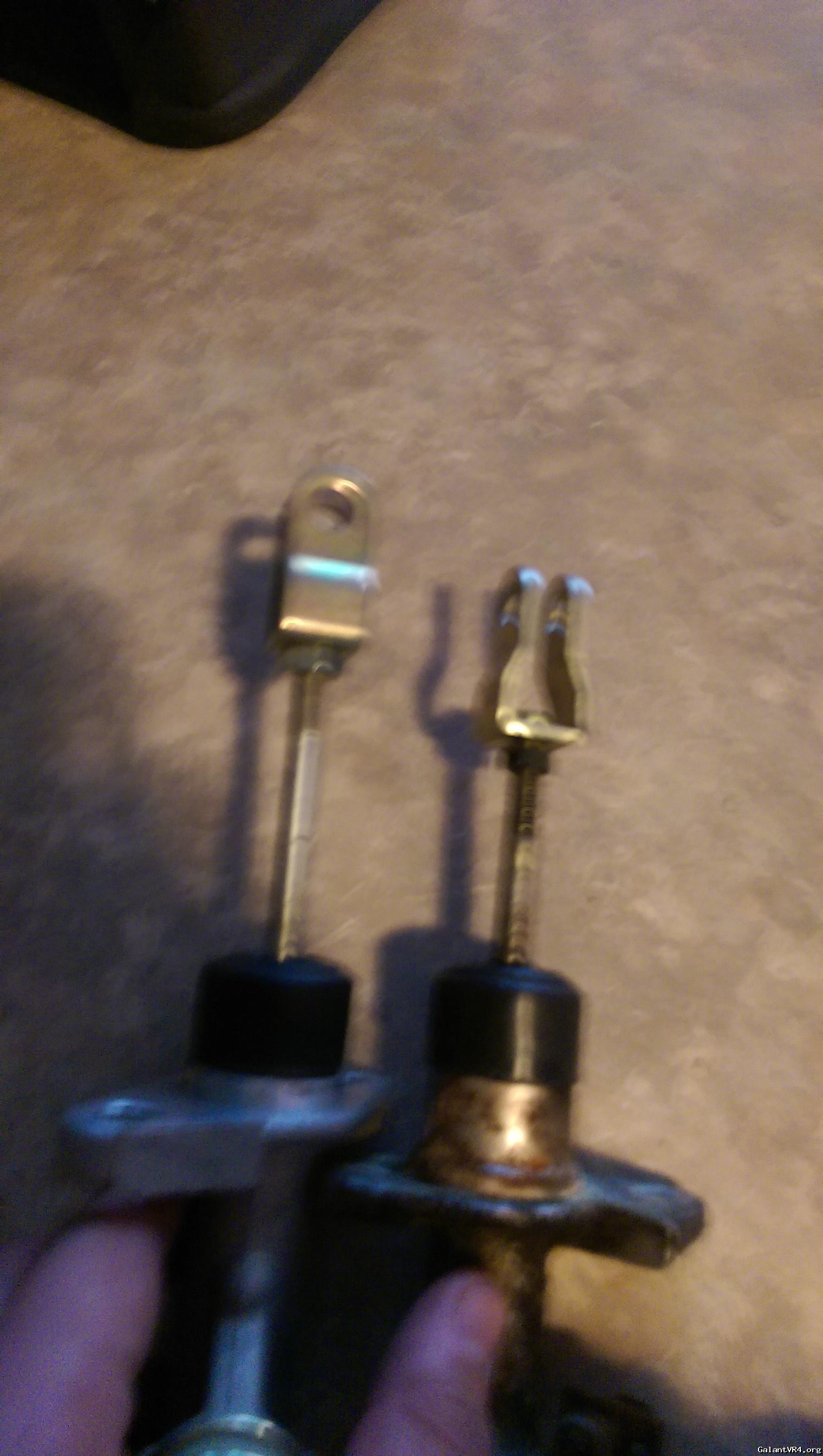

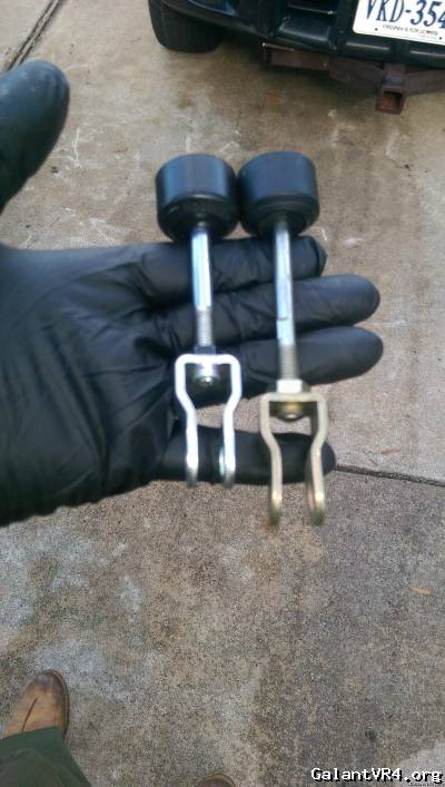

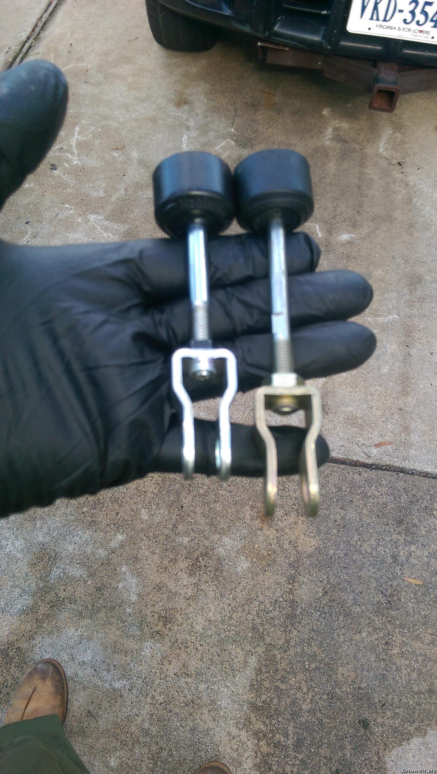

I was able to get my hands on a bad turbo 2g master cylinder. The 2g rod on the left is a lot longer that the stock GVR4 rod on the right.
I'll mess with on Friday.

I was able to swap in the 2g clutch master cylinder push rod yesterday, and the result was being able to shift into gear very smoothly. I only drove the car up and down the driveway. I still need to preform Jack's Transmission clutch drag test, however I need to work out the vacuum leaks and fix some wiring before I start all of that.
