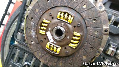

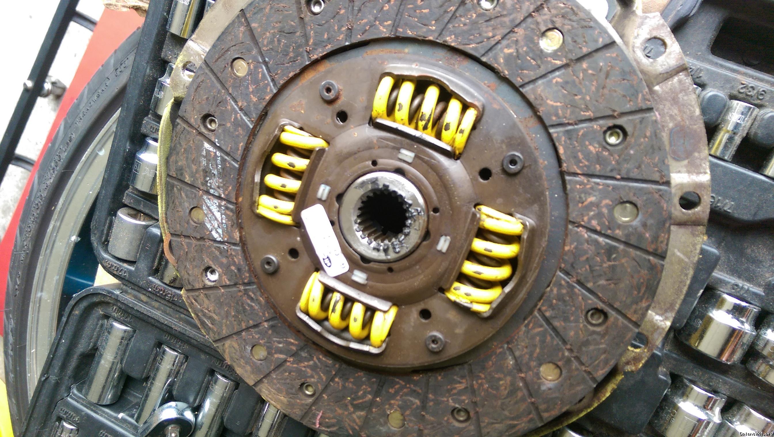

1) Gear shift malfunction Excessive clutch pedal play: Adjust (Done, found worn clutch pedal level, rebuilt clutch pedal assembly, Still have issue )
2) Distorted clutch disc, excessive oscillation: Replace (New part, Checks good )
3) Clutch cover assembly worn: Replace (New part, Checks good)
4) Clutch disc spline worn or corroded: Replace (New part, Checks good)
5) Clutch disc facing peeling: Replace (New part, Checks good)
6) Clutch release bearing worn: Replace (New part, Checks good)
7) Damaged pressure plate: Replace (New part, Checks good)
8) Damaged pressure flywheel: Replace (Swapped out flywheel's, still have issue )
9) Leakage, air mix or clogging of hydraulic system Repair or replace parts (Replaced 10 year old slave cylinder with a working one from a '91 TSi AWD. Was unable to determine bore size Slave cylinder that I got from a '91 TSi AWD so I replaced it with a new OEM one. Still have issue. Ordered clutch master)

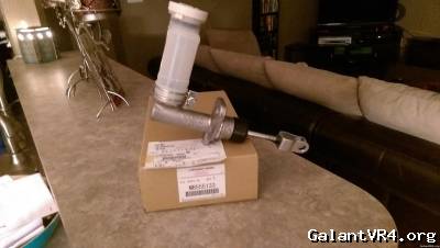

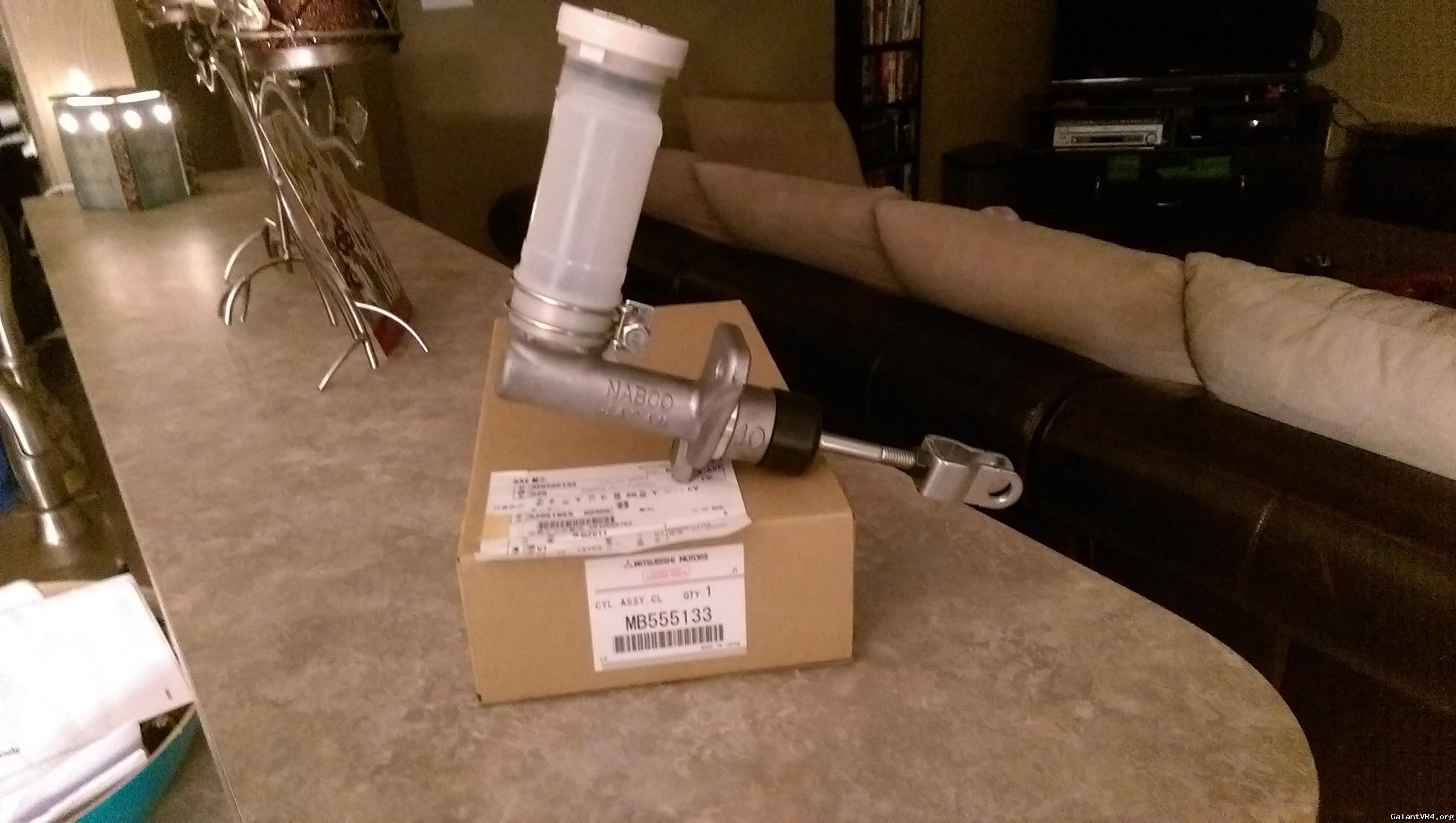

Fresh from JNZ.
Not sure when I'm goinr to have time to install this and test it out with Hurricane Joaquin heading straight for my area. I need this weekend to prepare just in case.
citymunky
Sep 22, 2010
1,761
Chesapeake, VA
So I installed the clutch master cylinder yesterday night. I bled the system today with the addition step of pushing in the clutch fork to fully compress the clutch while the bleeder screw was open. Closing the screw before releasing the fork and pedal.
Started the car and again with the car JSB I was able to get the car into gear. So installed the transfer case and the front tires and tried again. Good to go, I was still able to get the car in gear with while JSB. I button everything up a d drop the car on the ground and I was able to get in 1st. It was a little notchly and have I was actually driving out into the drive way. I drove around the block however shifting was not easy as it should have been, either my clutch is still not adjusted right yet or the synchros are trashed.
