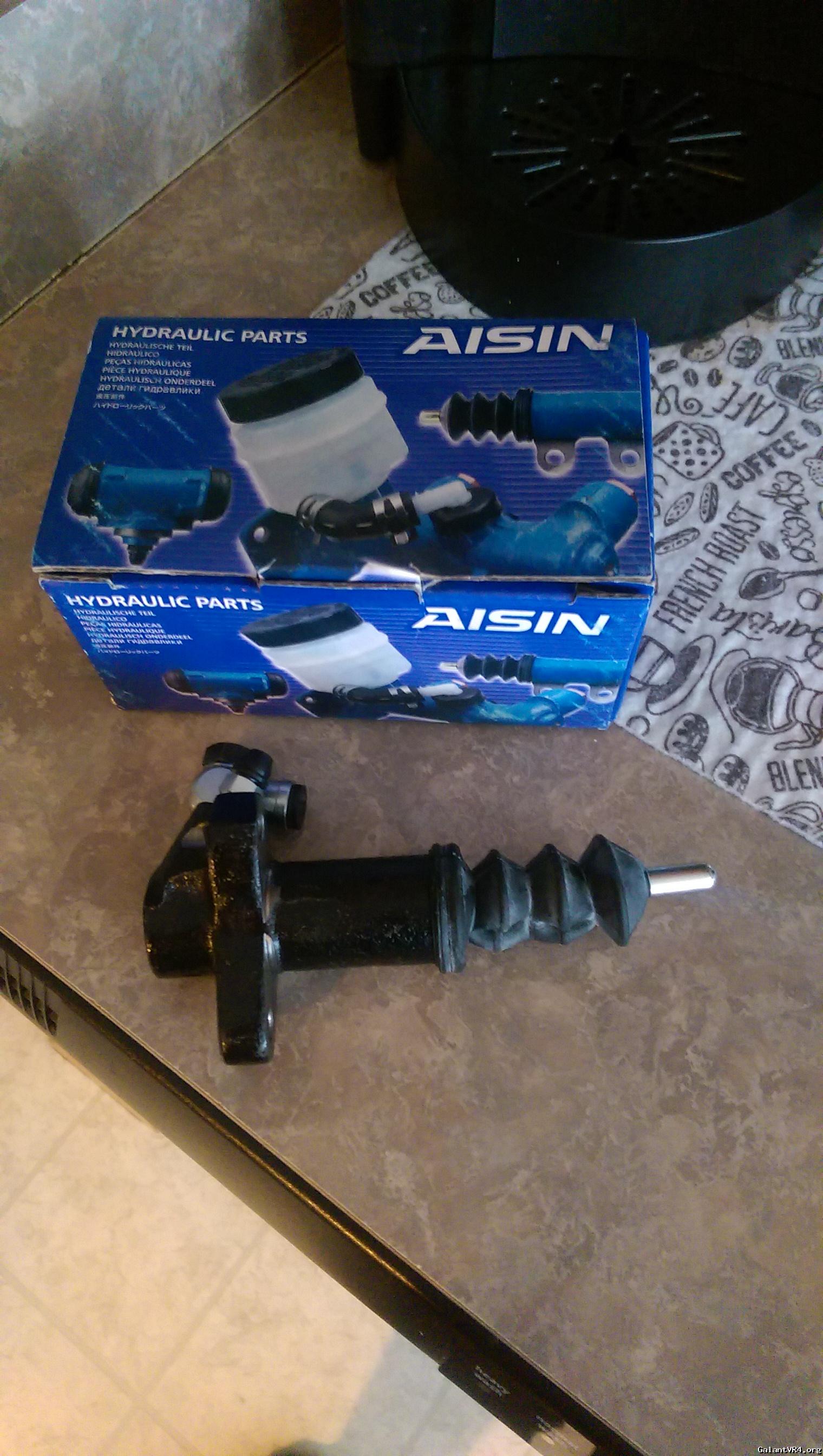

As for now I got my hands on Aisin (Mitsubishi OE supplier) Slave Cylinder with a 3/4" bore.I started installing today but it started to storm. Still need to bolt it in and bleed it.

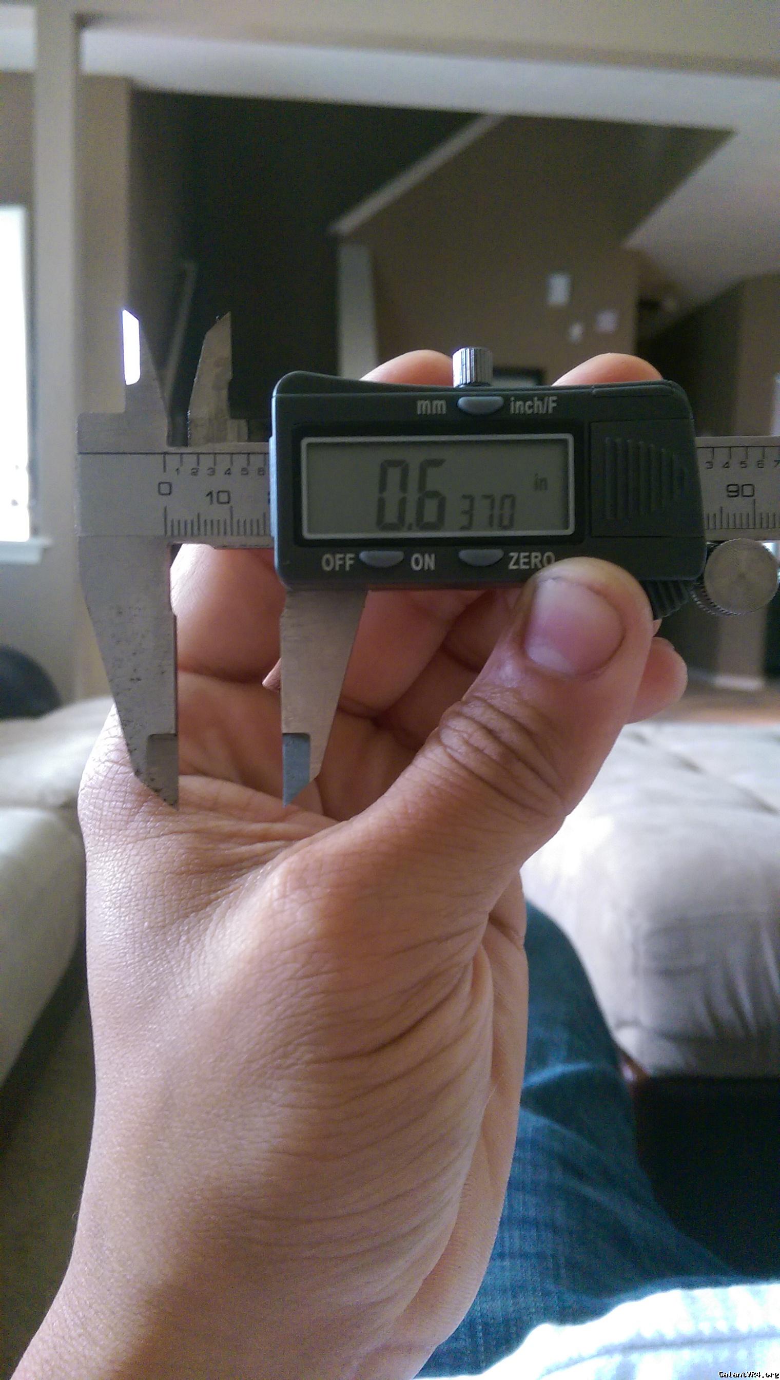

I know this is not the most ideal tool to measure the flywheel step however this is what the step is reading on my resurfaced flywheel.
I'm unsure what to do for my next step. The Fidanza Fly wheel I have in there at 1st is reading 0.610" on the other edges, and that is the flywheel I have in there to begin with before I replaced the slave cylinder.
My buddy has a freshly resurfaced flywheel with the proper step for sale. However I'm not sure if I should try it, since the Fidanza had the proper step.
I'm thinking about shimmering the pivot ball with one washer since the transmission is out? However with the transmission installed the fork is dead centered, so I'm unsure if I can do more harm then good if I shim a new pivot ball.

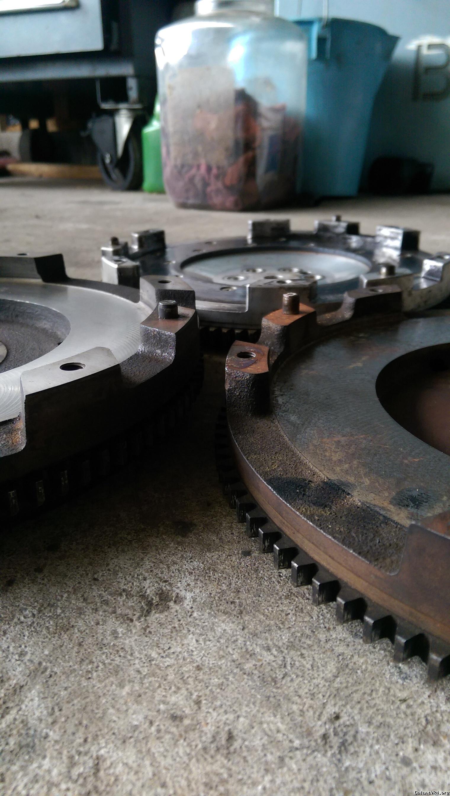

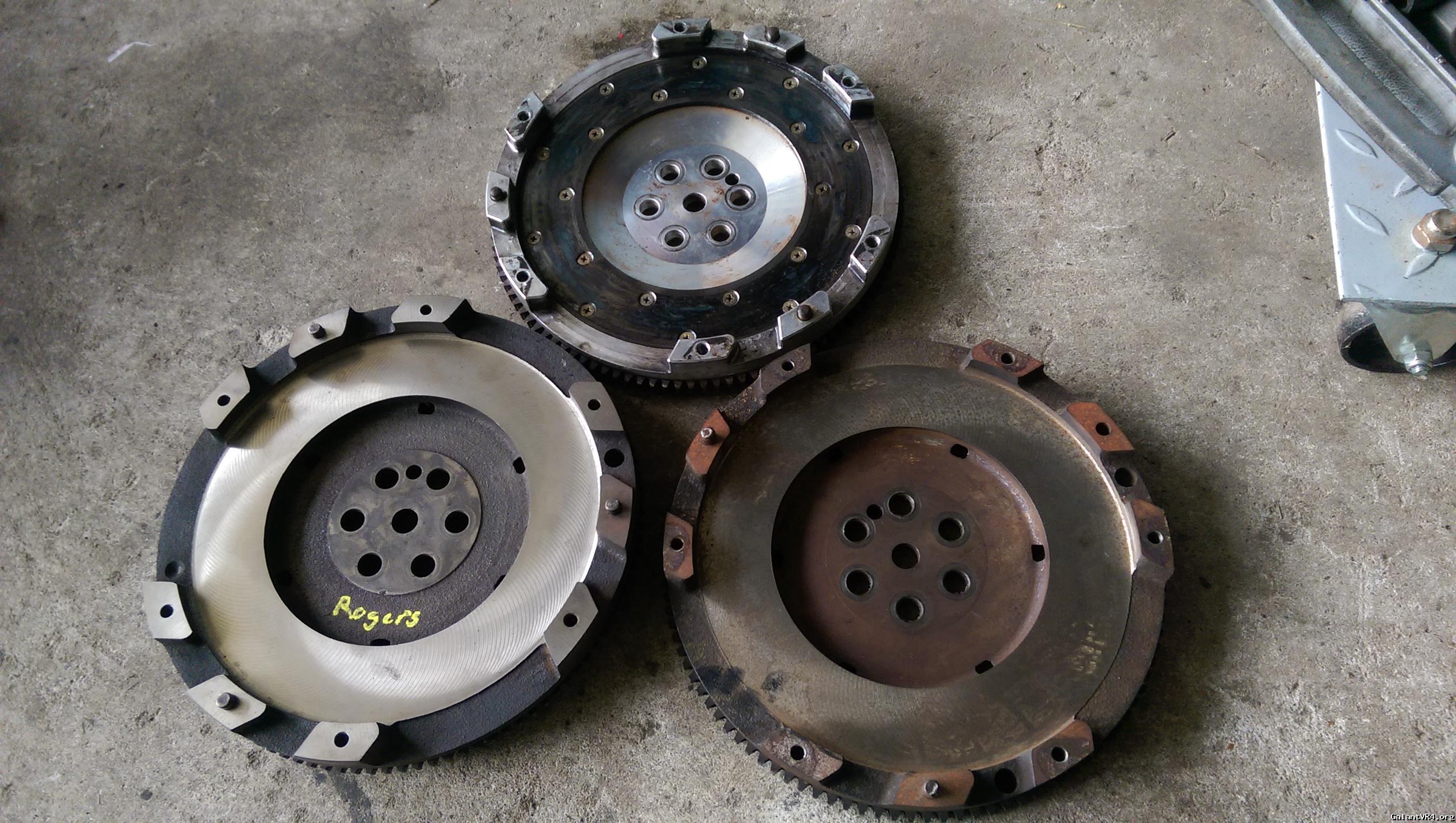

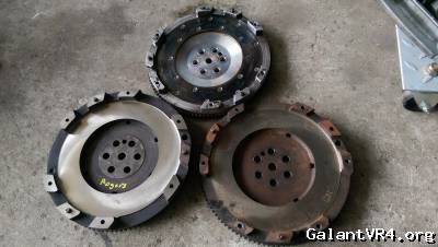

Here are the flywheel differences.
The top is the Findanza
To the left is a stock flywheel that I just pick up. (0.610 step)
To the right is right is the lighten flywheel wheel with the fucked step.
