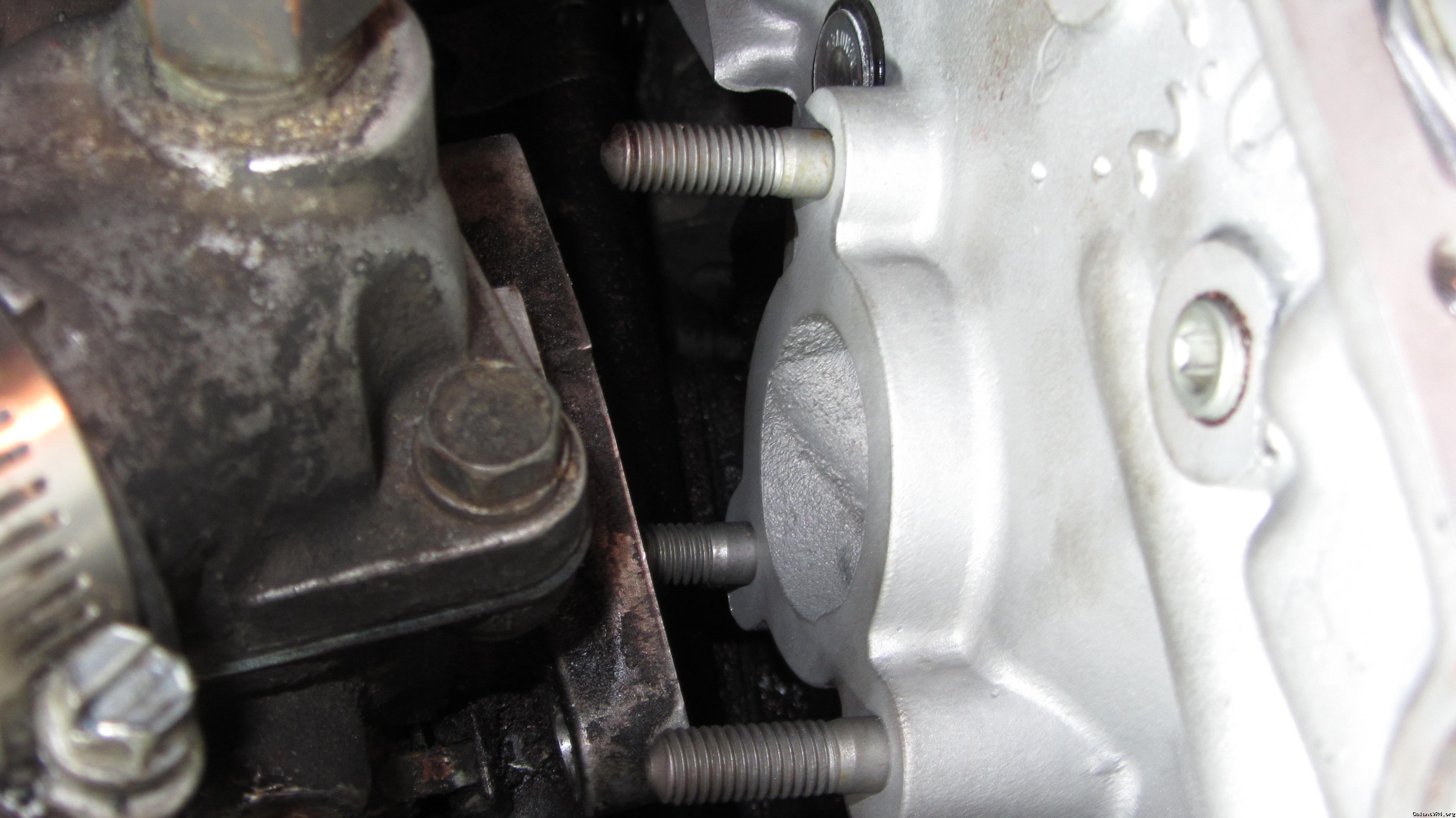

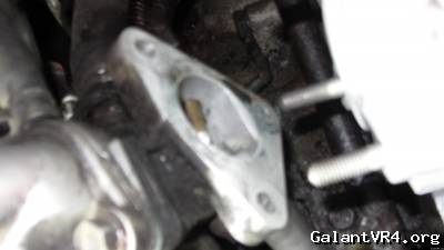

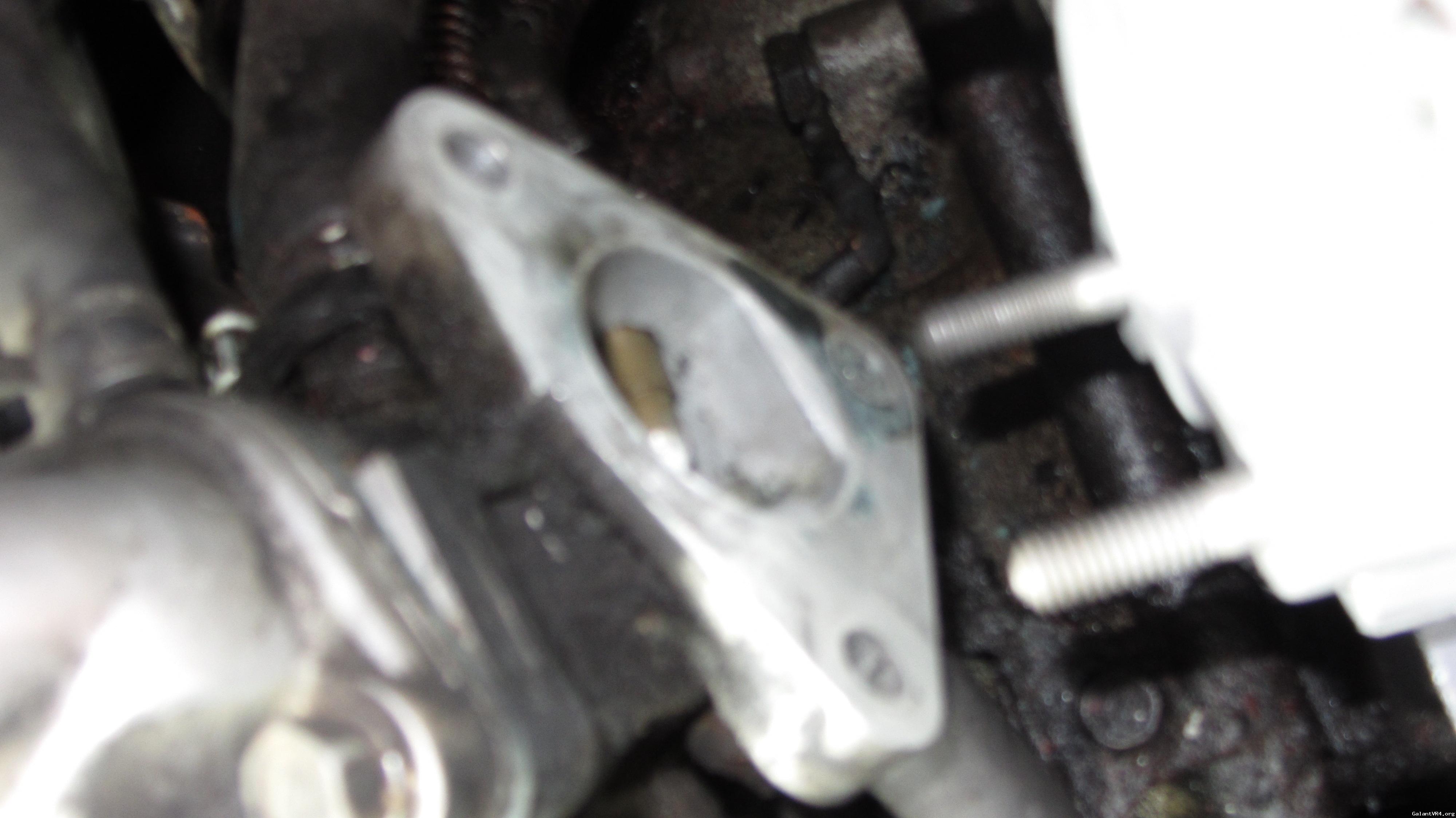

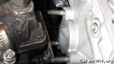

I think I'll just use the gasket this time. If I could install it on the head out of the car, maybe, but I don't think I could get a good bead of sealant with the tight space and angle of everything.
At the time, it seemed easier to remove three bolts then all the coolant lines. I had no ideal the gasket was kind of rare.
DynastyLCD
May 12, 2006
761
Harwinton, CT
^^^ one awesome way to do this - clean out the recessed ring around the thermostat housing, and lay your bead of RTV in there.
as long as you use quality stuff, you'll be just fine. if just using a gasket, i recommend some spray-tack to go along with it to be safe
May 4, 2003
11,892
Clarksville TN
Do not over torque the bolts ....you will crack the housing...probably welded and repaired 10 of those things over the years.
