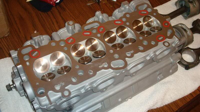

The OEM Mitsu MLS head gasket I ordered seems to line up fine but blocks off alot of cooling passages. The head in question is a 2G head and the Gasket claims to fit 90-99.
I have circled the holes that get blocked off by the gasket.

Blocking off these cooling passages isnt going to hurt anything, is it?

These holes are going to block off the passages in the head. My block doesn't have these passage either. Blocking off these passages on a 2G head, is this going to cause any issue with cooling circulation?

Well the thing is, my 6bolt head doesn't have the passages so there is no coolant passages that run there.
Forget the gasket issue. Swapping a 2G head onto a 6bolt block should be a straight shot other than enlarging the bolt holes 1mm but will I have any cooling issues with the 2G head having passages and the 1G block doesn't?
Now bringing the gasket issue back up... lets say someone were to run a Mitsu MLS gasket on a 7 bolt motor with a 7 bolt head. What happens when they block off the cooling passages on that motor with this head gasket???

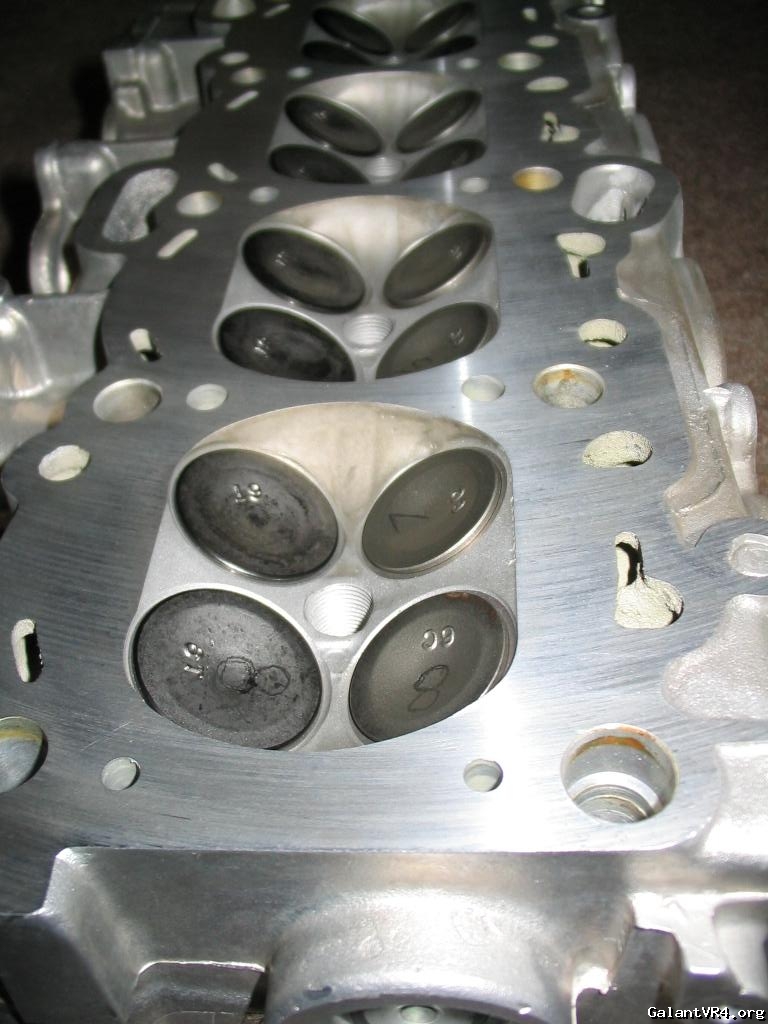

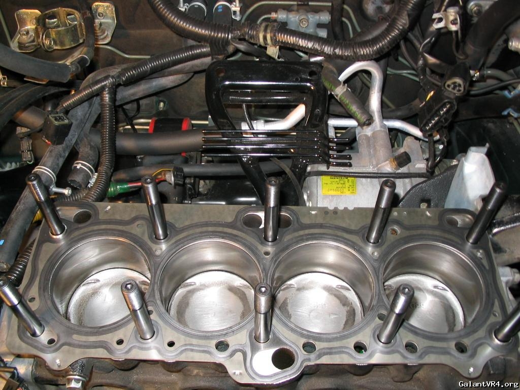

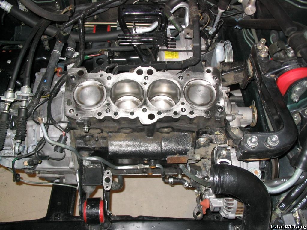

11,983
I just dug up some old pics from when I pulled the head off 1051 and had it redone. My head has those passages, my block doesn't. I run an MLS gasket and have no issues.
These pics are from 2003 and the car is still running fine. Never had a cooling issue.
