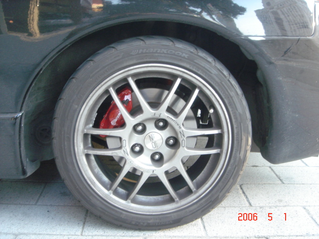

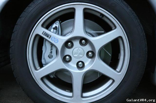

A 7.5" wide wheel will not clear the calipers. I could be wrong but that's a .5" difference ~13mm.
it will as long as the offset is correct. If you look at the link I posted there is a pic of a 2G eclipse with brembos and Evo V wheels. They are the same OZ wheels that came on the 99' GS 10th anniversary. But they are 17x7.5.

they were further than page one.
"This is the EVO5 wheel on my car. It's 17 * 7.5 and off set is +38."
