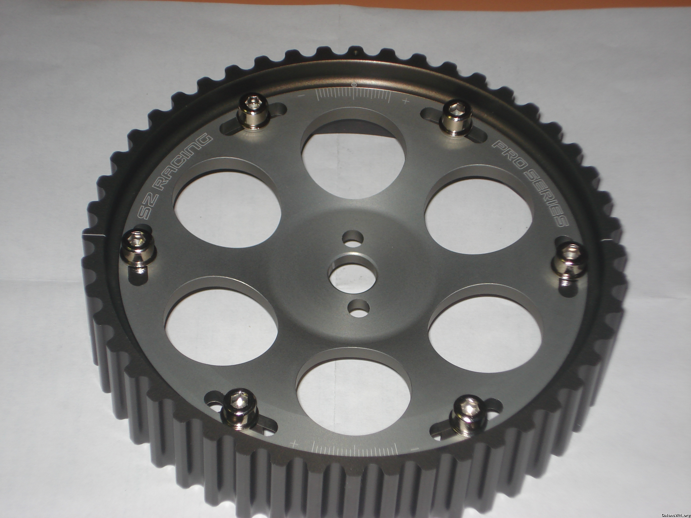

The items are the same, but the timing marks on the intake cam will not line up (I believe the Evo is 90 or 180 degrees off, and the gears are off to match). The exhaust cam gear should line up just fine.
However, if you intend to degree the cams in, it won't matter - you can do a rough measurement to get it in the right orientation and then make your own marks with the gear set at zero. Then finish degreeing in the intake cam with the gear.

The dowels on the camshaft sits at 12oclock correct?
I've basically lined mine up so that the dowel points up and marked the cam gear on the sides (3oclock and 9oclock) and lined them up to suit.
This should be sufficient correct?

the marks on the vr4 cam gears aren't at exactly 3 and 9 o'clock, I think the 3 is more of a 2.58 (get a straight edge and have a look)

I bought them from techsport, they are some Aussie brand but look like tomei's. They are designed for a 4-8.
I just lined up the dowel to the stock ones and remarked the cam gear which is 1 tooth off to the left of the original mark. So I just lined up the new zero markings with the stock and new cam gears and marked the side markings. Looks a bit funny when you look it at, but it'll work. I'll punch the new markings in permanantly.
