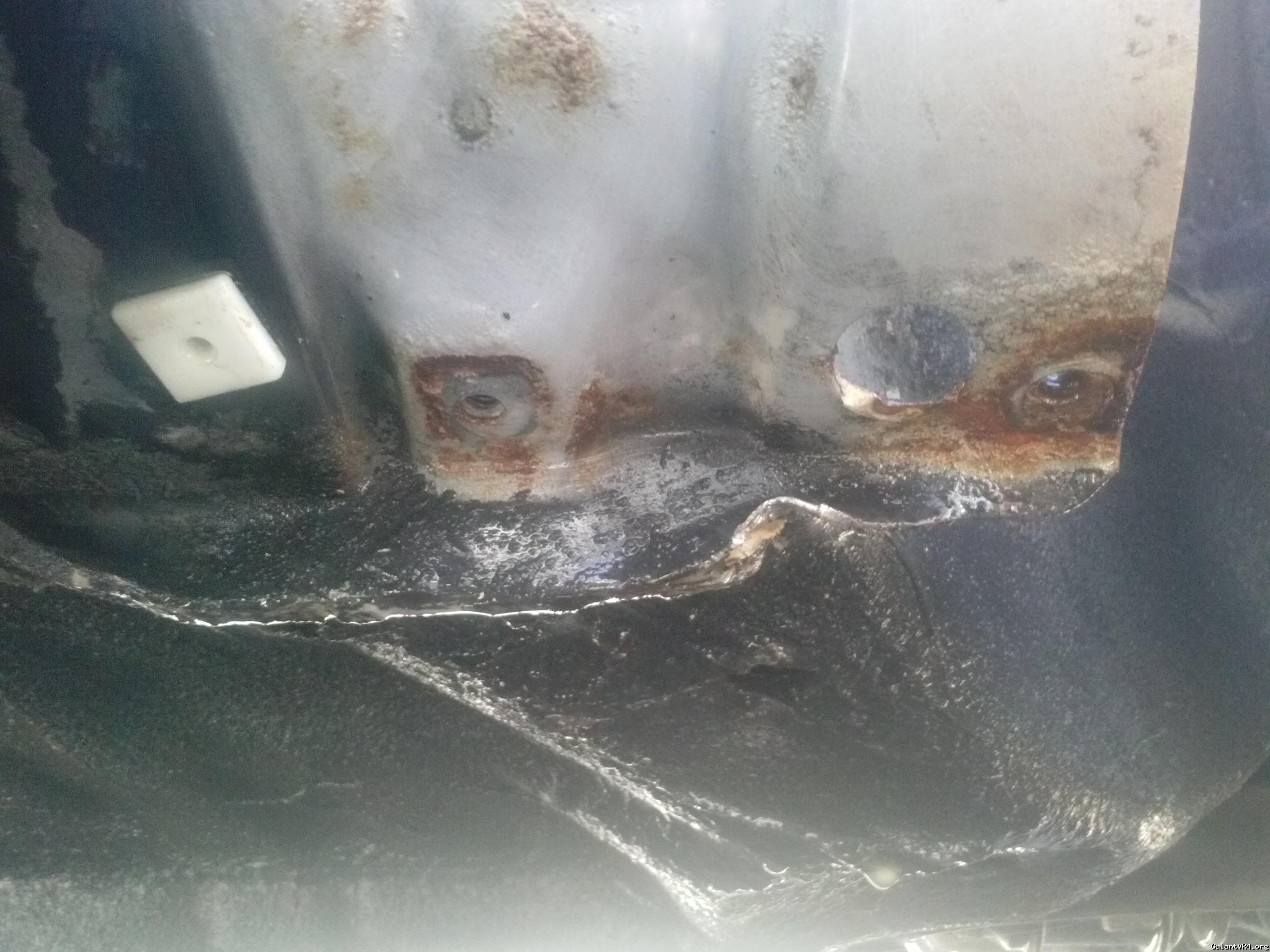

So this is about the only rust I found on the entire vehicle so far

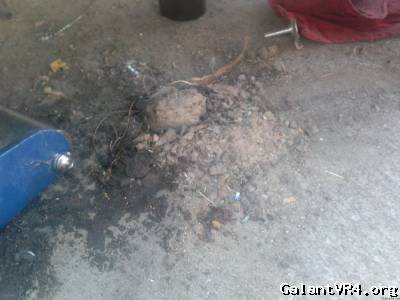

All this dirt was stuck under the fender.

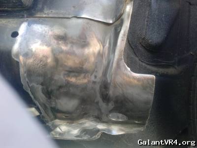

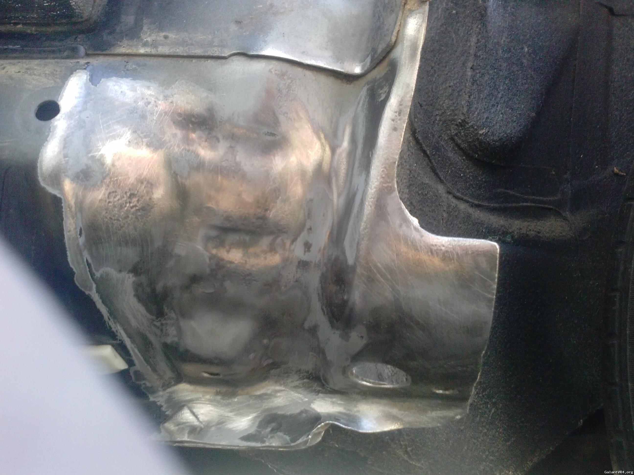

Sanded it down luckly it was only minor surface rust.

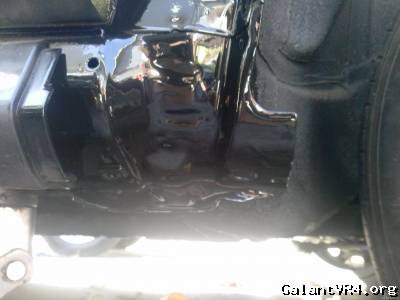

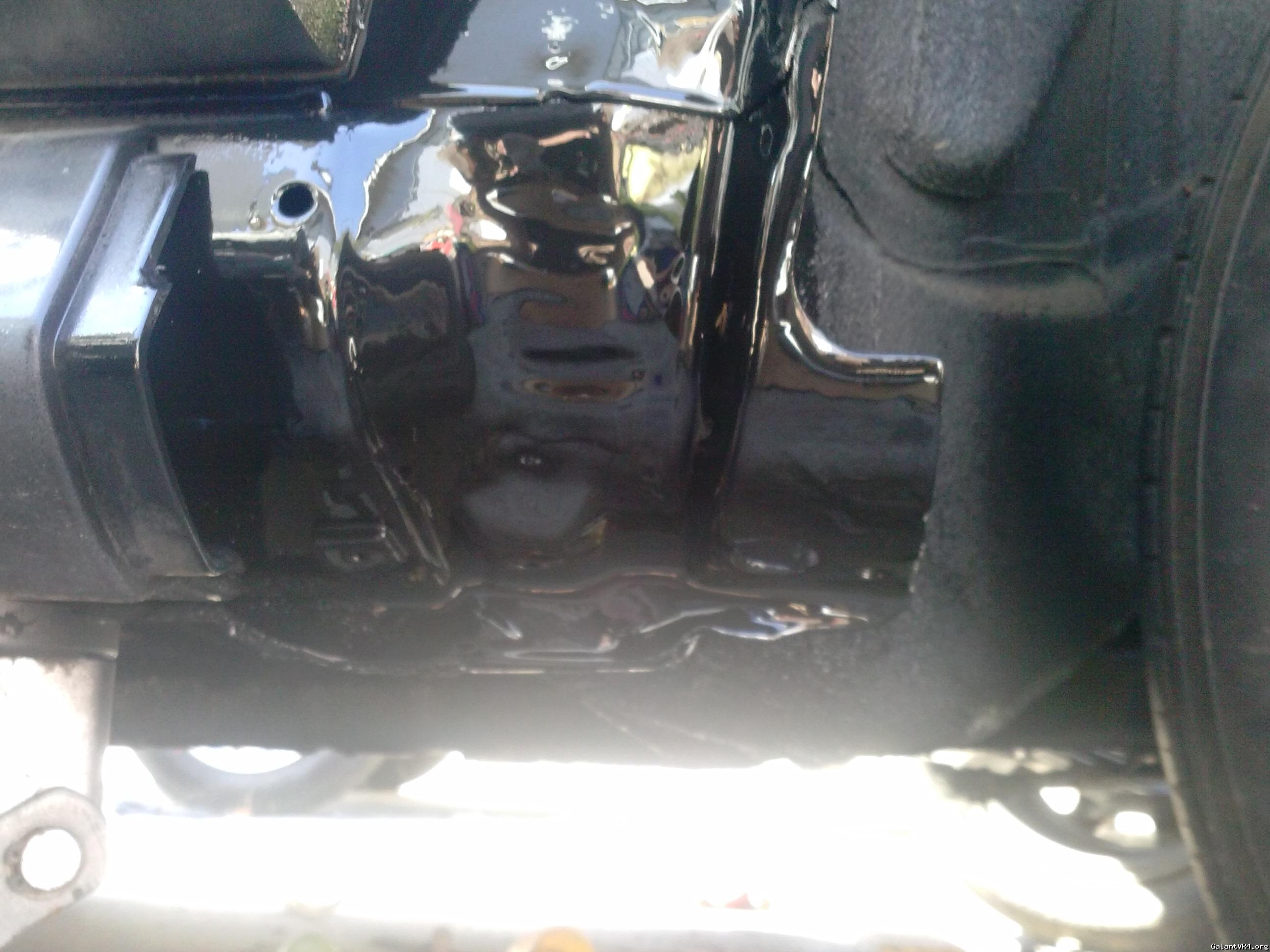

Sprayed some anti-corrosion paint on it.

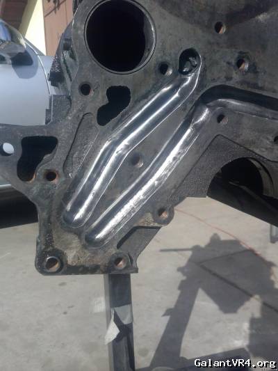

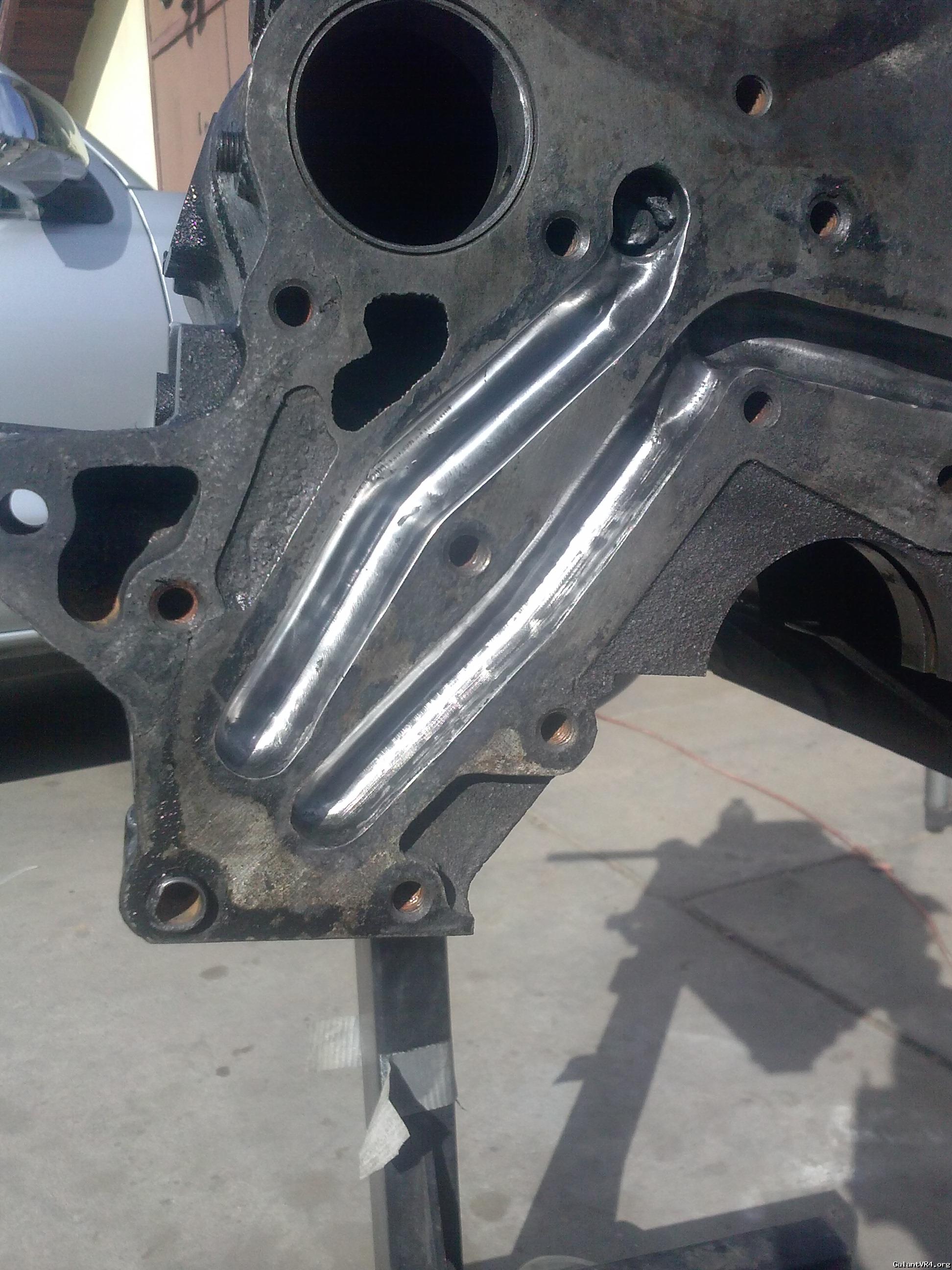

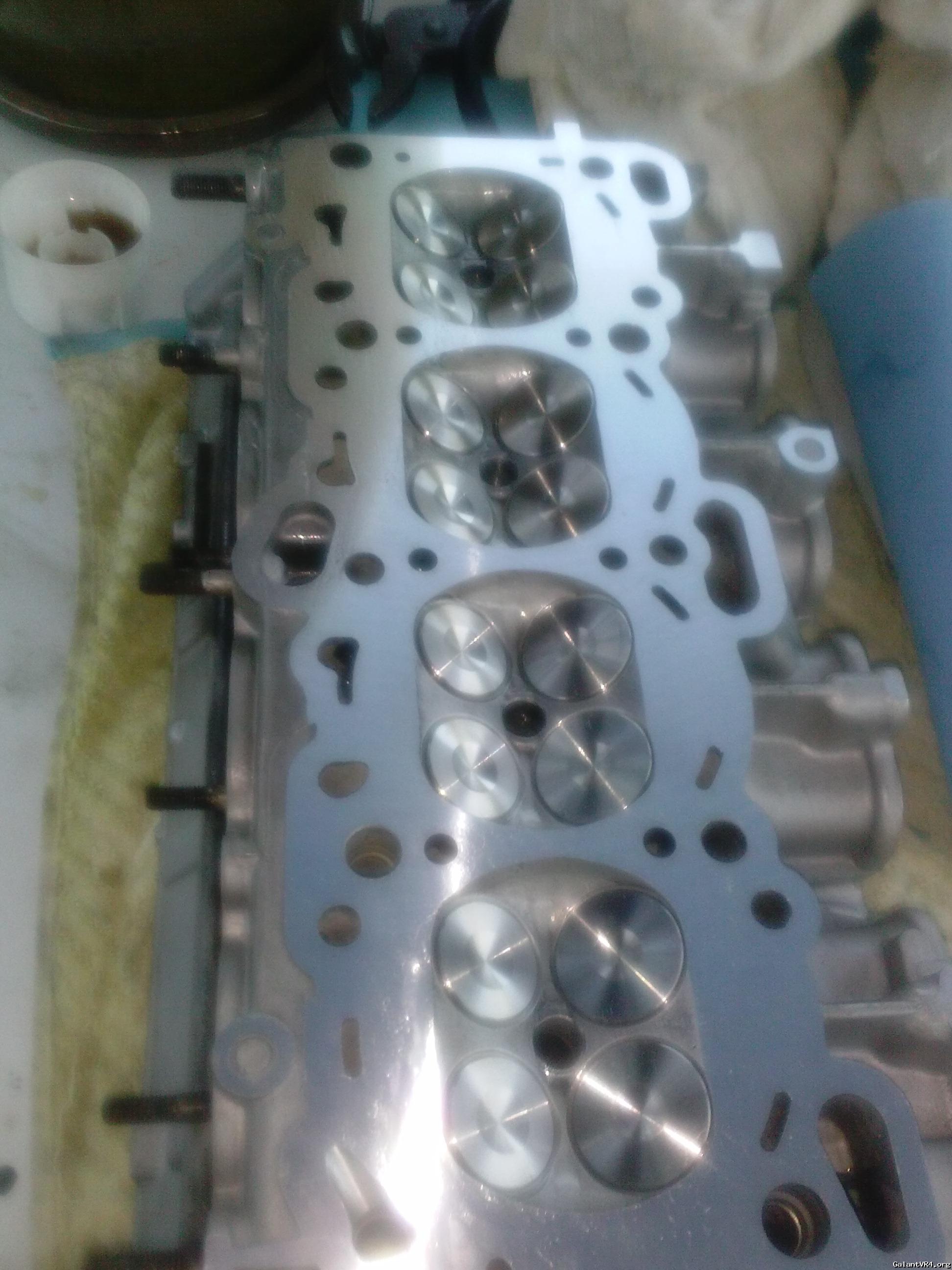

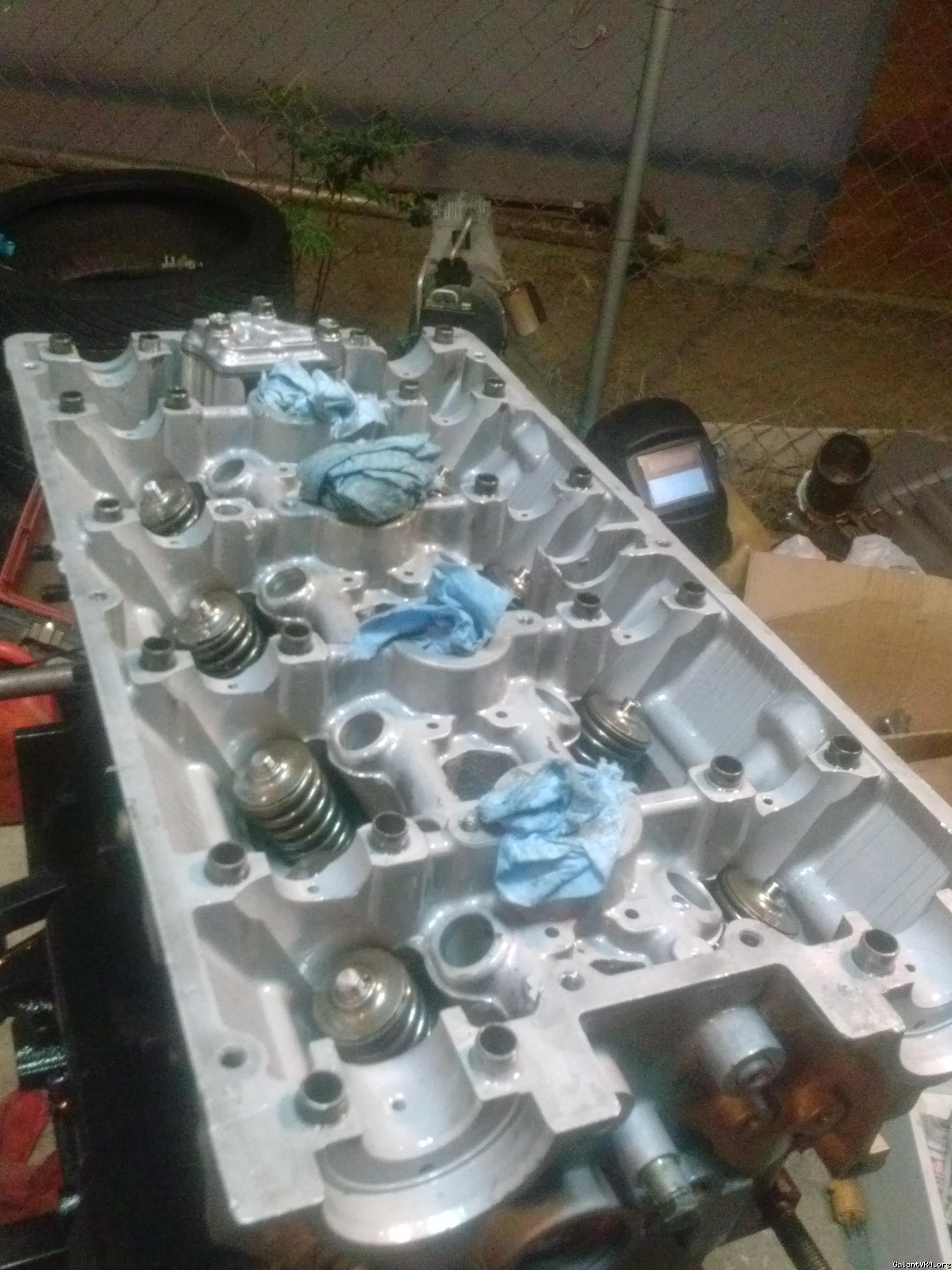

Did the oil galley mod.

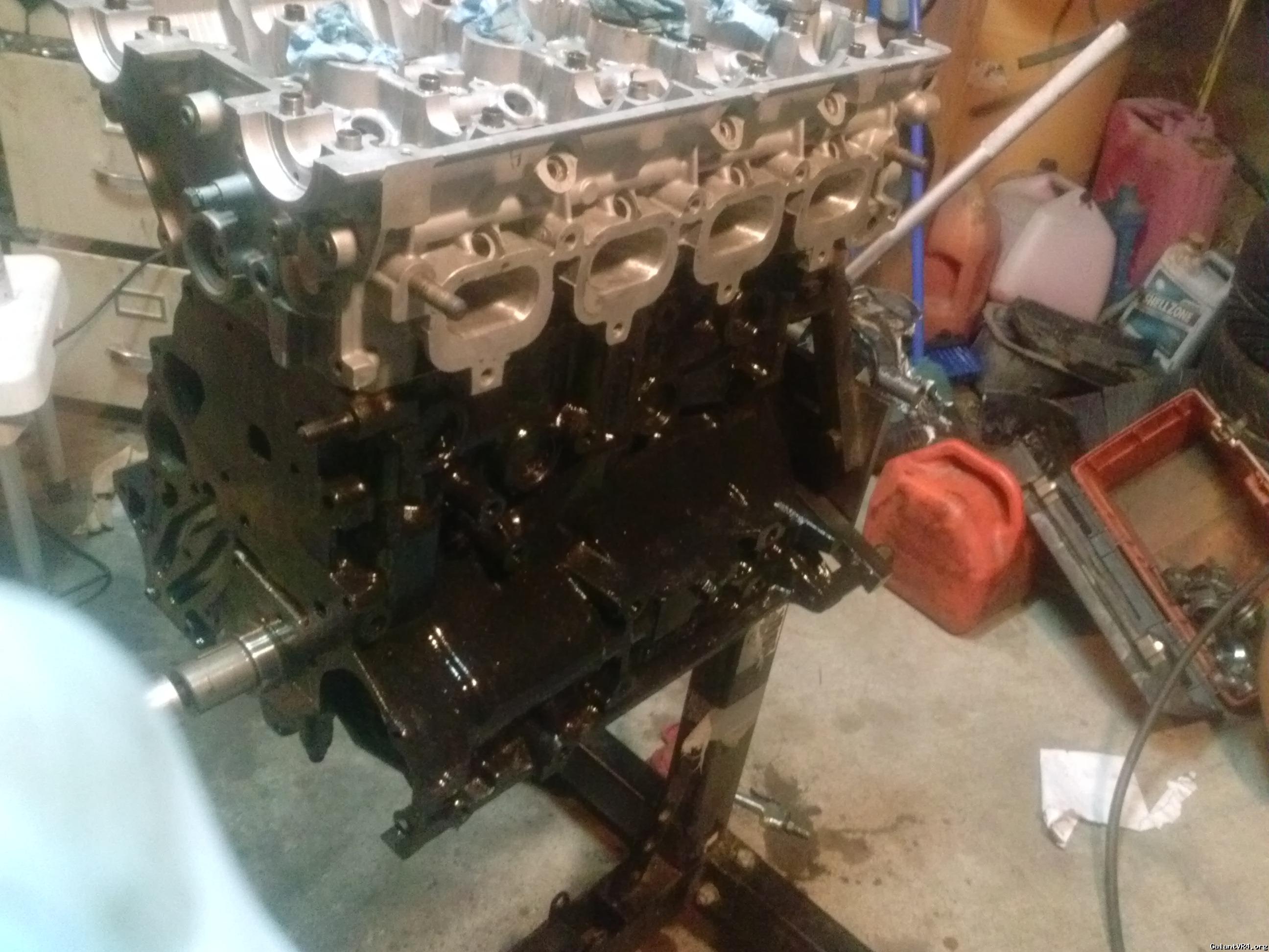

2G head minor port and polish ,3 angle valve job,Stainless Steel valves,oil port mod ,diamond cut resurface ,new valve stems,stock valve springs for now.

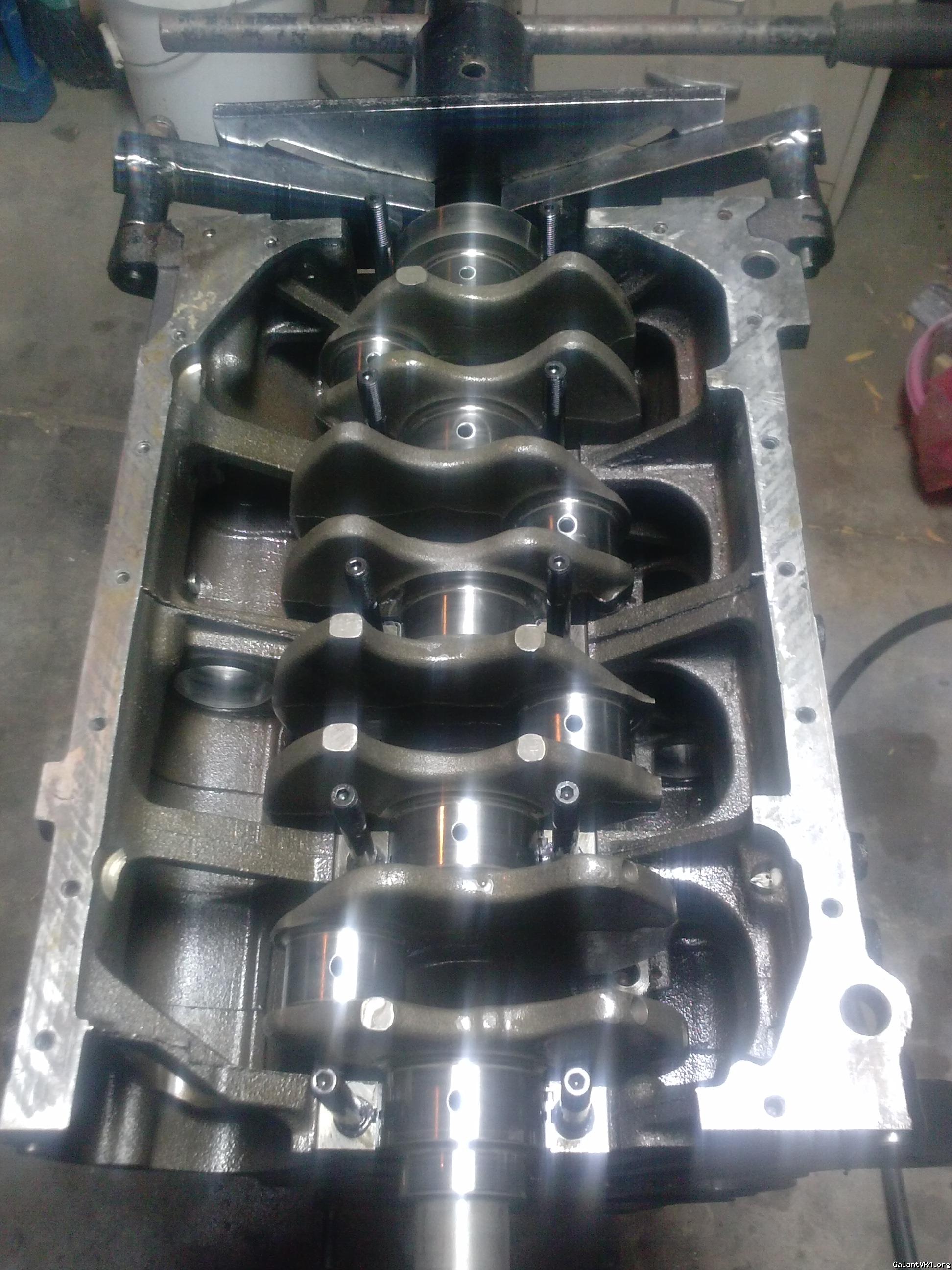

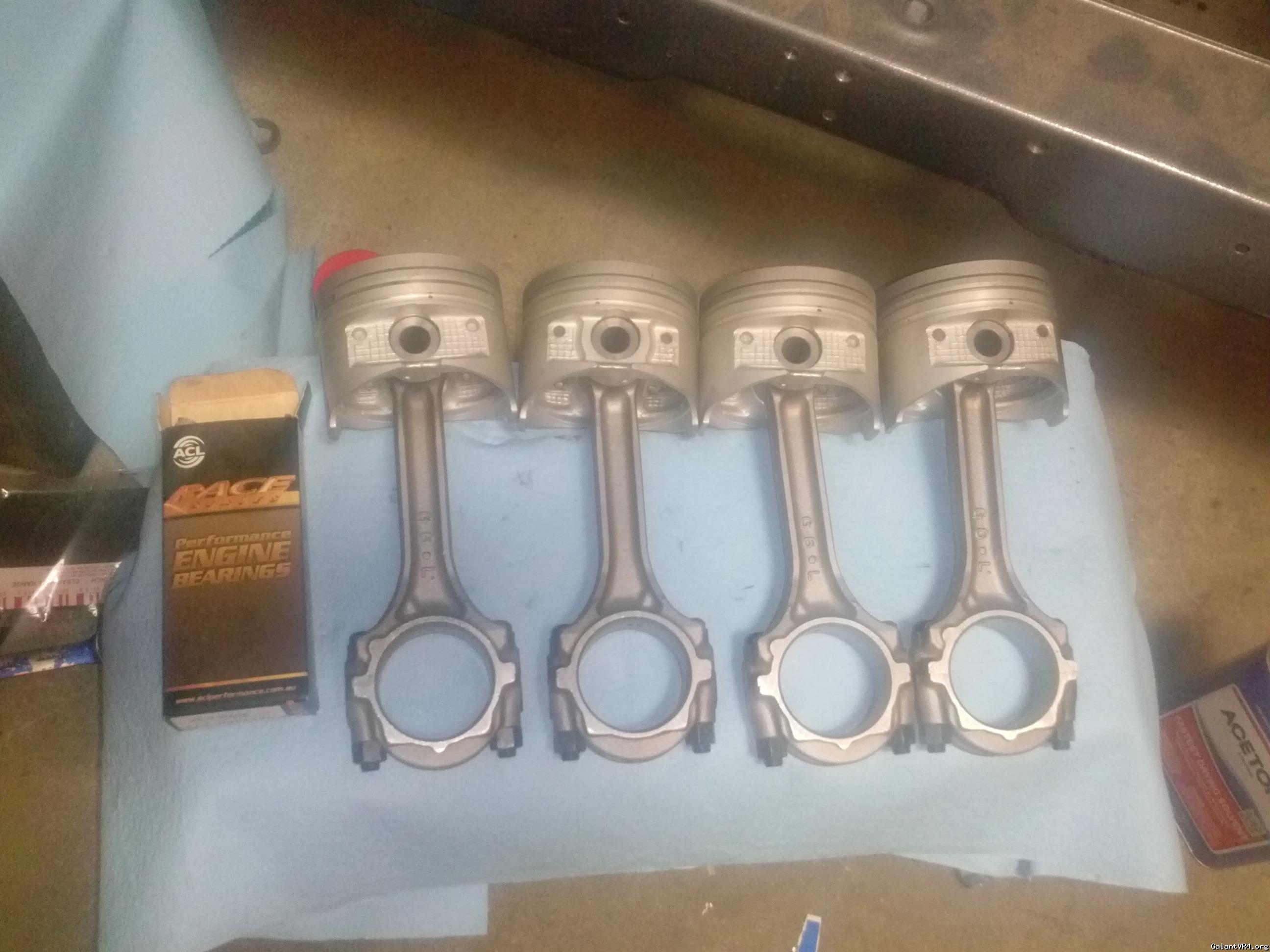

6bolt rods with 2g pistons & ARP rods with ACL Race Series Bearings
ARP main studs ACL Race Series Bearings,newer standard size crank shaft.

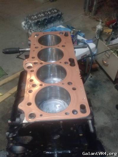

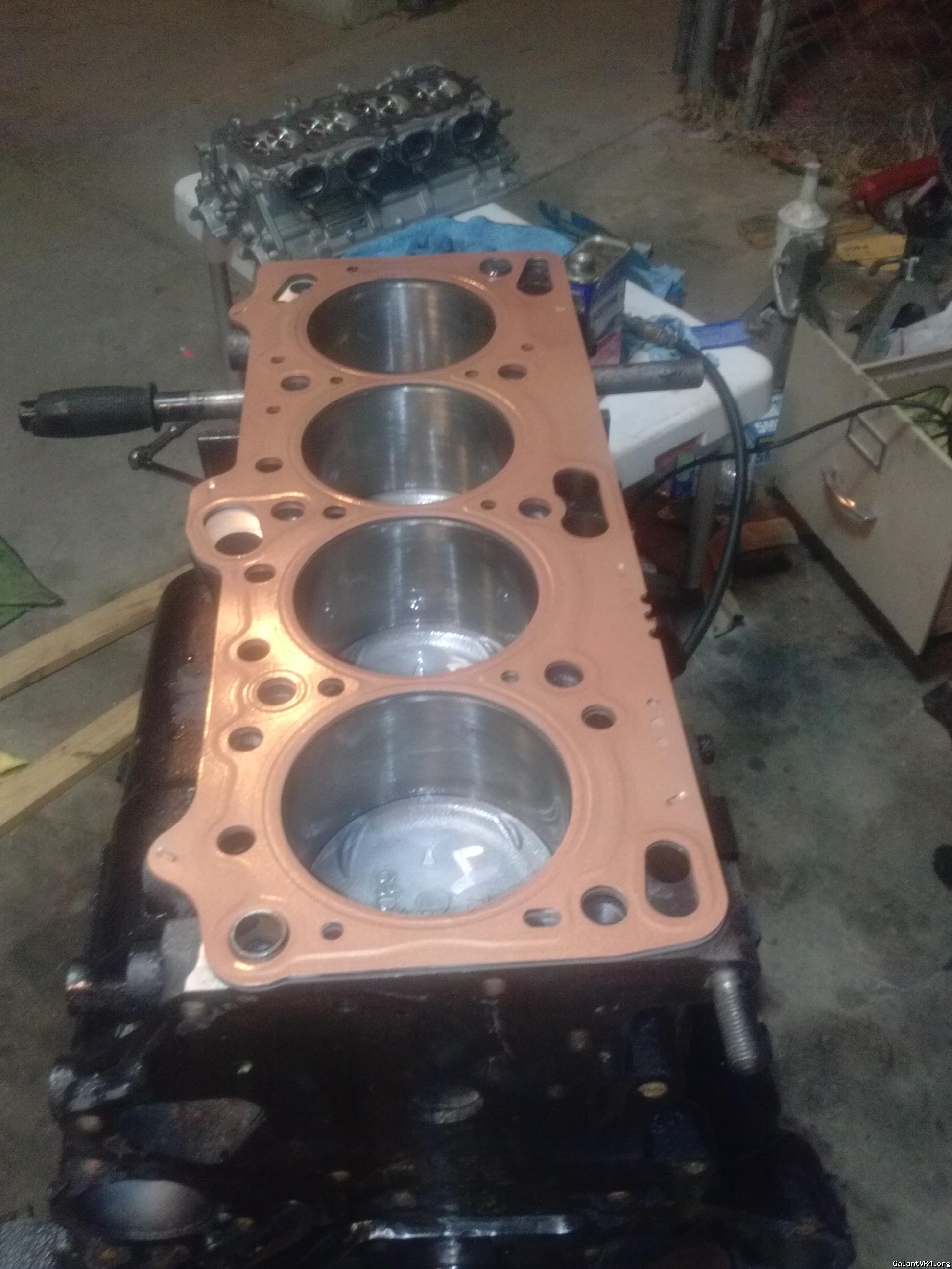

Copper sprayed the MLS head gasket also head has ARP Studs.
Block and head assembled.
