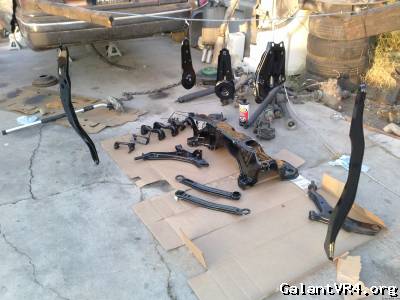

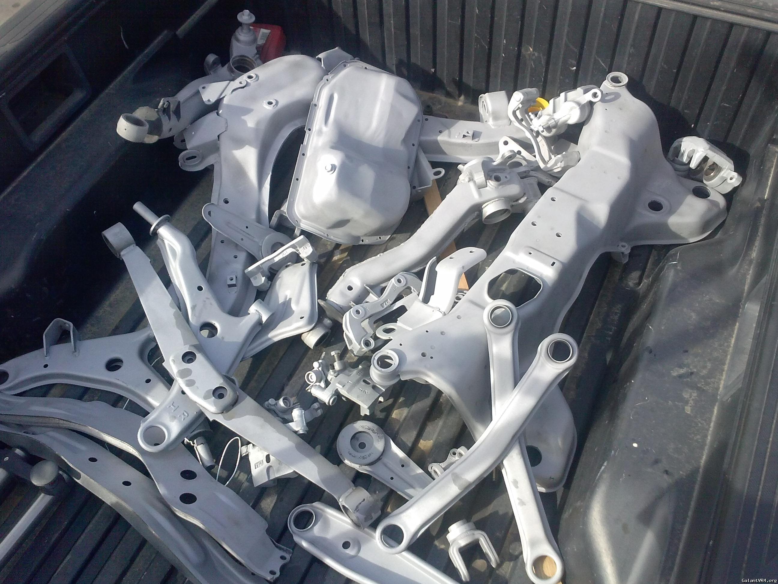

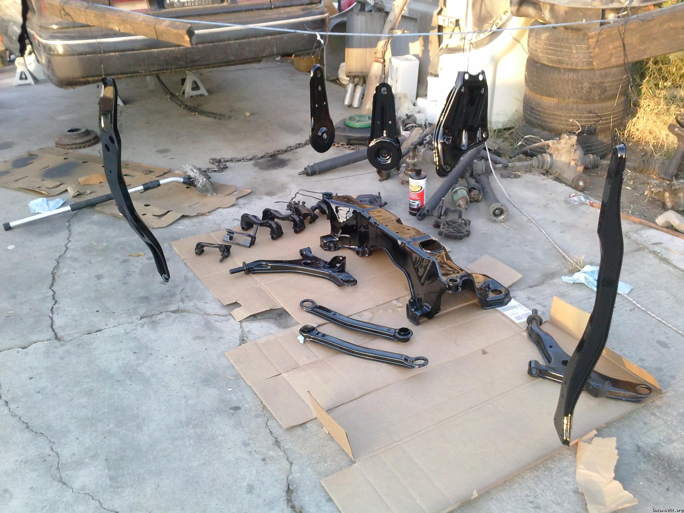

Here's a little update... some new parts that have been laying around now that im currently unemployed Ill be working on the car a lot more /ubbthreads/images/graemlins/rofl.gif but tomorrow I should have the suspension parts back from soda blasting and ready to paint.
Heres a few pics for the meantime.

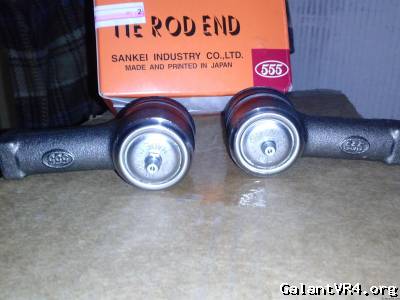

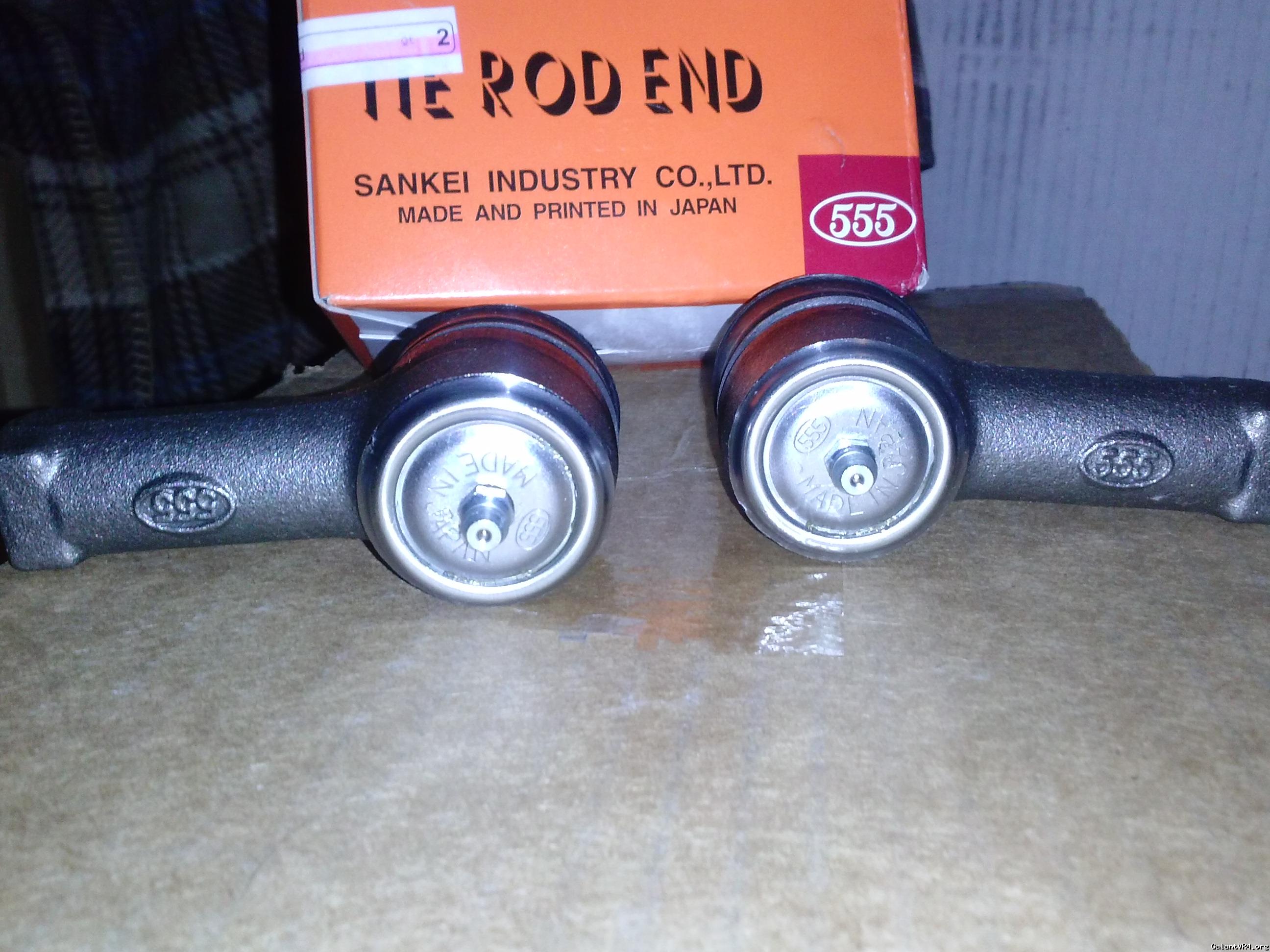

New Tie Rods

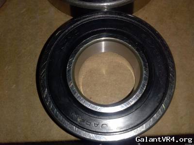

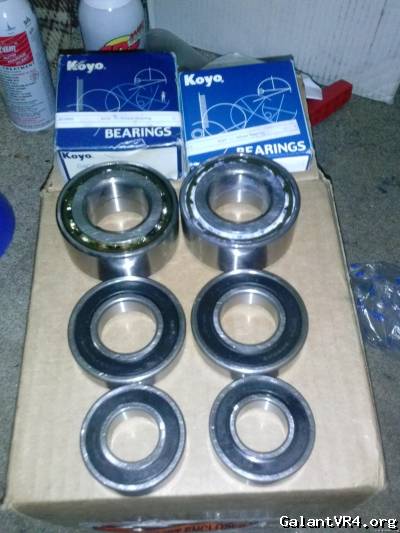

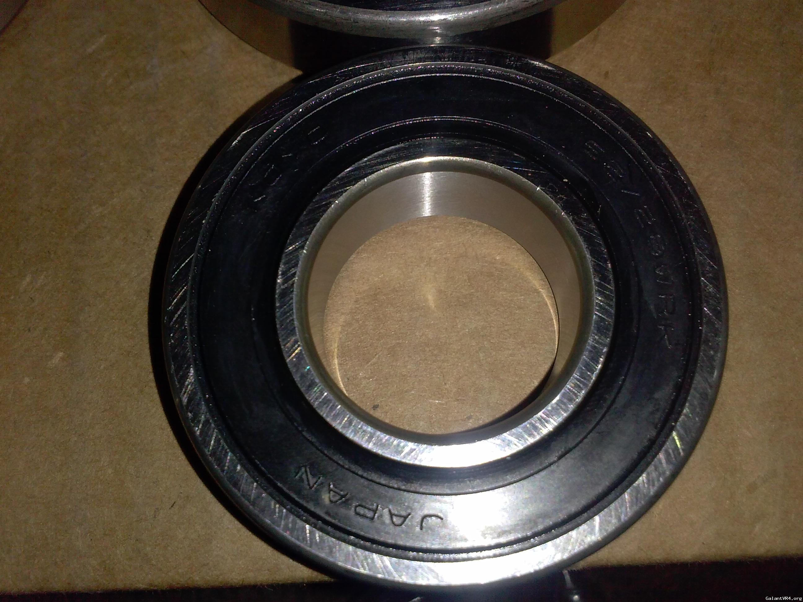

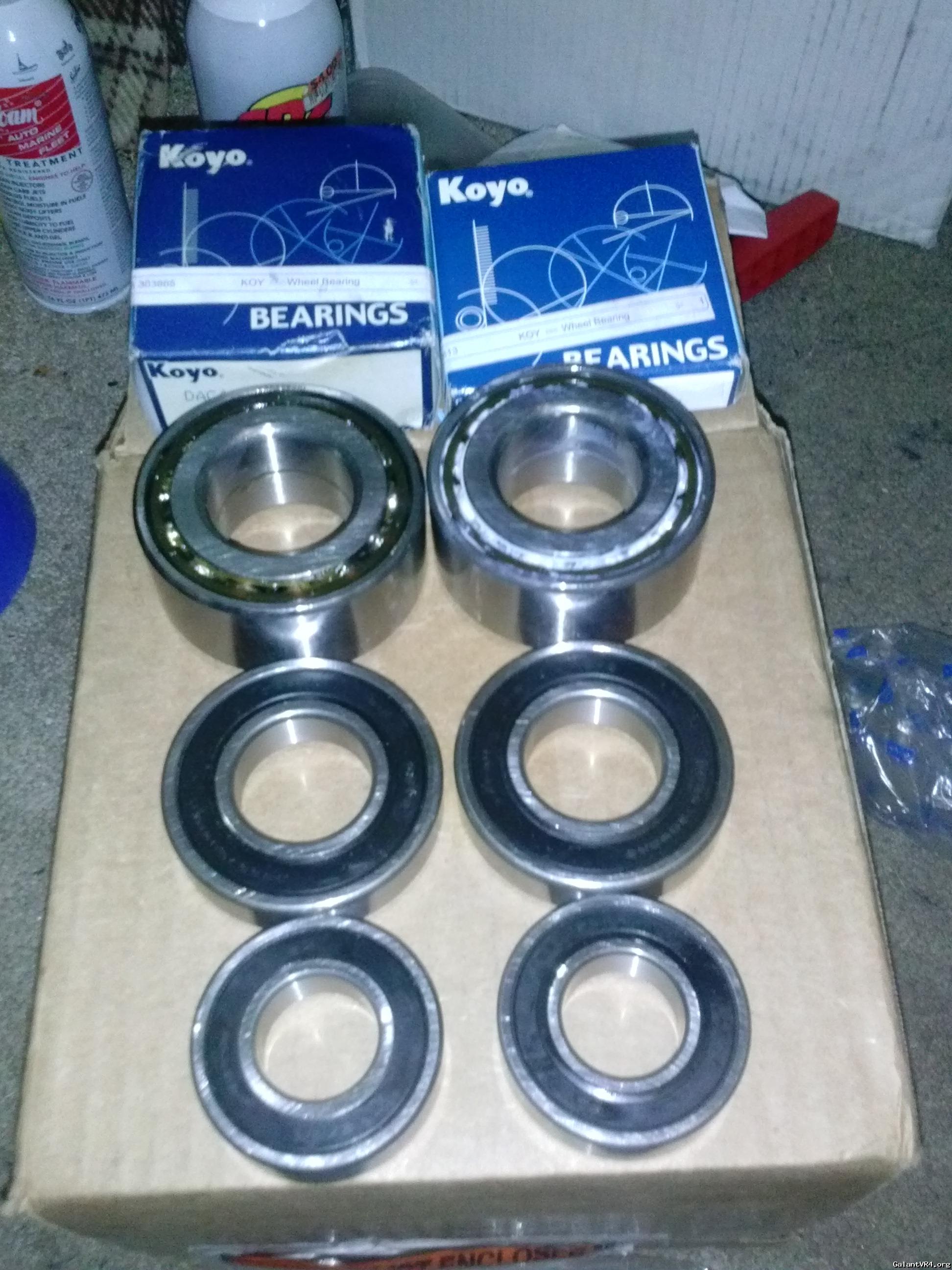

New Wheel bearings all around

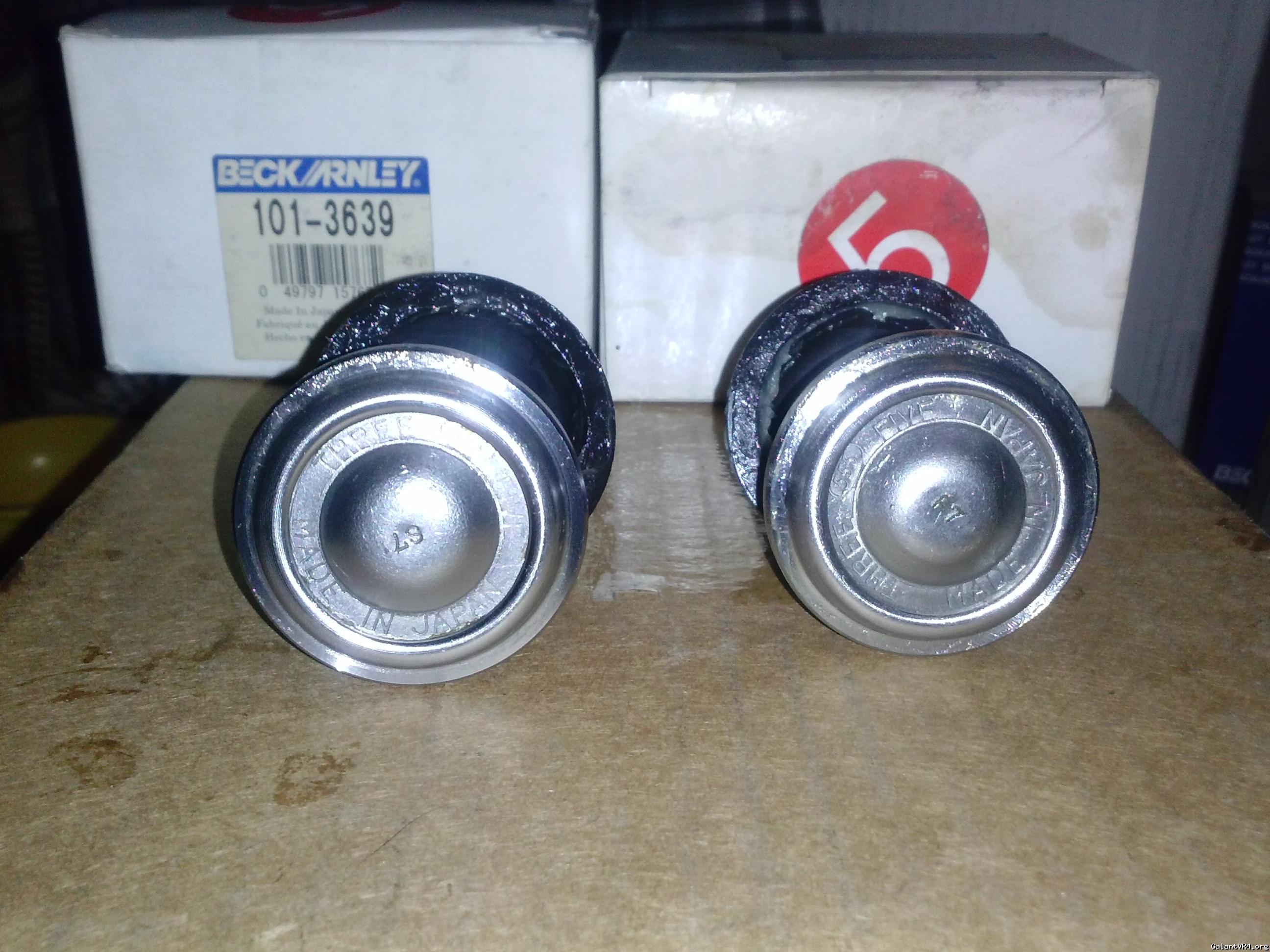

New Ball Joints

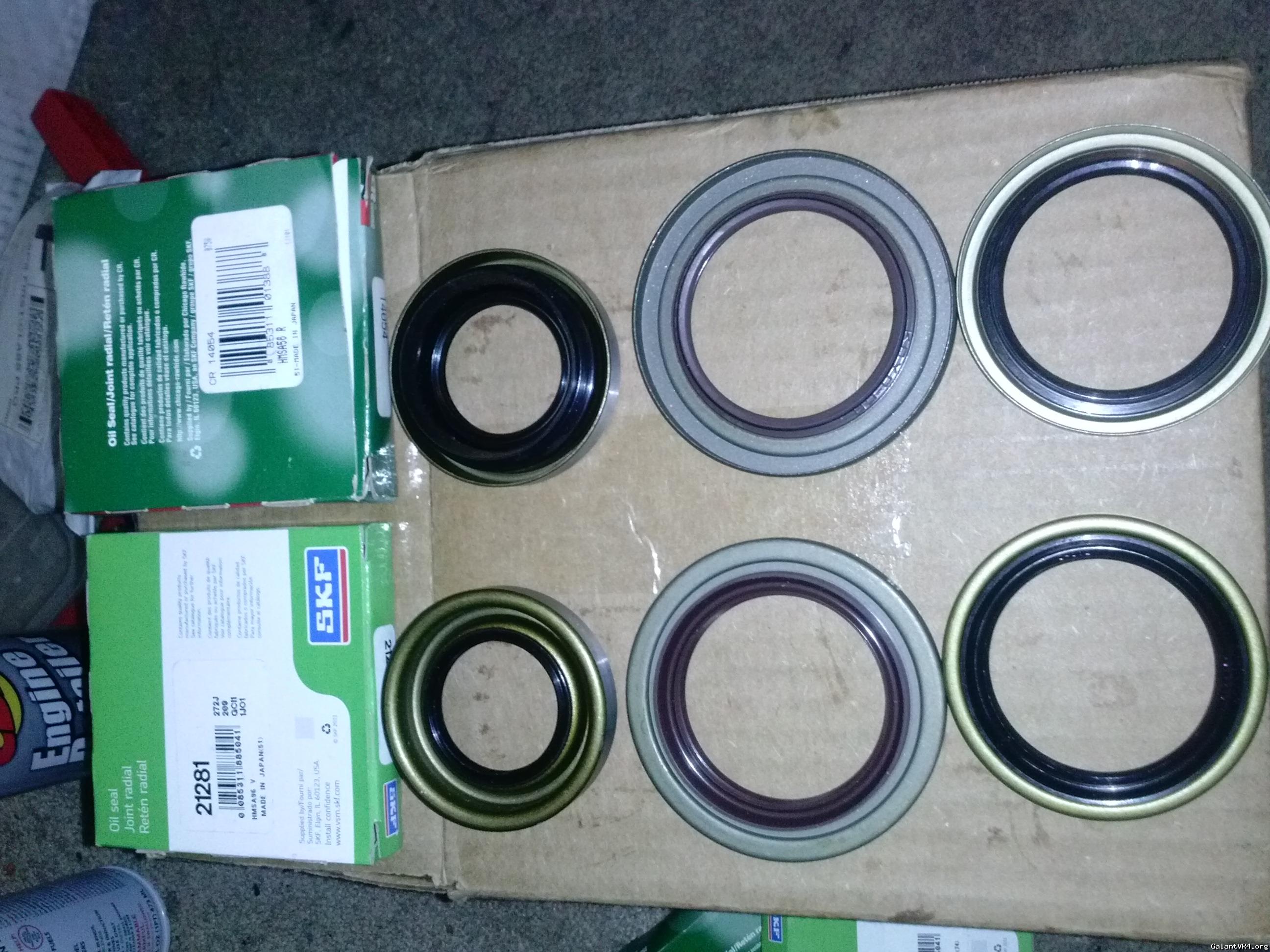

New Wheel Bearing seals

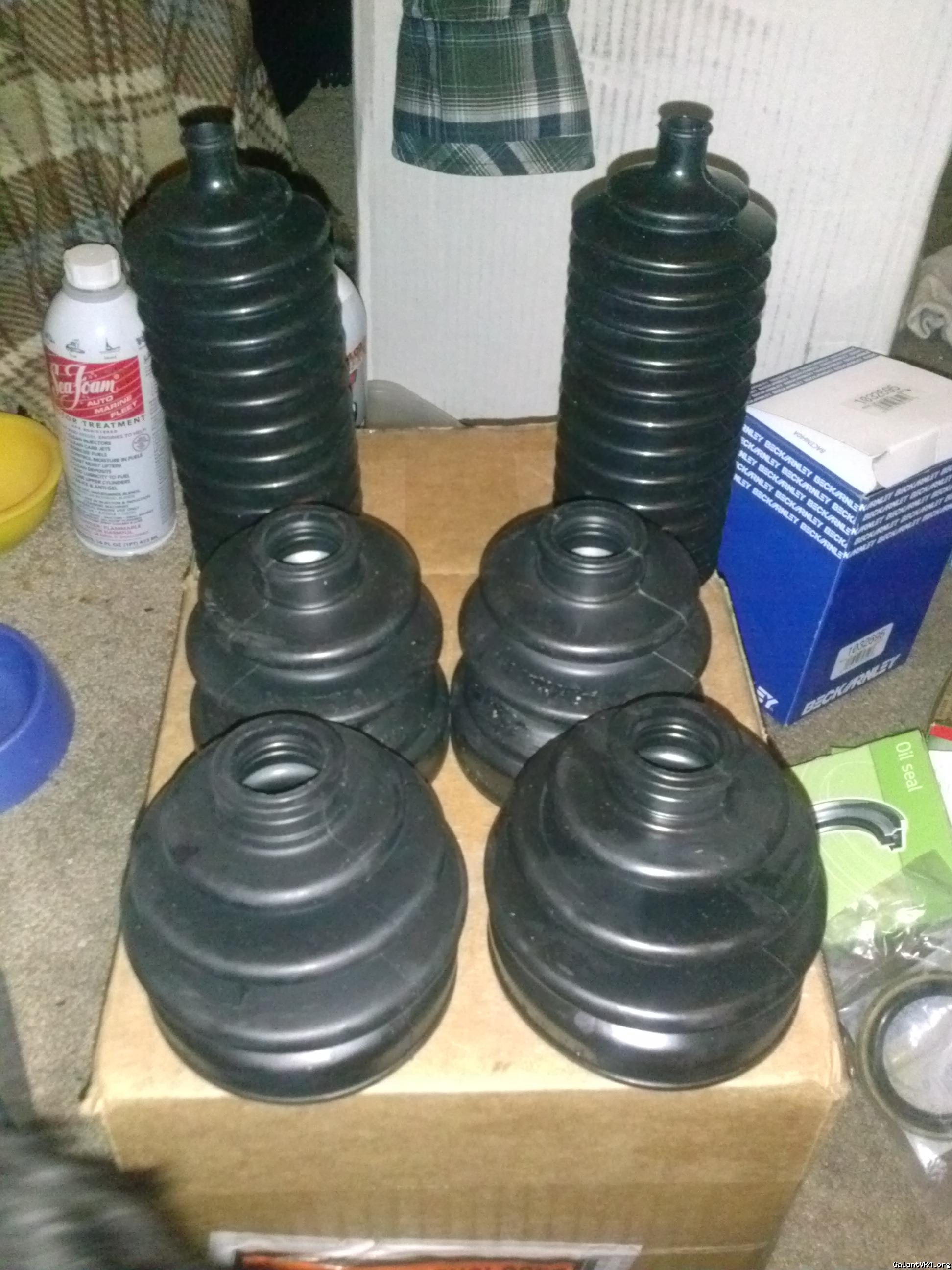

New boots

Rust wasn't really an issue I think the only thing that really had any rust was the rotors /ubbthreads/images/graemlins/rofl.gif
The tumbler is a nice tool to have around I mostly use it to clean bolts and small parts leaves the threads nice and clean and there cheap if you use there 25% off coupon.

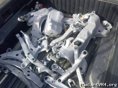

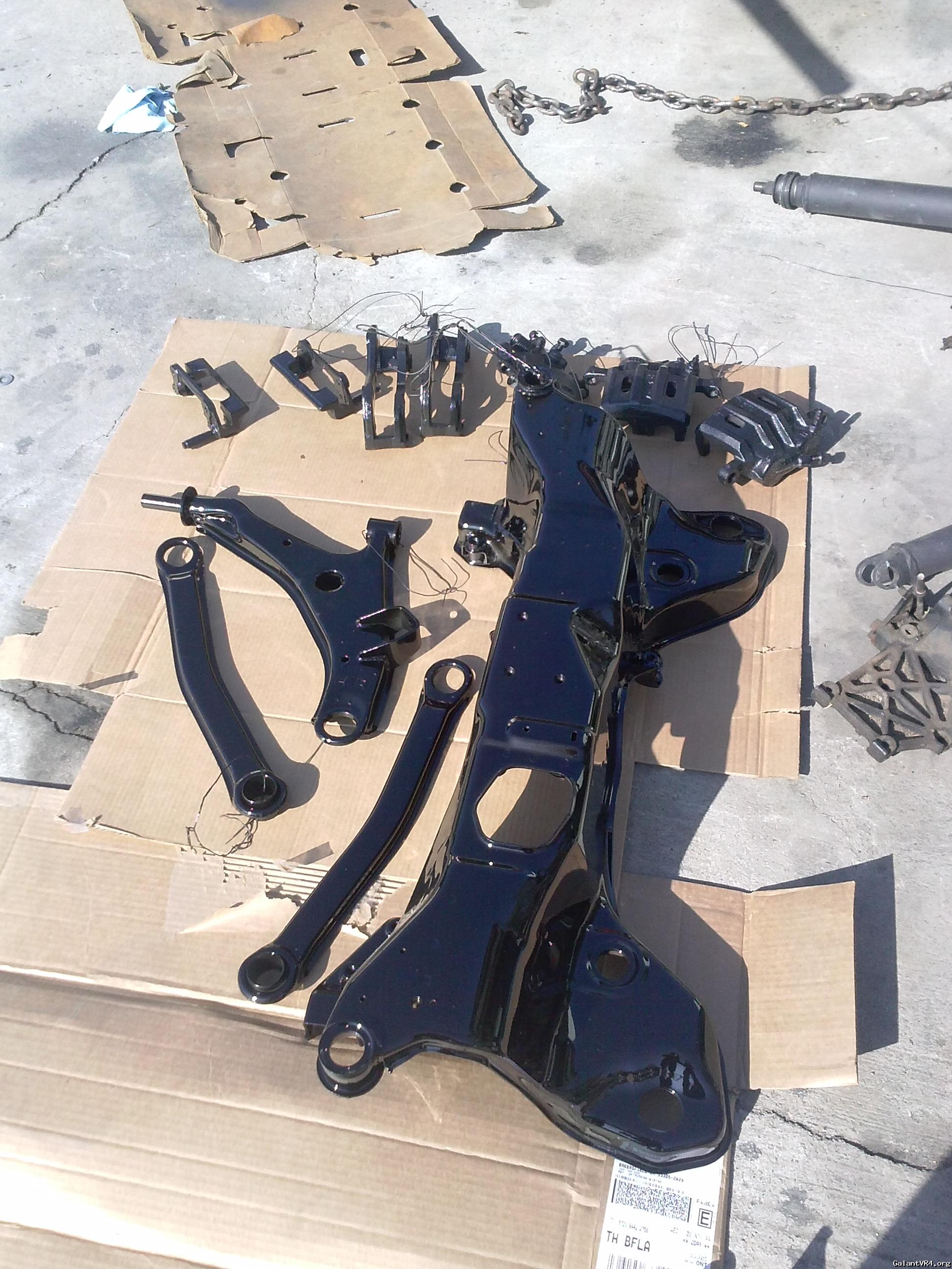

So here's a little of today's progress.

Quoting mitsuturbo:
Quoting Vr4junkie:
5lb Tumbler works awesome defiantly recommend one of these.
And what or who exactly is it you are defying by recommending one of these?
I was slightly confused myself. Of caution though, while the tumbler is great for small pieces like the water neck, caliber bracket, etc, be cautious with the bolts as the medium will remove the factory zinc/cadmium coating. This will cause your bolts (while looking sharp in the short-term) to wind up acquiring surface rust.

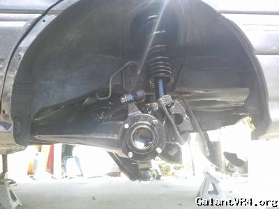

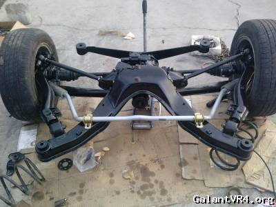

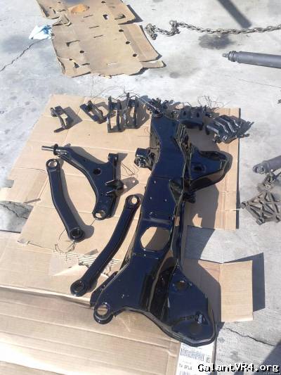

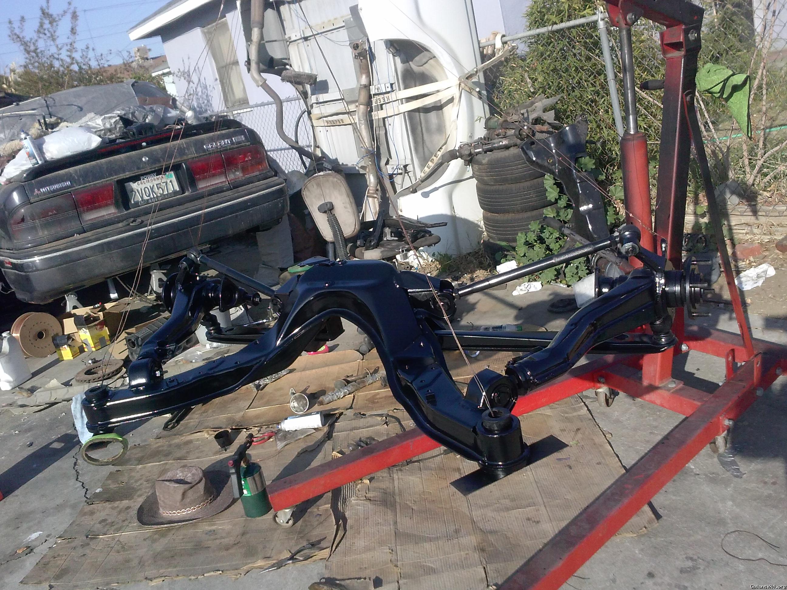

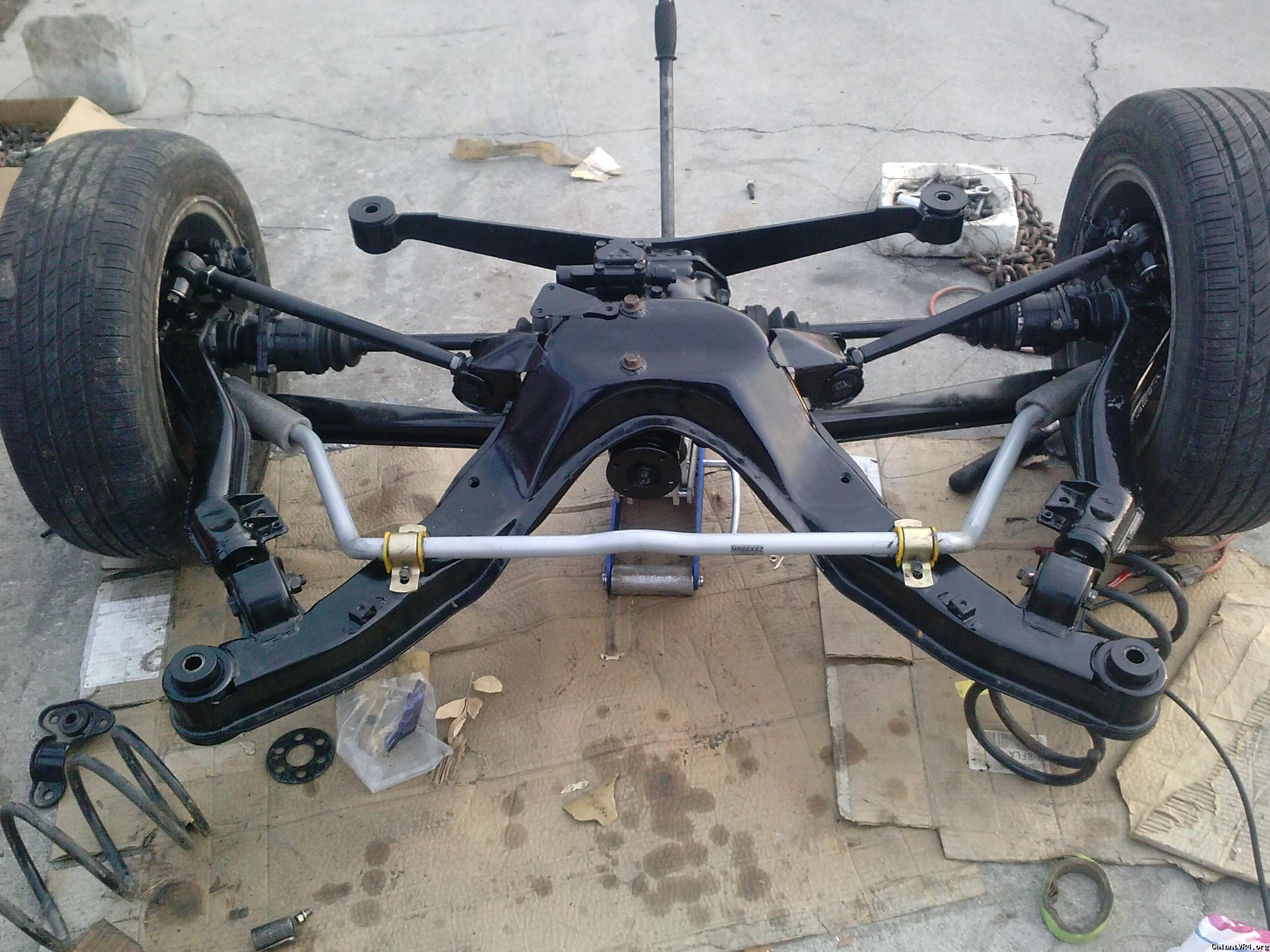

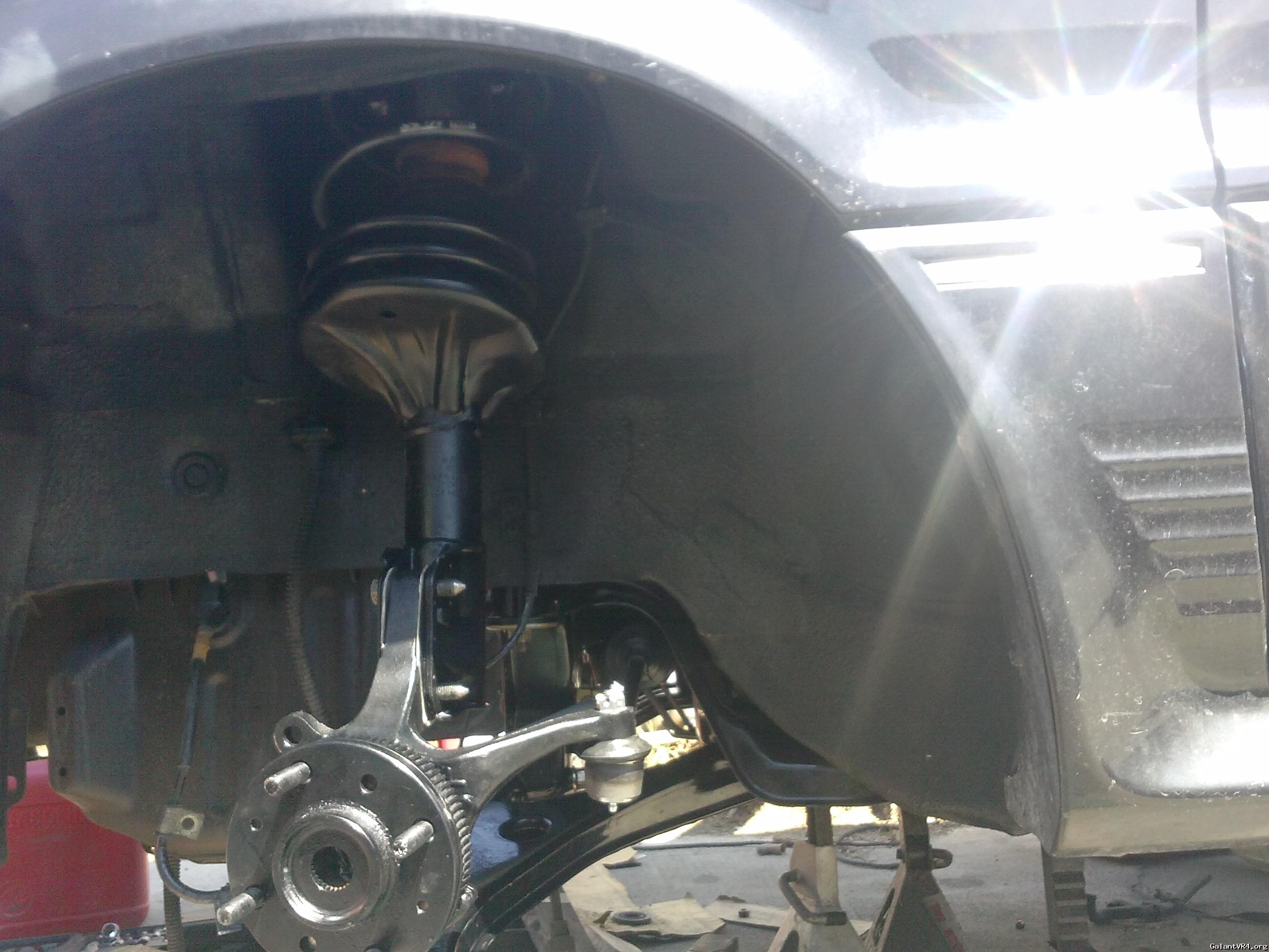

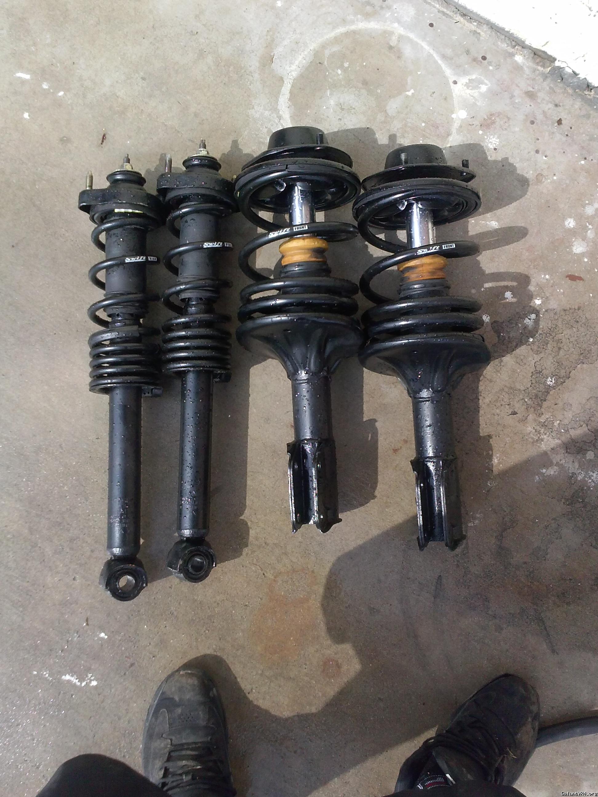

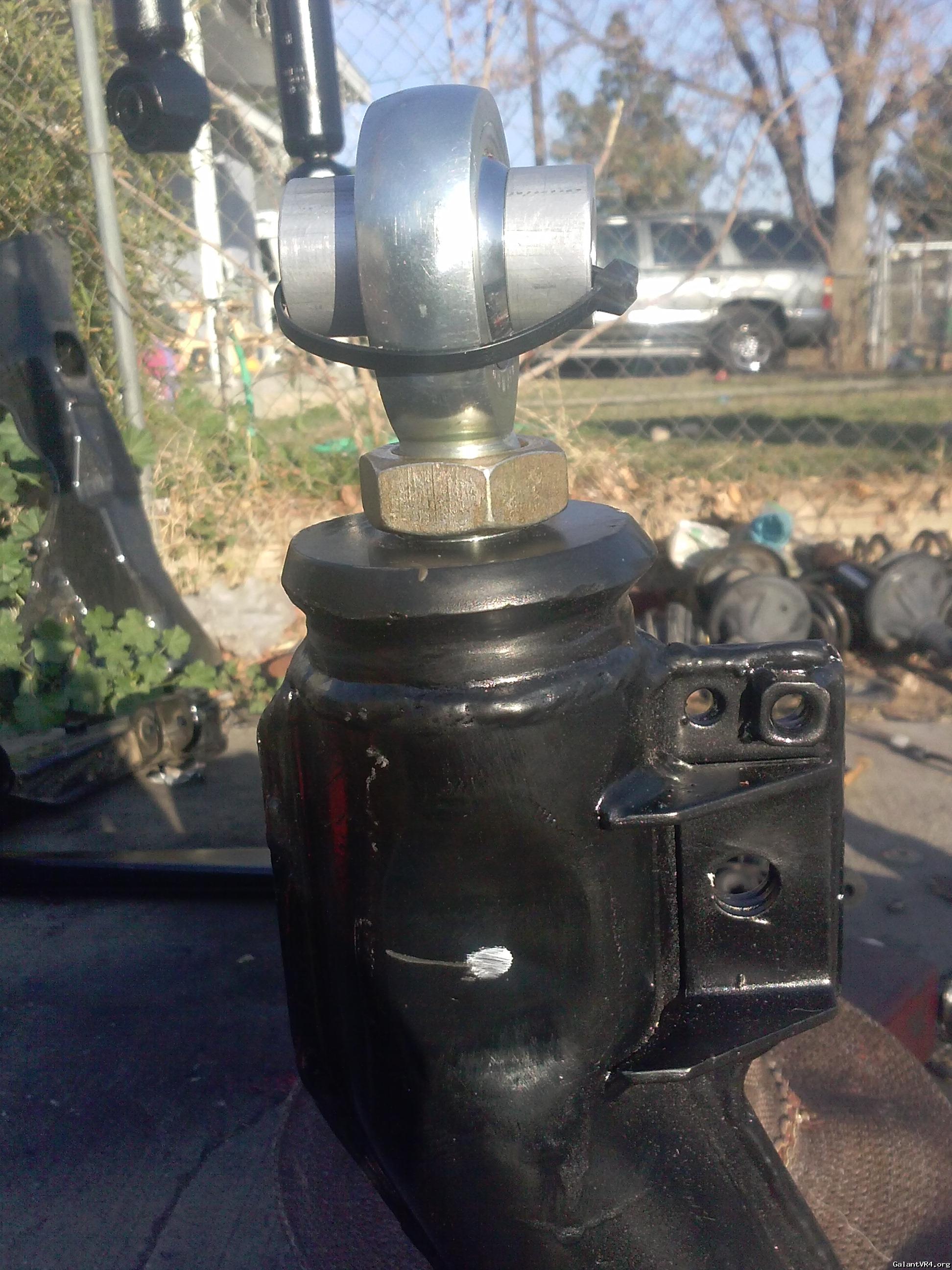

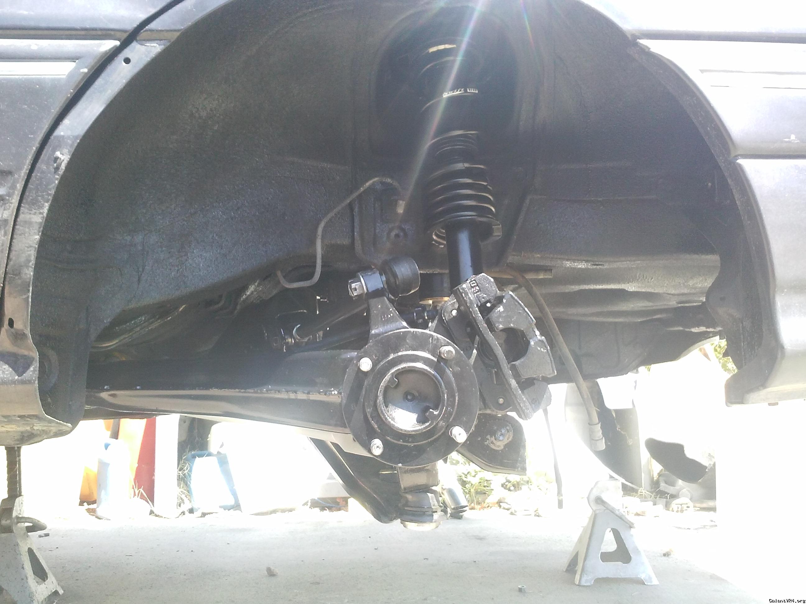

Sprayed a last coat of anti corrosion paint
Almost assembled missing a few bolts

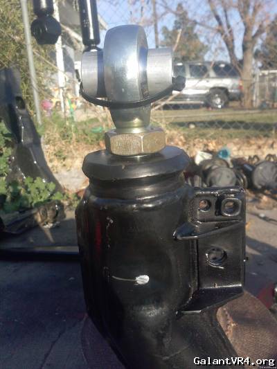

Jay Racing rear toe elimiinator and rear upper adjustable control arms

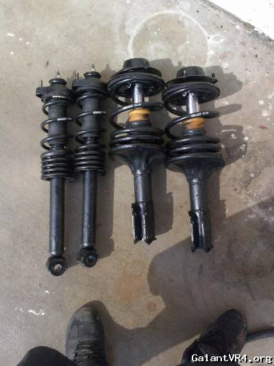

Evo suspension on Swift springs.

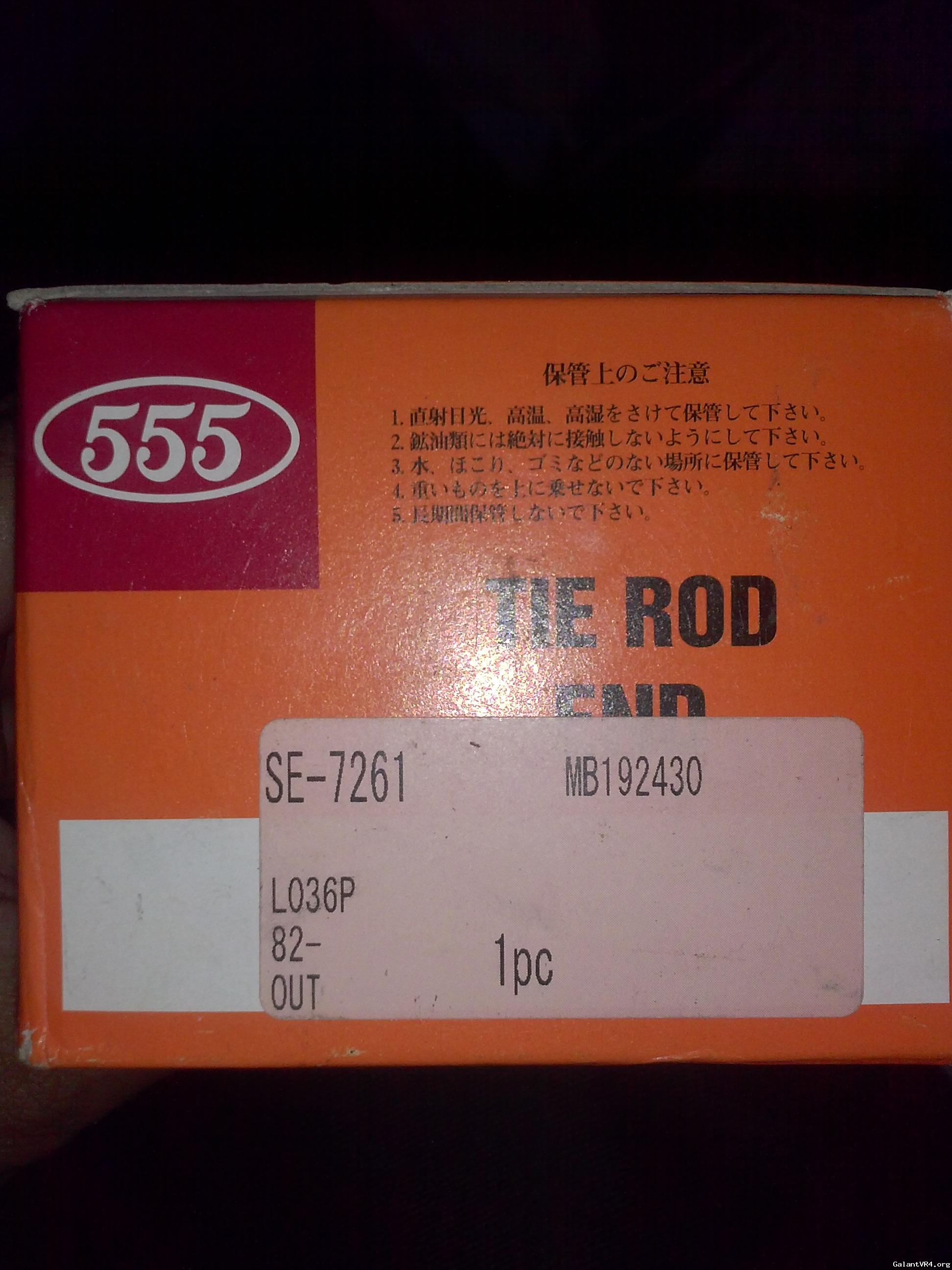

Sweet, so sankei # se-7261. You know these are for a space wagon right? Edit, I see the new # mb564991 works for galants.
Vr4junkie
Jun 25, 2011
596
Some wack town in CA
Yes it was all that hard work finally paid off but yea it did felt great knowing its got fresh new bearing and literally all new bushings /ubbthreads/images/graemlins/smile.gif . But it's still has a lot to go but its getting there little by little.

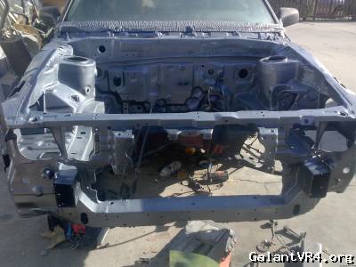

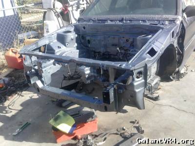

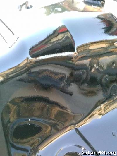

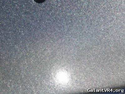

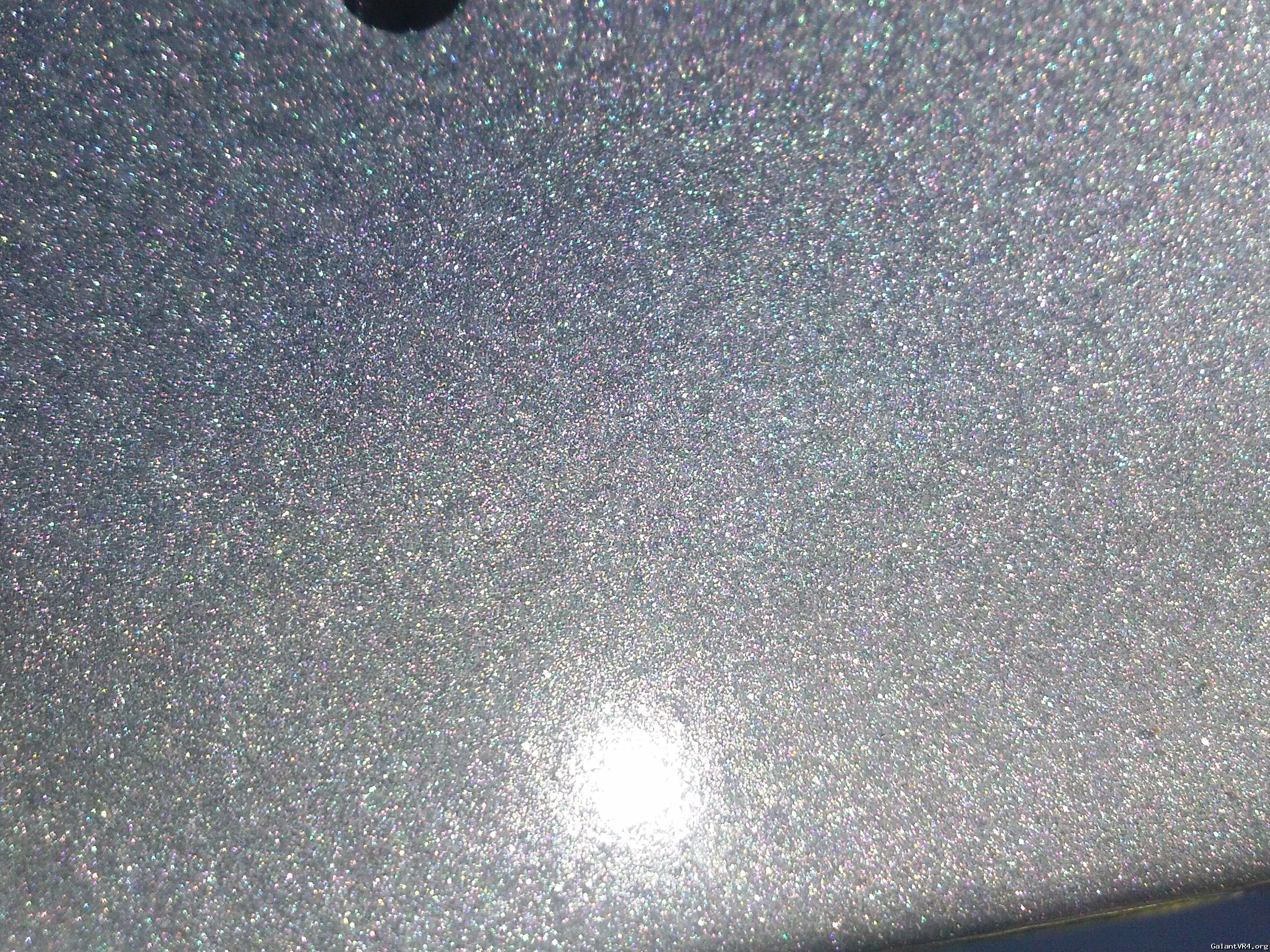

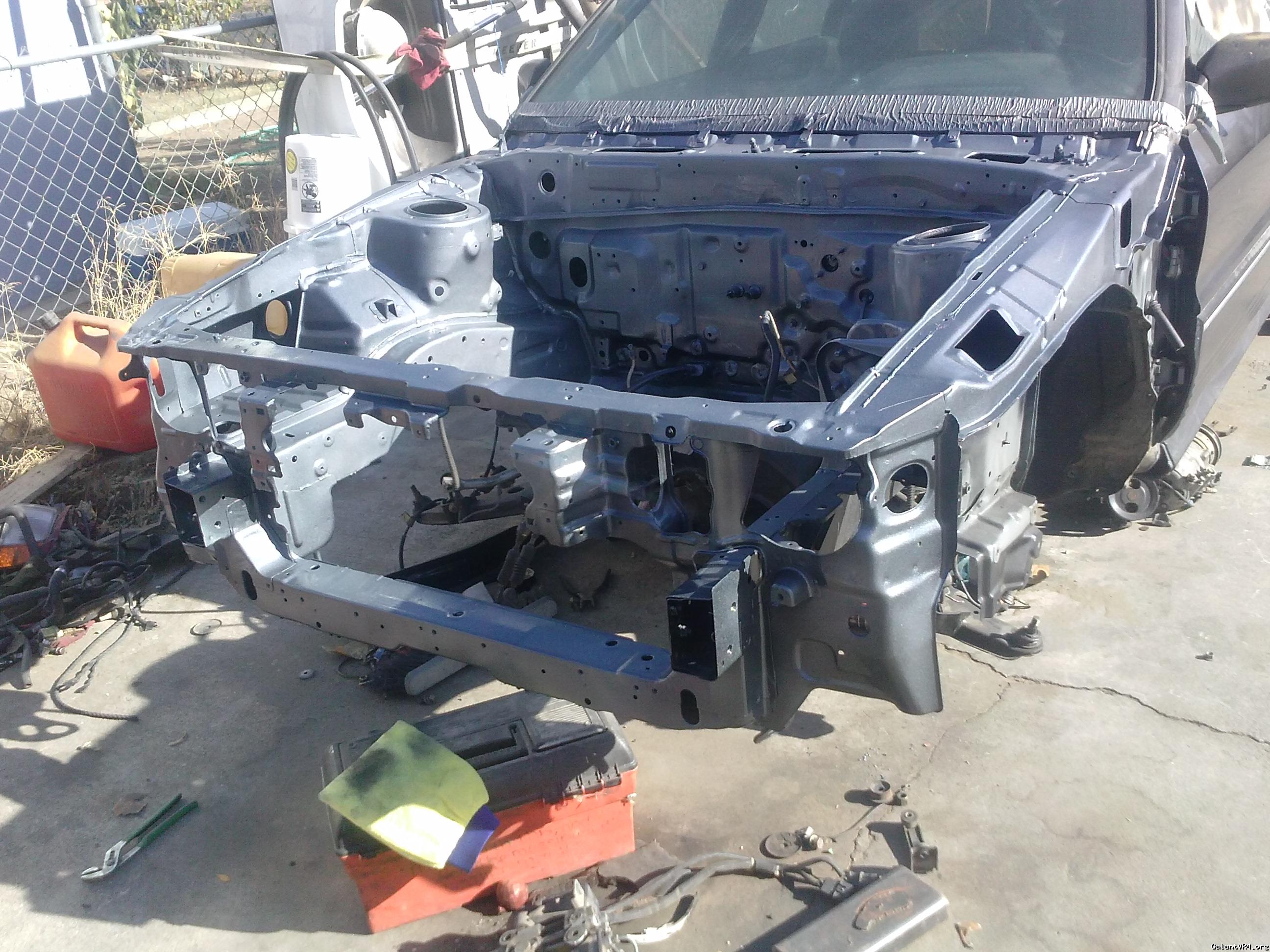

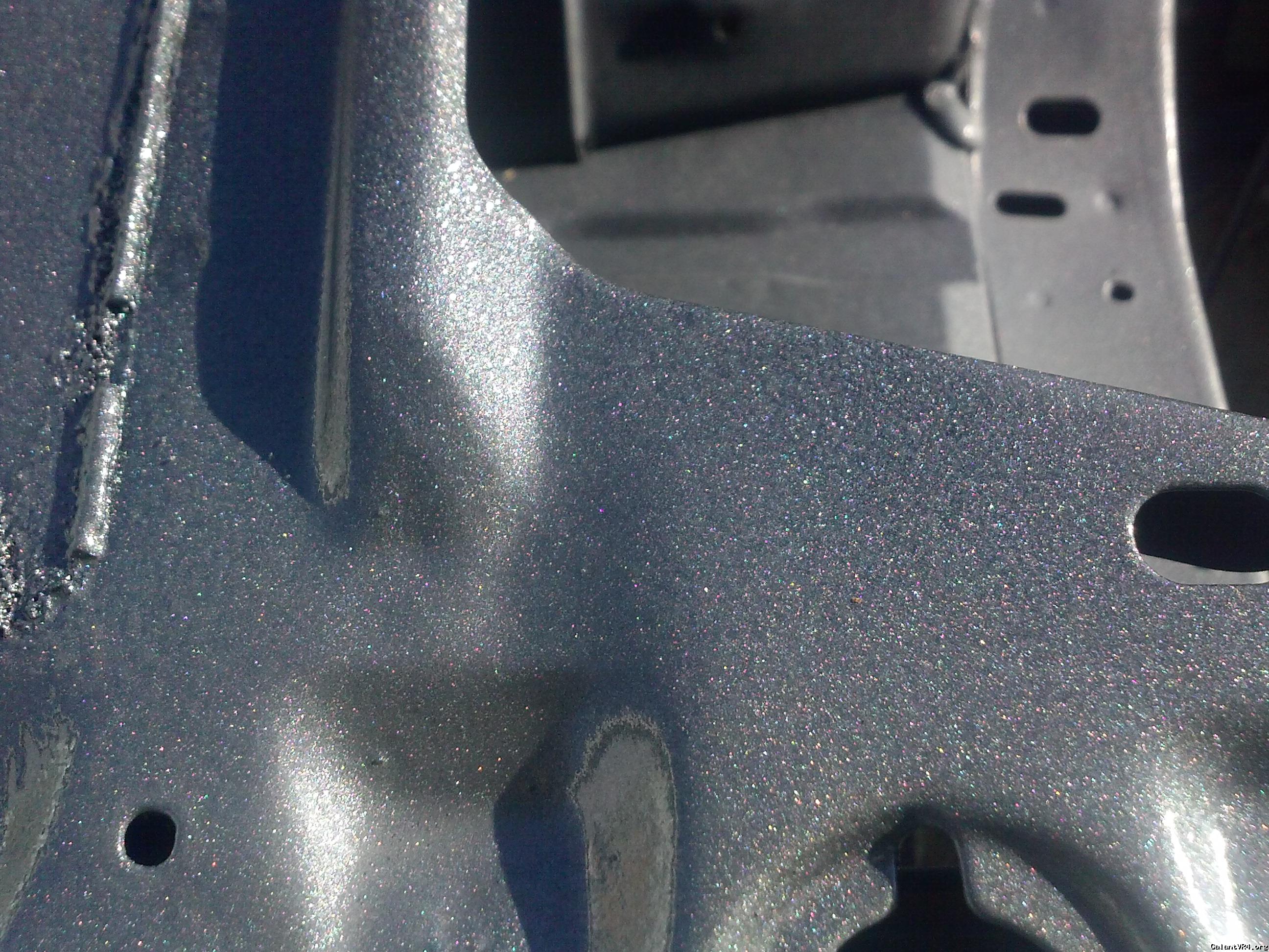

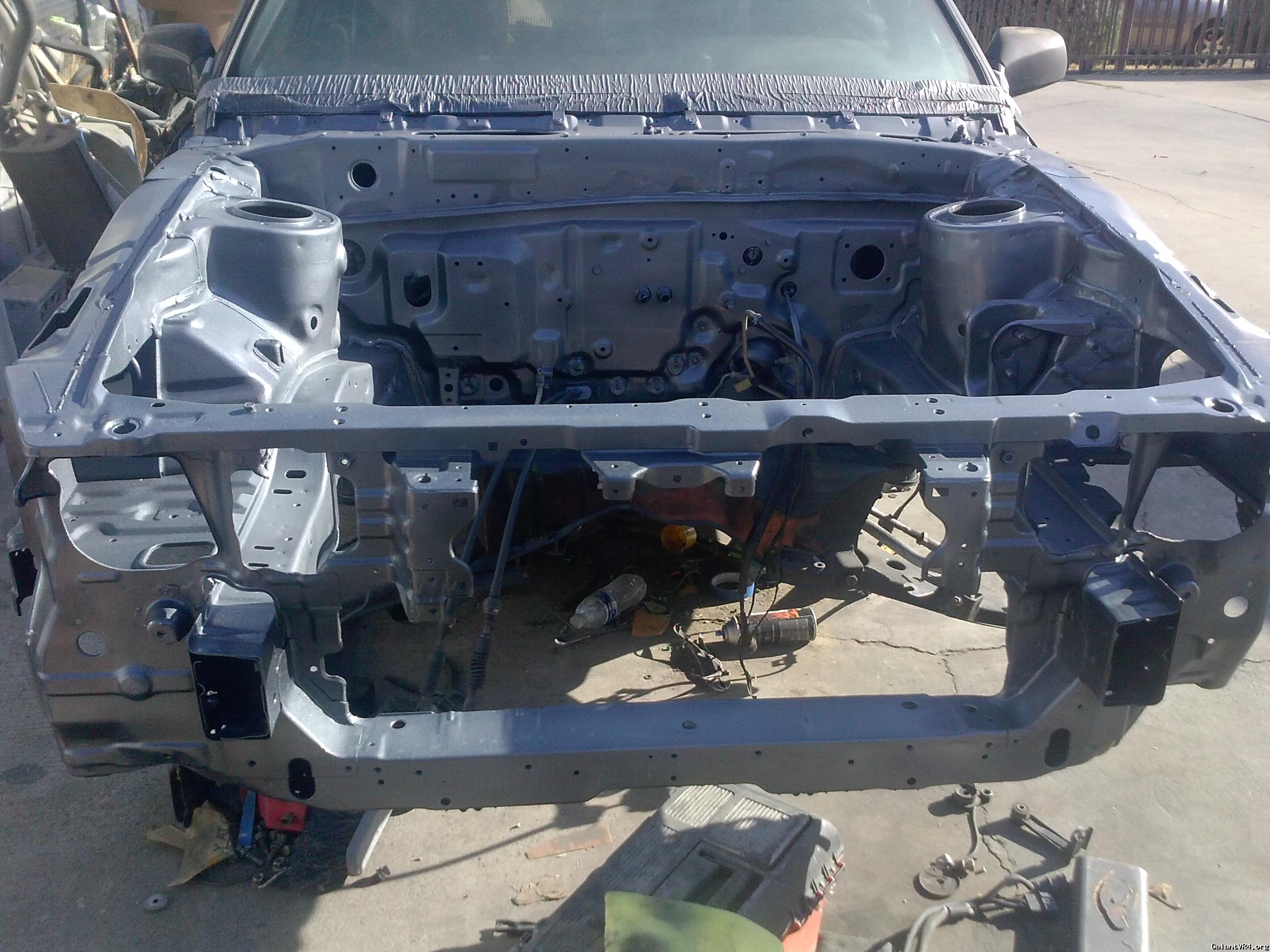

Just got done painting the engine bay it's a metallic grey can't really tell by the crappy phone pictures not the best painting by far but might keep it for a while.
