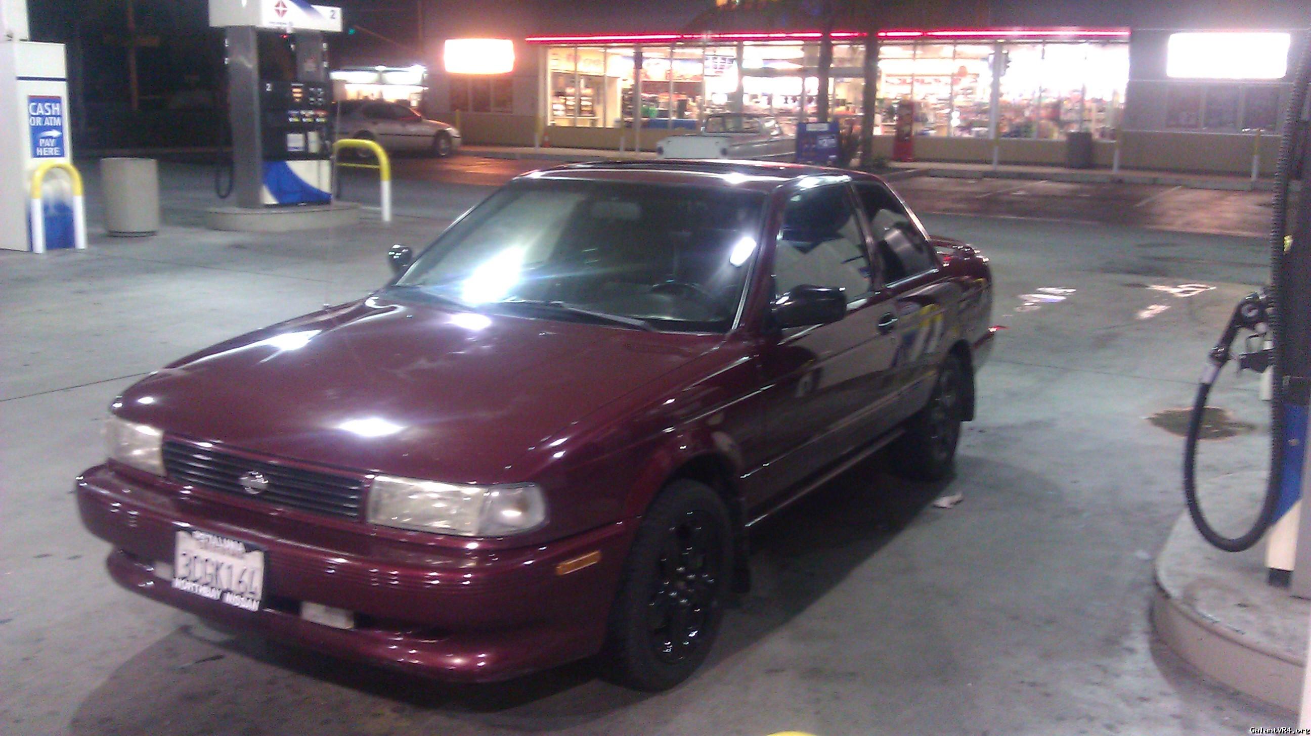

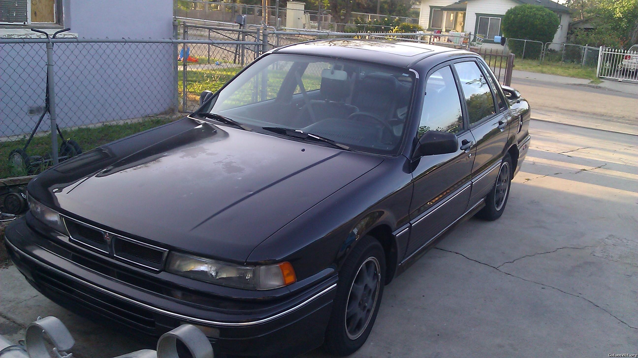

My old B13 SE-R that I sold to buy my GVR-4
Bought a Rare car and even rarer from the ORIGINAL OWNER!! /ubbthreads/images/graemlins/grin.gif Completely stock
All maintenance paper work
385/2000 after a wash and wax that didn't do much
Didn't even get the chance to change the oil gatta love the VR-4

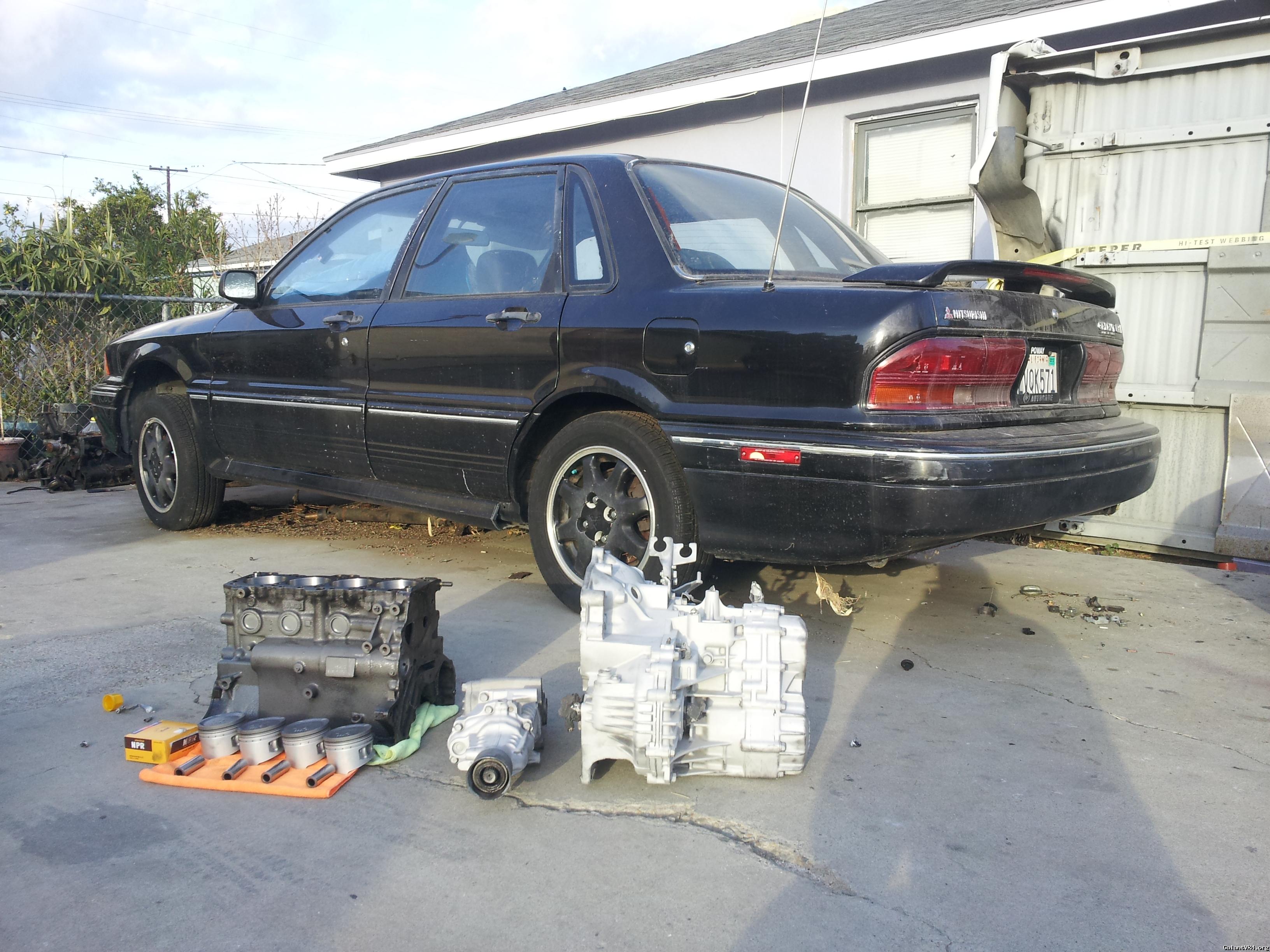

Well finally getting some progress heres a few pics for mean while

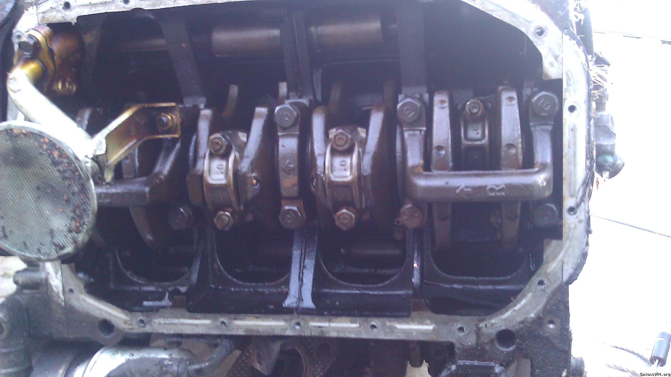

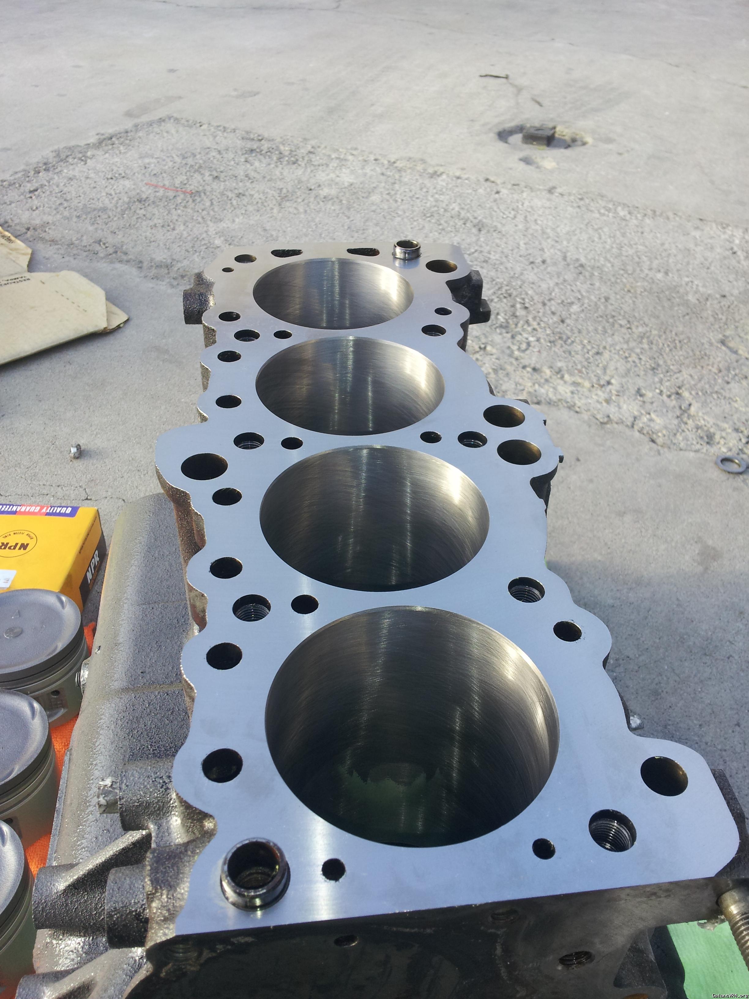

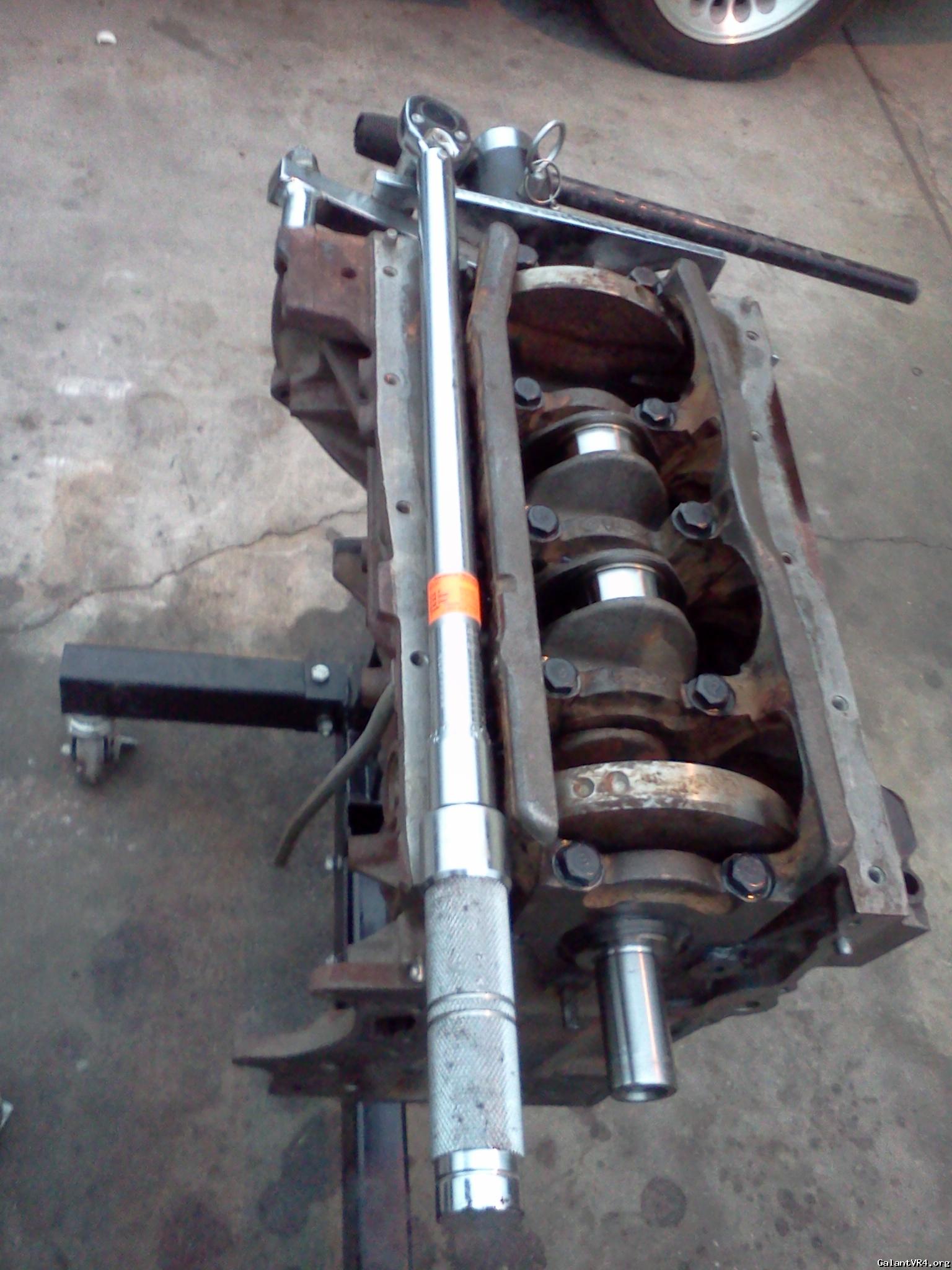

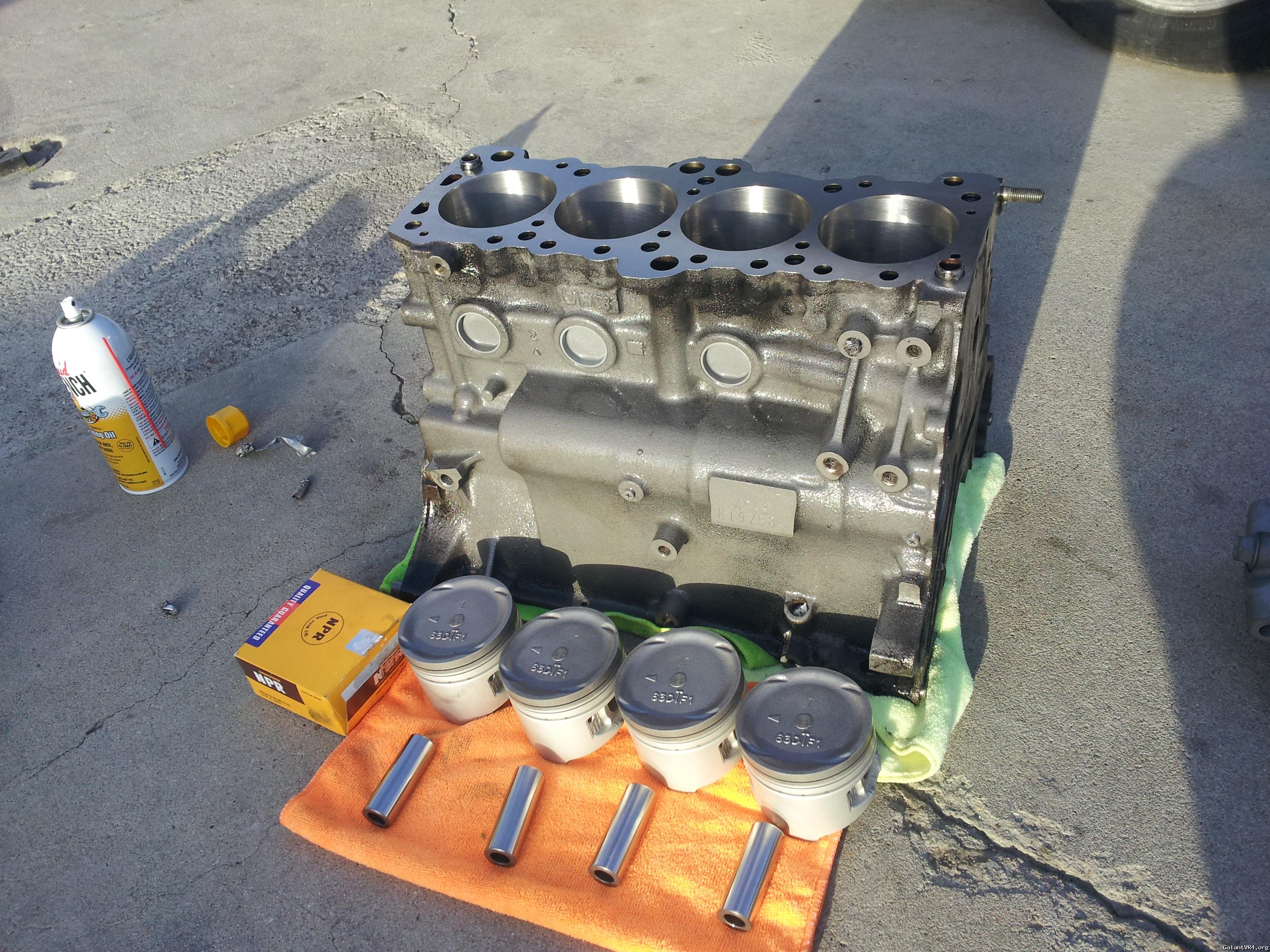

Block Decked and Bored
2g NPR pistons 0.030 over

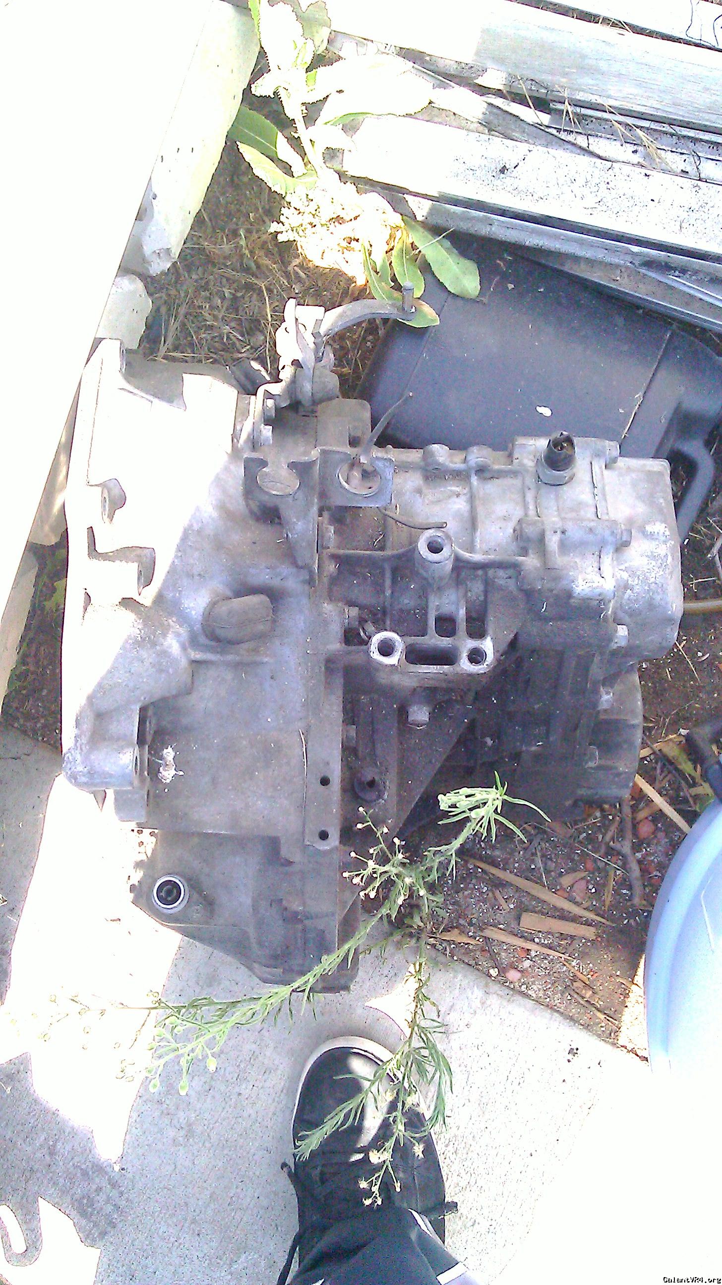

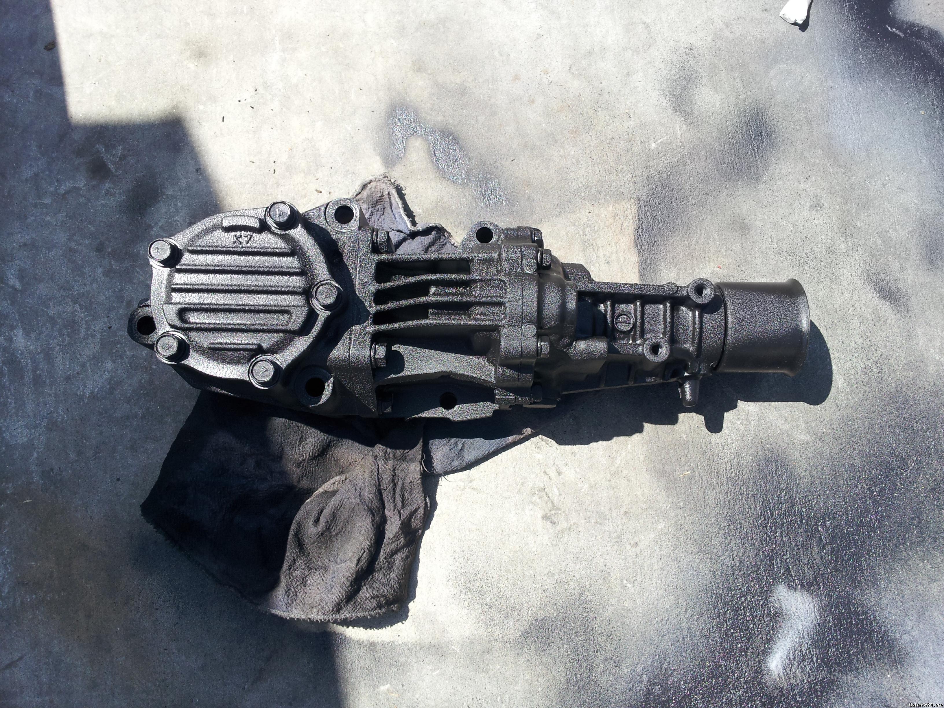

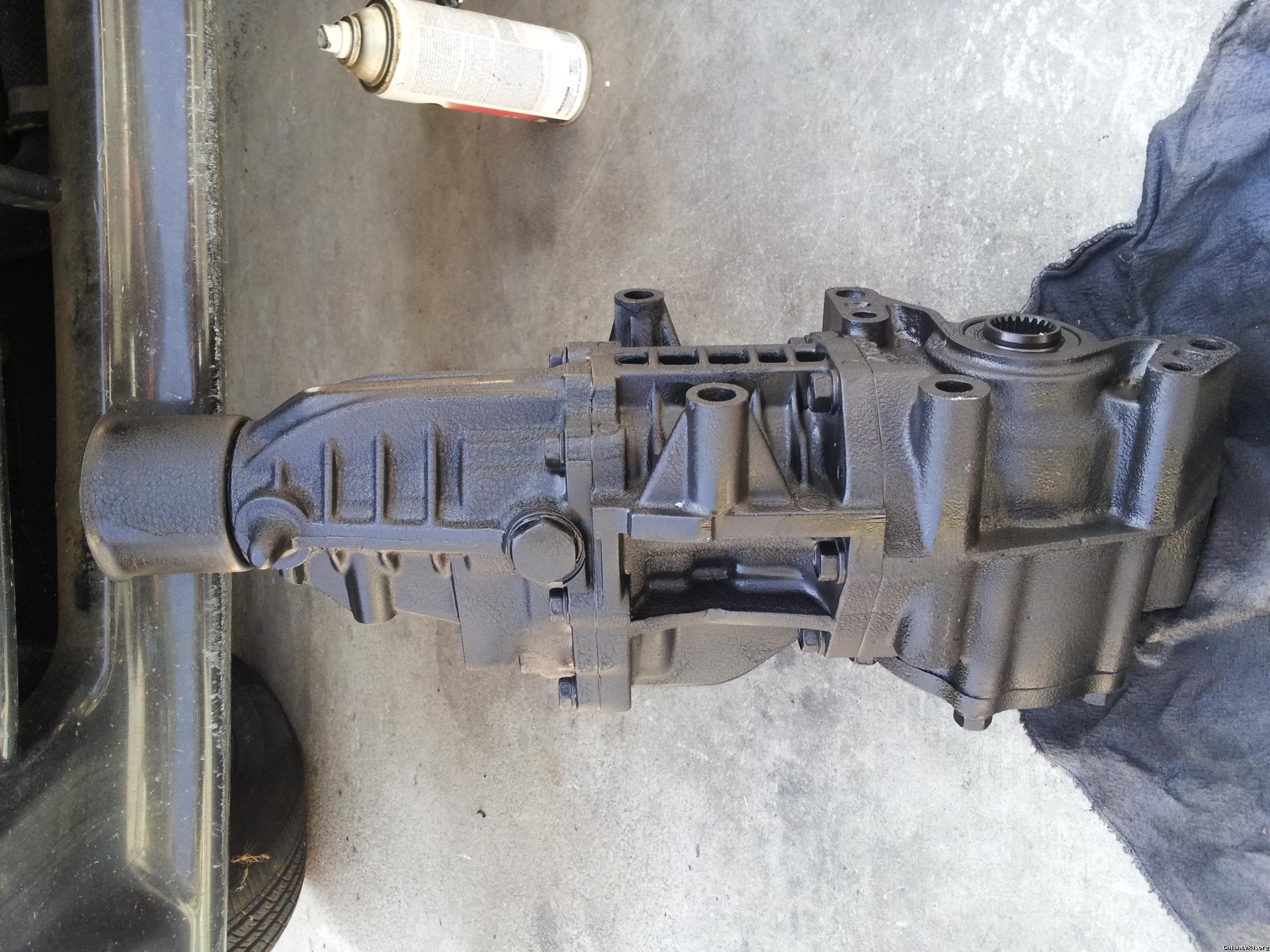

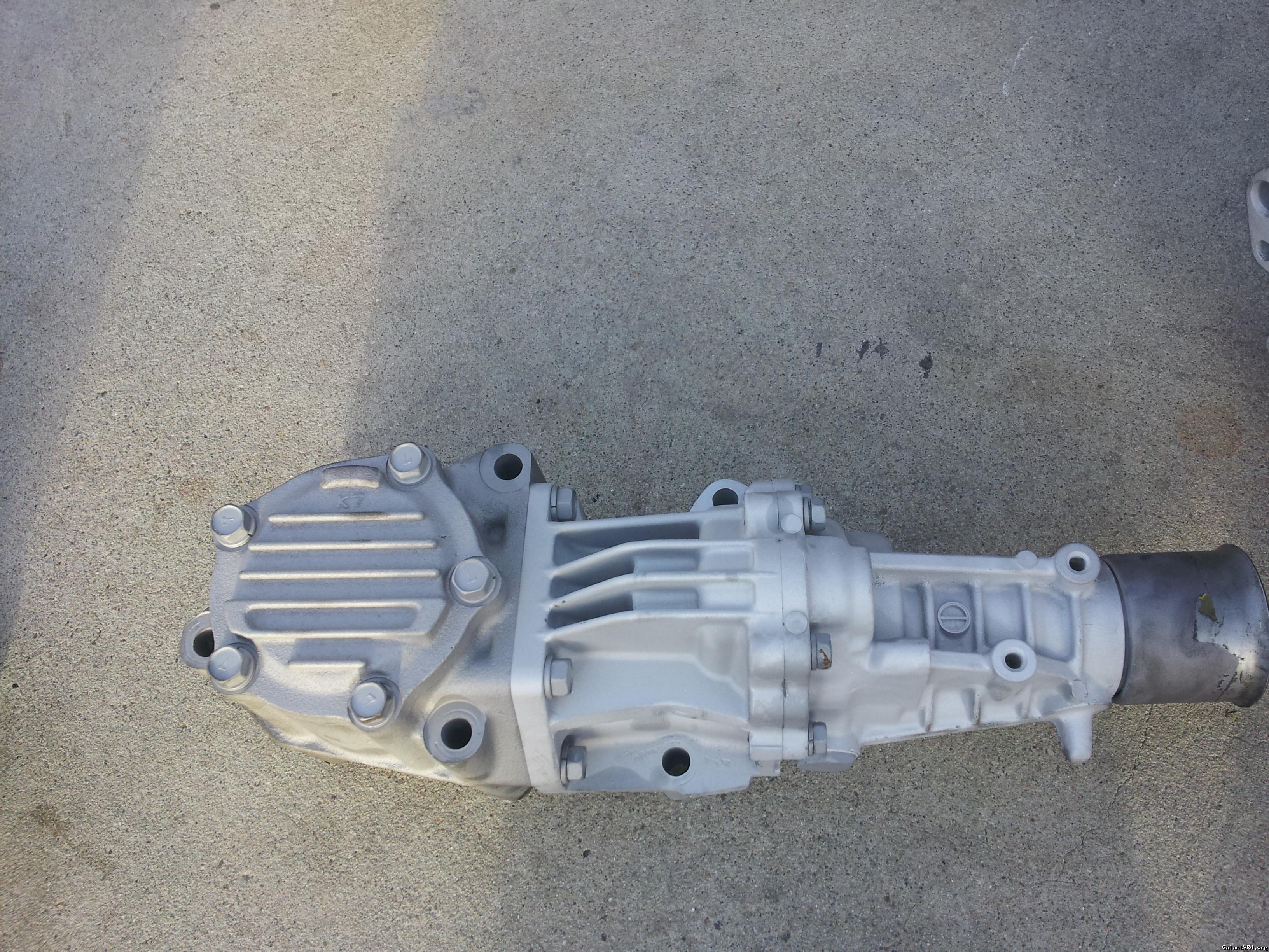

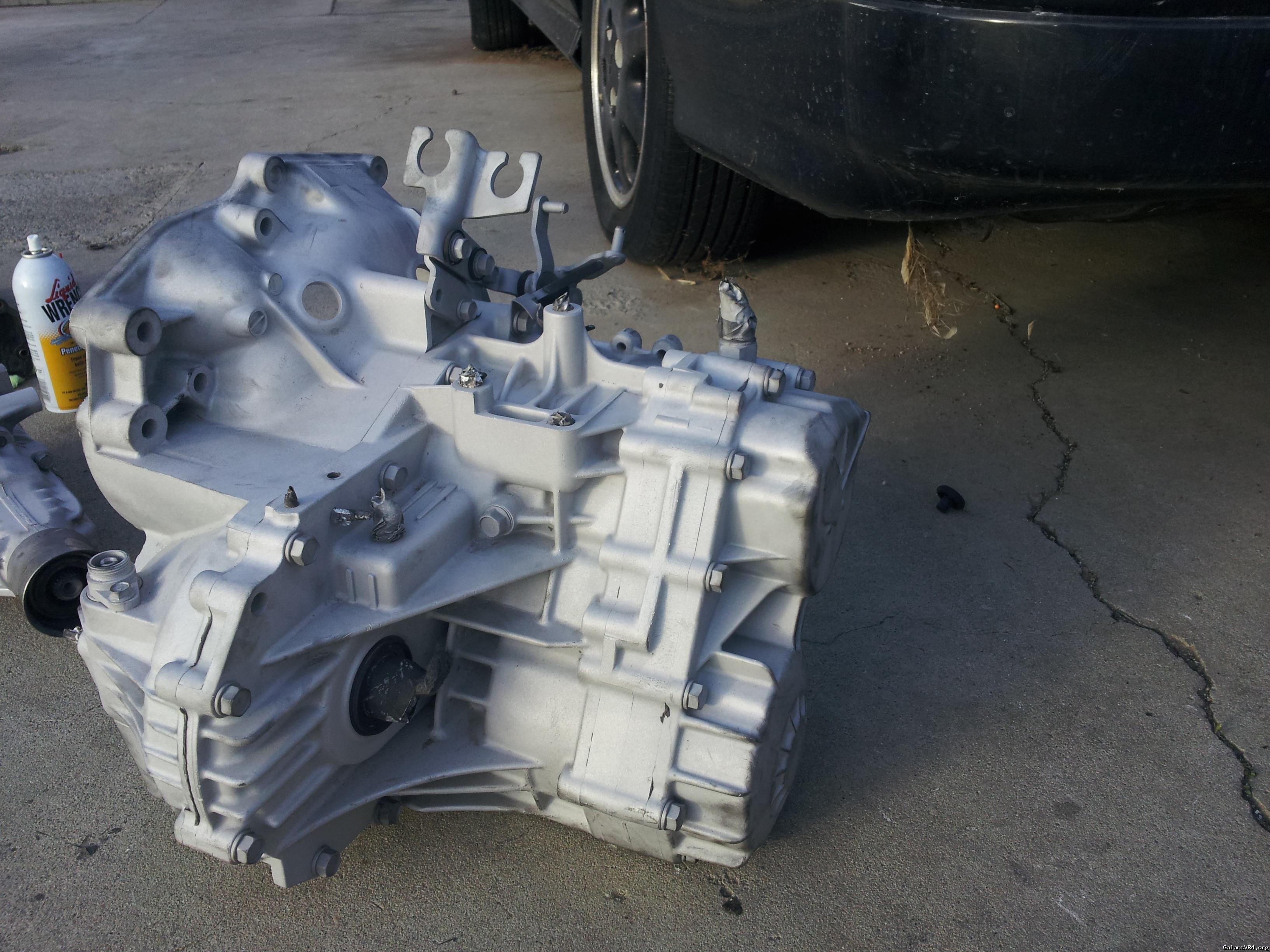

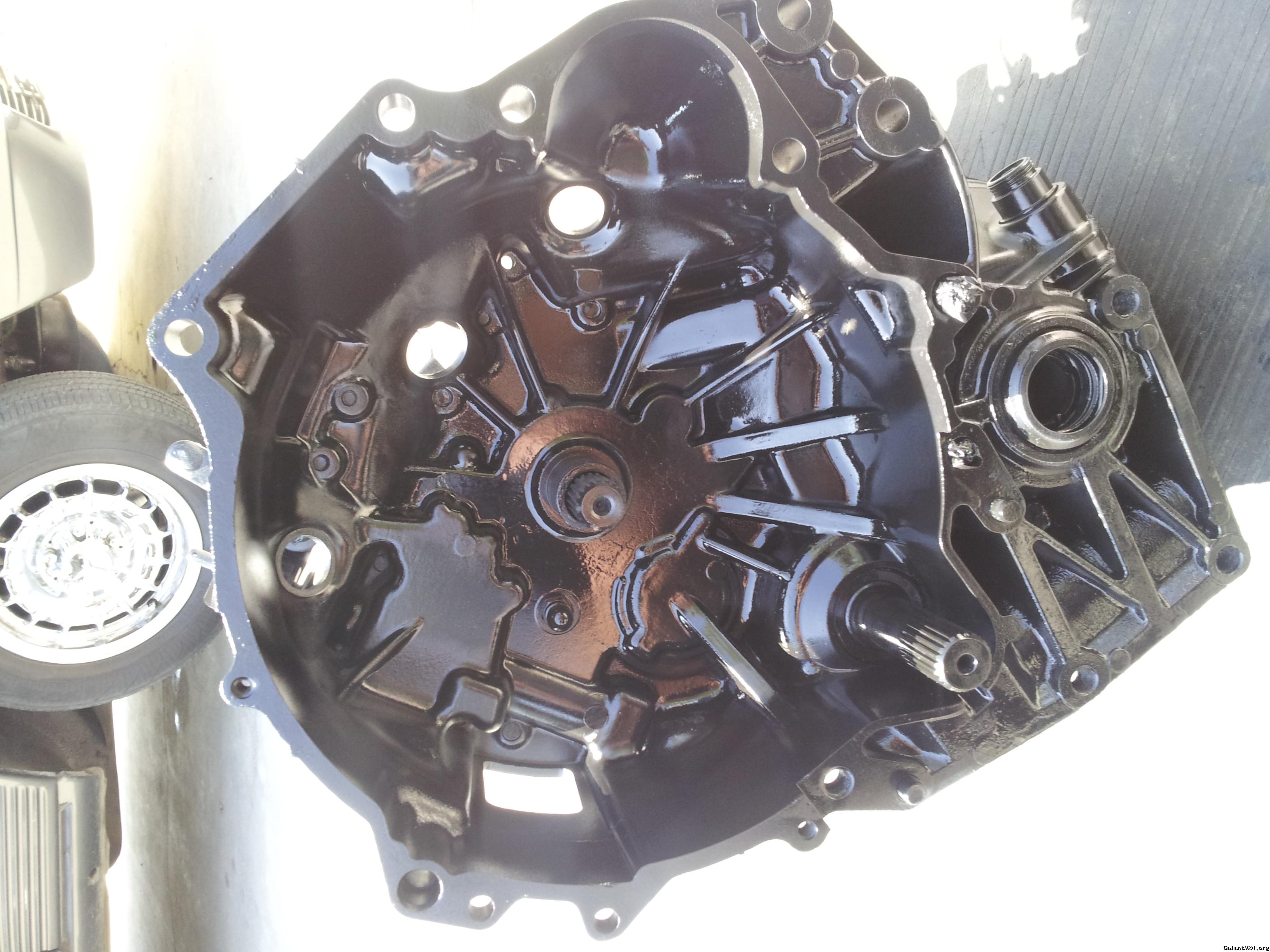

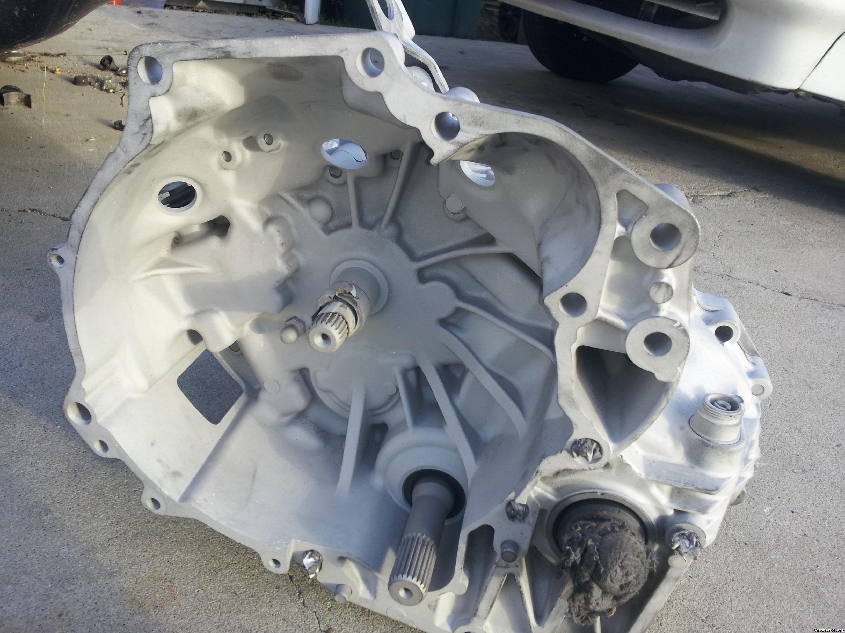

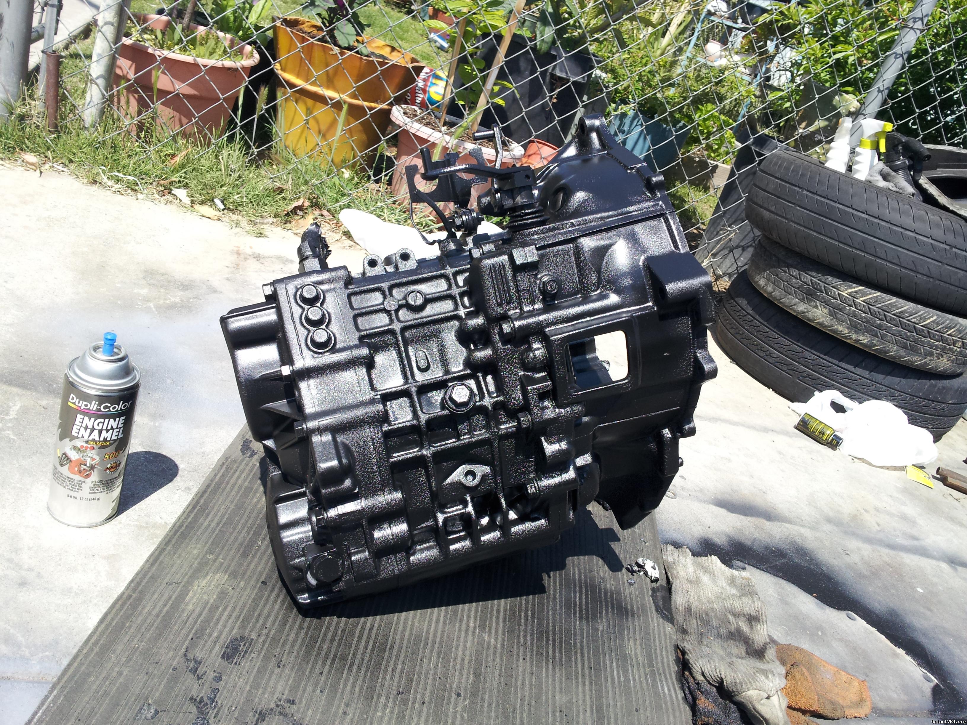

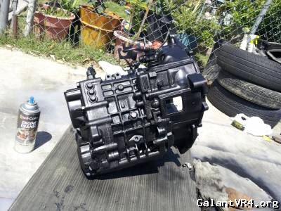

20 year old transmission after a quick power wash

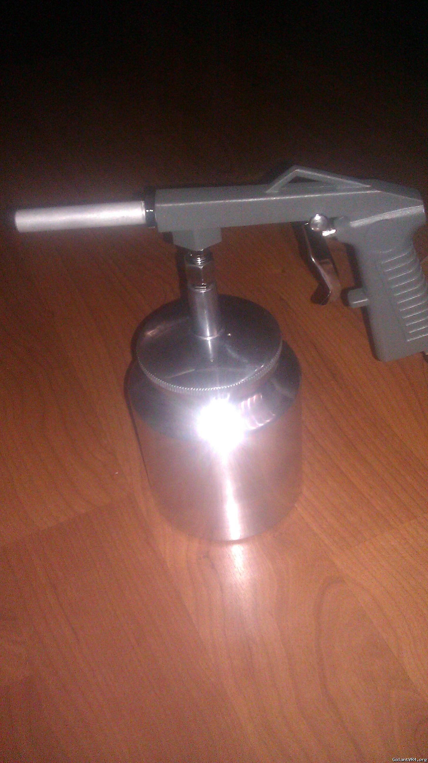

Sand Blasted the Tranny not sure what color I should paint it

Just using stock replacement parts basically? I can't wait to go through all of my drivetrain.
LIV4PSI
Nov 24, 2011
1,774
O-H-I-O
That's a good setup, and all most really need. What about the drivetrain? Did you just clean it up while the engine was out? I can't stand when people put filthy parts back onto the car after they have been removed.
Vr4junkie
Jun 25, 2011
596
Some wack town in CA
Yea perrty much since its out might as well clean it plus I found out we have a sand blaster at work and I can use it when ever I'm on my time off. For the drivetrain im looking into Jacks maybe replace the sncryos get there double 2nd gear still not sure and a 4 bolt rear end when I could find one at the yards.

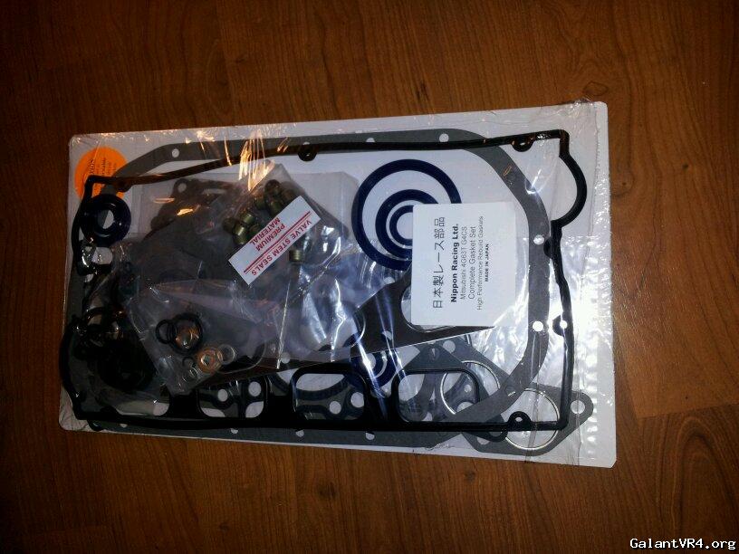

Just got These in the mail /ubbthreads/images/graemlins/smile.gif

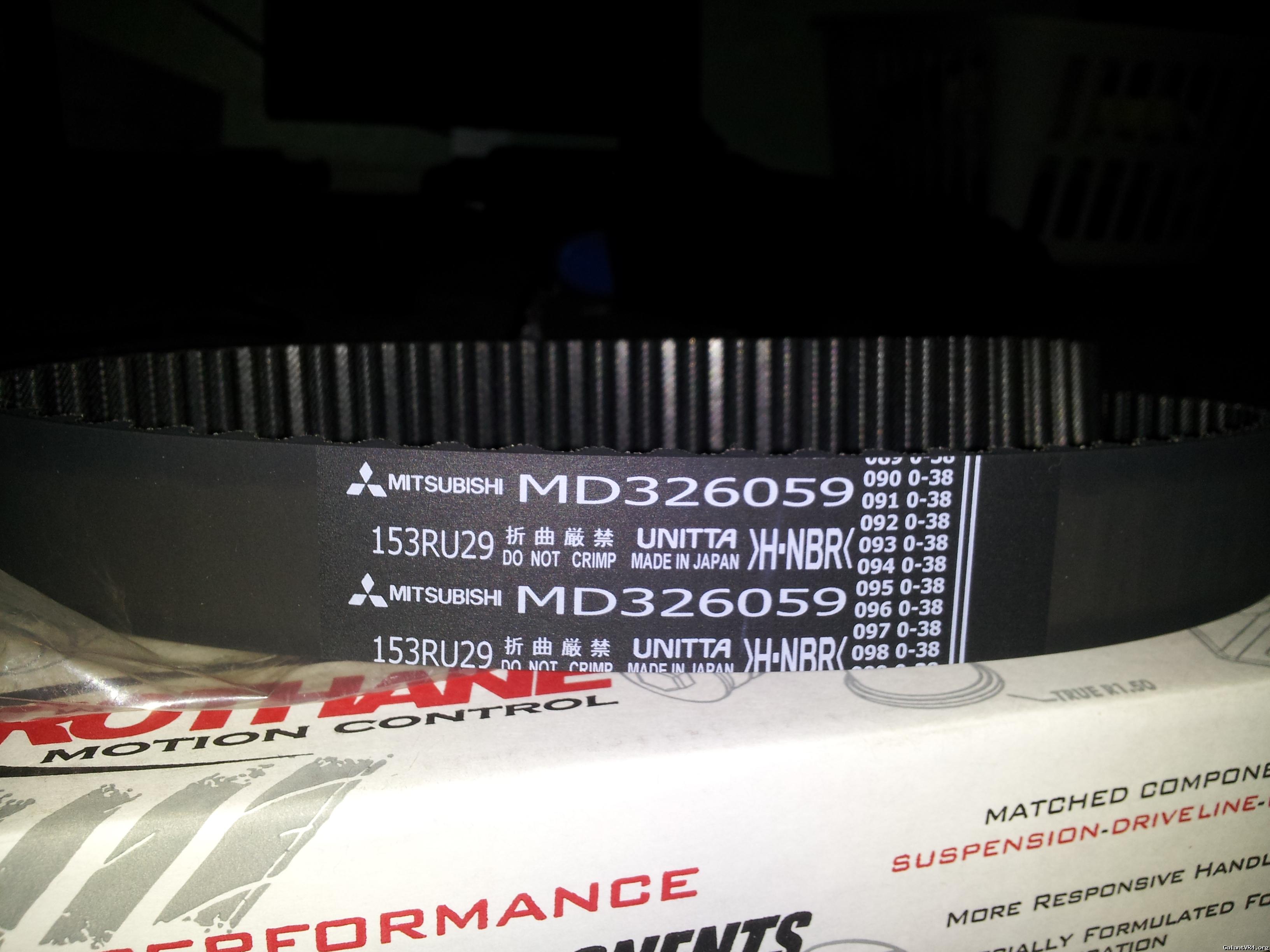

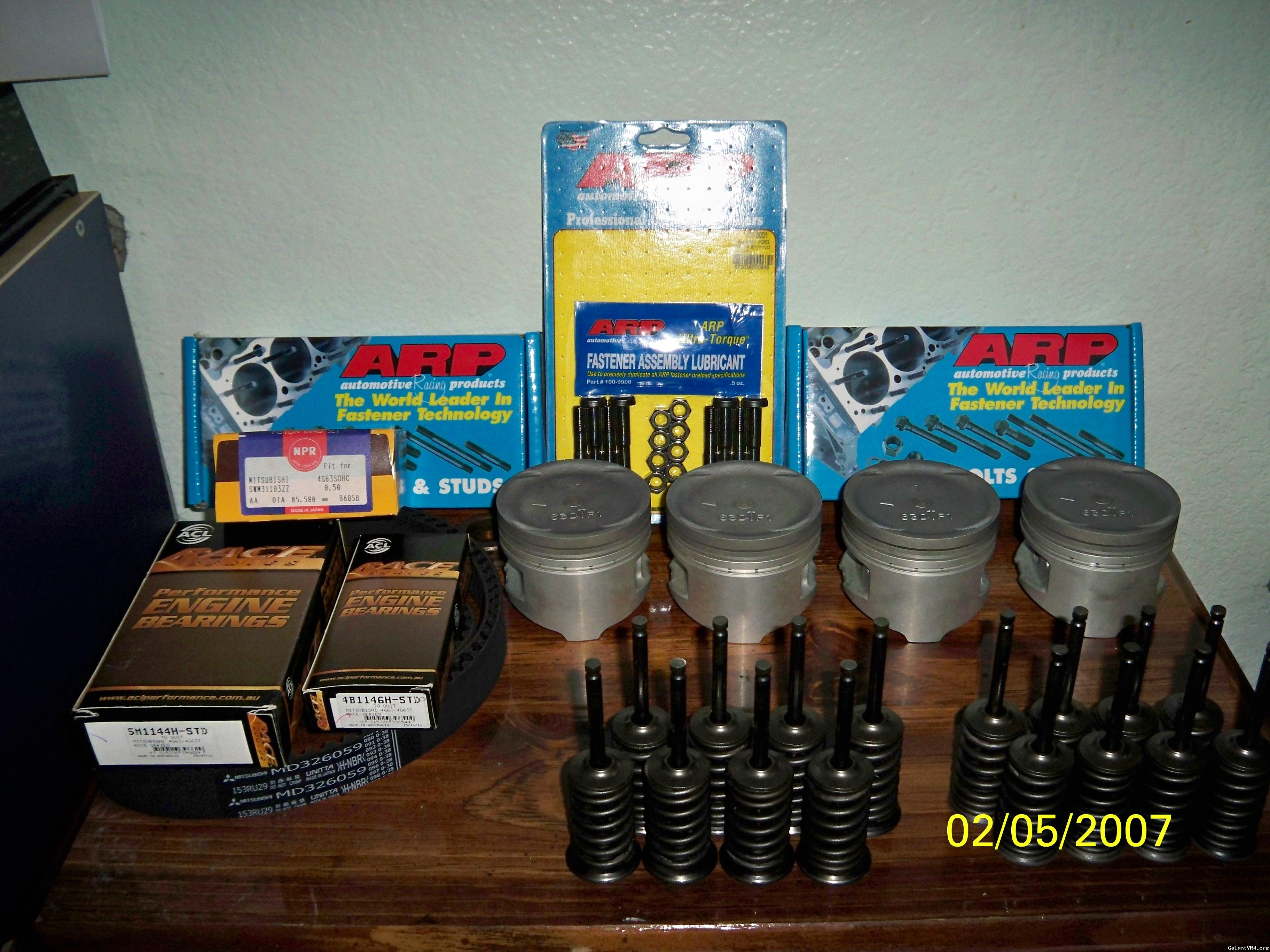

Nippon Full Gasket set

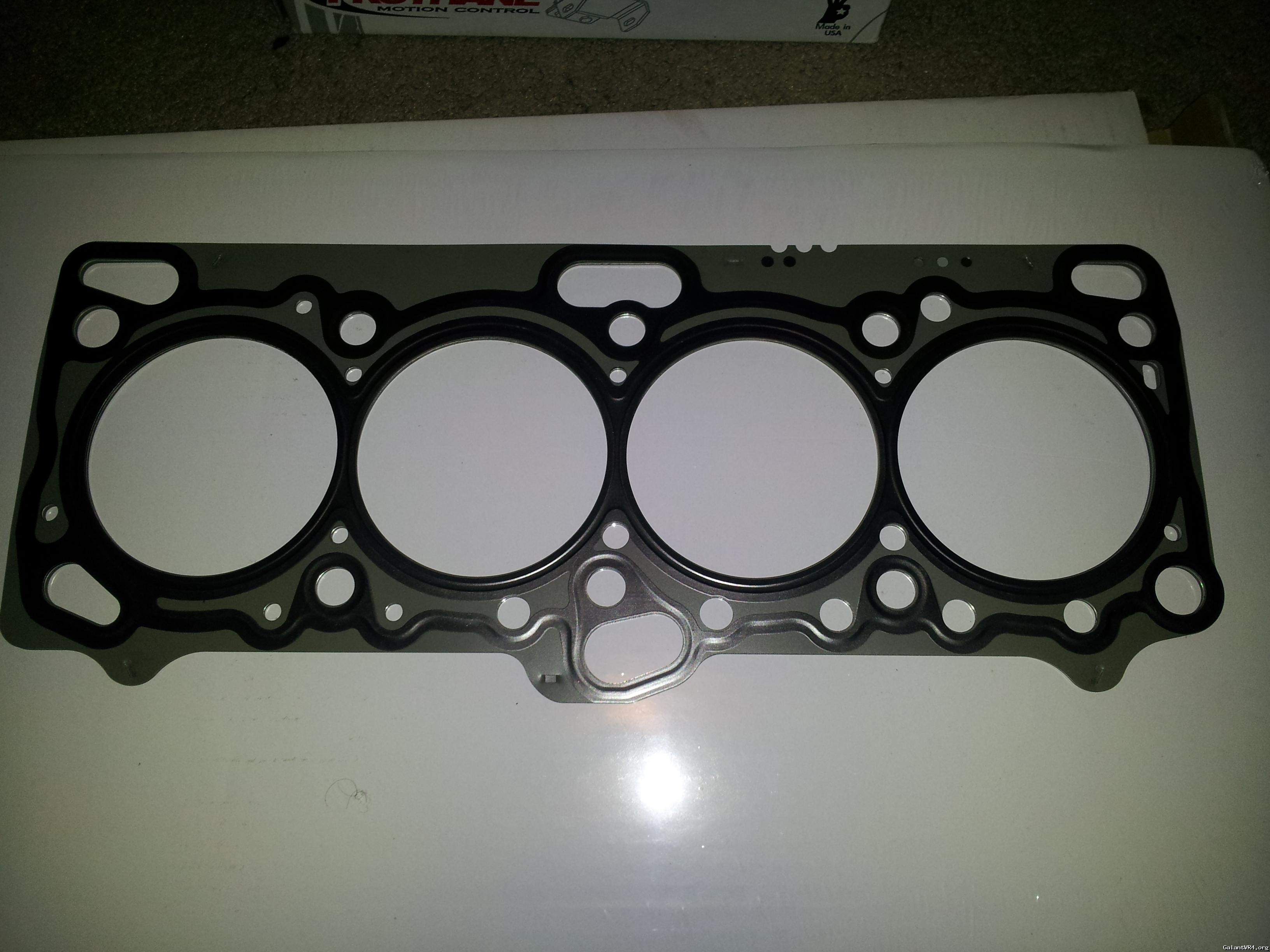

Nippon MLS head gasket
OEM Timing Belt

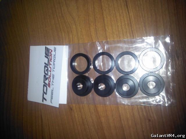

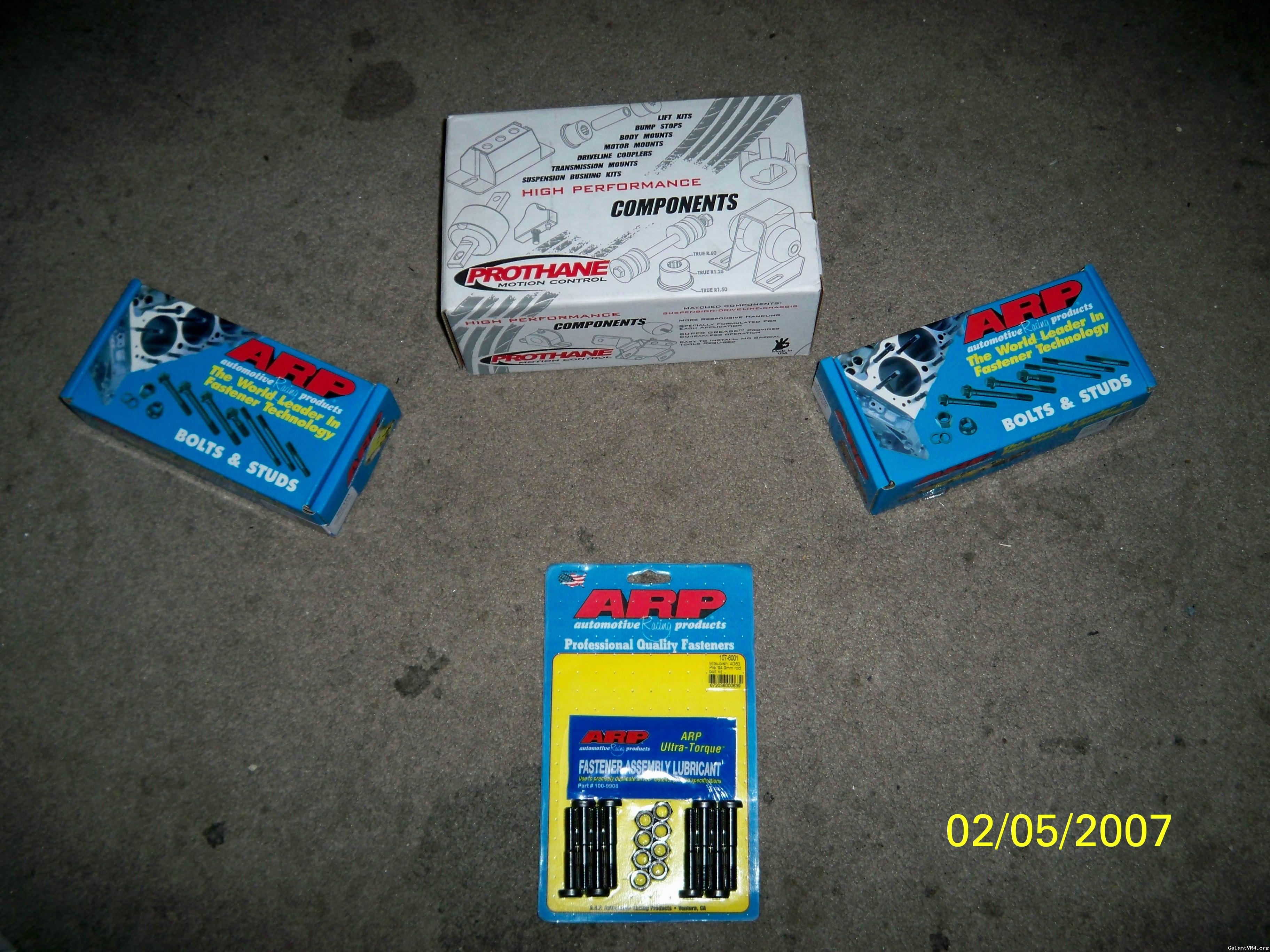

ARP Head Main and Rod Bolts and Prothane Inserts

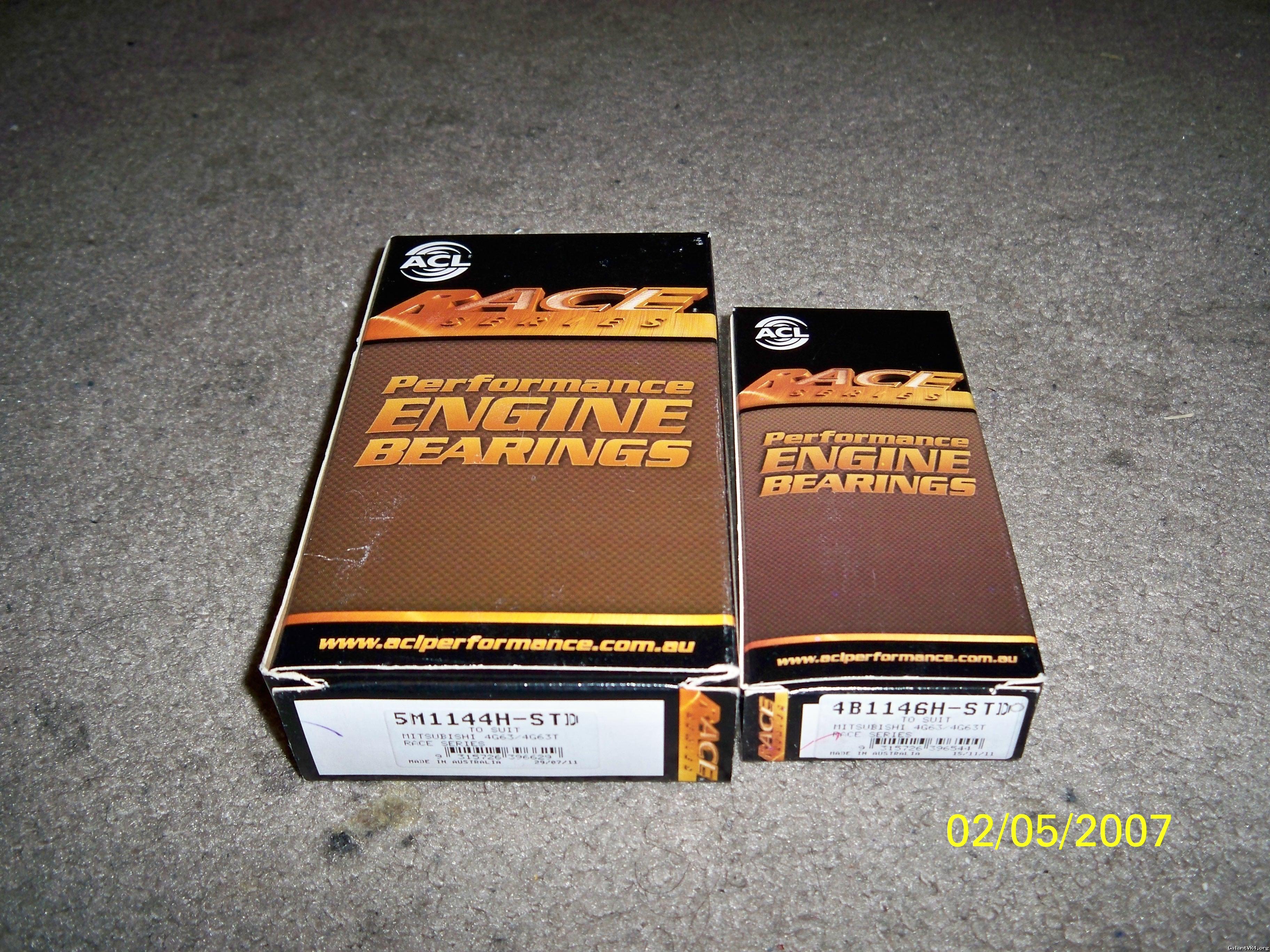

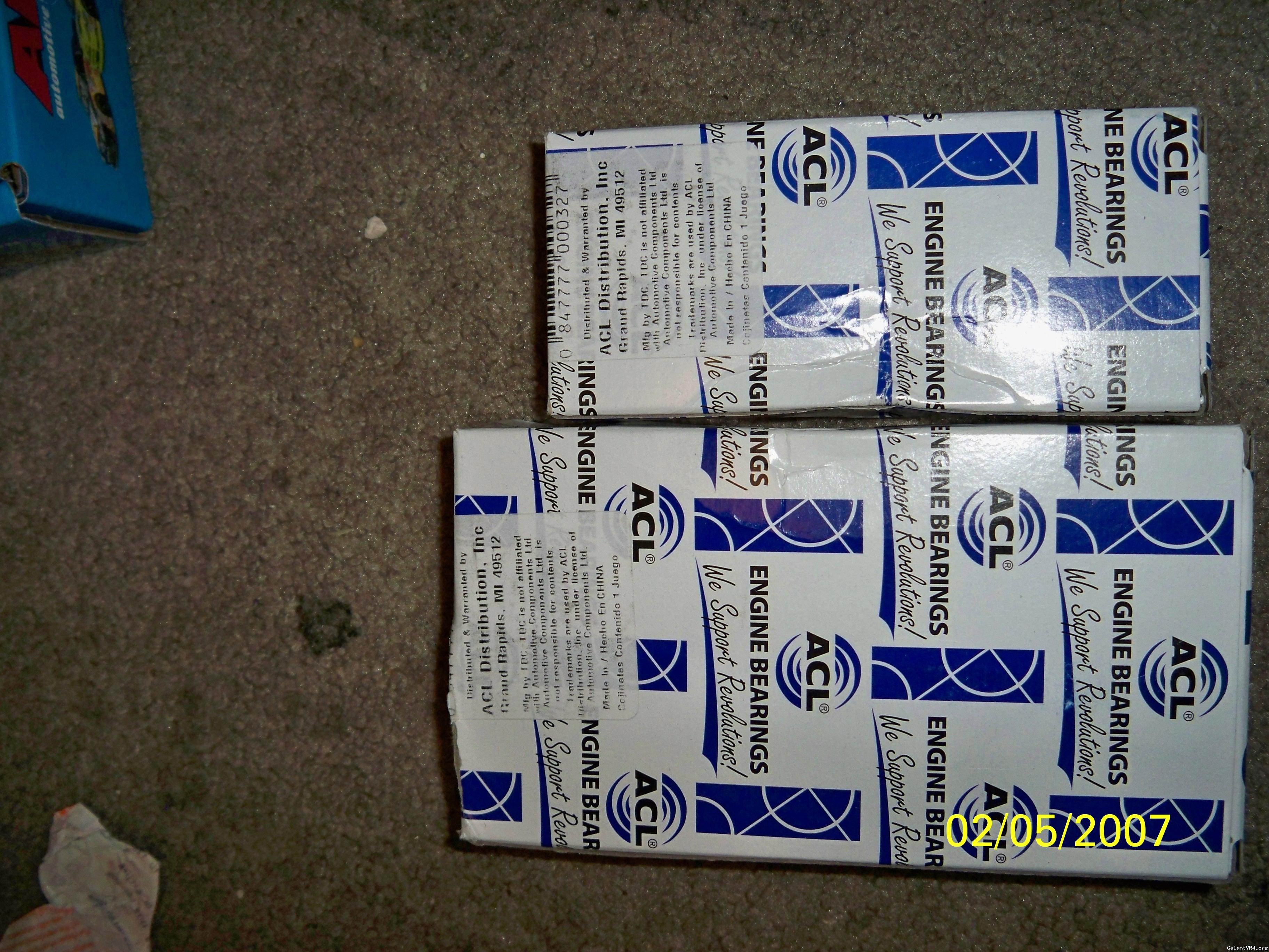

ACL Bearings I was going to use till I saw there were made in CHINA REALLY ACL!!! /ubbthreads/images/graemlins/frown.gif
So I ended up ordering there Race Series Bearings Made In Australia more like it /ubbthreads/images/graemlins/wink.gif

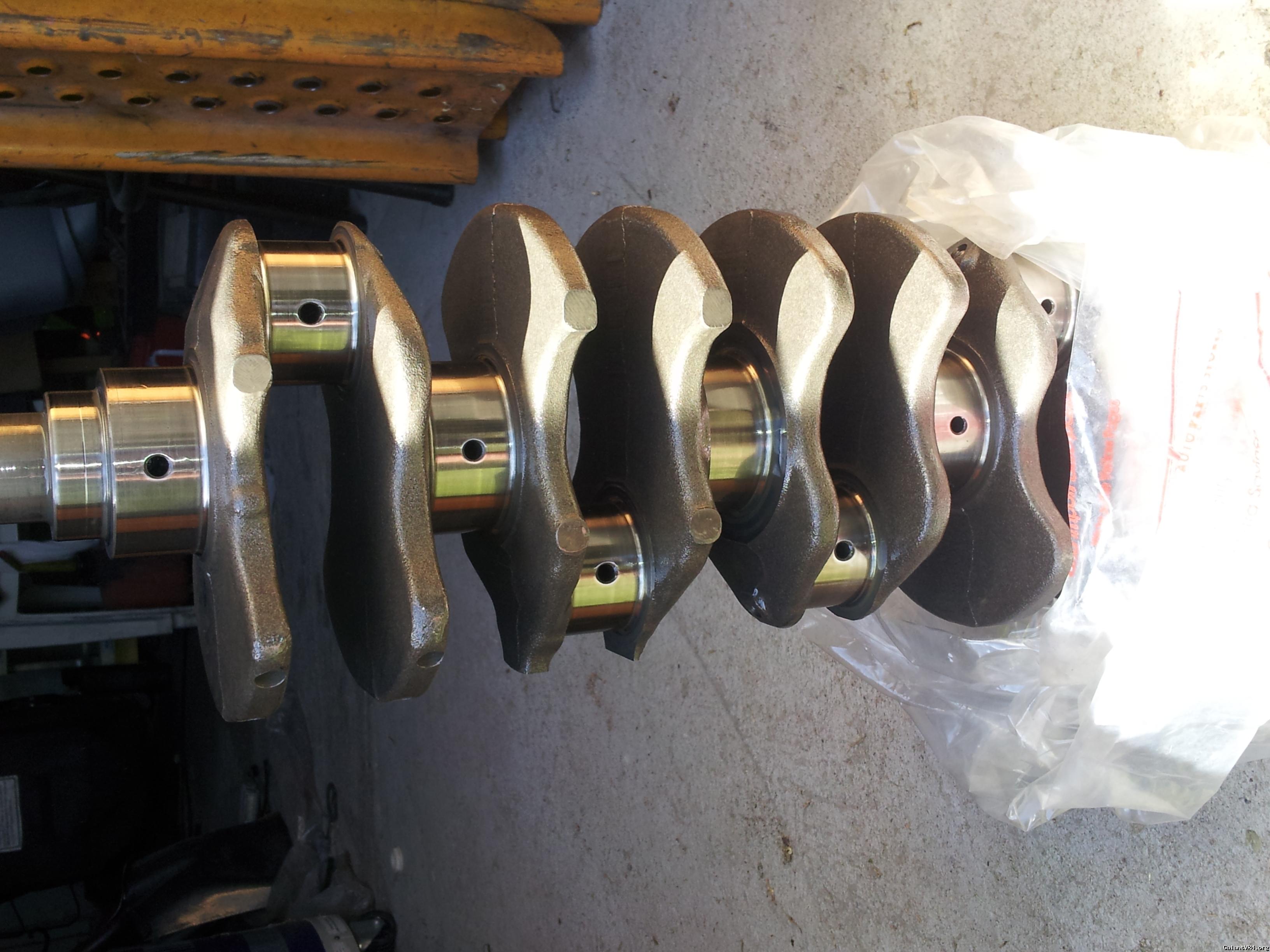

Some of the new toys. /ubbthreads/images/graemlins/grin.gif
Polished Standard size crank.

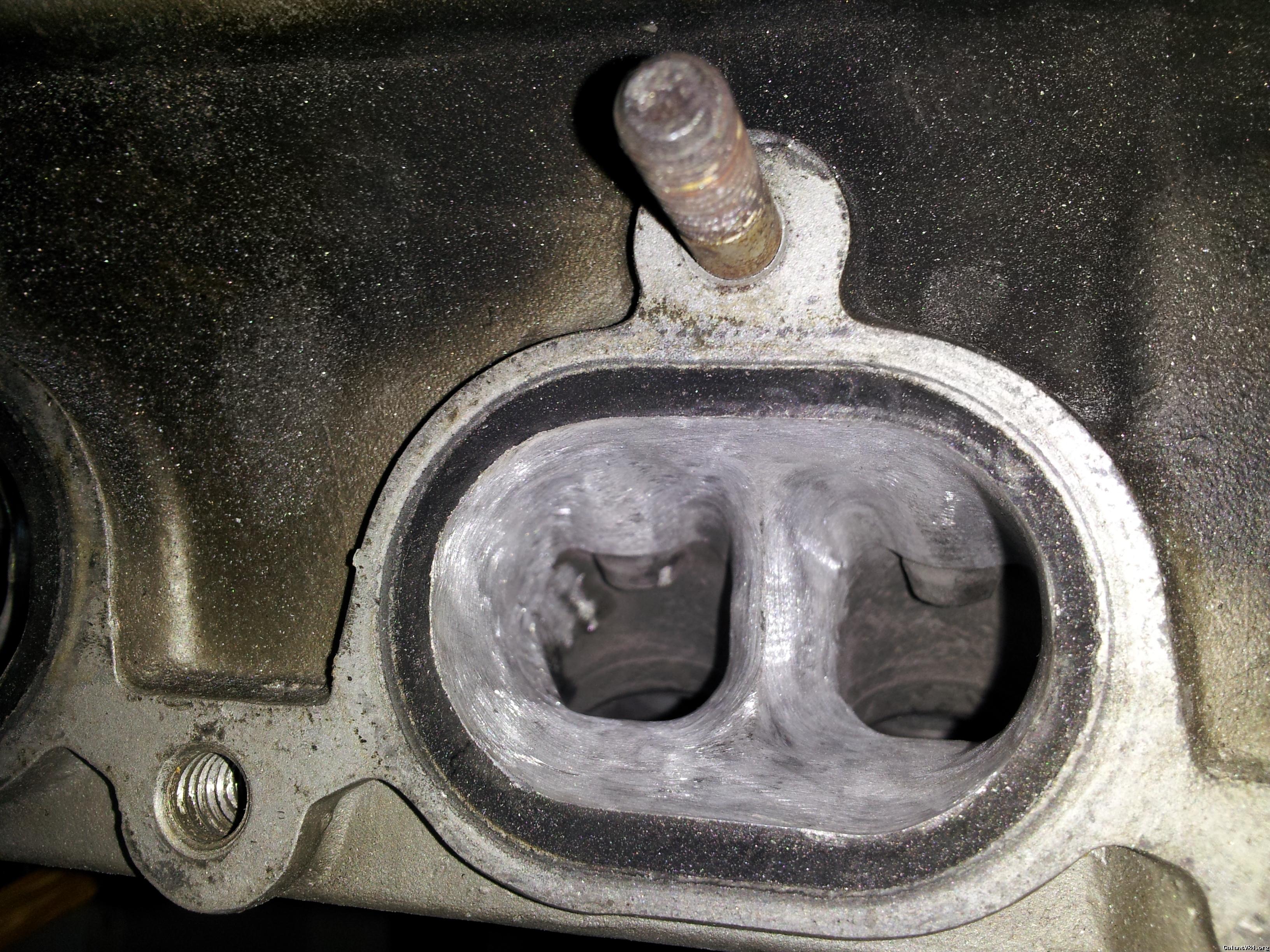

Porting and polishing the head still not close to done.

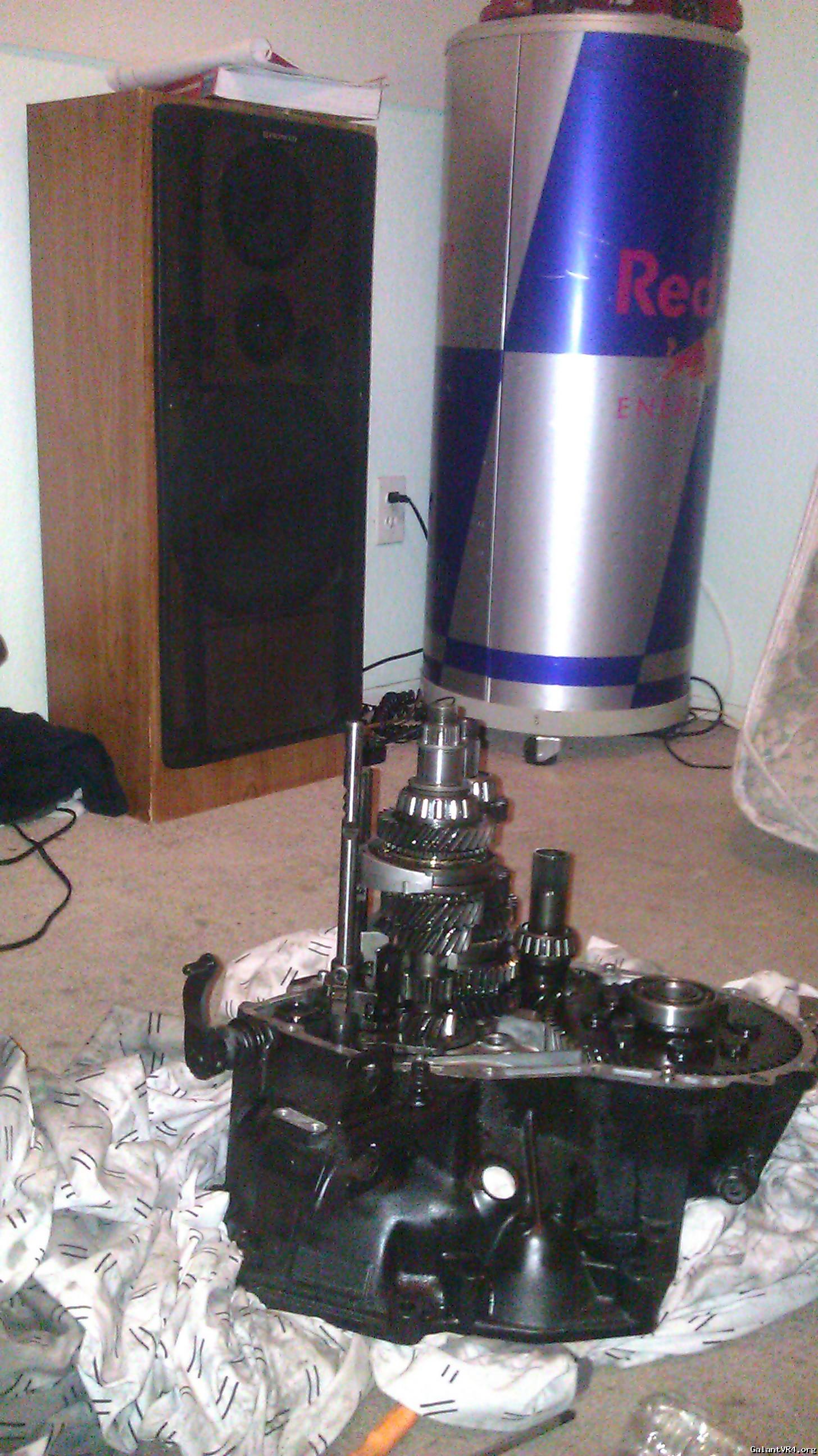

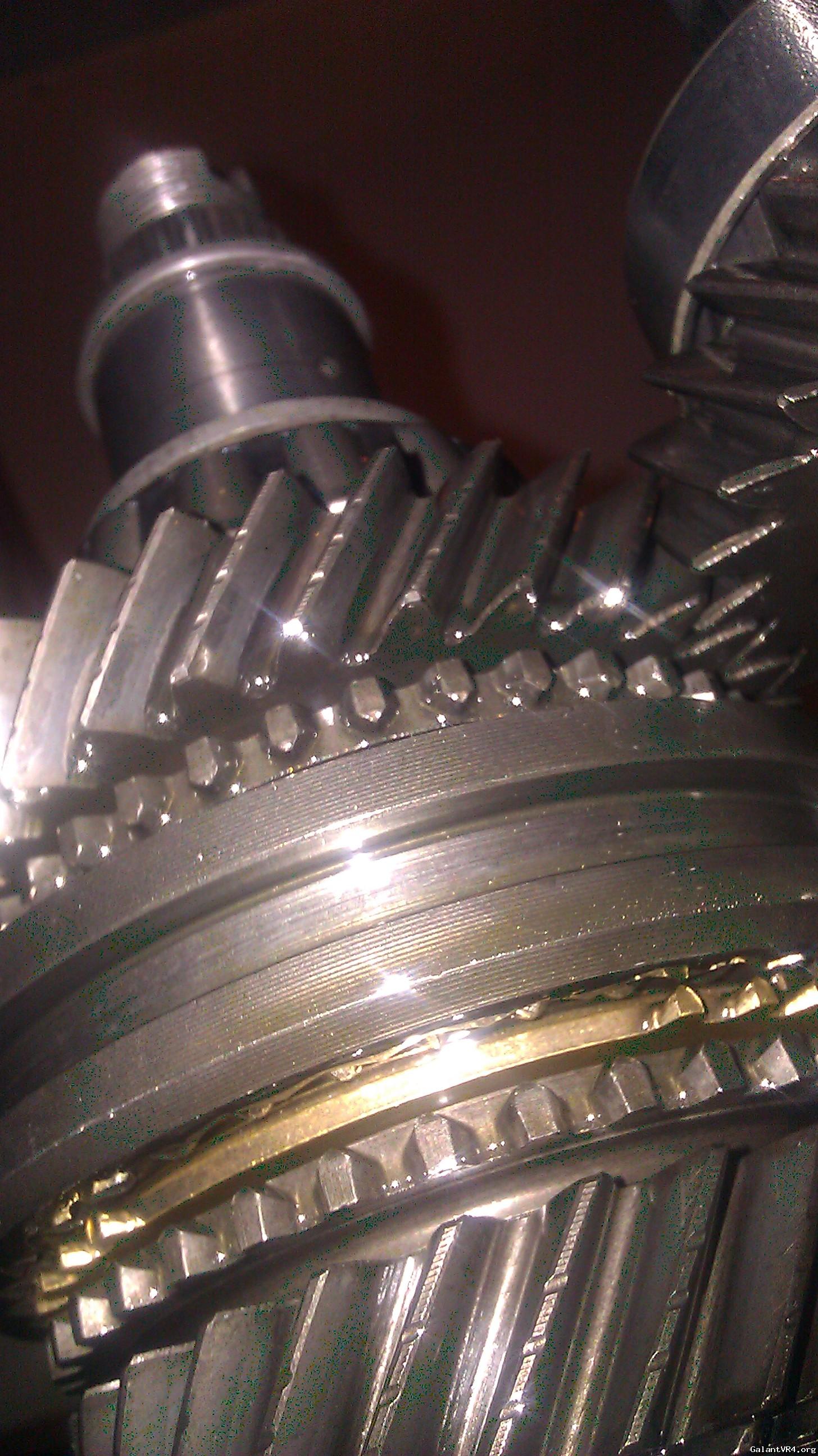

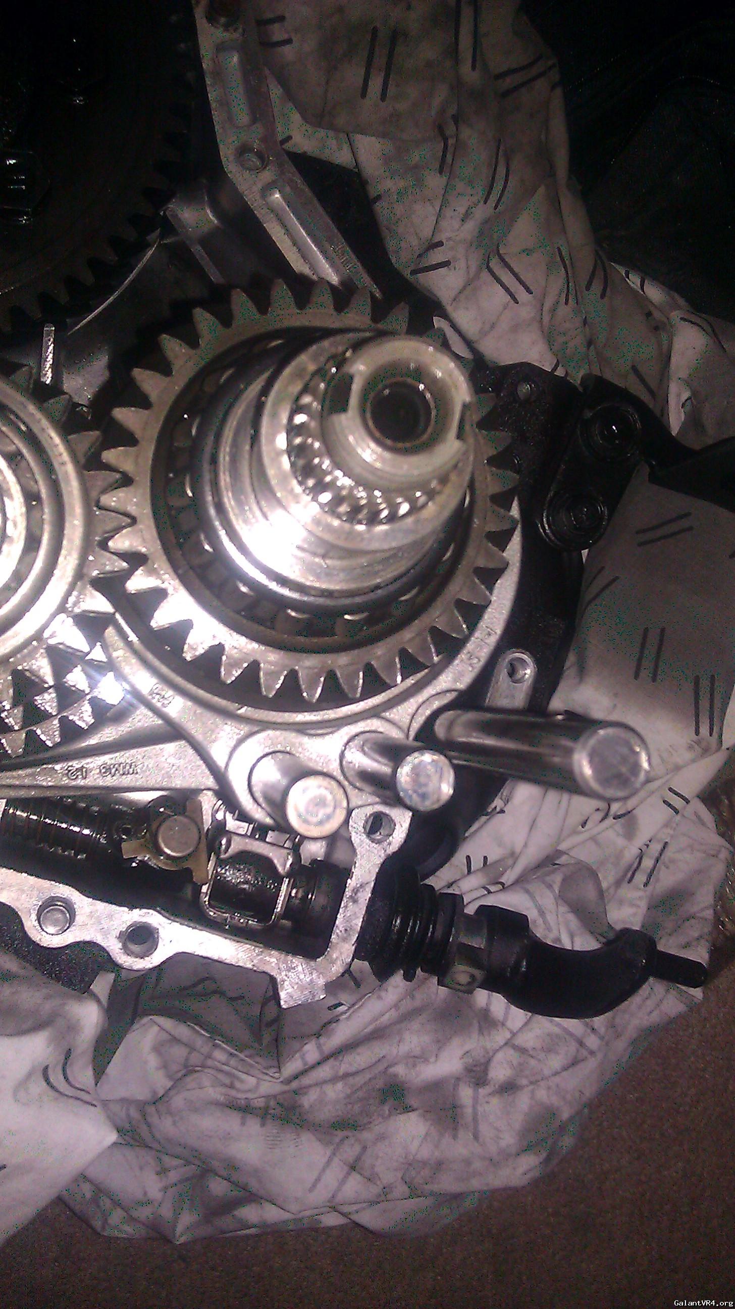

Opening up the tranny
Glad to find out I have this tranny /ubbthreads/images/graemlins/grin.gif click might go for there evo 1st and double syncro 2nd and evo 5th not 100% sure yet

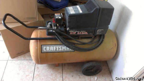

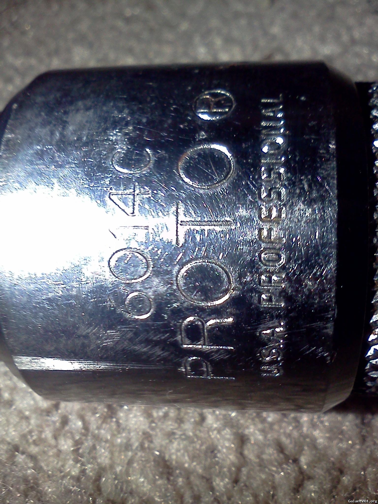

One of my new toys 1/2 50-250ft/tq neighbour sold it to me for 20 big ones /ubbthreads/images/graemlins/grin.gif guess the company he works for is getting all new tools. It was recalibrate last year might be time for another calibration.

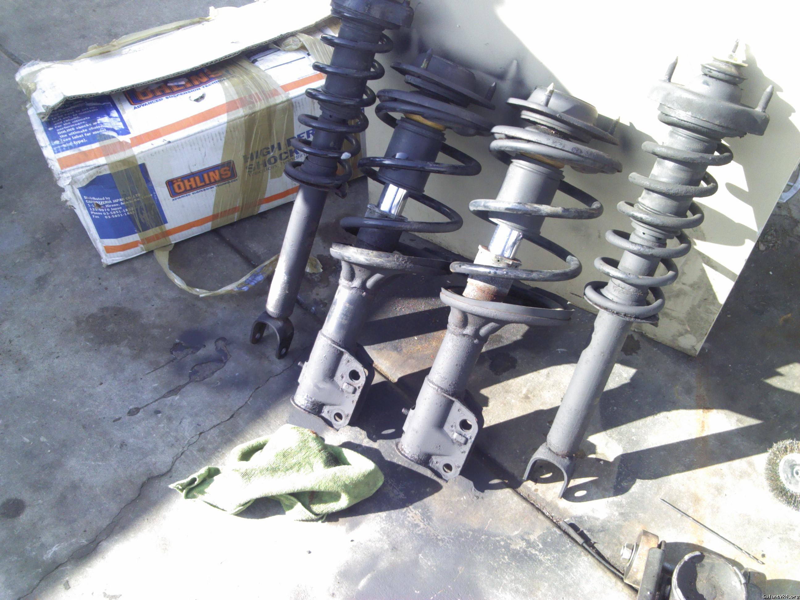

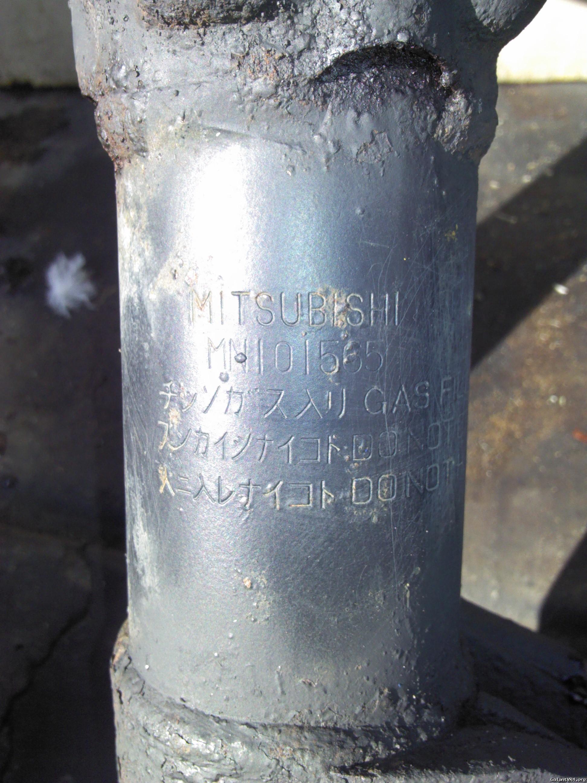

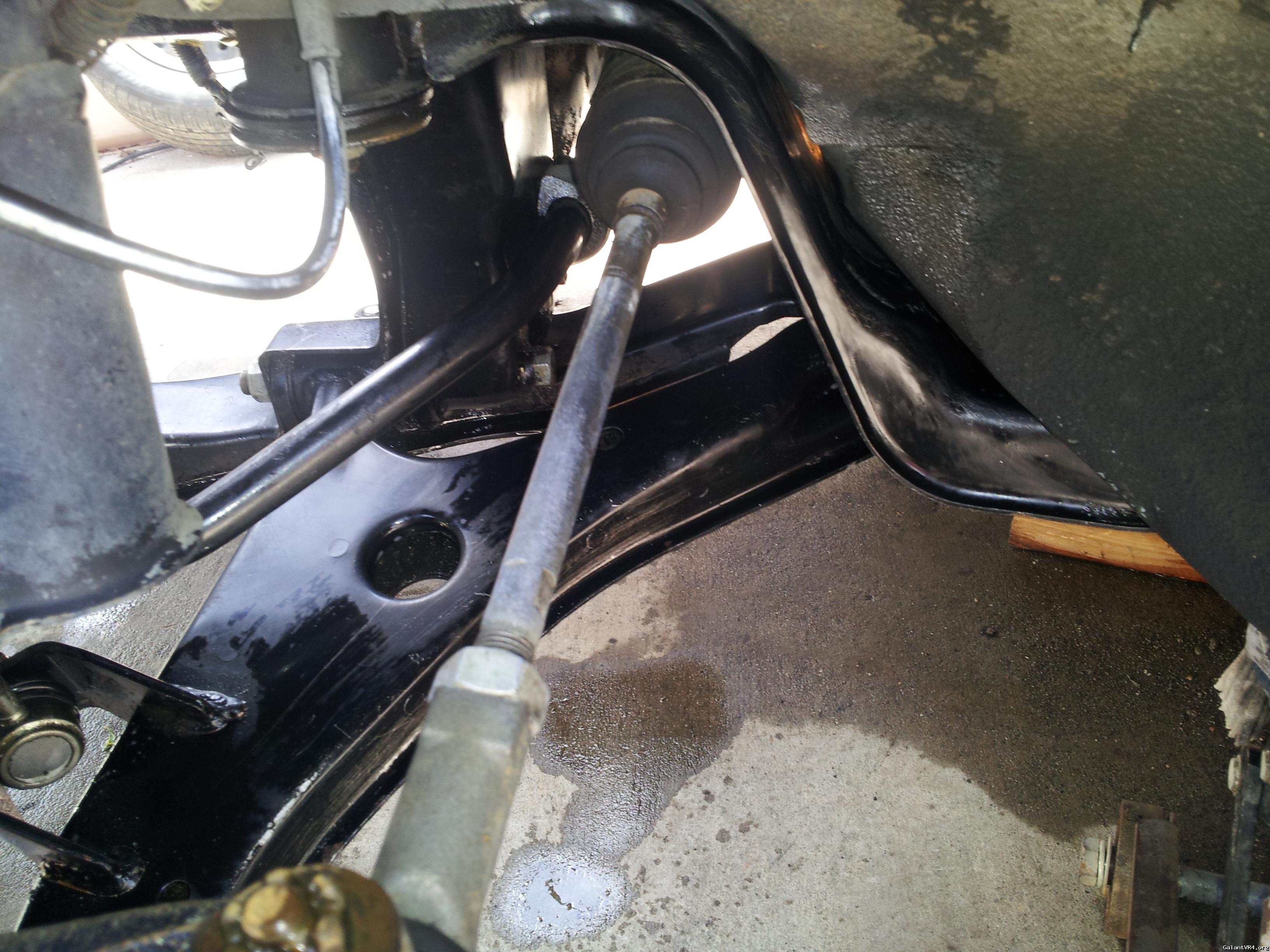

Finally picked up my Evo 9 suspension got it from a guy I met at the Buttonwillow race track just ganna have to sand it down take the surface rust out and give it a coat of paint.
Vr4junkie
Jun 25, 2011
596
Thanks I just sprayed some paint over the rust spots for meanwhile.
Now I just gotta figure if I I want to keep stock springs or get some after market springs any suggestions?
