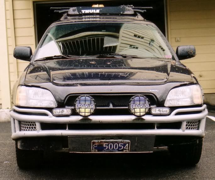

3 inch piping? You're joking right?
something like this is pretty legit:

No I was joking. That is pretty legit. It's going to cover all the area the bumper does and then up a little past the headlights. Why did I not take a CAD program so I could put a rough sketch up...

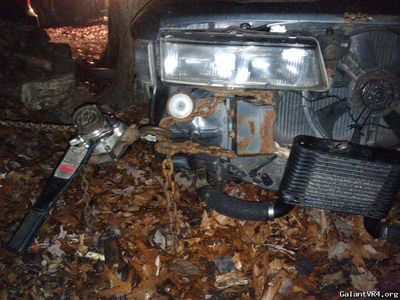

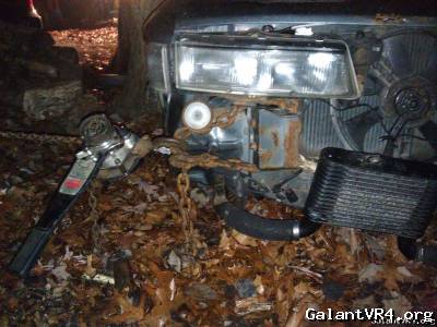

Well I have been bending the front out for a couple days now. leaving pressure on it overnight and coming back the next day to bend both sides evenly. I switched back and forth a couple times and the unibody started separating from the body.... I was curious if anybody had any better idea than trees and chains... I wanted to torch the rails while i was wreching the comealong, but I heard bad things so I didn't try. Anyone else?

Well it is straight enough for the fenders and hood to fit "correctly"...Good enough for now. update with pics. Green face GREY BODY.
