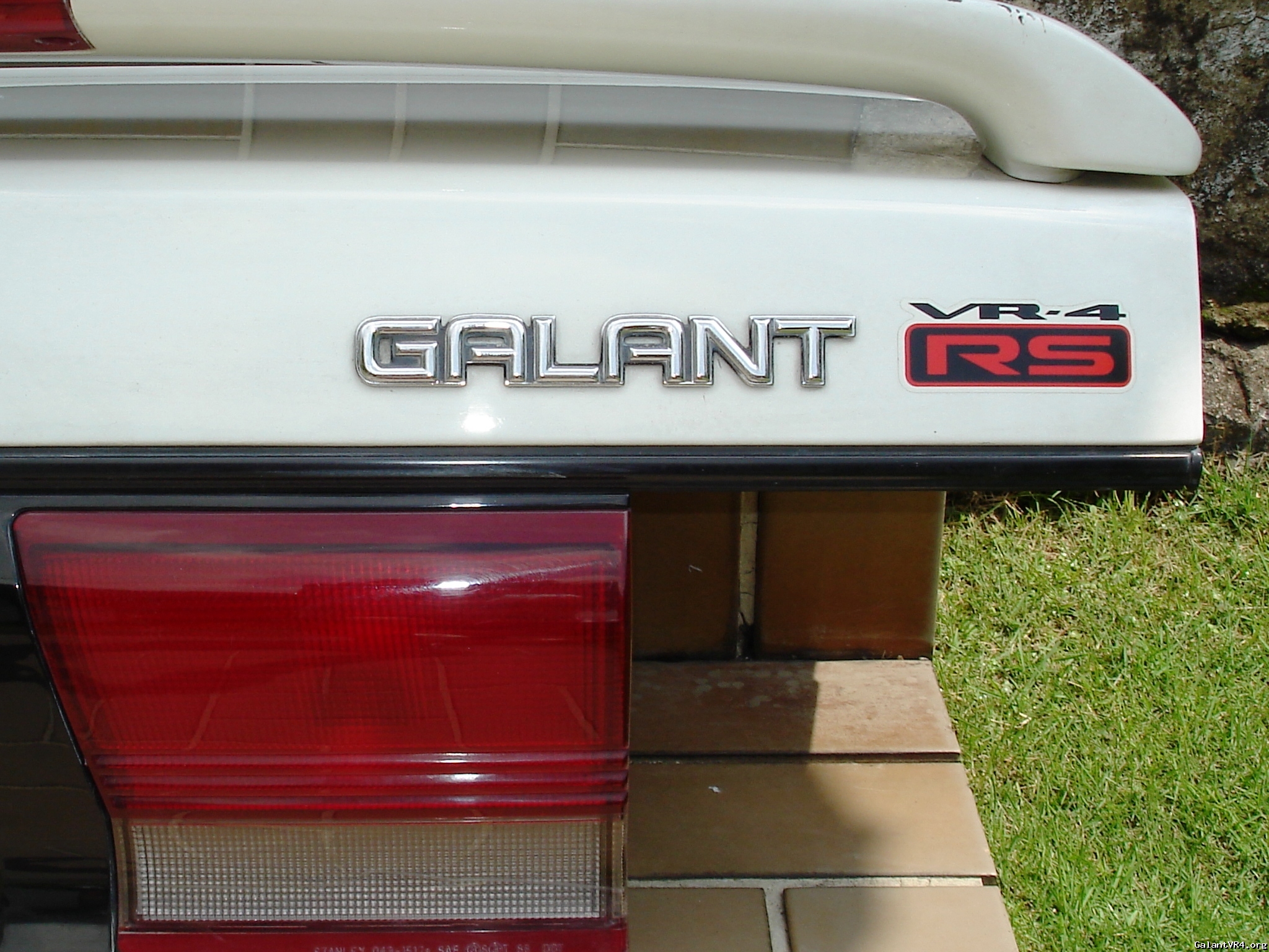

Came from the local importer last week. Saw 2 VR4's cut-up. One was surely an RS based on ; the chassis code (e38a), body color (white),vented hood, bumper with lower slit, manual window winders,yellow top injectors, no 4WS on the rear door and finally, the VR4 RS decal.
I was told the other one was just a standard VR4, so wasn't really interested. However, when i took a look at the parts, I saw these - chassis code e39a, vented hood, bumper with lower slit and yellow top injectors. Judging from these parts, i would say that it is an RS too. What's throwing me off - black in body color, digital a/c, electronic window winders and lastly the decal - VR4 without the RS.
Questions
Paint on the hood and bumper is factory, so is the black one an RS?
Aside from the parts described above, what are the other differences?
Do I take it that the e38a has front and rear LSD's, while the black one only has a rear LSD?
From the RS brochure often posted here, e38a with no4WS has shorter gearing than the one with 4WS?
Of course, in the end, it was a no brainer to buy the e38a. It had additional goodies; a roll bar, a tank guard and a differential guard, OZ mags,aside from a front Cusco strut bar and a Win-sports rear strut bar.

the black one is what has been nicknamed a vr4 evo 0 pretty much the RS engine and drive train minus the short gear ratio, and with all the normal vr4 interior

I believe the E38A came with a 4 bolt rear no 4WS and possibly no ABS. It was the RS equivalent of the EVOs that come without all the electronic skullduggery!

it doesn't have a front LSD, you need an evo 3 trans for that

mitsi called the black one VR4 evolution (it'll have a 4 bolt viscous lsd rear end) and the white one VR4 evolution RS (it'll have a 4 bolt plate lsd rear end).
they also made 'regular' vr4 RS's which had the same 14b turbo, 450cc injectors, etc as the normal vr4 and a 3 bolt plate lsd rear end.

uh yea sorry, plate type = clutch type.
A front lsd may have been available as an option, like it was on the RS evo lancers.

88 model e38a. does this car have a 4 bolt rear or is it 3 bolt.
car has no climate control, no rear wiper. i would check it out, but the car is in another country
H05TYL
Jun 9, 2007
752
Wgtn, NZ
it'll have a 3 bolt plate lsd. (I've got two of these diffs myself, good handling upgrade)
