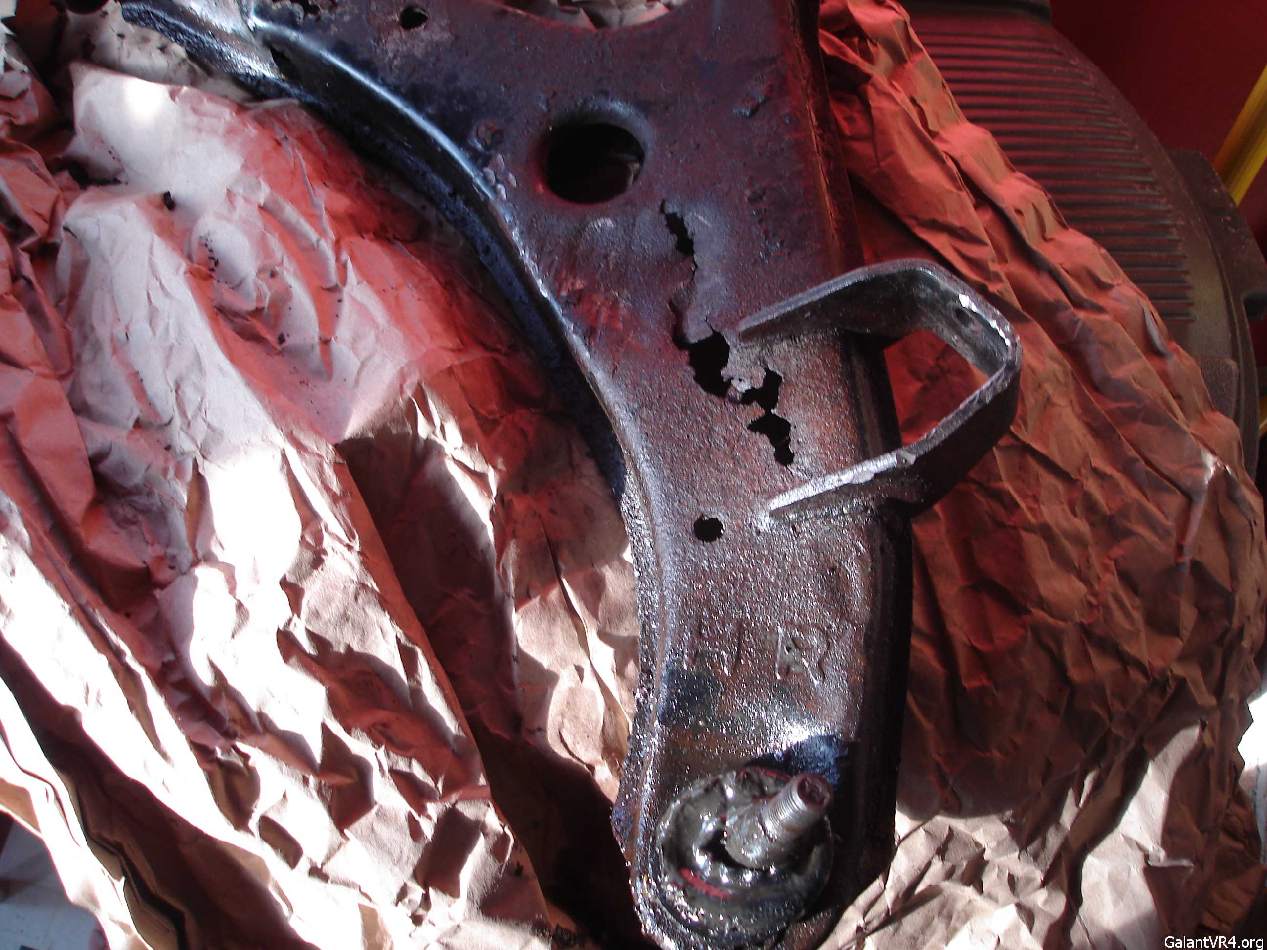

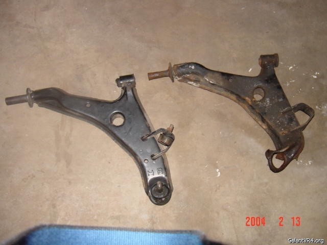

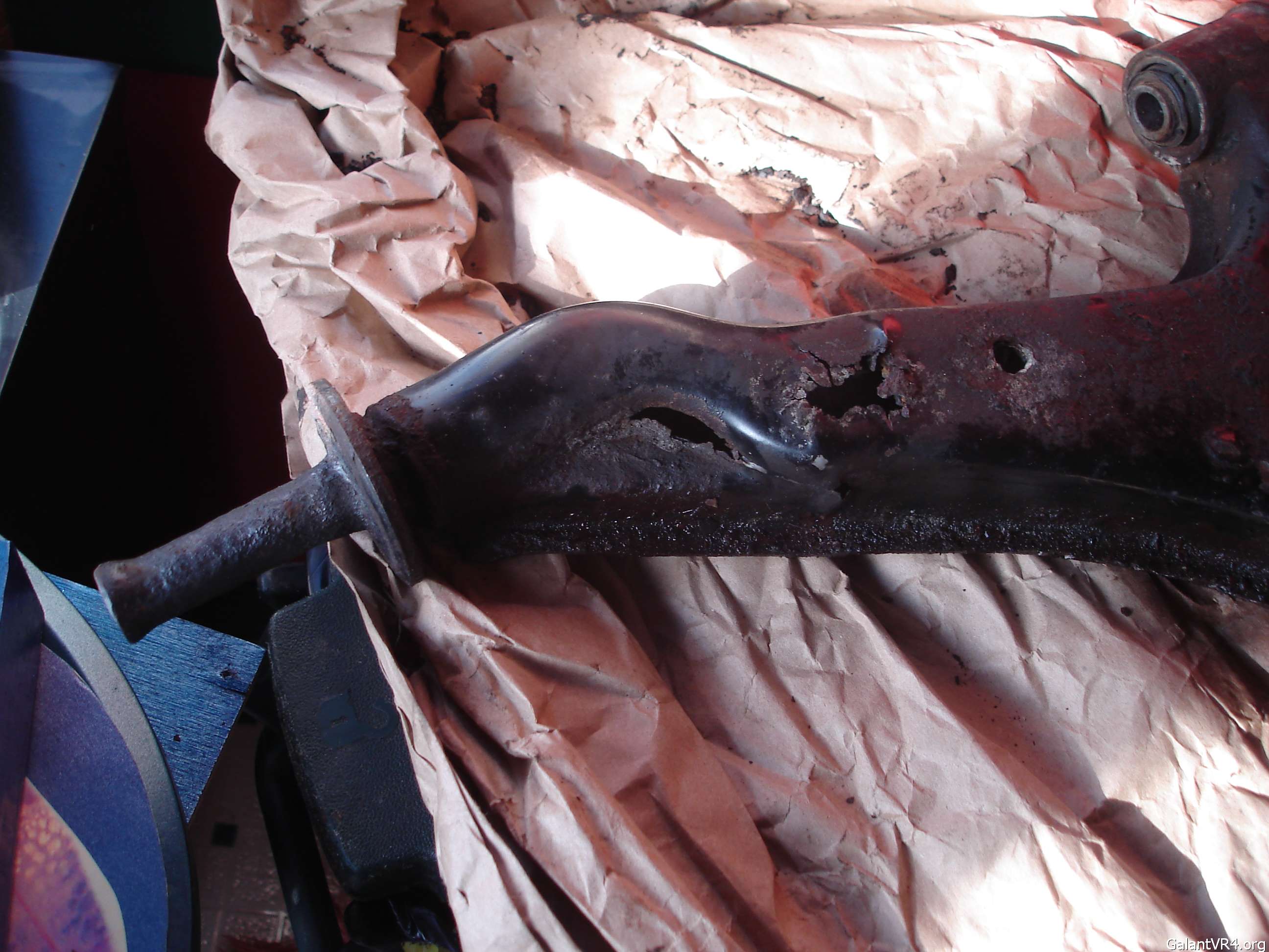

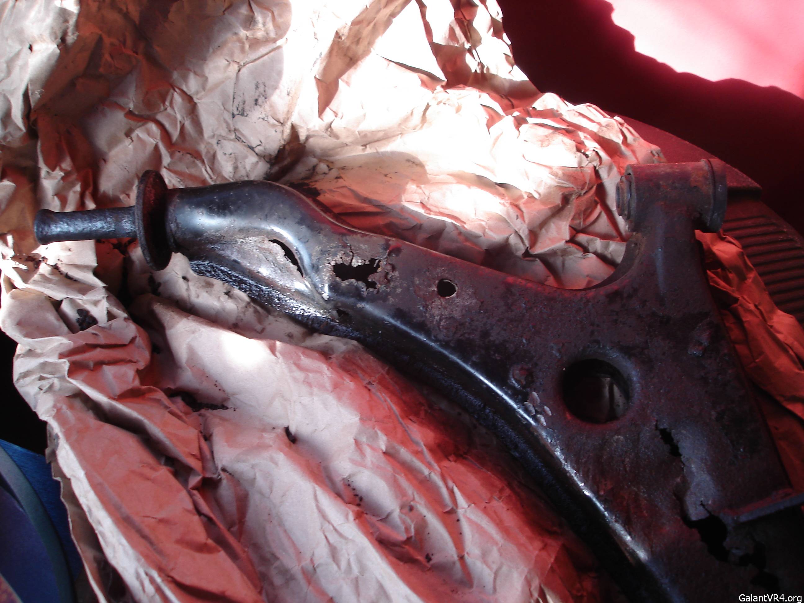

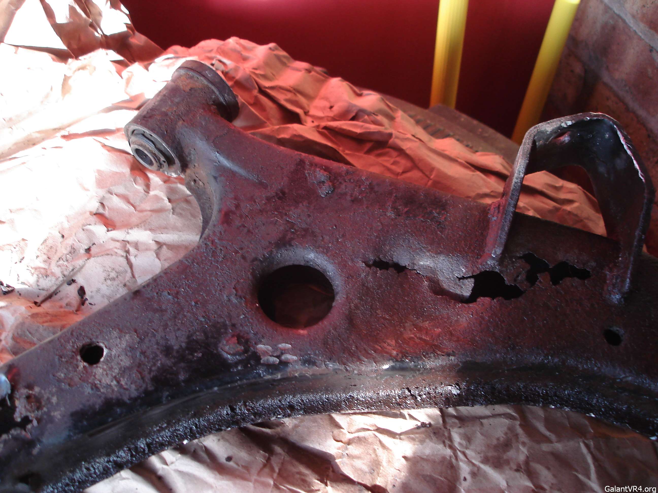

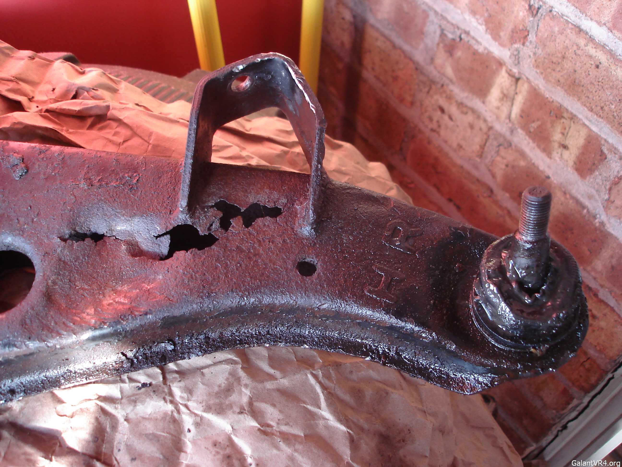

Here are some pictures of the old control arm.

holly mother of rust /ubbthreads/images/graemlins/uhh.gif /ubbthreads/images/graemlins/uhh.gif

OHG!!!! is that rust??? If so, I would replace all of the remaining arms on the car just to be safe.
