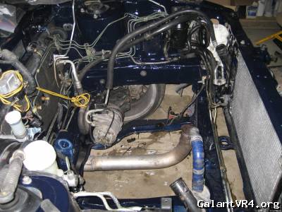

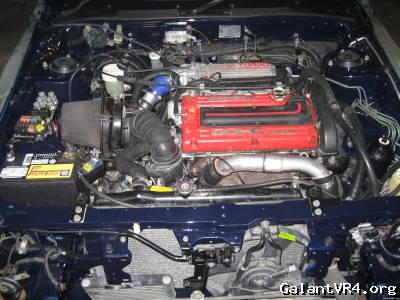

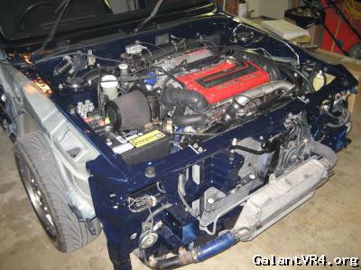

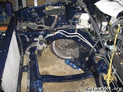

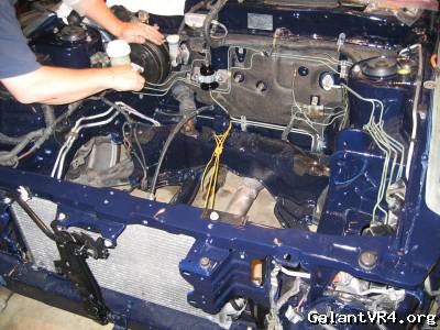

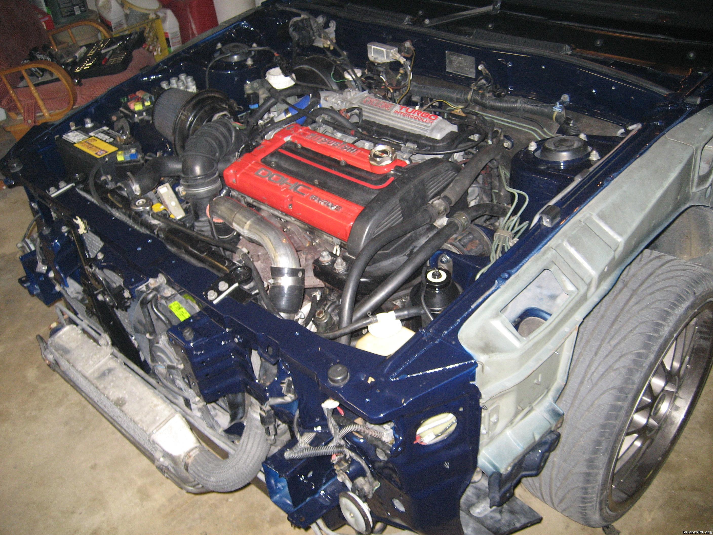

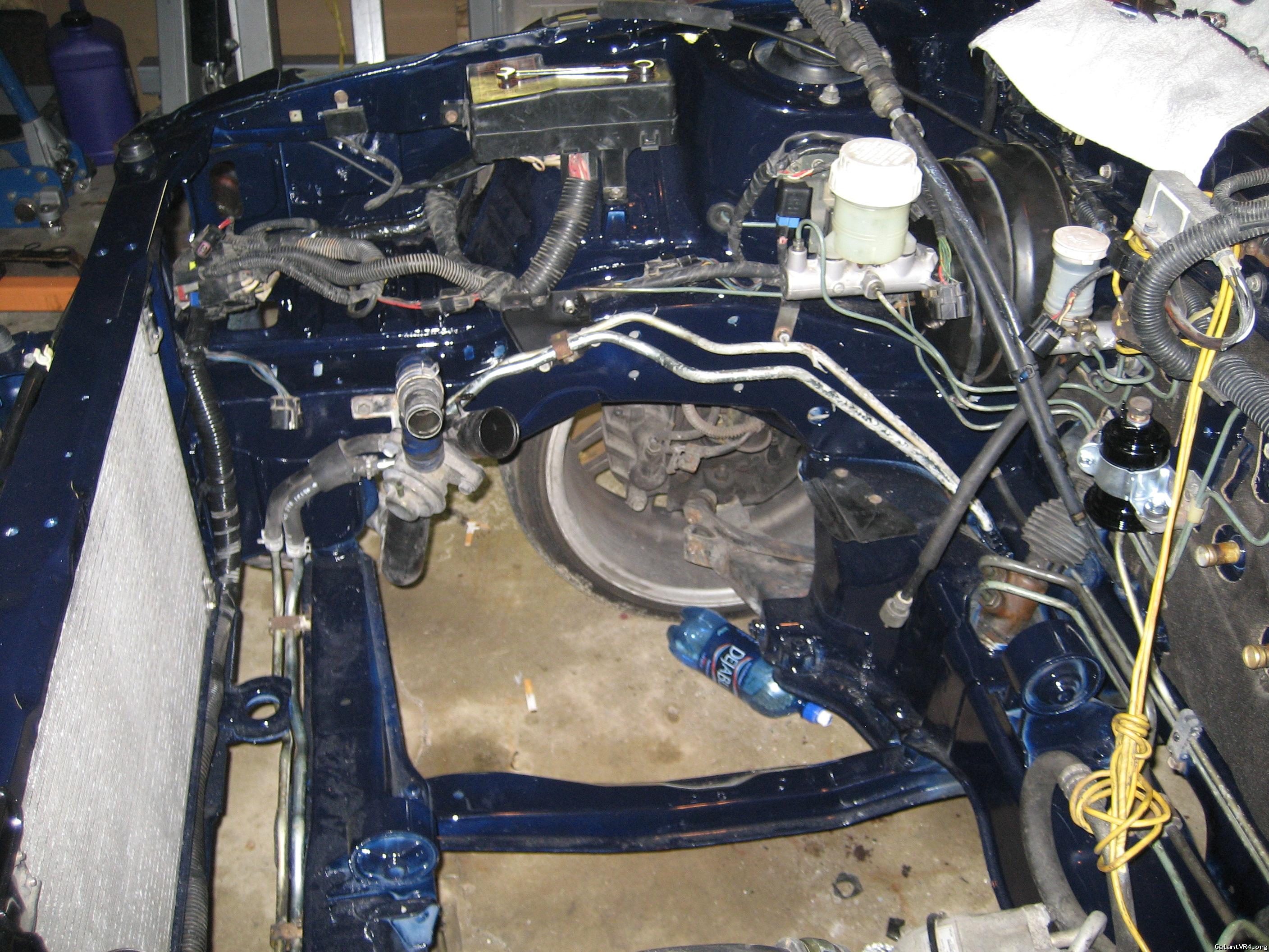

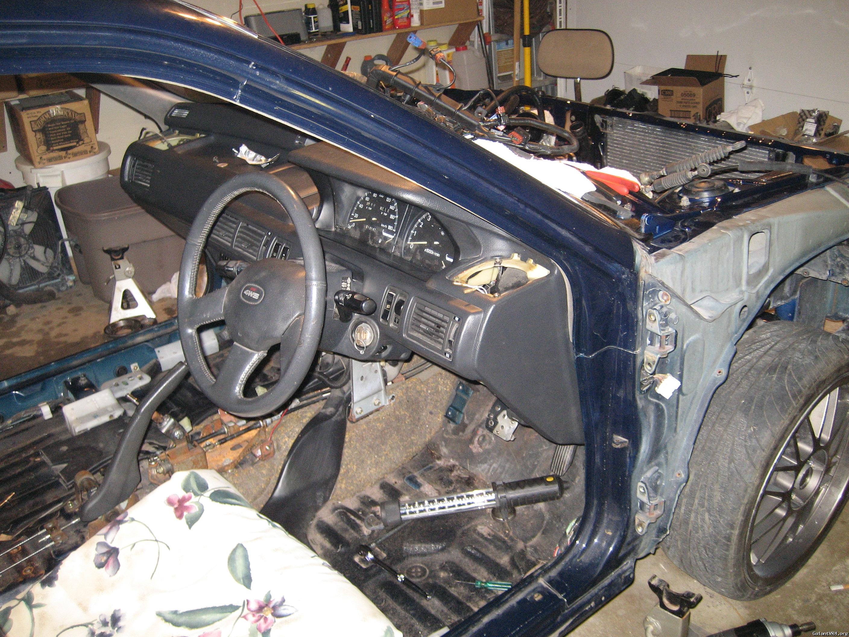

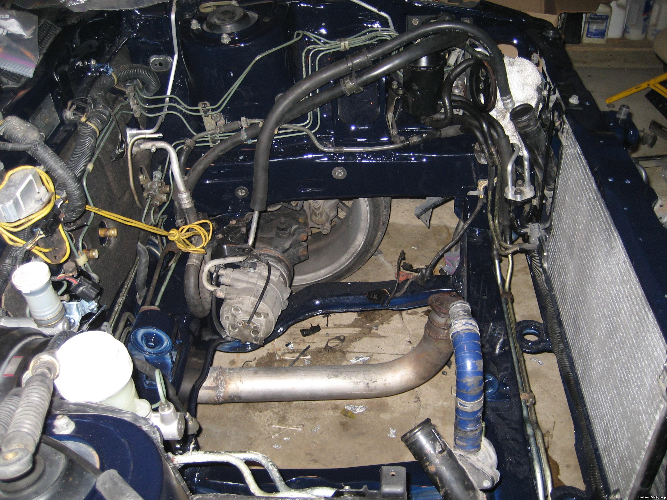

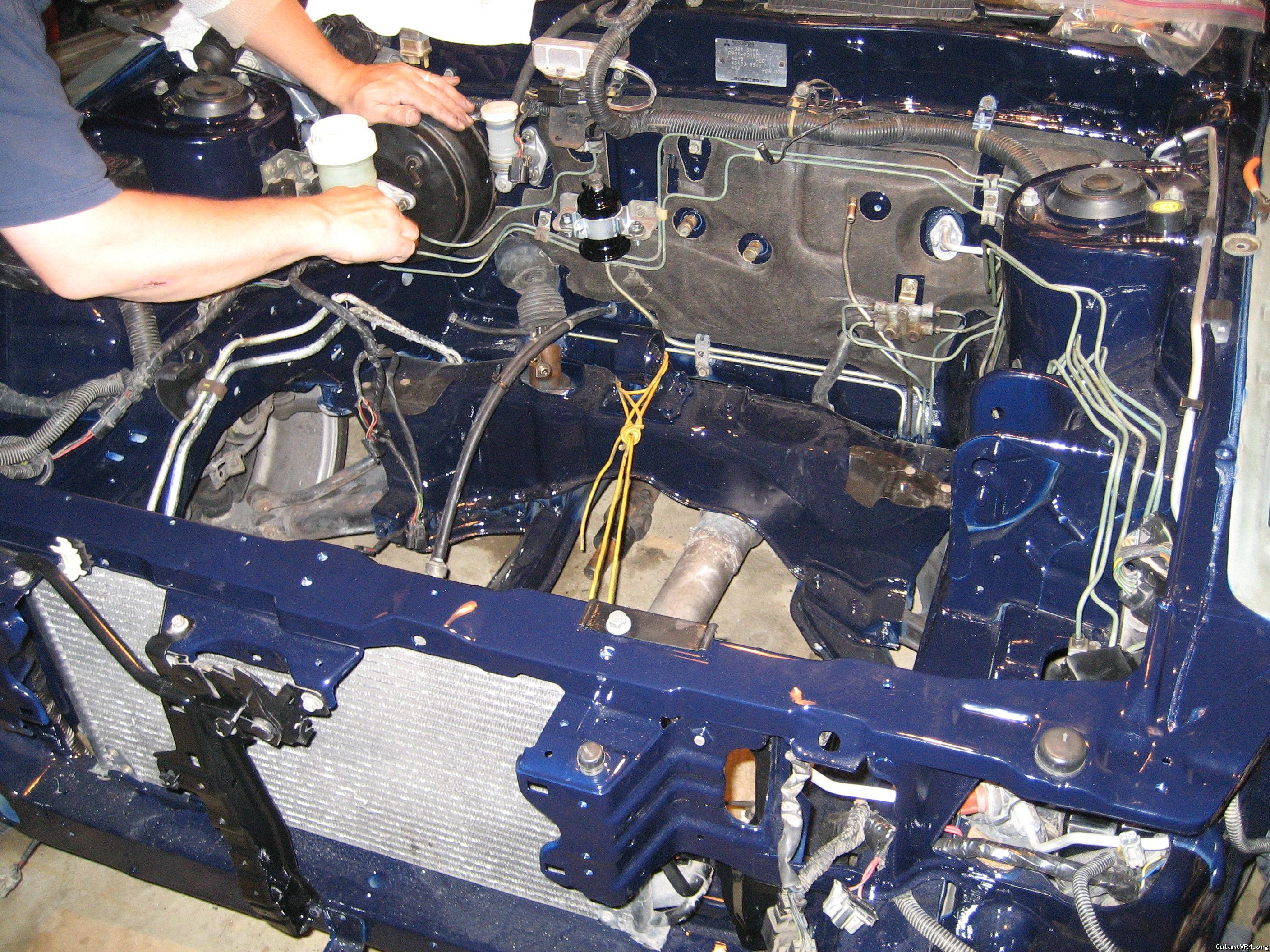

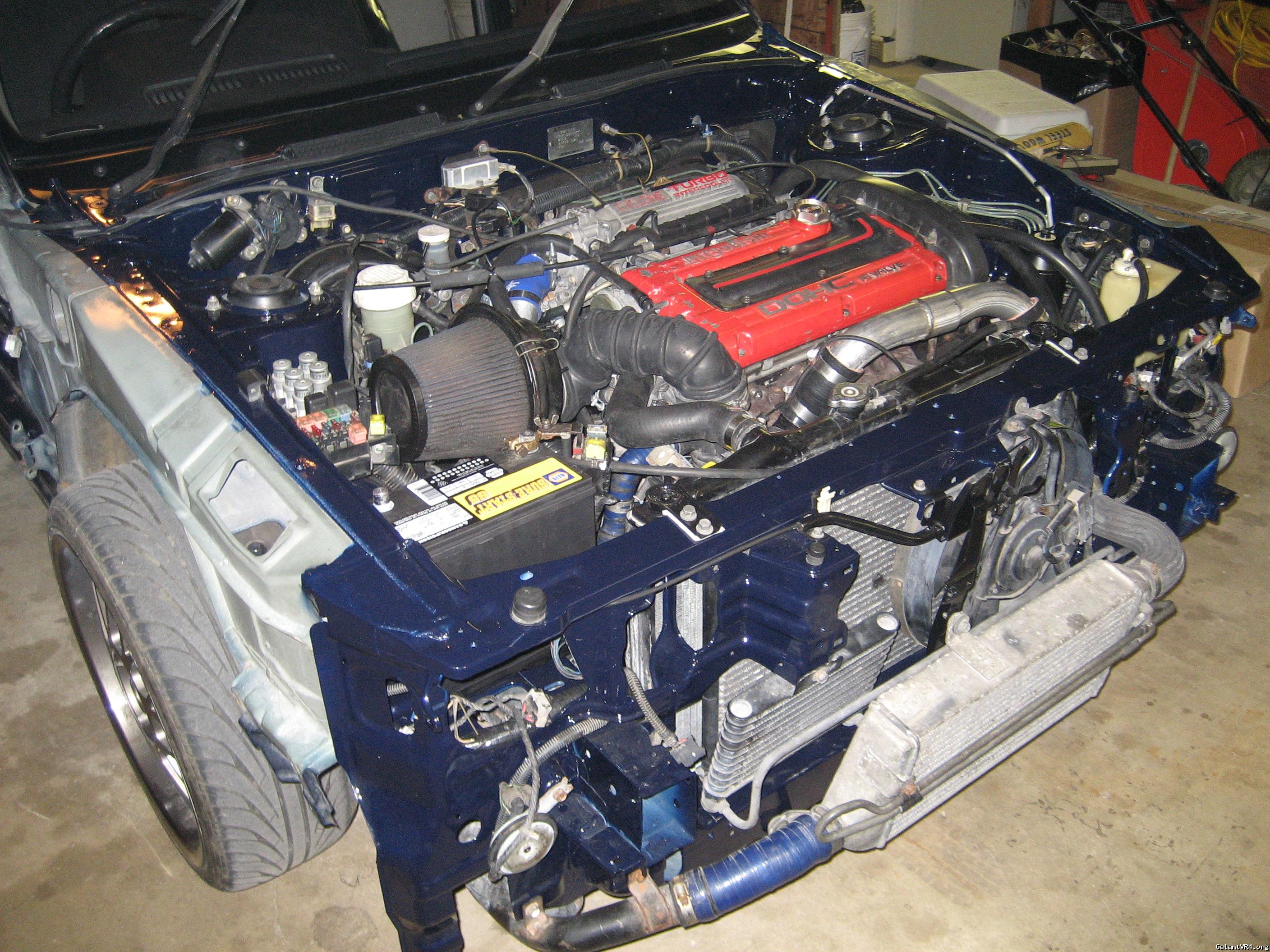

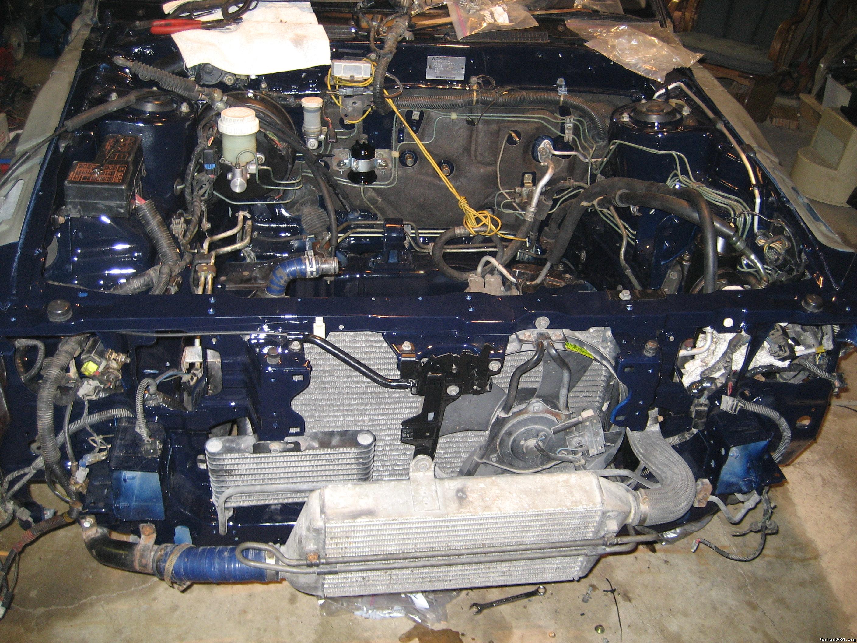

A few members are here for the weekend helping me bring the RHD back from the dead. here is our progress.
Will update with more pics tomorrow.
Thanks
JC

thus why you needed a jdm harness. /ubbthreads/images/graemlins/cool.gif
Cool color and looks like it came with nice wheels.

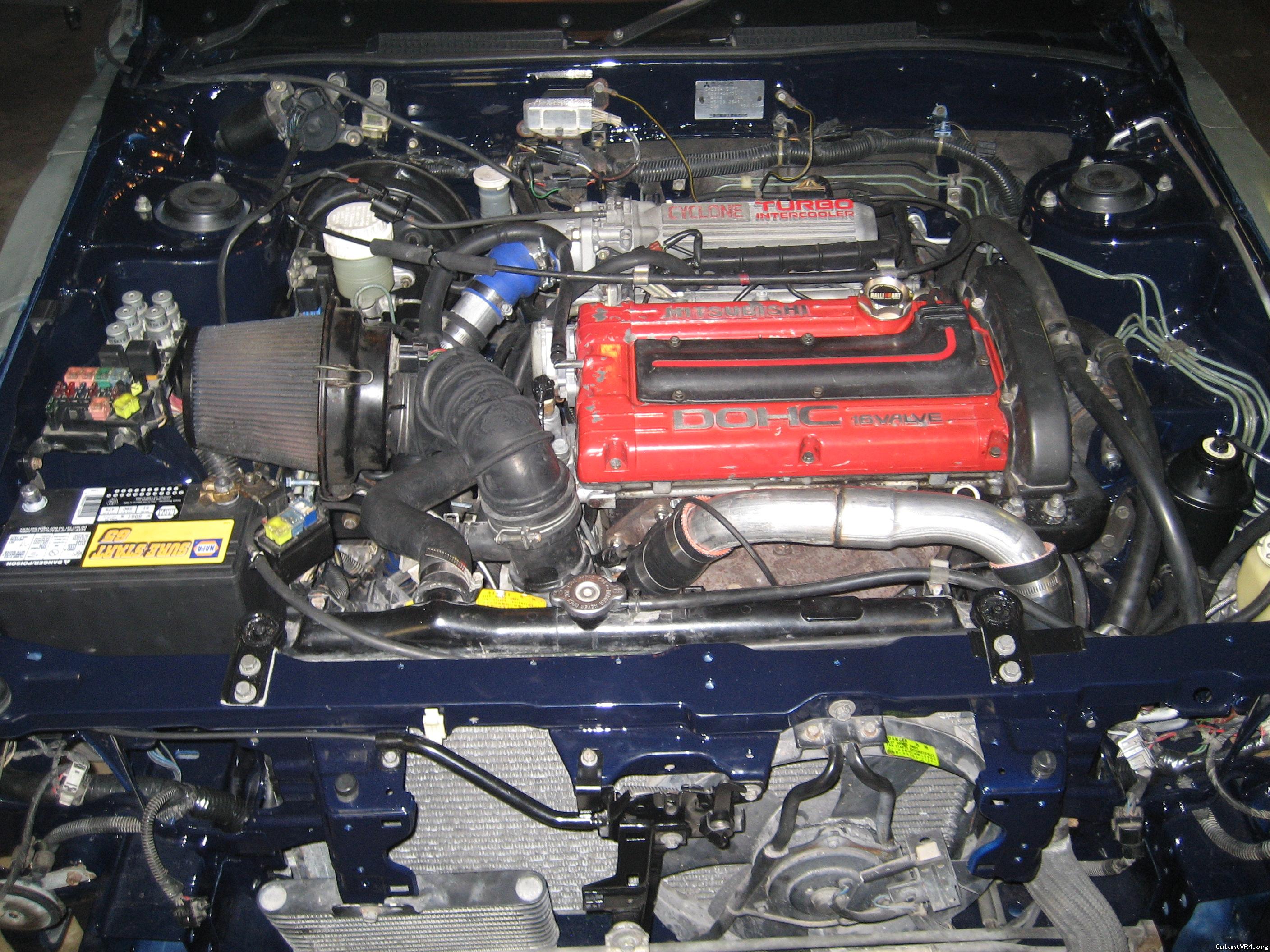

24hours later and she is running.
BIG THANKS TO /ubbthreads/images/graemlins/applause.gif /ubbthreads/images/graemlins/applause.gif /ubbthreads/images/graemlins/worthy.gif

Just got off the phone with JC. He fixed all the grounding issues and the car is idling better. And without doors, seats, carpet, hood, fenders, and trunk, the car is ripping up the road.
He still has an issue with the cooling (probably a stuck t-stat) and a fuel gauge issue (could be a broken wire in the trunk/tank).
The true test will be when the car paint is finished and the lights are all in. Hopefully the new chassis harness works all the up-front lights.
After 2 years of down-time, it is good to see "blue" up and running.

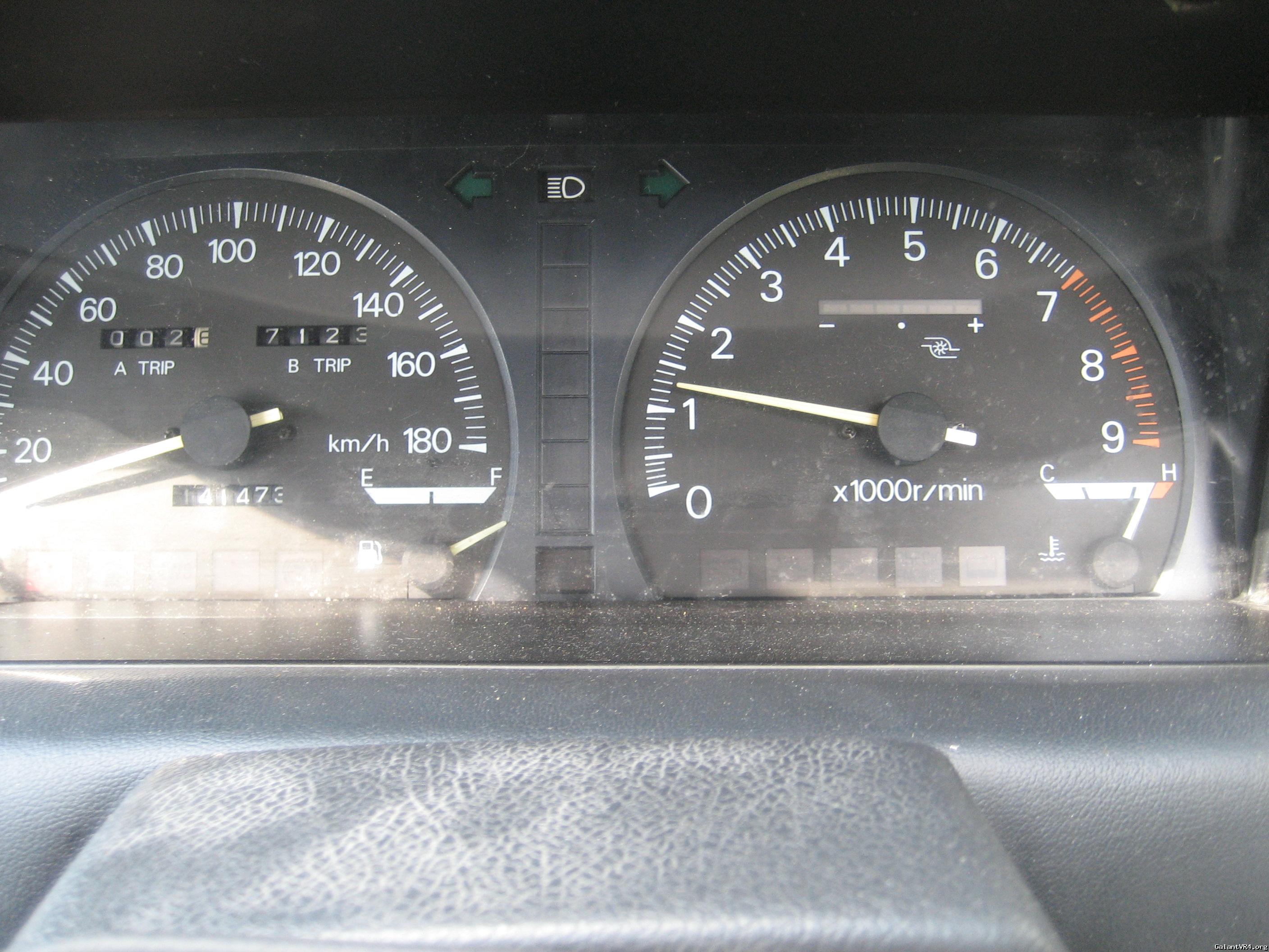

nope no luck on the guage issues yet I unhooked the battery for over 12 hours and the fuel guage went back to its correct position but after about 10-15 min of the car running it went waaay past the full mark again... Could this be a sending unit issue? or do you guys think the actual cluster is messed up?
Im also having issues with the wipers they keep stopping in the up position. I didnt take the wipers off the car, My body shop did that, is there something that could be hooked up wrong like some of the moving parts ?
Thanks,
JC

Quoting jcgalntvr4-244:
Thanks,
JC
My car did the same thing with the gauges the other day, i took the cluster out and checked and cleaned connections, reset battery and it went back to normal. The coolant gauge as well jumped up just like the fuel gauge. Does anyone know what causes this?
