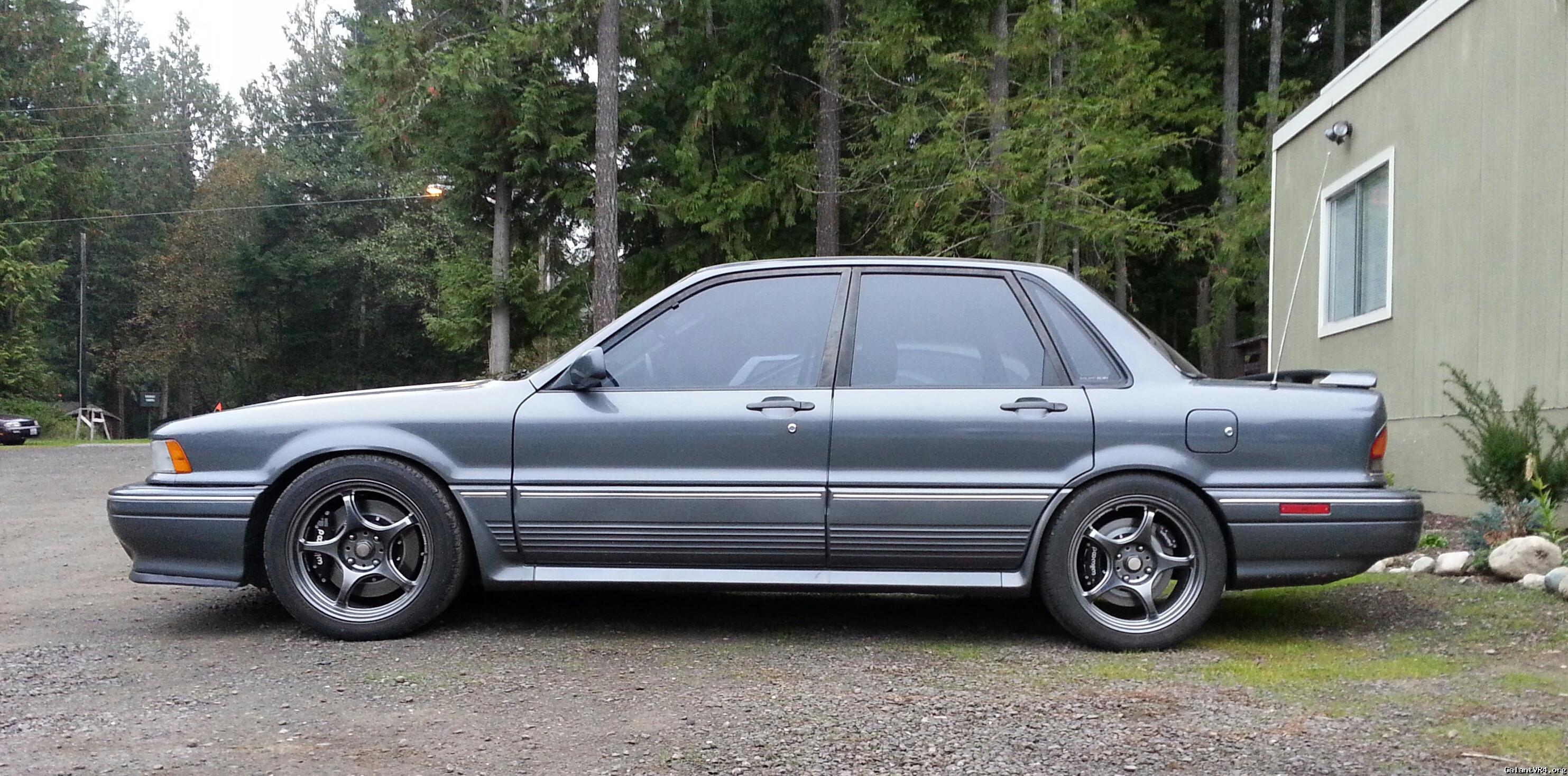

I'd have to find out if the guy who built the bracket wants to make more (and what they'd cost) or if he wants to just release a template...
here's the pic for those wanting a better look link to pic
