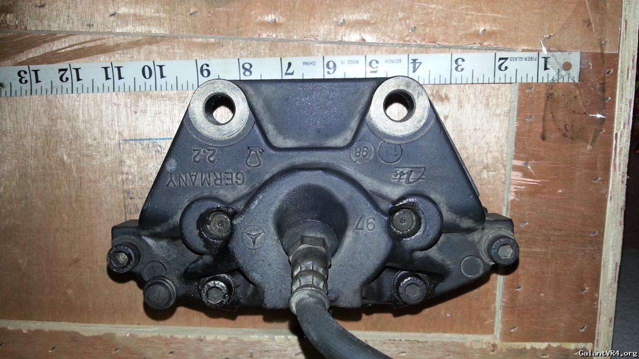

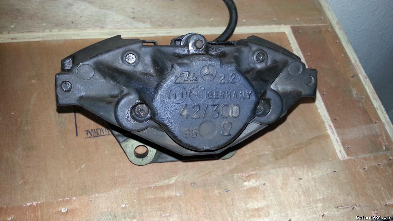

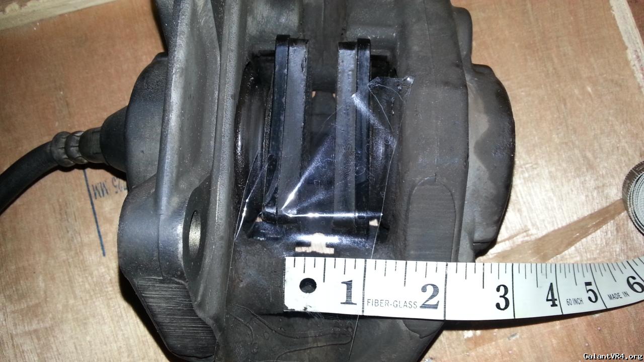

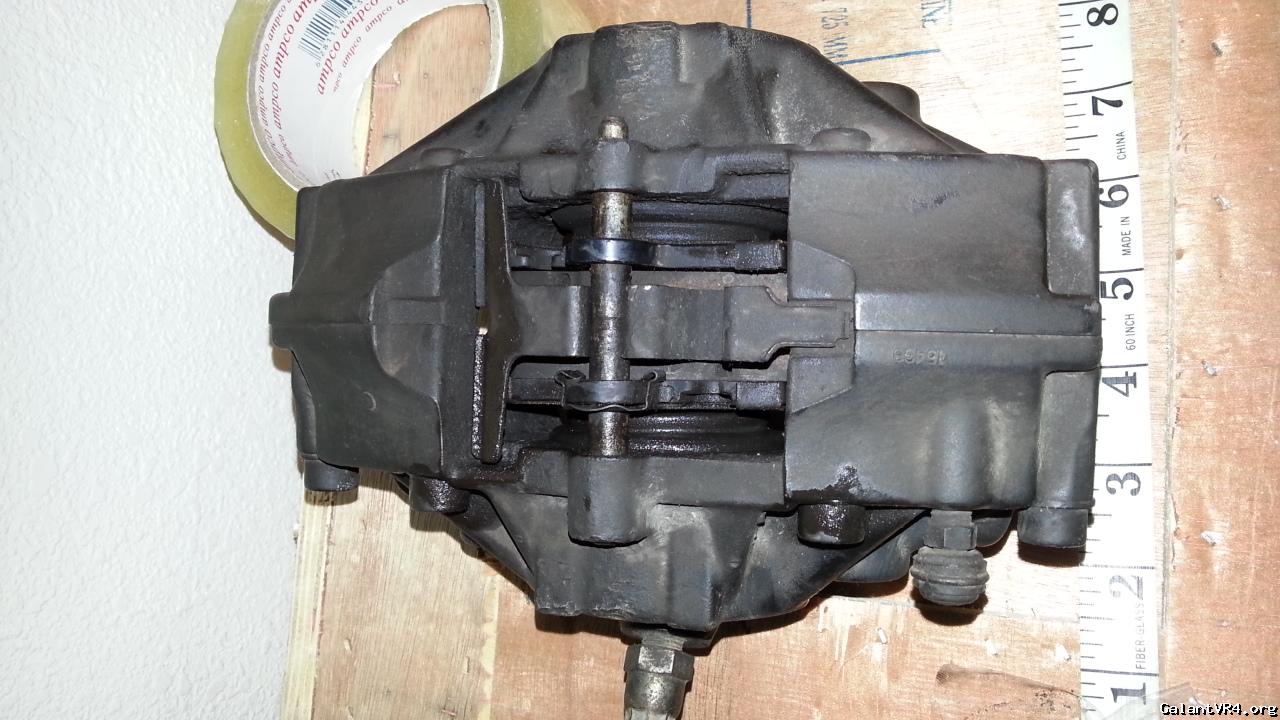

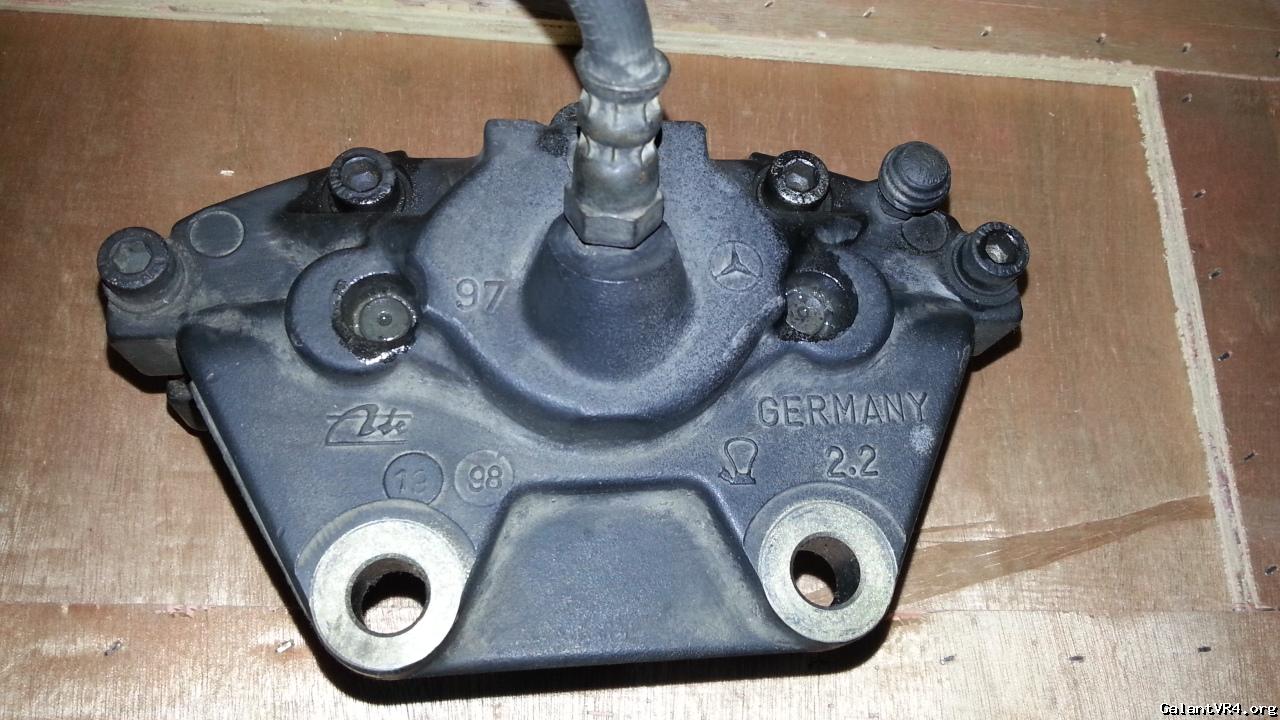

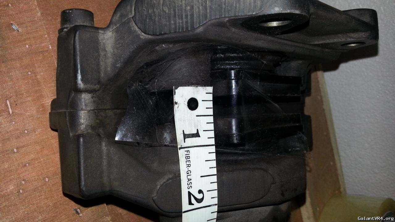

I find those caliper at the junkyard from Mercedes S350 I think. It seems good upgrade as it's original rotors has almost similar thickness as our cars. I still not sure how a bracket could be made to mount the new calipers. That will be measured later. I bought them chap. about $110. I may keep the original caliper for e-break only.

Conclusion
It is impossible to clear for bigger calipers without having big rotors. I can keep the original rear calipers for e-break only by fabricating crescent style brackets.
I may do it one day if I got biggir rotors. At least one or inch bigger.
