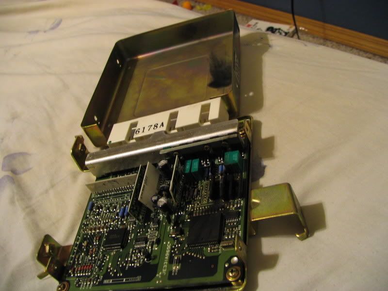

Bought an ECU... is it fried???
I purchased an ECU off the boards from another member for the 90 GGSX that I will be DDing until it dies and I can swap it over to VR4 status. I bought the board sight-unseen (never will buy something without pics again). Is this even usable to test if the car will start? I don't want to damage anything else by using this though...

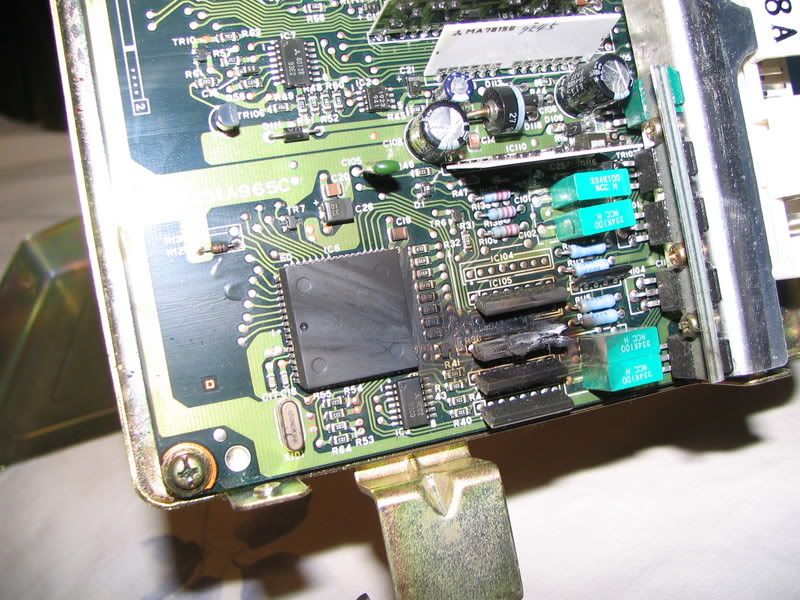

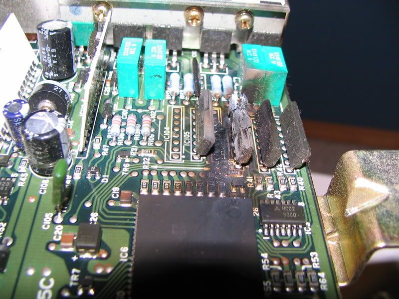

DO NOT plug that into your car.
Those are the ISC drivers and that will kill your ISC.
I can try and clean that off the board and repalce the drivers if you want to try.
I charge $5.00 each for the drivers (used) and cleaning should be around $20.00.
Worse-case should cost you around $55 for cleaning, replacement, and return shipping.

I garentee that his ISC did not work and that black smoot on the board is conductive and could even cause a bigger fire if it makes it way through the humiseal coating.

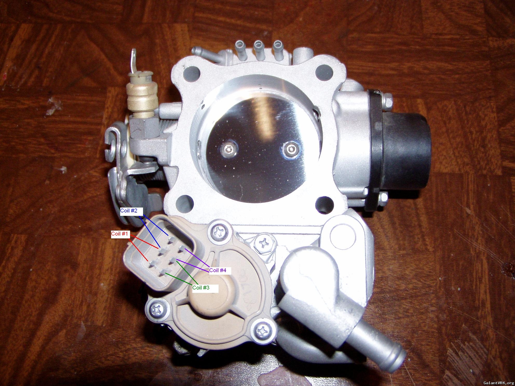

BTW - A shorted coil on the ISC caused that. That is why you want to check your coil resistance BEFORE you plug in a new ECU.
You need to have 30-40ohms on all 4 coil points.

It's like 28-30 for the original ISC, and 40 for the 'new design' (which IIRC are more...black) ones no? Would 40 maybe be open coil, on an original ISC?

The story goes that it was from a Galant GSX that had a t-belt snap. He swapped over and made it a VR4, so he had no reason to look inside the ECU. Here is something that kinda bugs me... If you look at the picture, this "90 GGSX N/T" ECU is inside a T/E/L ECU case, meaning someone, somewhere, either swapped the boards, or this was the wrong one entirely. If said seller purchased a M/T turbo ECU with a Galant case then there would be no reason to even think of reusing the case. If the seller purchased a M/T turbo ECU from a T/E/L, he would have had to REUSE the Galant case, and in doing so, would notice SEVERE burn marks on the case.

is the top case from an NT? i get what you're saying but i notice the charred marks on the lid so either the top part is from that ecu or the ecu blew after it was swapped. /ubbthreads/images//graemlins/dunno.gif
