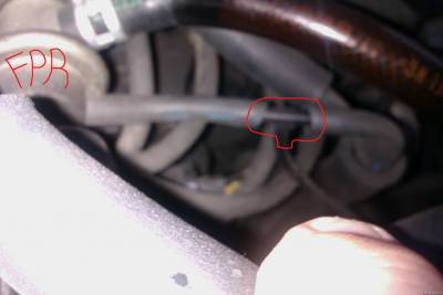

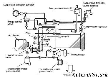

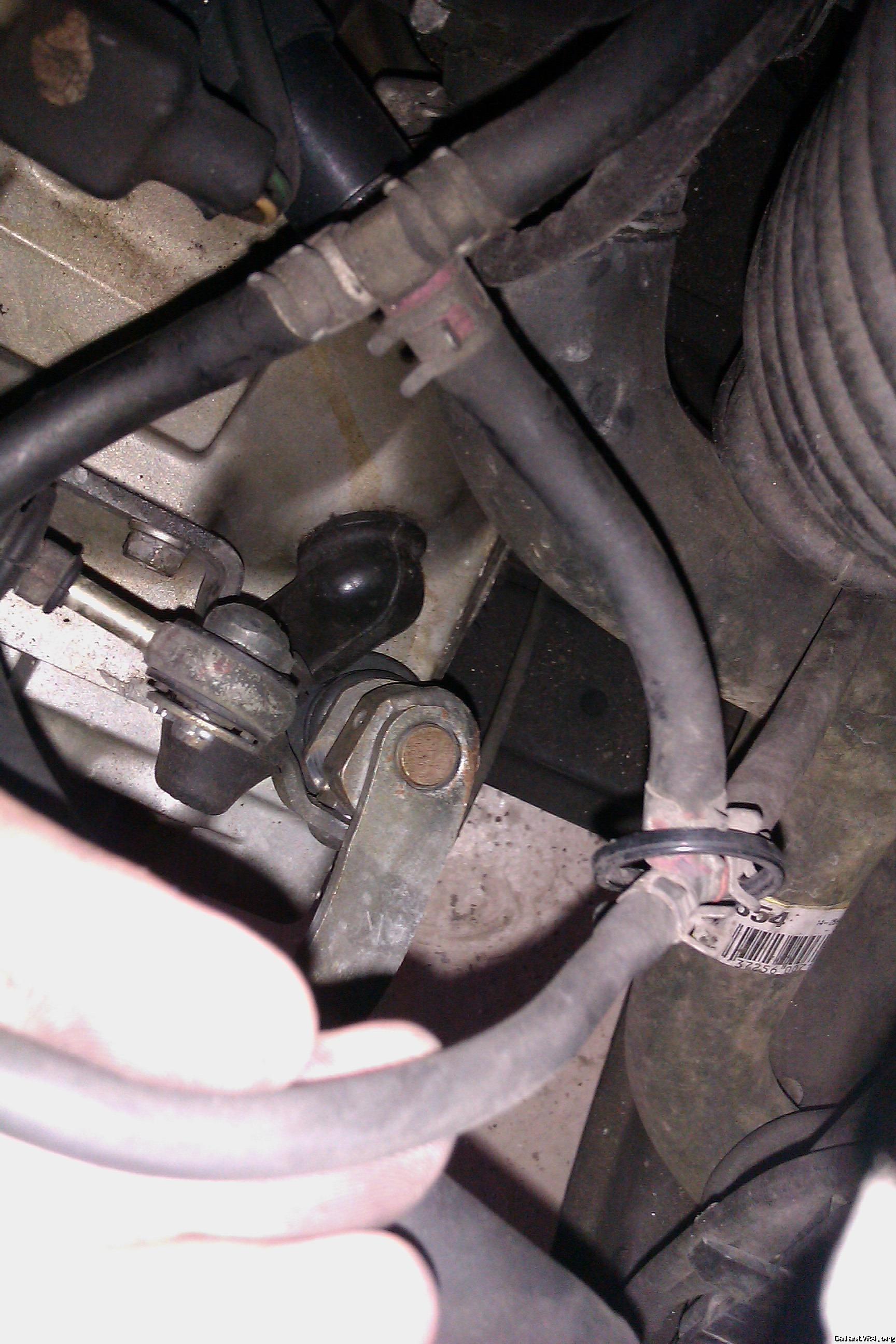

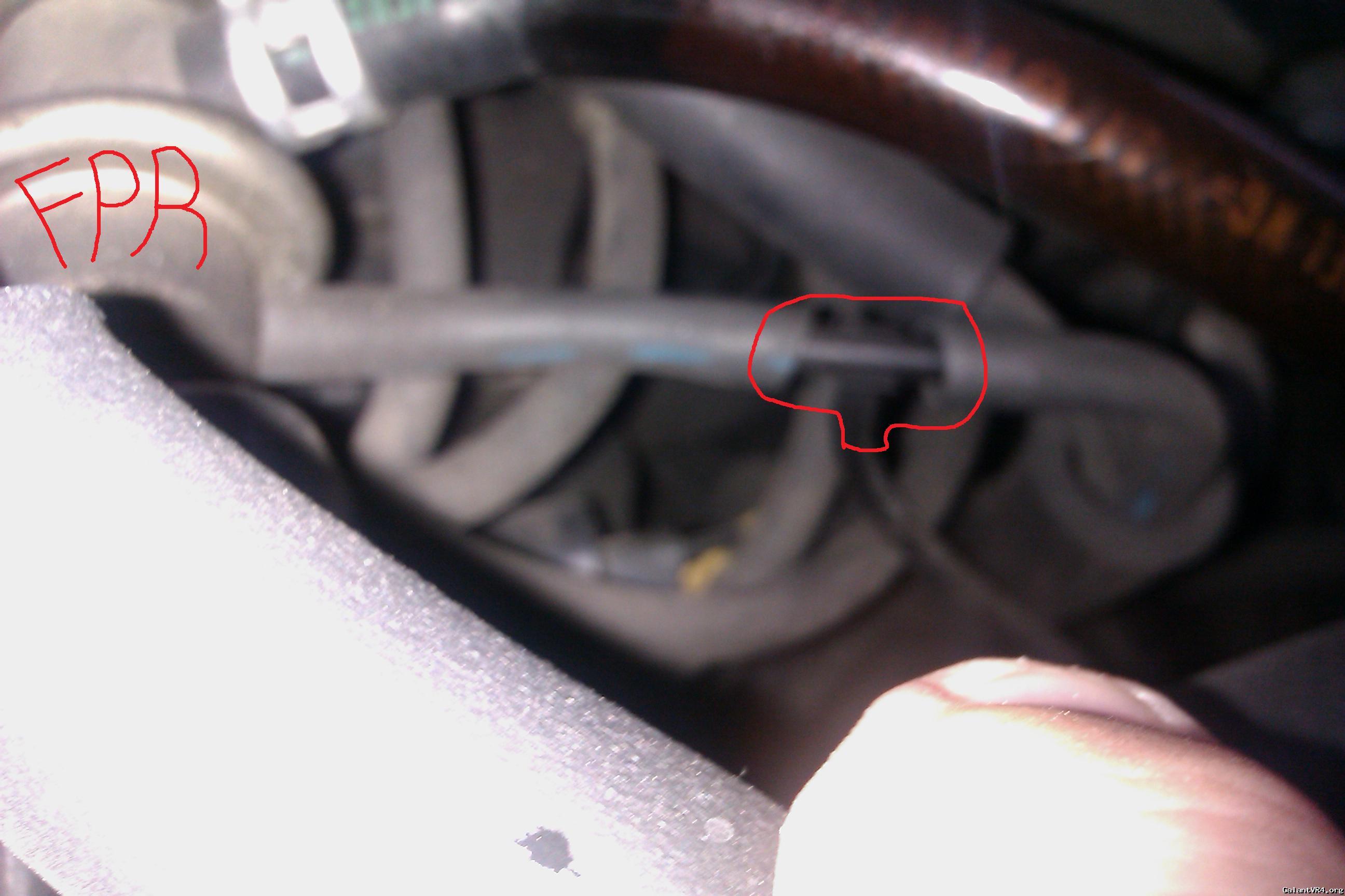

okay so i blew into both sides of the bcs and no air either way and i have a pic to help a little everything looks correct besides how bcs is connected, and i know my art skills suck lol, and per diagram its has T offs in correct locations and vacuum lines correct is there something im missing /ubbthreads/images/graemlins/dunno.gif
If you cannot blow thru the BCS then it's closed. Like mentioned this means you are running on WG springs pressure only which is about 7-8psi or what you are seeing on your boost gauge.
Since I'm not 100% sure how the BCS works when the car is off ( default closed/open with no power ) check it again with the car idling. If you still can't blow thru it then it's either bad or the ECU driver isn't working. Worst case get a MBC and bypass the stock BCS like most people do, just make sure you don't get crazy and bump the boost up w/o a tune or support for it.

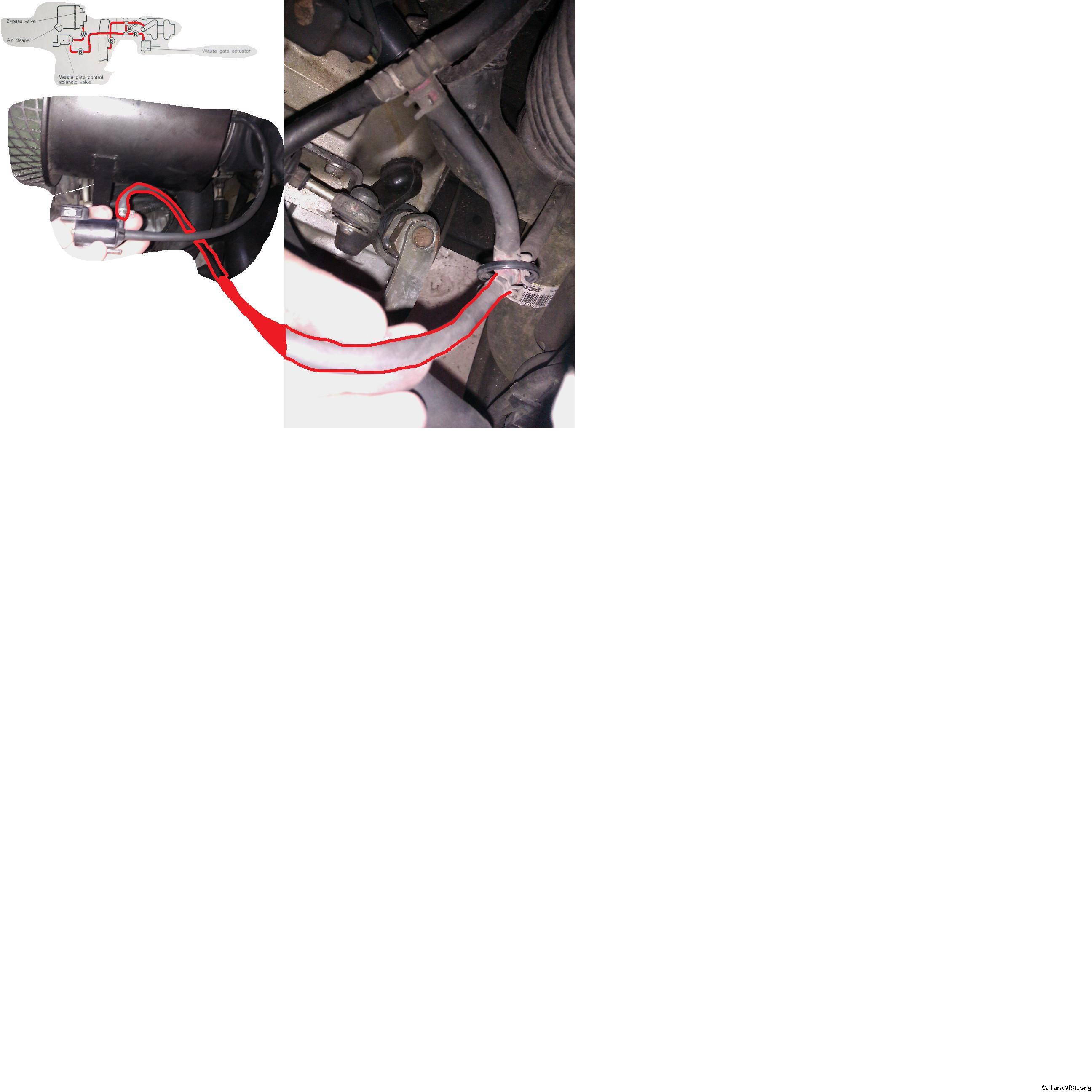

The diagram for the hose routing looks good. Edit, on second thought there should not be two "T" fittings for a stock setup only one. Here is a pic that shows it better:

In the vacuum diagram posted above, you can see that the turbo has one vac line coming from it that goes to a tee fitting. On the tee fitting the one side goes to the wastegate actuator. Remove the tee fitting and use these two lines for the mbc. Unplug the vac line coming from the back side of the mass air flow and cap it. Now you can set aside the bcs, as both ends of it should no longer be attached to anything.

And what I mean is the other t off goes to lower ic pipe and those; its 2 different diagrams so little confusing
