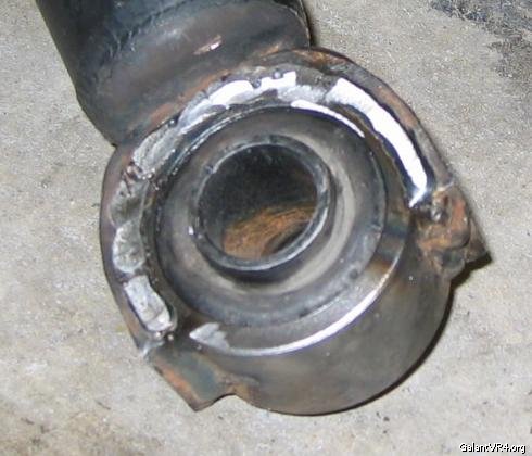

Pivvay when this is done I'll gladly pay you for a set along with the ICS elliminator plate, might as well get it all at once. I've had a full evo suspension setup with just 100 miles just sitting in my garage for about 5 months and I really need to do something with them. BTW for anyone who's thinking of cutting off the botom mount and welding on the correct one, I started this and it didn't work out too well. Ruined one of my struts so word to the wise.
How did you weld? I've got some good advise for welding struts off some other people if it comes to that. However I hope it doesn't.
So say we come up with some kind of braket or something for the rear evo * strut then we should be able to use evo 8 teins or any other evo 8 suspension right. What if you drill the hole in the U of the strut big enough to fit the stock vr4 lower strut mount then used some kind of bushing

I've got a guy who welded the galant bottom loop on to the evo struts and it worked fine. Probably a tig only job with lots of stops and rags to keep the strut cool. I"m still working on a bolt on solution but I don't have a ton of extra time so it's slow going.

how much did he charge to do it? Why couldn't you just do it with MIG in the same way...make a puddle and stop. cool...make a puddle...stop...etc...
Don't know how much $$$. I would rather TIG it so you can keep the heat as localized as possible and as little as possible but if you're really good with a MIG you might be able to do it. Gotta keep it cool as much as you can is really the only key.

I can butt weld 24 guage with my mig...spose i've got a pretty good feel at heat control /ubbthreads/images/graemlins/wink.gif I'll probably take a crack at it.
john
I got the bottom of the stock Galant shock welded into the fork in the Evo shock.
The shop had to weld it a little bit at a time, and keep the shock body covered in wet rags.
It cost about $150.
