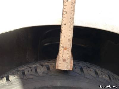

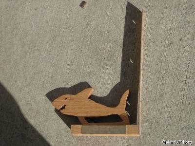

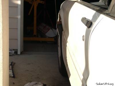

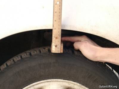

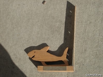

Here's some teaser pics, to clear up the fog surrounding ride height with EVO bits. Stay tuned for a full post on the project.
Note: the car was sitting on a slightly inclined driveway.
The highly calibrated measuring tool:
Fender gap with stock setup:
Fender gap with stock EVO setup:
Camber with stock EVO setup:
Clearly the EVO front springs need to be cut - we're figuring out how much to cut off and then bolting it all up again. I want stock or just slightly lower than stock height when it's all done.
