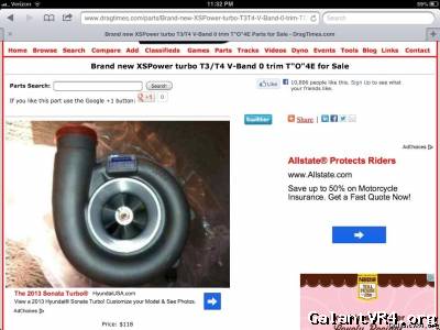

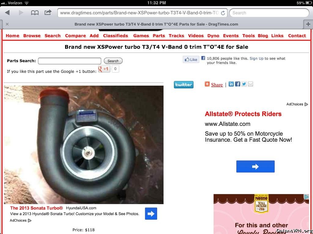

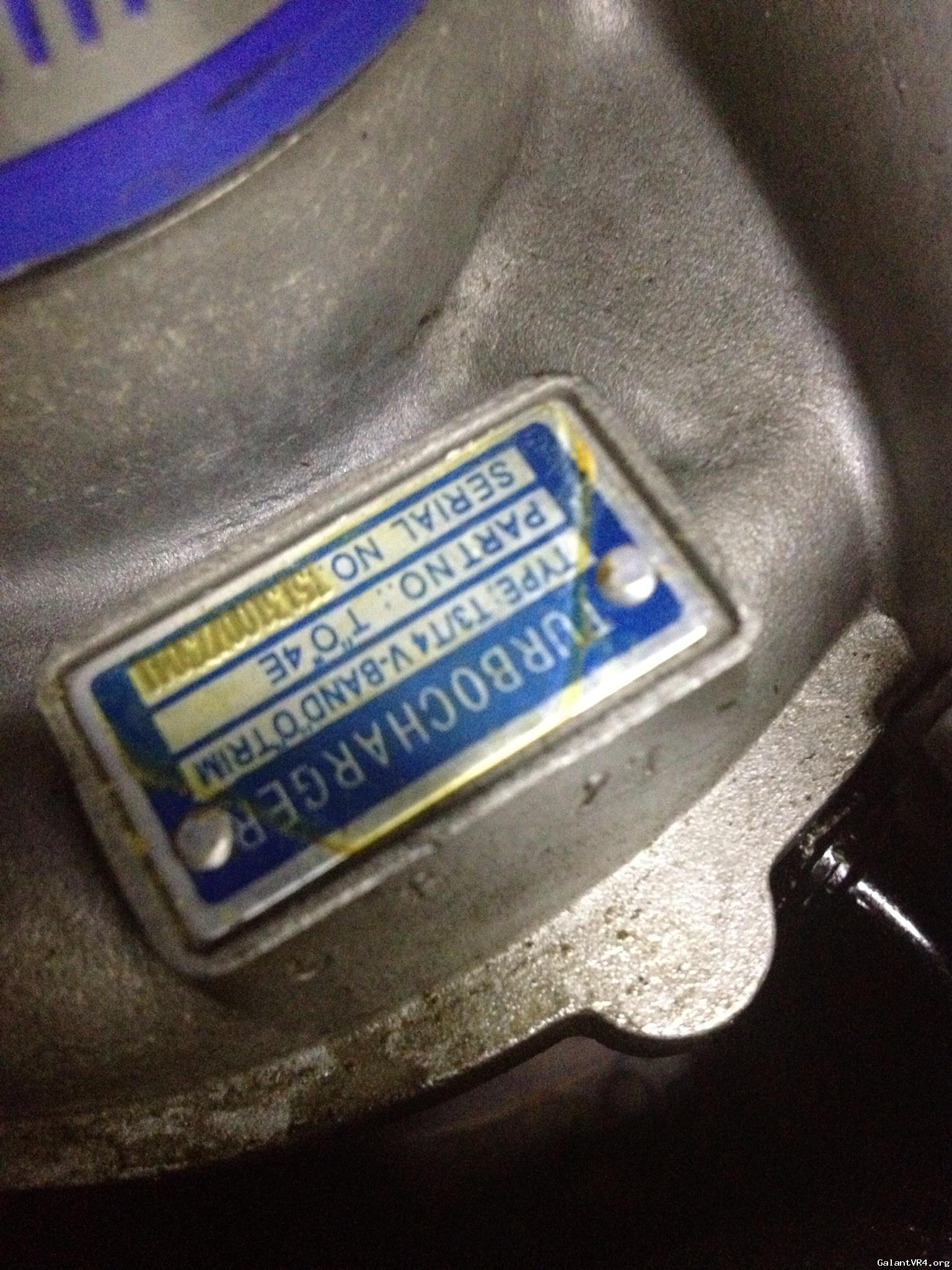

I forgot to mention..680 injectors. 255 fuel pump. And a keydiver chip running 91 octane. I found this label on the turbo has anyone seen it .the for sale ad said it was turbonetics..I don't think so..more like a ebay special

Yep as I thought. eBay pile of sh**... Why would a member on this forum /ubbthreads/images/graemlins/bawling.gif buy such crap for a great car...actually it's not the guy I bought It from fault he didn't know. Anyway that turbo will make a great paperweight. It does work but u can't trust ebay parts on anything.
