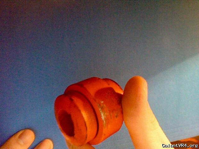

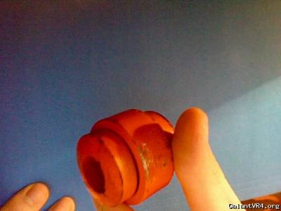

Whats the difference? I bought some dsm rear shock lower mounts from a guy but he sent me the wrong thing. Is it possible these are from a FWD DSM?
Here's what I wanted
Here's what I got

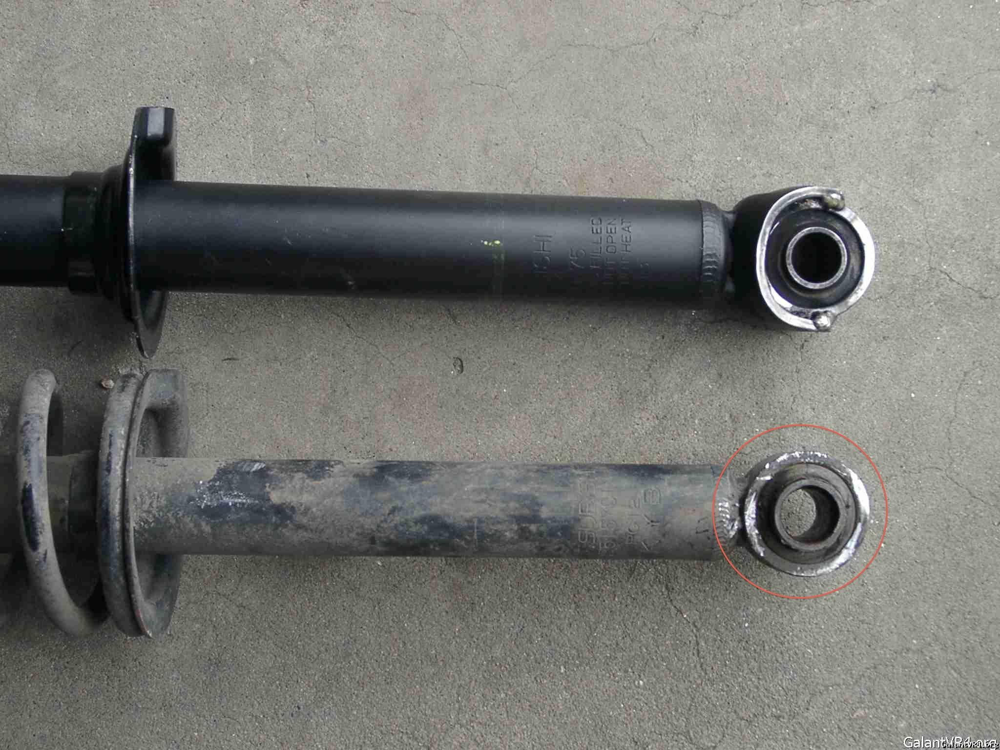

FWD's have larger holes in the bush than an AWD.
I tried to run my VR4 (awd) stuff in the AMG (fwd) and found the problem above.

Looks like its the bushings only?
Its too small. There is a rubber bushing and a skinnier metal ring around it. It definitely is not from an AWD 1g rear strut. Im just trying to figure out what the hell it is because at this point I paid quite a few bucks for straight up sh*t that will never be used by anyone.

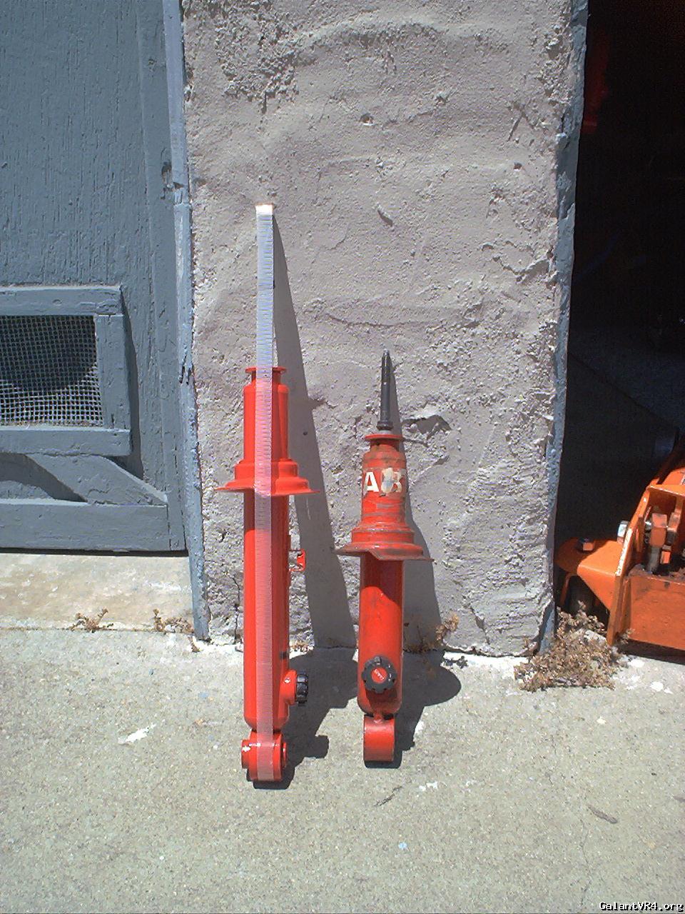

Fwd rear shocks are shorter.
THe shorter one on the right is from my 1990 fwd. Left is 1991 vr-4. Bushings should be the same.
