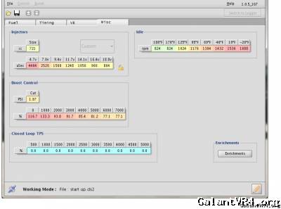

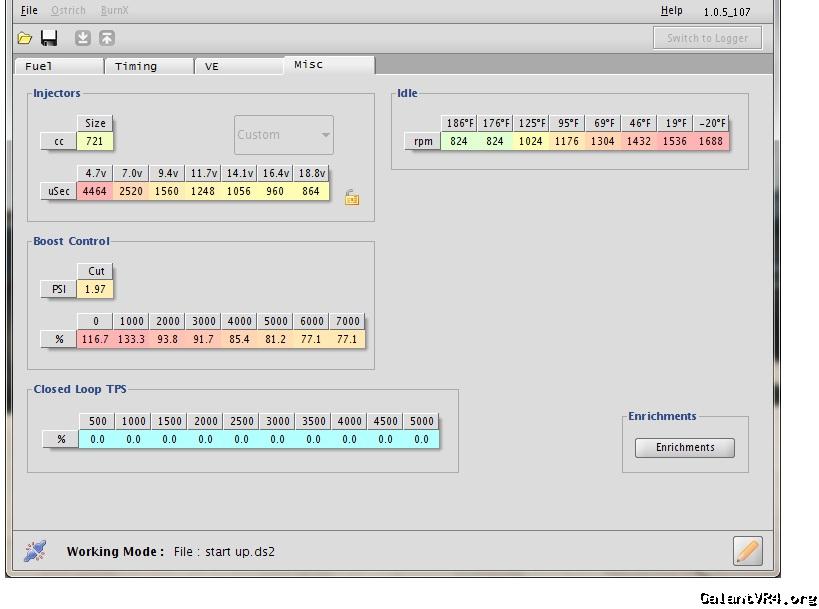

The previous owner had the zietronix logger and claims its easier to use. I actually just found out I couldnt post logs because I was a sub 5 post user haha. So I am going to try and post a log and also a snapshot to show my injector deadtimes because I am unsure if they are dialed correctly. I had no idea on decel it was normal, the engine would cut out and sputter and at time on accel(low load) the afr's would go up to 17, it wasn't on boost but still I think that might be too lean pre boost.
heres a screen shot of the deadtimes
