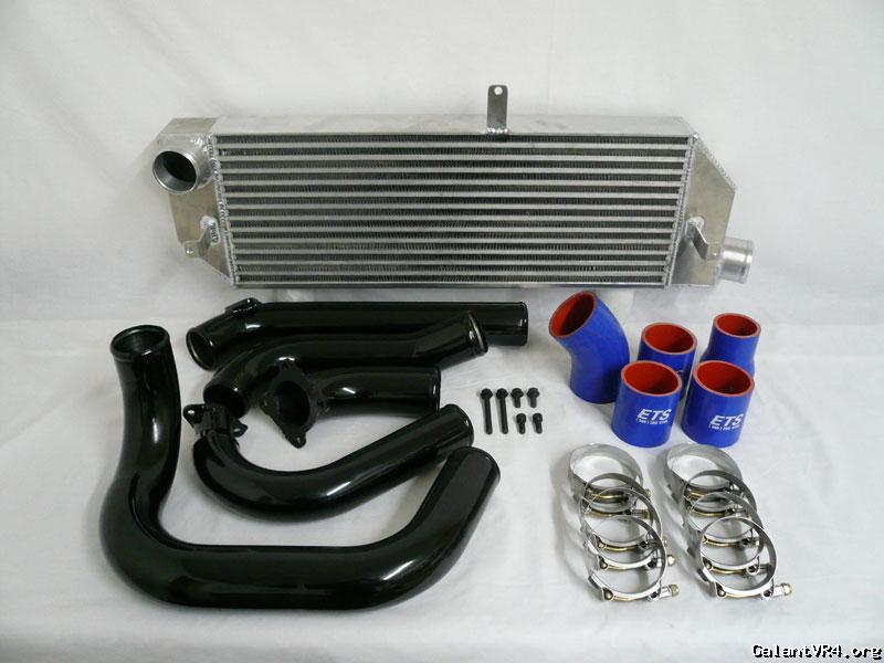

ETS has a stock like 2.5 J-pipe. It also replaces the rubber piece that runs over the manifold. A small diameter pipe is welded to the flange, but it expands to 2.5" almost immediatly. Im sure they can get one to you if you call them, but otherwise, Ive only seen it sold with the kit.
second pipe from the bottom.
