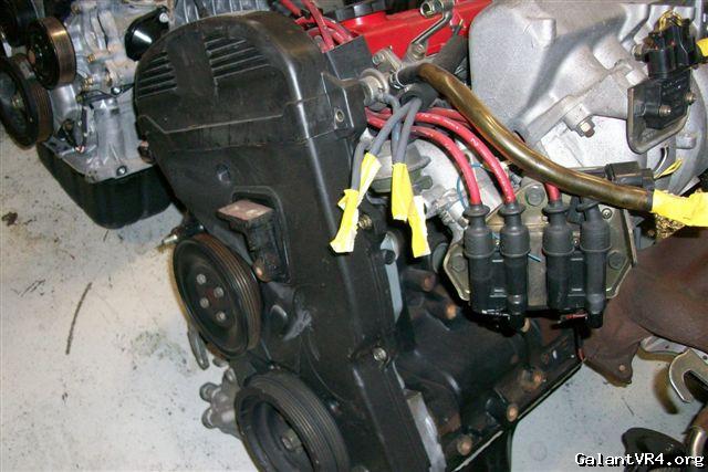

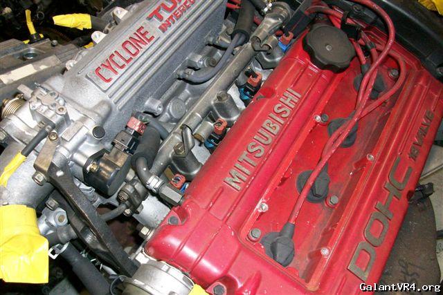

That's a helluva deal. I paid $500 to "Standard Machine" or something out in Glendale/Peoria for a shortie balanced out to 12,000rpm back in 2005 or so.
Shame you didn't jump on it sooner. This one was collecting dust in my garage in Glendale for the better part of a year.

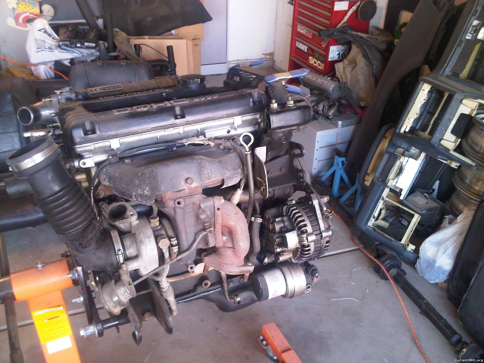

I was offer this jdm for a good price ... This would be fast and give me more time to build that dream stroker?

It could, but those motors are hit or miss. I had a buddy doing a 6 bolt in a 2G. He got two of the motors and both were junk, the last one he got worked well for a few months then he had to get the head rebuilt as it started to smoke real bad. After that it seemed to worked okay but he still had a mystery used engine but spent just as much as he would have to have one rebuilt.
