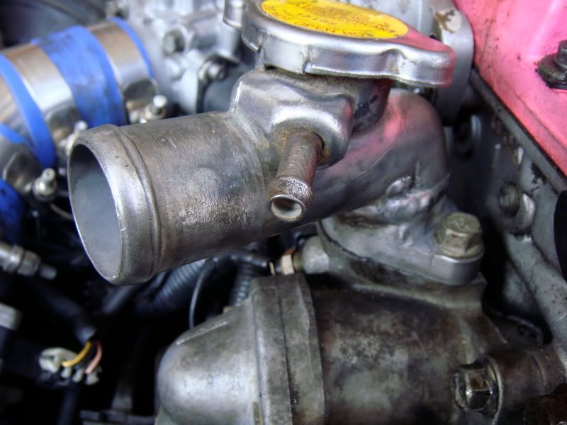

The 1g water neck/t-stat housing has a provision for the radiator cap. The GVR4 t-stat housing doesn't. The little nipple on the 1g water neck goes to the coolant overflow. On a GVR4, this nipple would normally be on the radiator. You'll need to extend the hose to reach from the 1g t-stat housing all the way to the overflow reservoir. If you also have the standard GVR4 radiator with a cap, you will then have 2 caps in the system using the 1g water neck. Not a great idea...
Nipple on the 1g t-stat housing that goes to the overflow:

IIRC, the AFCO radiator doesn't have a provision for the radiator cap. So, you are correct in needing the 1G water neck. This will relocate your radiator cap to the t-stat housing location. The nipple on the water neck goes straight to the overflow tank. If it goes anywhere else, that's wrong.
