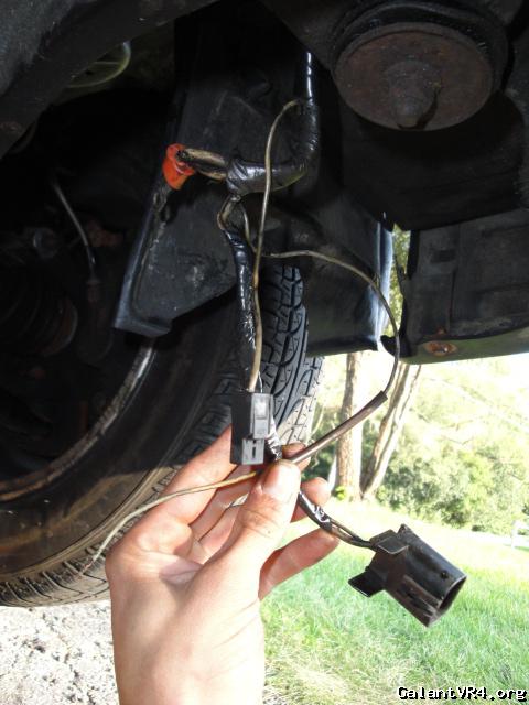

i have no idea where the little white wire should go, when i took off my alternator this wire was not connected at all? anyone know?
and another question i have is how do i switch out the old conection for my headlights to run on the new ones i have?

White wire goes to the Power Steering pump. It needs a female butt connector on the end of it.

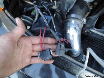

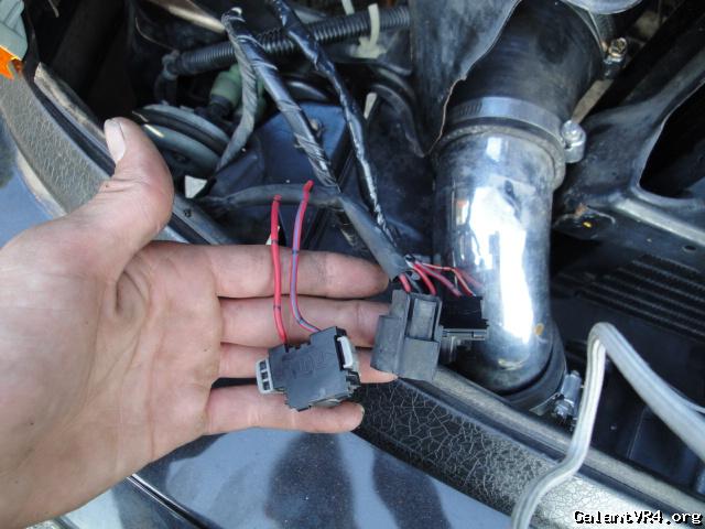

well hertz i bought this car from rez down in bloomington normal, i cant run my high beams, thats what those connectors are for.
rez
Feb 14, 2005
440
champaign,illinois
^That's right Dave, they were jdm lights
Are you just hooking up the high beams in the jdms or are you putting in totally different headlights?
i am just gunna hook them up now,same headlights just want to switch in these connectors you gave me.
