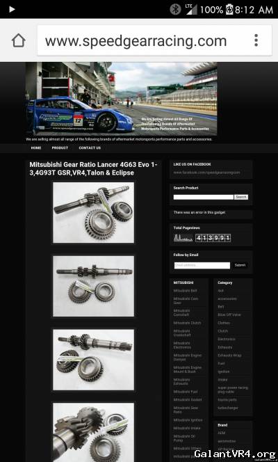

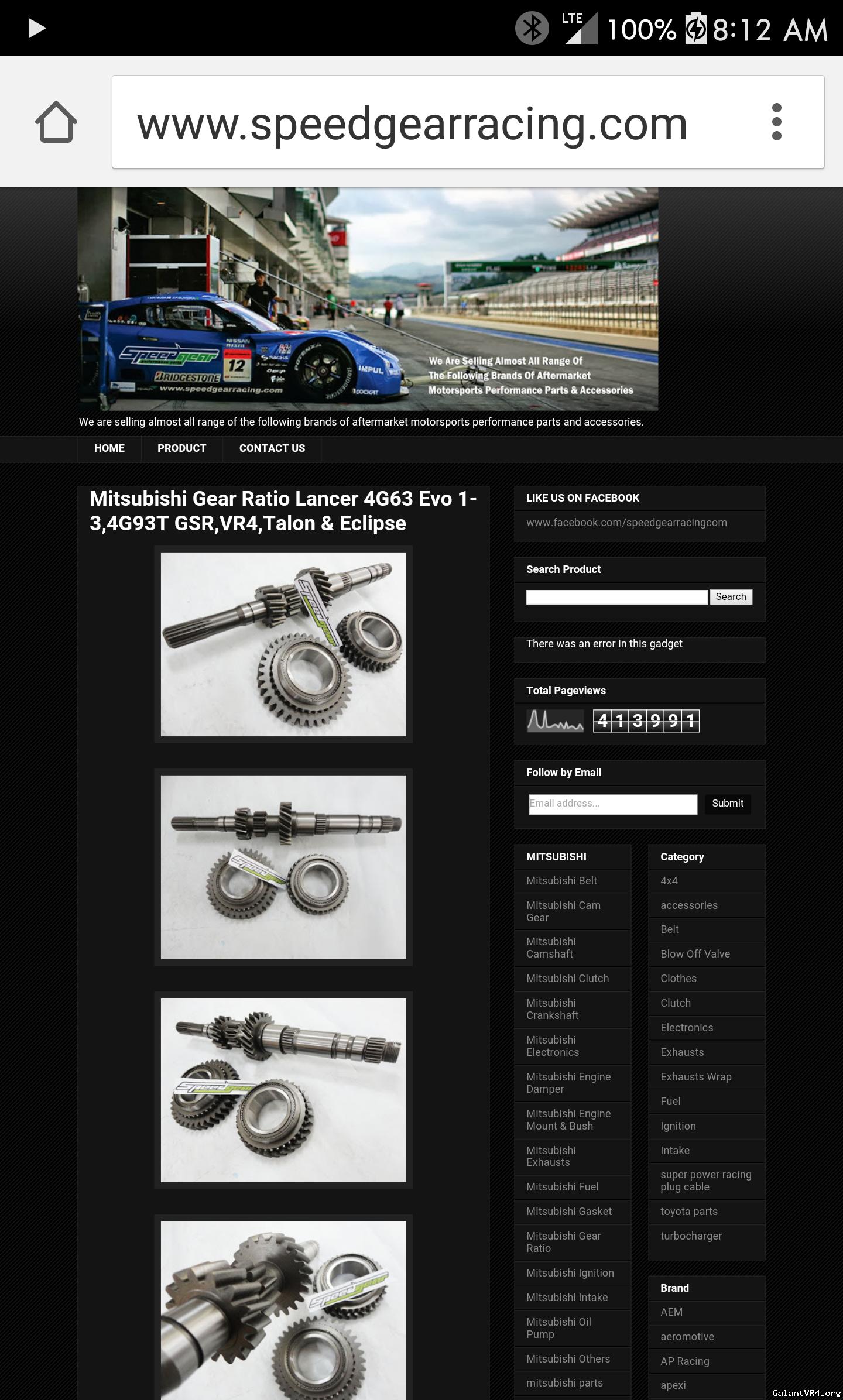

Definitely taller gearing for 1 and 2. My only concern would be the strength of the metal they are using. Never heard of that company.
Tell you what though, if they are stronger than stock, they should get on producing a 3/4 setup, even if stock gearing. Just to fix the main weak link in the 1G DSM/GVR4 trans after you ditch the Galant 1st gear.

I don't know if this is them but there's a German company making straight cut gears for the 1g trans
