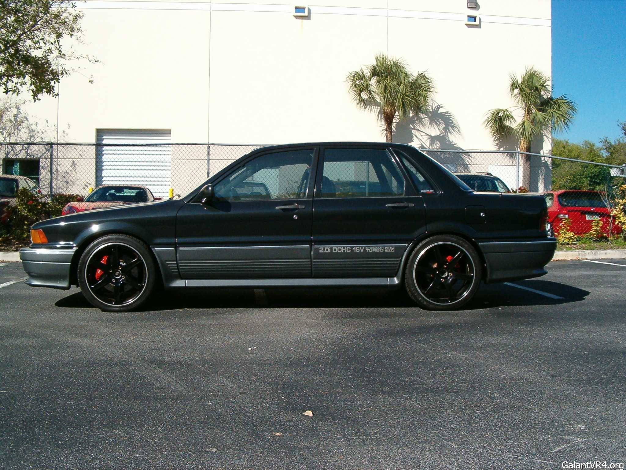

any pictures of your car with espelir springs?
What do you think about mine?
OEM Evo 8 struts with Espelir ASD (the blue ones) /ubbthreads/images/graemlins/grin.gif
Don't let the ride height fool you. It doesn't bottoms out, it's firm without being too bouncy & the springs are the right free lengths. This means, no worrying about them becoming unseated. My cut evo 8 front springs never came unseated /ubbthreads/images/graemlins/wink.gif.

So the espelir springs by themselves lowered and leveled everything out? I was thinking about getting those springs, but I was a little worried they would leave the front end a bit higher still. I'm also using the GVR4 tops in front, are you doing the same? That ride height is sick!
+1 /ubbthreads/images/graemlins/ooo.gif

I completely agree^^^^. This is why i went with Whitelines, but the car doesn't seem to sit the way I want it. I REALY like the way your car sits and will hopefully duplicate this as my next setup.
One question that seems to have gone unanswered is did you haver to cut the Espelir springs or did you attain that ride hiegth with them out of the box?
NO CUTTING OF THE ESPELIR SPRINGS, NONE, ZERO, NADA, ZILCH, YADDA, YADDA, YADDA..... /ubbthreads/images/graemlins/grin.gif

^^That's great to hear. I now know what mod I'm doing next......after my new galant gets back on the road......espelir springs! (already have the evo suspension)
hah, i'll get pictures up of mine soon, the galant is at the shop. i bought mine awhile ago for 75 shipped on ebay brand spankin' new. i'd check it out.
$75 brand new shipped is a steal. They're normally $250. I got mine for $50 shipped with about 2k miles on them. My car is a little lower on the driver's side than the passenger side. I thought replacing the suspension would've solved that but it didn't. What can be done to level it out?
