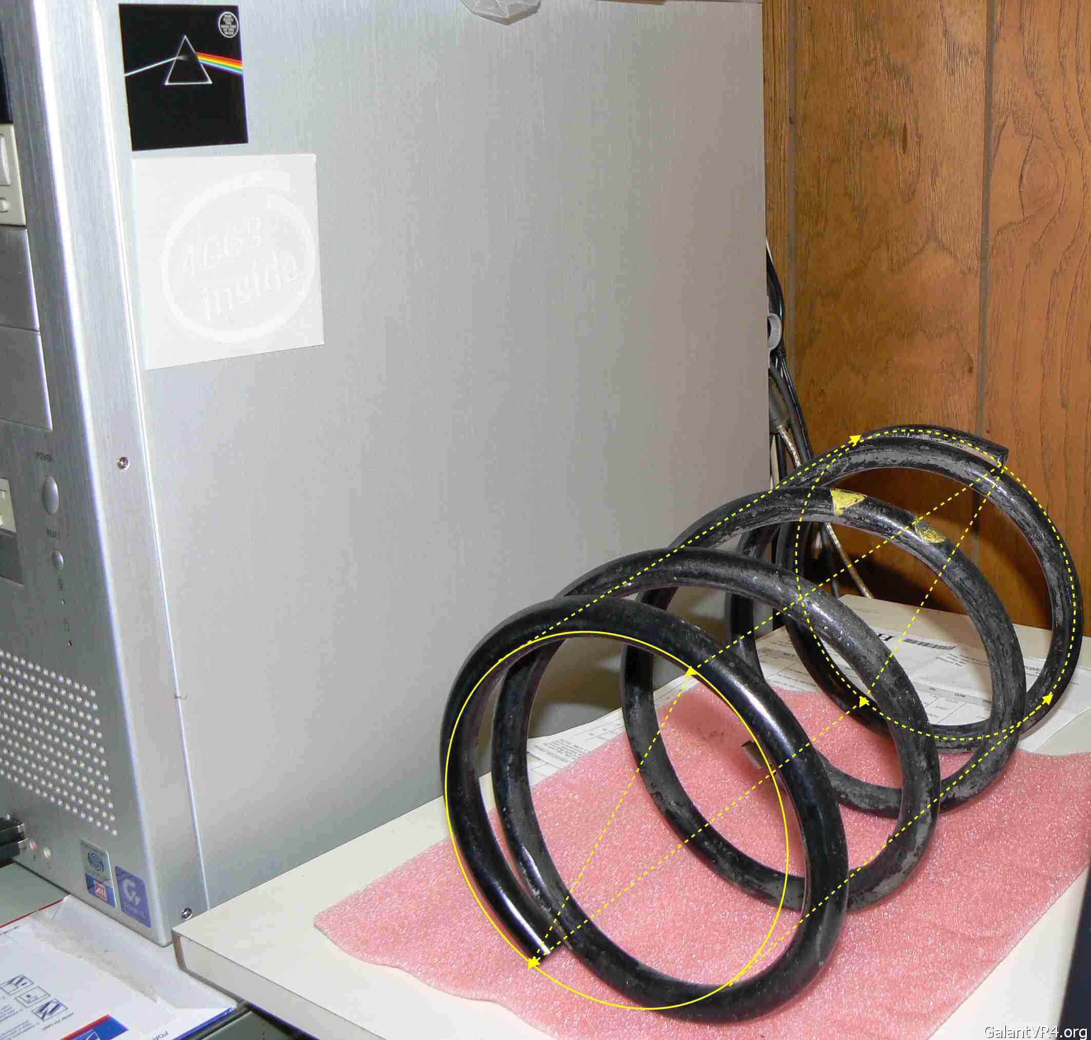

I took a picture of the EVO spring and did a rough dissection showing that the ends are exactly 180 degrees apart. Can anyone indicate the exact location the spring needs to be cut from this diagram? I cannot tell the orientation of top vs. bottom (if any).

Cutting the springs is one of those things that you just have to cut a little and if its not enough then cut a little more. I wouldn't just lop off a bunch because what worked for someone else may not work for you.
