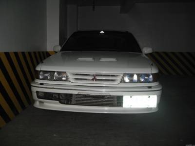

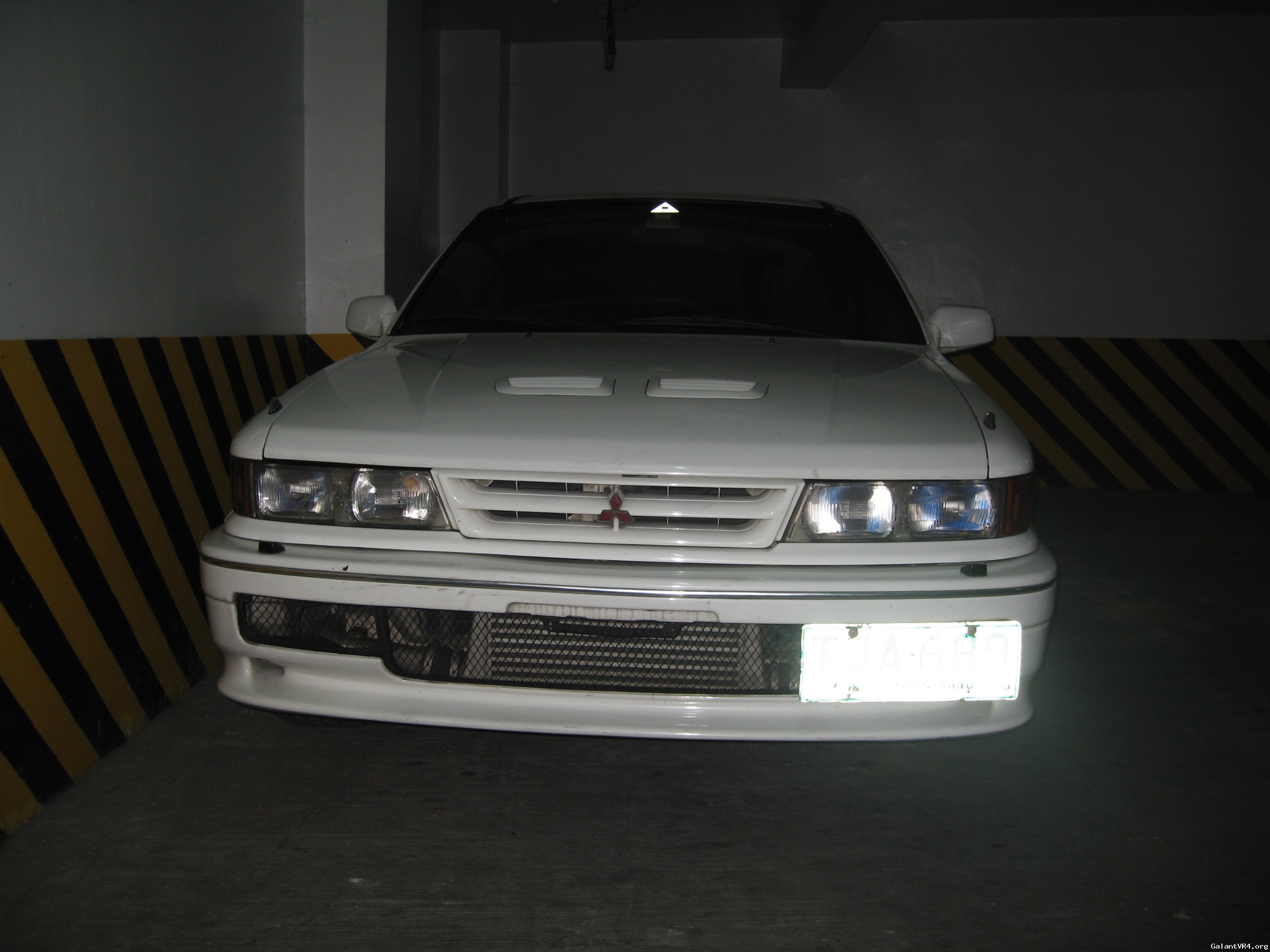

Underneath the filter, i cut a hole there and made an air duct feeding cooler air from the front bumper.
There is a slight decrease in AIT around 5-10* according to dsmlink.
I can still make the airbox cooler by sticking some insulation material (i forgot what it's called but my mechanic has one). It's like soft foamish material. Coz when i touch the airbox it's still hot. So i assume there is still a lot of heat transfer going on inside the box because of the under hood temp. Putting insulation outside or inside the box will definitely help. Of course i choose to put it inside for a cleaner look.

i dont have a direct pipe yet but i do have a hole under where the air filter sits and i do have an air duct going towards the front bumper where my passenger fog lamp used to be. I think that the air duct isnt enough. I have to extend it to where the fog lamp used to be and design a very good air collector.
