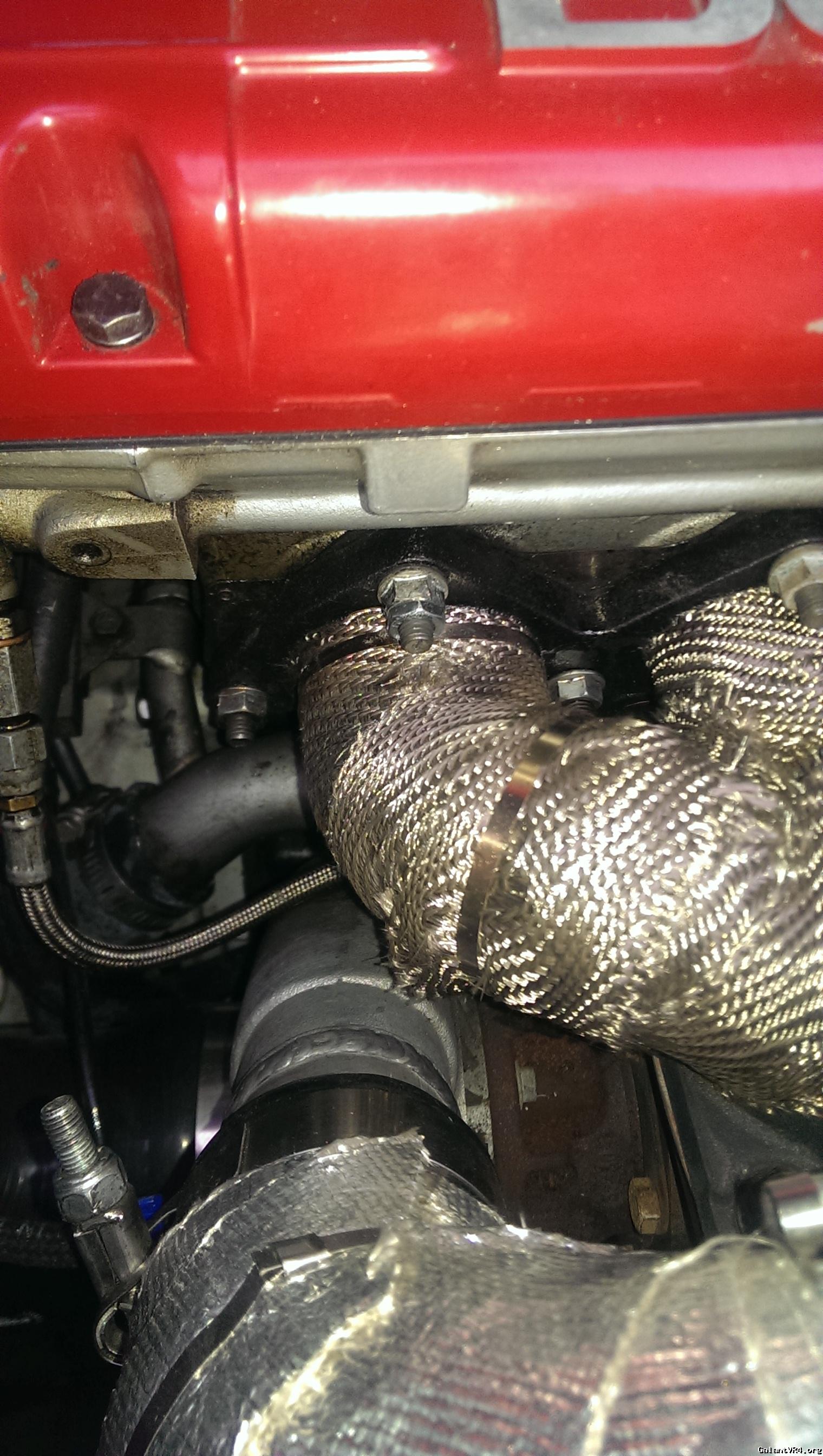

Ok, so I just got back from Toronto. Drove home from the airport. Drove to dinner. All ok. Drove to an office this morning and the damn nut is loose again. Thank goodness for small miracles... The scribe mark on the end of the exhaust bolt hasn't moved, so the bolt itself isn't running out. But I'm still in a place where I can't get the nut off without cutting the end of the bolt off or loosening every other both and pulling the manifold off the block (which incidentally would also require either moving the radiator or unbolting the exhaust and maybe pulling off the turbo).
I've noticed that their is a washer between the nut and the block surface. This washer is quite smooth on both sides. The nut, however, has teeth on it. Now not every bolt has a washer, but most do...
Can I snip that washer off and just tighten the nut against the head? I would bet those teeth on the nut would hold on pretty good. My other option is to take a locking washer, cut it, twist it open so it can slide around the bolt, then twist it flat again.
Thoughts? I really don't want to cut the bolt and taking the manifold off isn't going to happen anytime soon.

Simple thing is to run another nut on there and use as a jam nut .
If you had one, as Coltsfan said, use the locking nut.

lol. If i could get another nut on, I could take the current one off /ubbthreads/images/graemlins/smile.gif
although it would seem that the cap on the nut is what is keeping it from running completely off. I suppose I could try to put a smaller nut onto the bolt. hell, easy enough to try. I'll report back with my results!

Winner!
Two days and no issue. The jam nut had no cap and was half the size of the existing bolt. It cleared the JNZ manifold by a hair, but it cleared it and ran onto the bolt with ease.
All seems well so far!

an artifact of my old valve cover seal. I'll get it wiped off and retake the picture.
although I do have a crush washer that needs replacing on my turbo oil feed..

Turns out the that the nut wasn't loosening. The stud was pulling the head threads right out. I pulled the manifold with EHMotorsports and he drilled out the stud holes that we didn't tap during the engine build, then we H-coiled them, and put it all back together with fancy BMW copper stud nuts.
All good now!

Check for tightness, sure, but bear in mind that the issue I was having is that the threads in the head pulled right out with the stud. I knew that was the case because I scribed the end of the stud and was able to confirm that even with the nut getting lose, the stud wasn't rotating.
And pro-tip. Pull the manifold and turbo out as one piece. Breaking turbo bolts is soooo easy to do.
