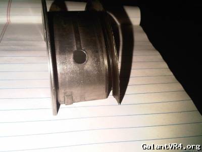

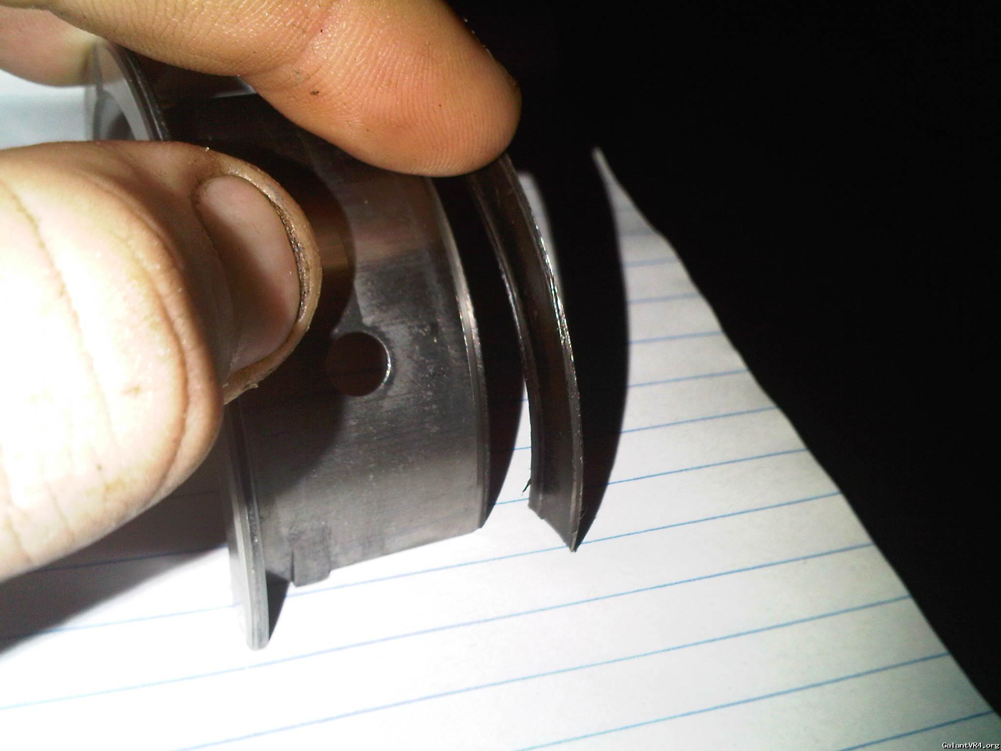

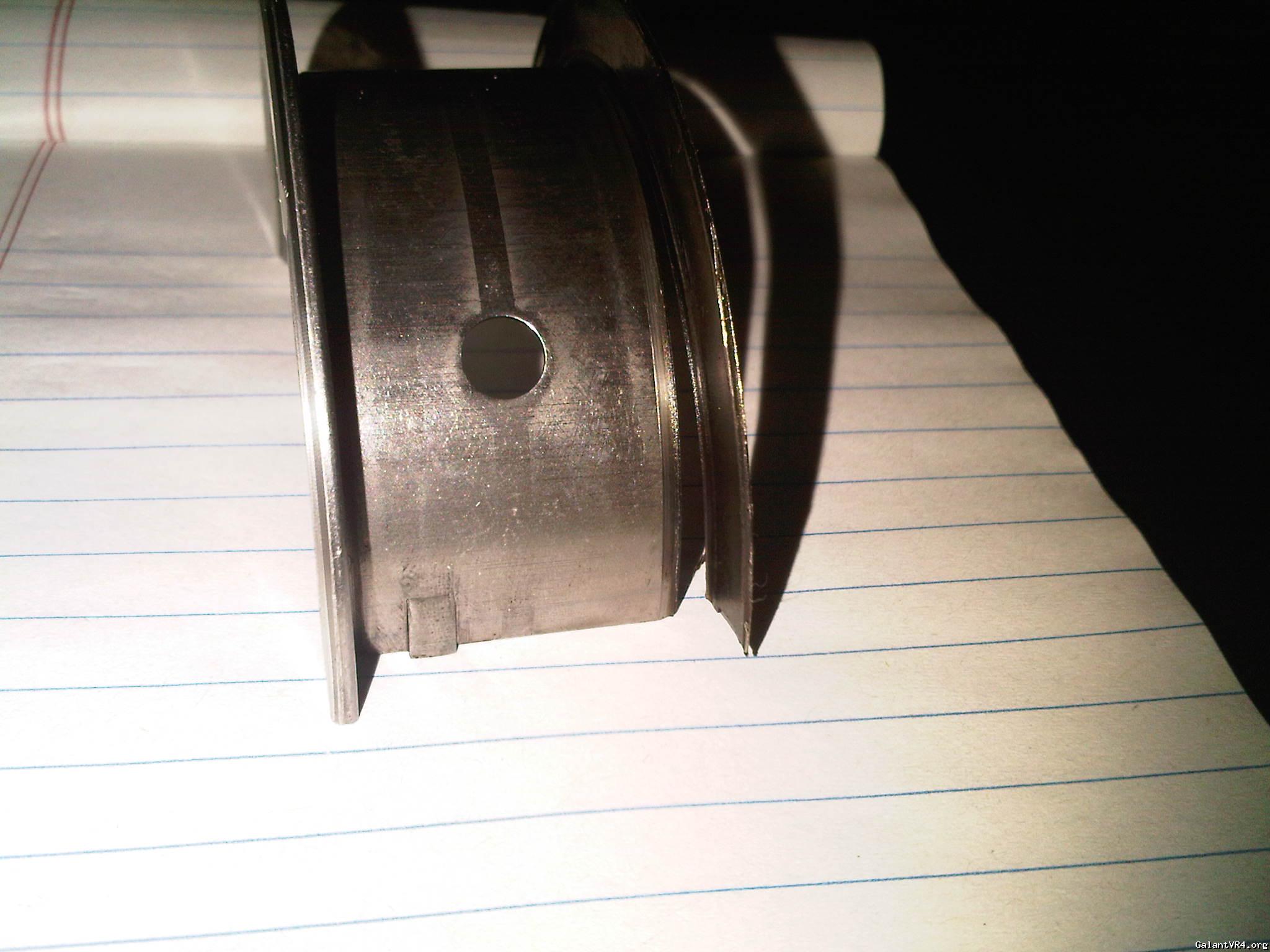

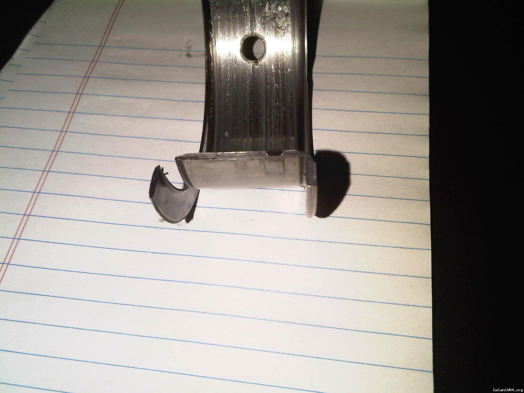

This is what an ACT 2600 did to my thrust bearing in about 20,000 miles. Destroyed my crank and caused some other problems as well. I will never own another ACT product in my life.
