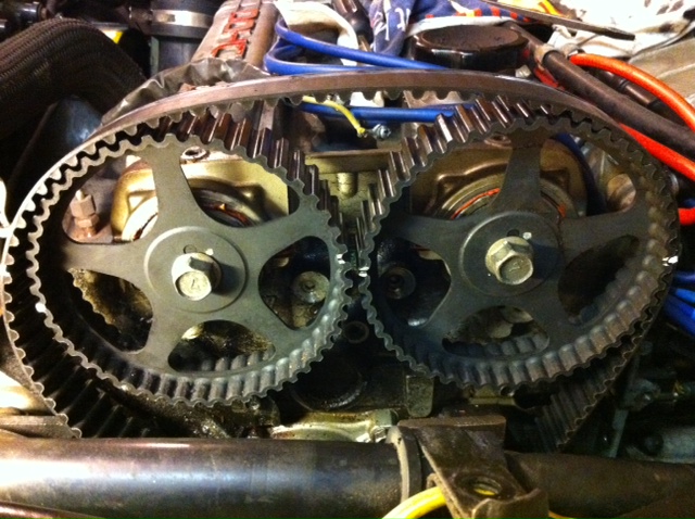

Nice, I got lucky and they lined up at the first pass. I picked up a gates belt locally, with a little more luck I might have the belt on yet tonight.

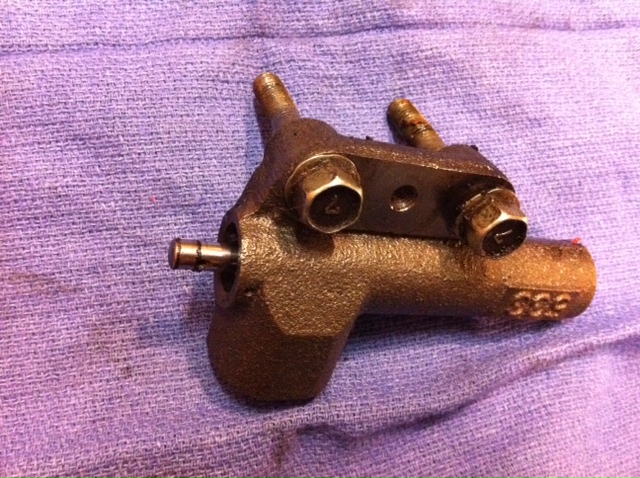

I screwed up and released the tensioner pulley before putting a screw in that hole to meet up with the tensioner. I'd this a big deal? Should I keep going by screwing in the tensioner to set the pin?

To remove the tensioner I would attempt to put a pin through to lock it if the hole in the tensioner rod happens to line up with the rest of the tensioner body - if it is only ever so slightly out I often find rotating the engine a few turns is enough to push it back in perhaps 1 or 2mm. Once the tensioner is locked then undo the 14mm locking bolt on the tensioner and pull the belt off. I often remove the two 12mm bolts on the tensioner and remove it entirely before taking the belt off so it isn't so tight.

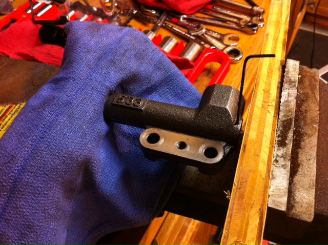

If you haven't been able to lock your tensioner with the pin (ie rod is too far out) and you have access to a shop vice then just pull the tensioner off and put it in the vice between blocks of wood and close it up enough to put a pin in it. Otherwise you can use a long threaded bolt (can't remember the pitch, but it's the same as the alternator tensioner adjustment long bolt) and thread it into a hole of the timing over above the air con condenser as shown here

Easier to just pull the tensioner off, compress it and put a pin in it. You can do it on the car as you suggest but it's hard to see. You didn't screw up, you're just a little out of order and/or you've added a step assuming you aren't replacing the tensioner.

Thanks for the input. I tried that alternator bolt and it is so close but not quite for getting those holes to line up. I guess I will pull the tensioner.

When I removed the belt the exhaust side cam jumped to the left a little with a click noise. Is this normal?

2)Just remember to compress the tensioner slowly when you have it out of the car.
3)Yes, the exhaust cam will click to the left. That's normal.

Easier to just make a tool out of allthread. Battery hold down works if you run a die down it but the threads aren't quite full threads and they can be gouged easily.

Iade a mistake there with the alternator bolt and tightened it not slowly.

Well, if you use a bolt it might not be so bad. Generally when people take the tensioner out of the car they put it in a vice or a c-clamp and you can REALLY squeeze it down fast. Are you sure you read the vfaq enough times? It specifically says to compress the tensioner slowly. /ubbthreads/images/graemlins/wink.gif

Anyone have a diagram of which bolts hold in the tensioner or a pic of one out of the car? Not sure which bolts to remove.

Are there 4 bolts to the tensioner with one behind the pulley? If so is there a trick to removing the pulley?

If you were just using a ratchet to turn that down you're fine. Bolts holding the tensioner on are soft of self explanatory. Two bolts next to it. Remove them. Key point, If you do belts on other mitsubishi 4g63 they are not all the same. There are 4 different part numbers for the tensioner so a description of "both bolts on the same side" isn't necessarily true.....it is in this case however.

Got it. I was confused because I thought I needed to remove the pulley and tensiOner as one piece. This was easier than messing with the screw.

WARNING:
It was brought to my attention that using an allen wrench as a pin is not recommended because if the wrench fails under tension it can shatter and potentially cause eye or other damage.
