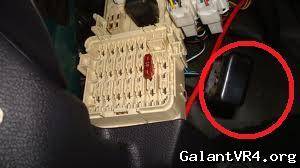

Had another question though i can see how everything would work the way its wired but is it ok to bypass that small fuse box that sits next to the larger one? Kind of looks like someone started to tuck things but only cleaned up some of the wires.

IRT your last question, assume you're talking about the diag port:
Would try to keep everything stock until you have your recipient car running. Anyway, you're going to need this if you connect an auxiliary tuning system like ecmlink.
