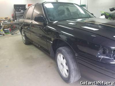

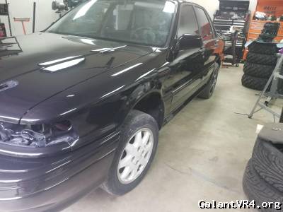

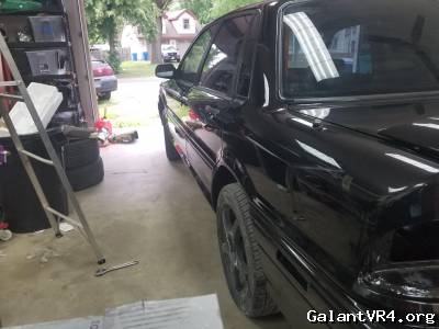

All of the tires need to have the same rolling diameter. It will require math to ensure that condition is met.
Mn92gvr4
Jan 11, 2014
110
North branch mn
Ah, I see what your getting at now. Well it's good for thought. I will have to see what kind of clearances I can get and go from there. Probably would be easiest to go with a narrower tire. I just have these floating around the garage, it would be nice to use them.

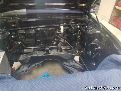

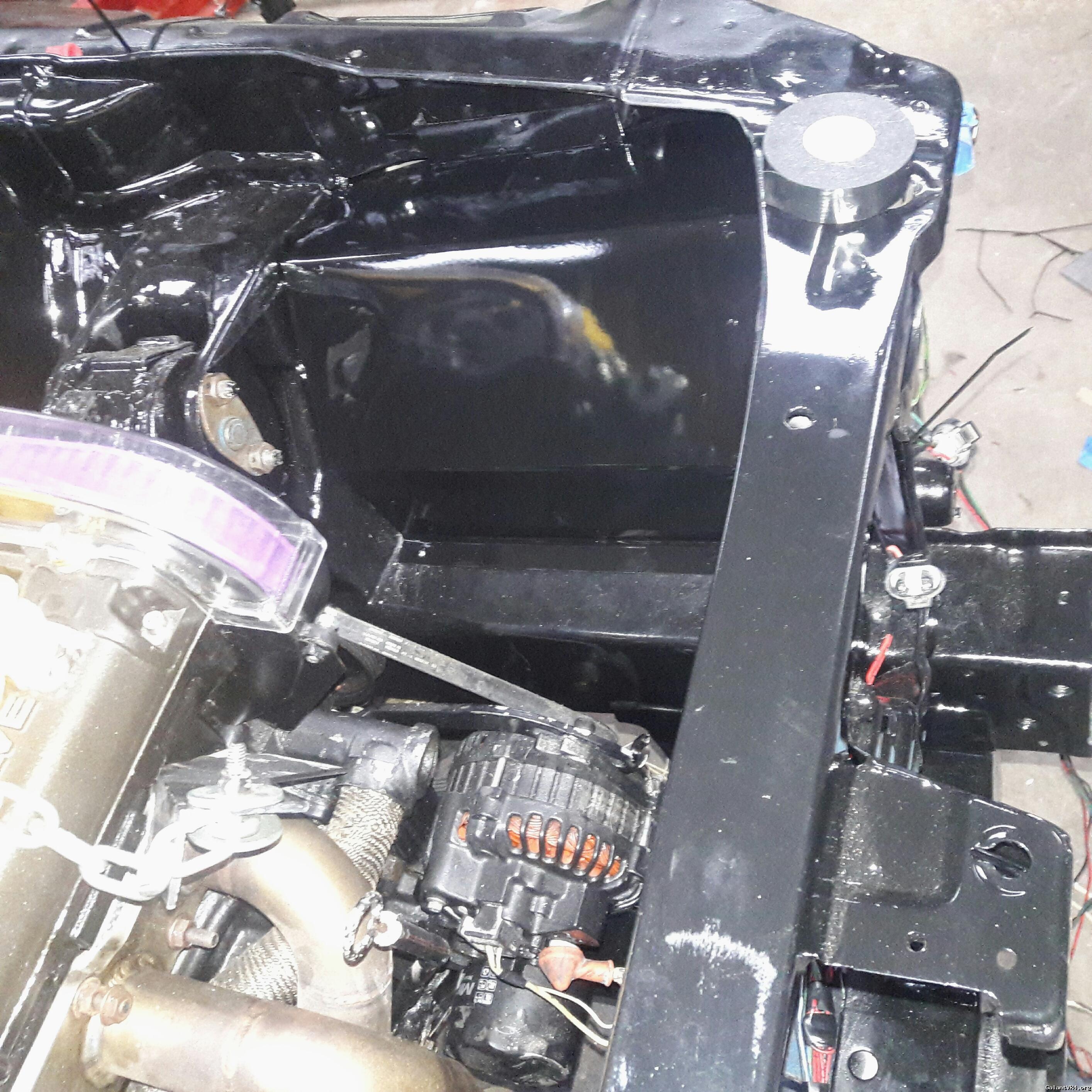

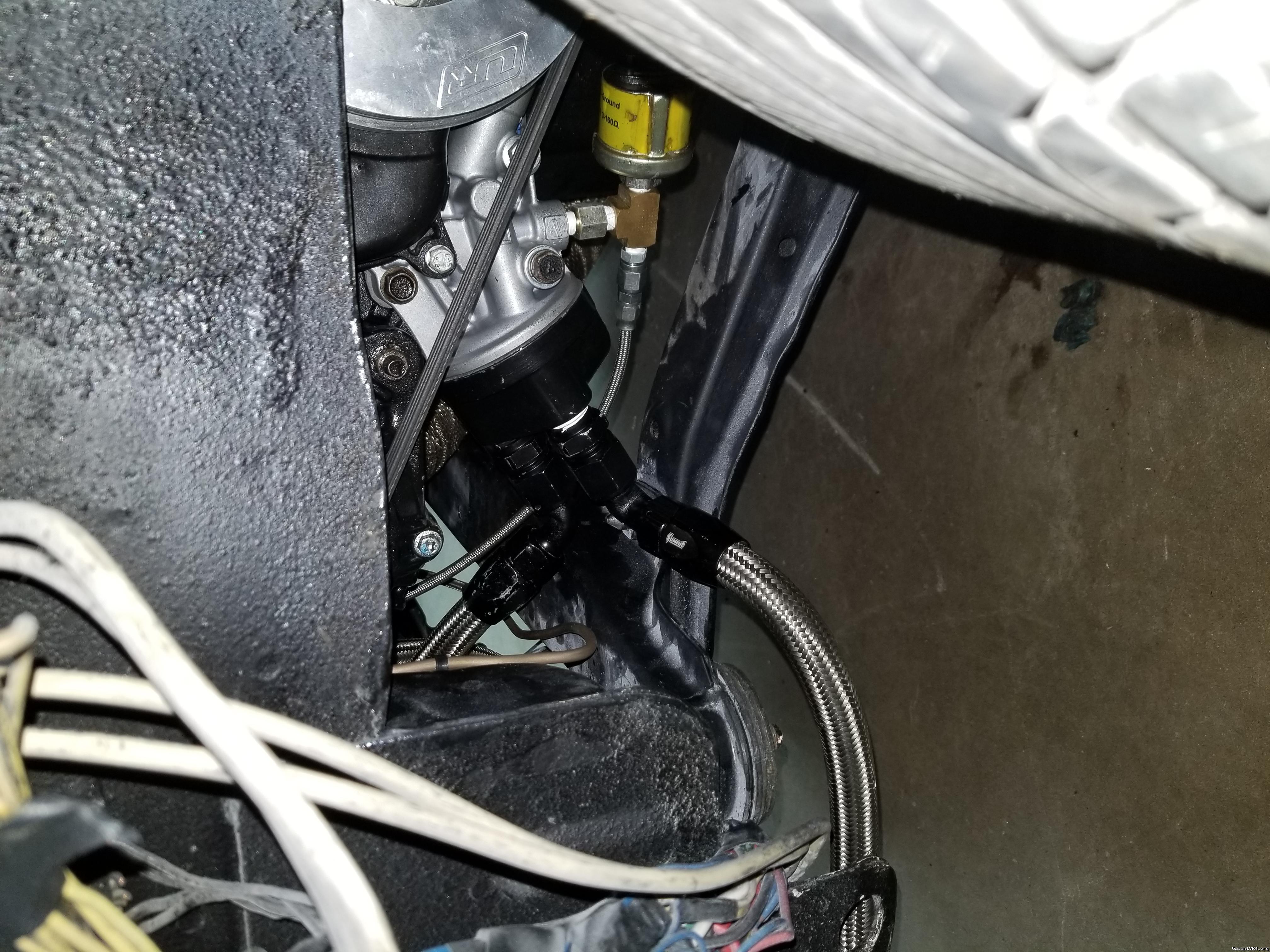

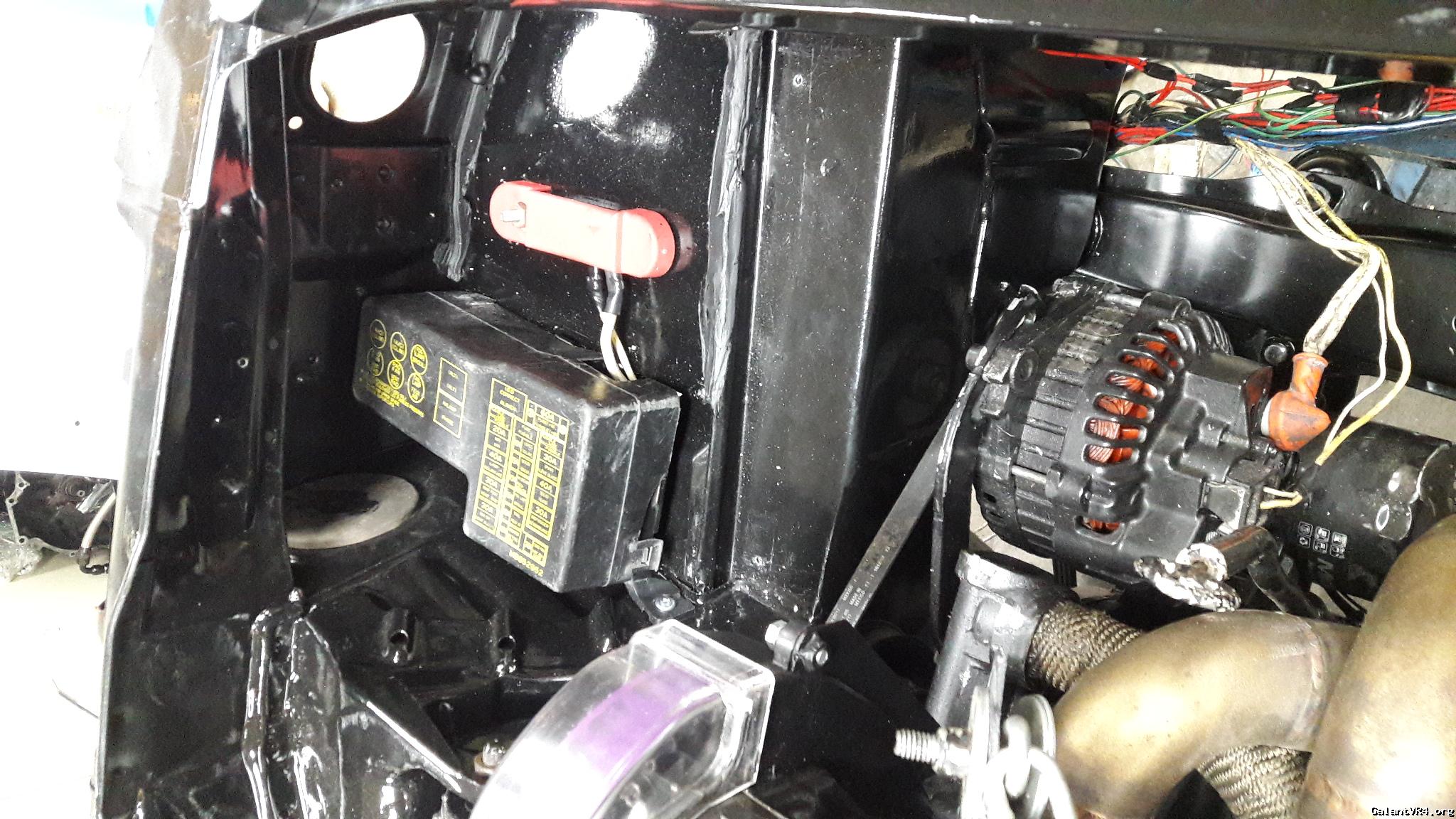

I just finished doing a fuse box relocation. Over all I am happy with the results. It was a huge headache but is well worth it. I still have to finish running my power supply cables.

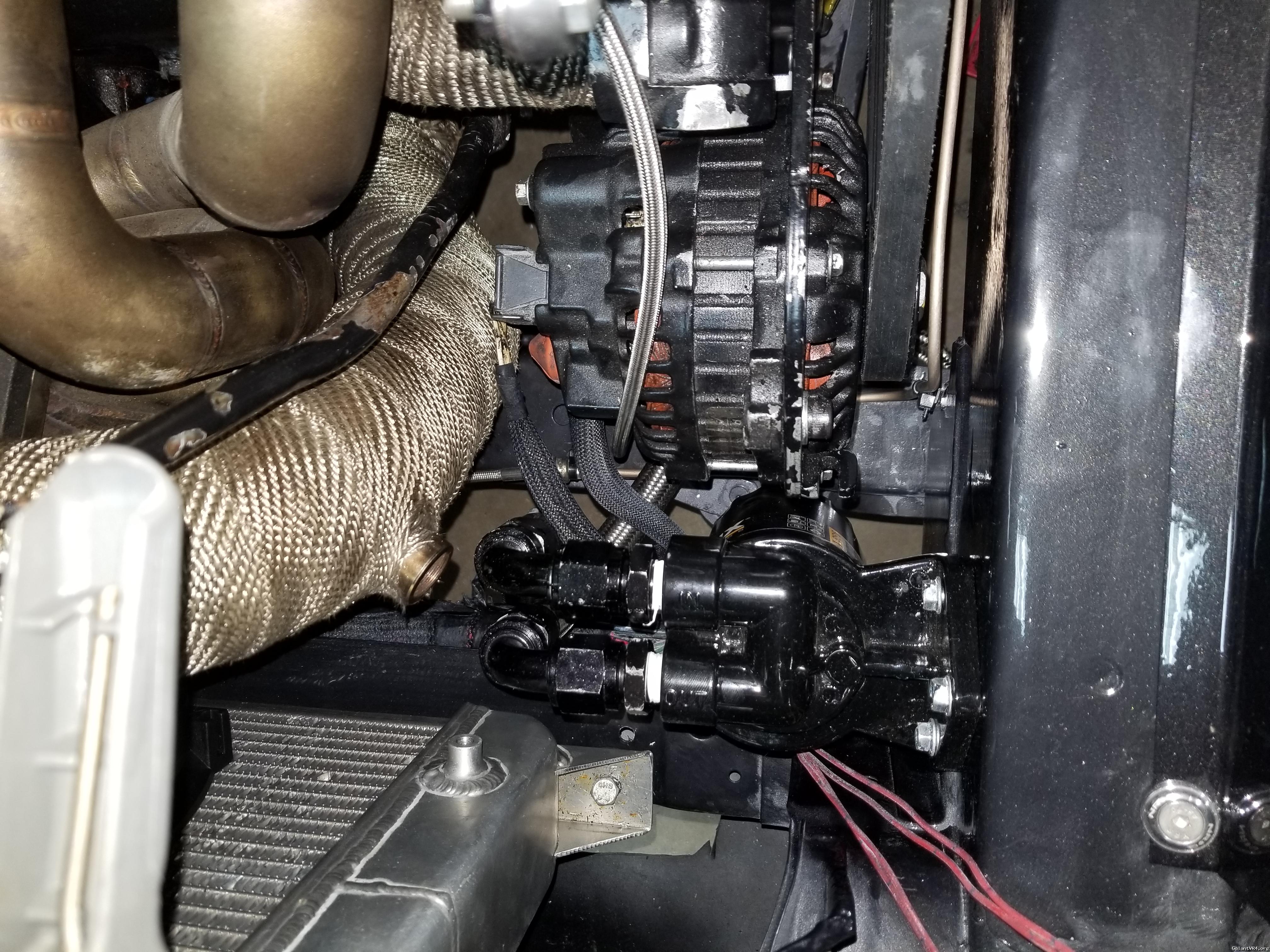

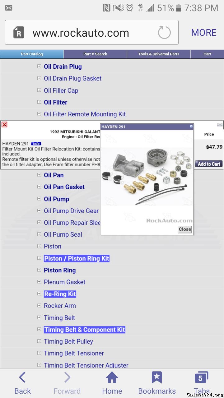

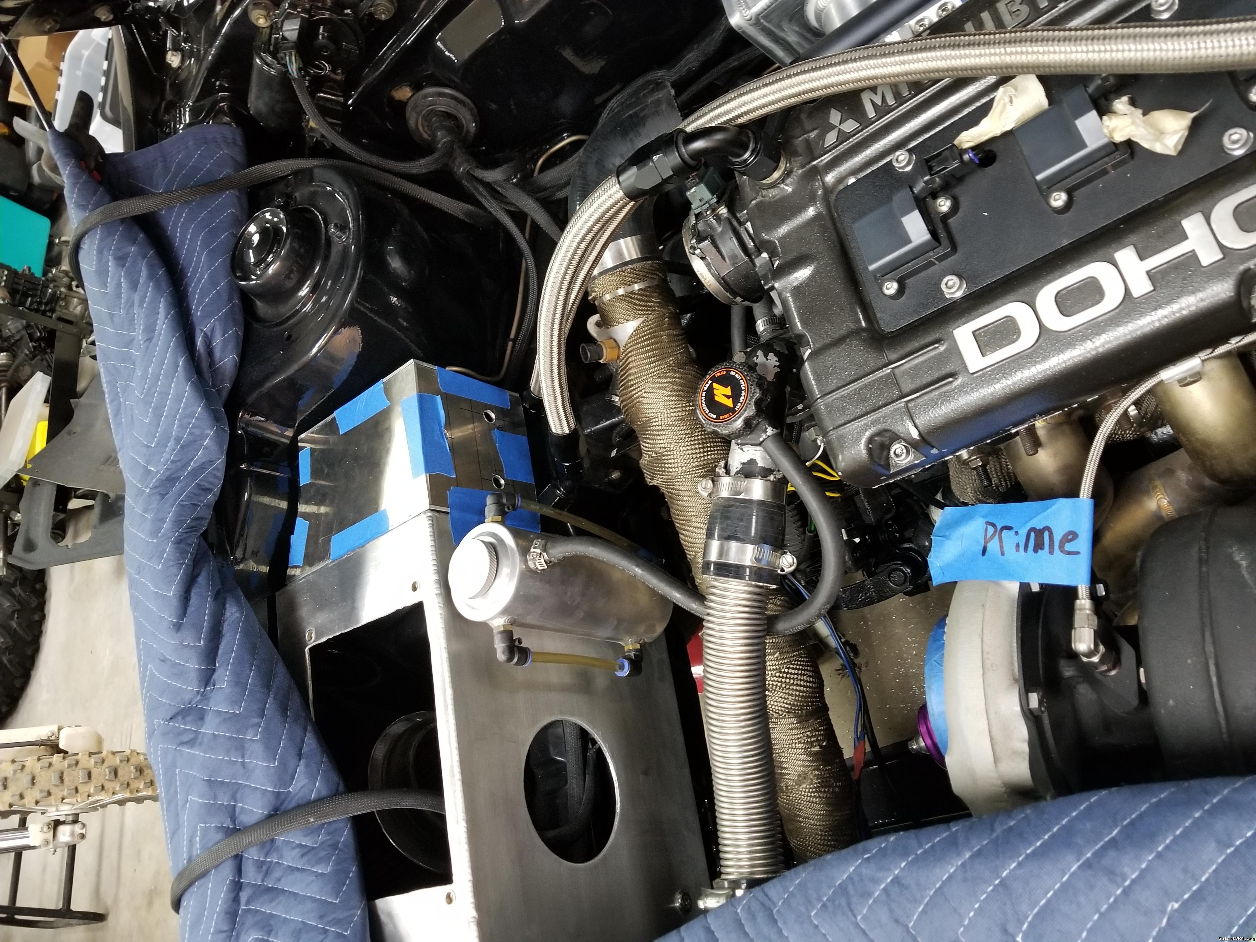

While browsing rockauto I came across this relocation kit. Pair it with a ffofh and it would clear up a lot of downpipe room.

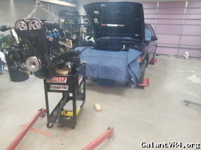

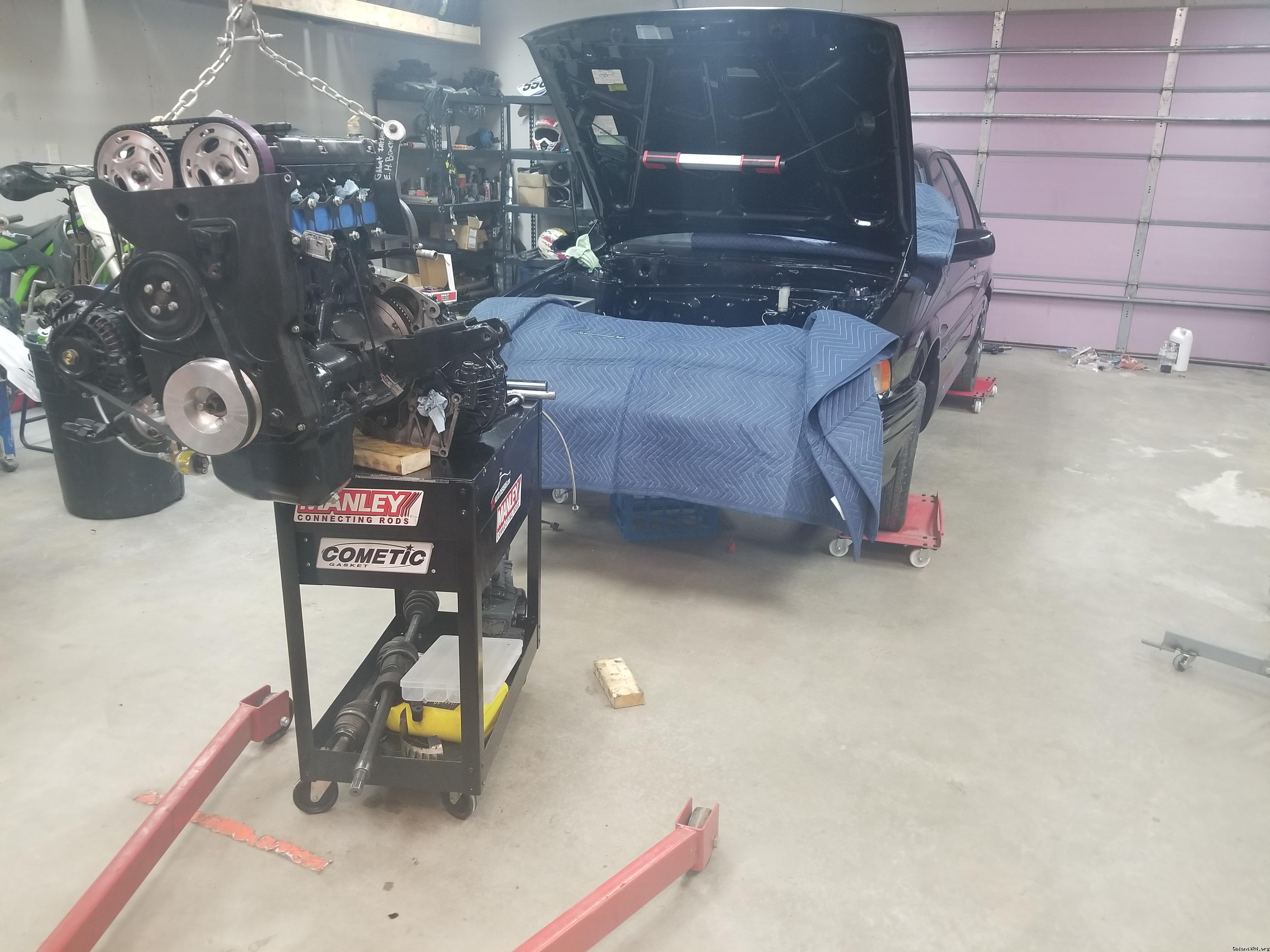

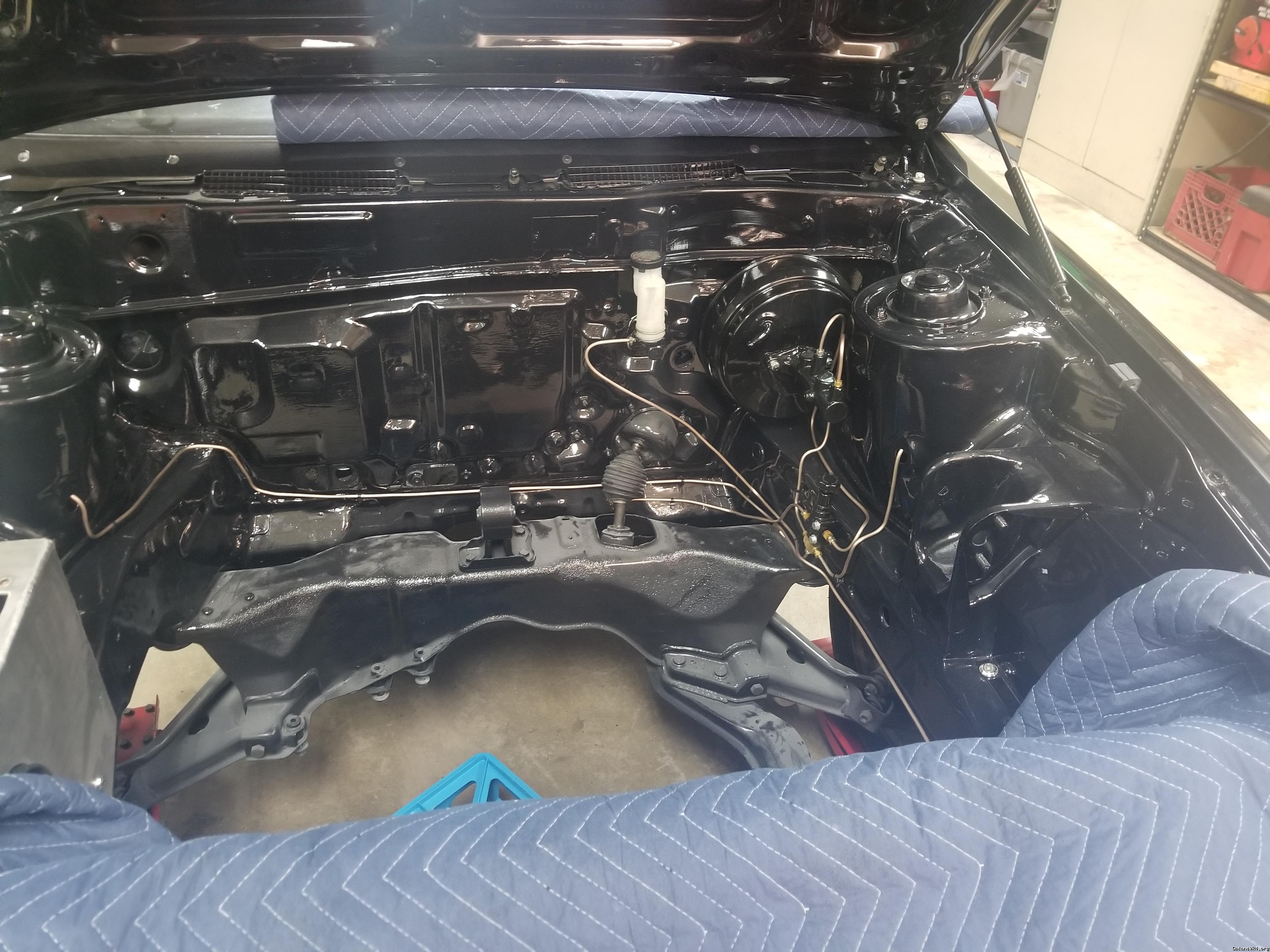

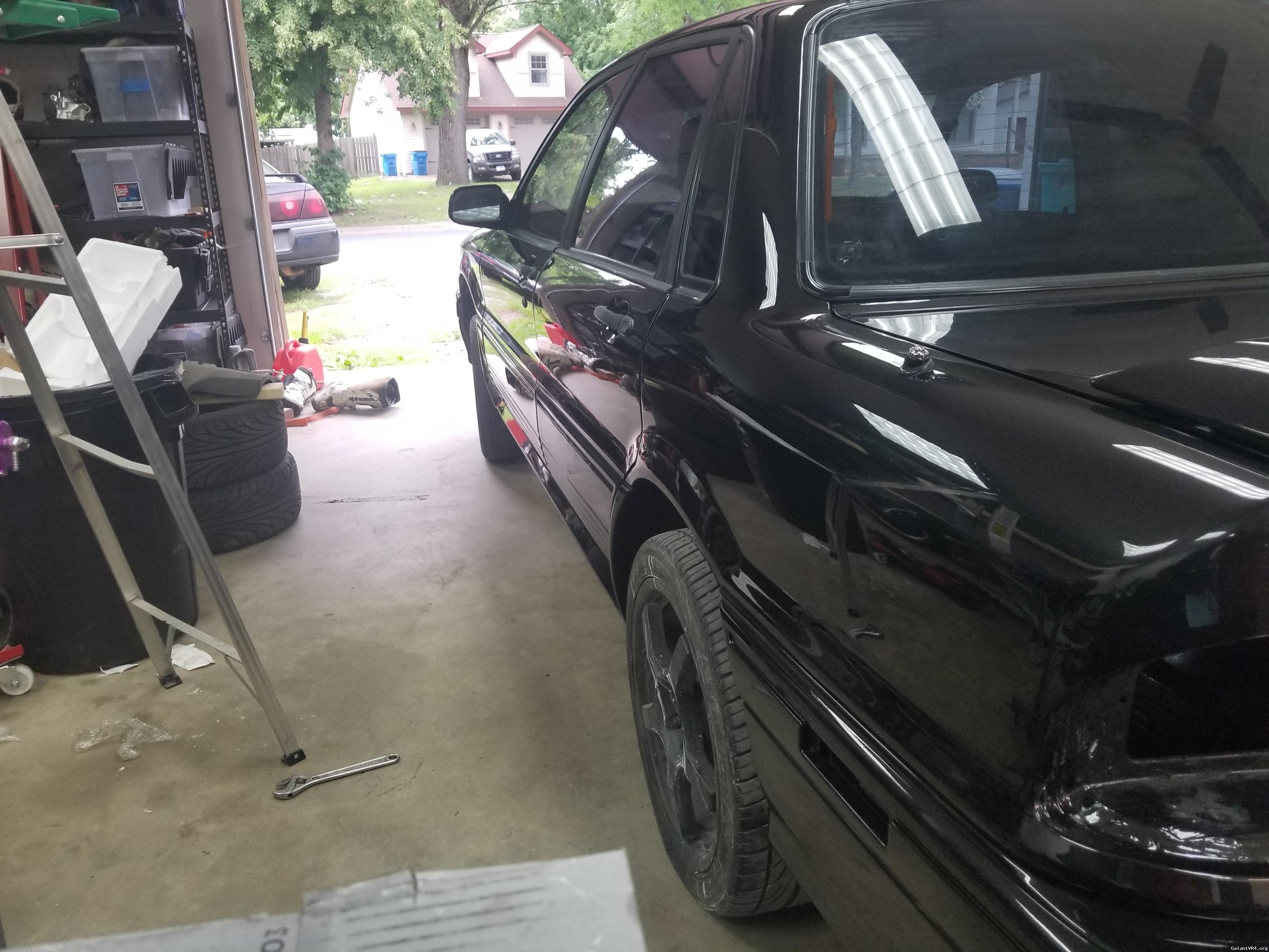

Stuff is happening now. Missed being able to work on her. Brake lines and clutch lines installed. Motor and trans going in next.
